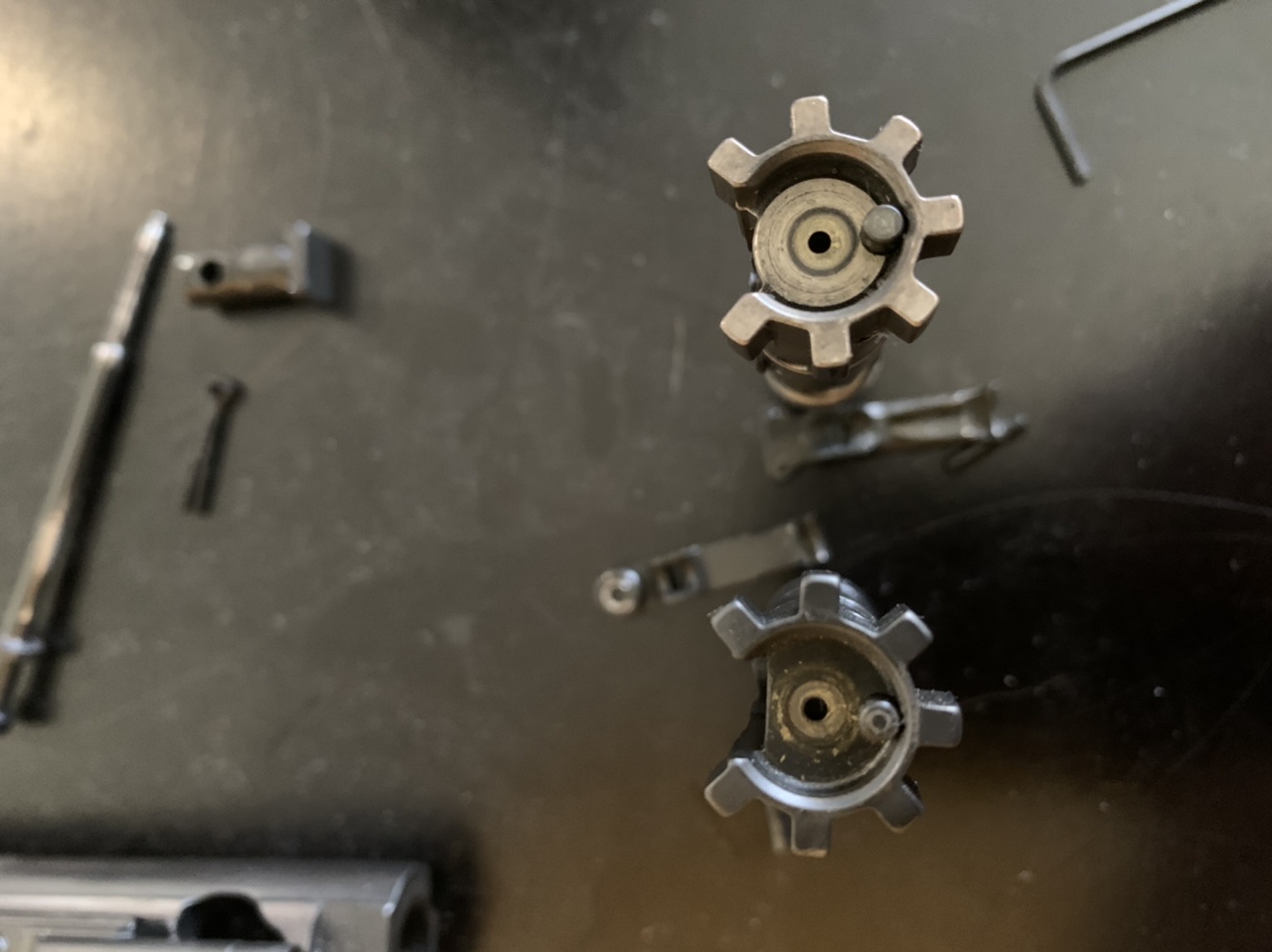

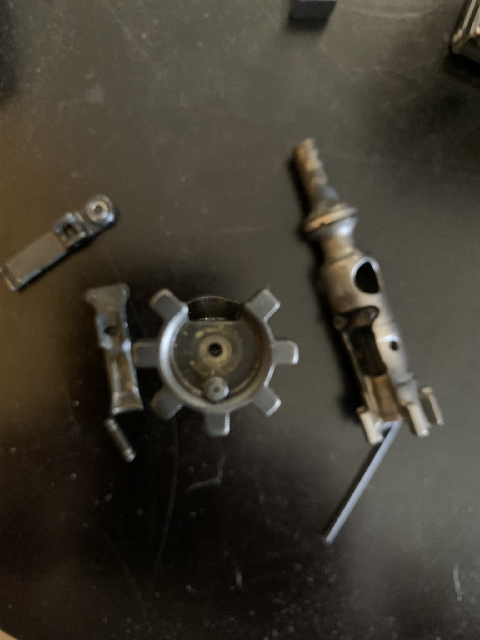

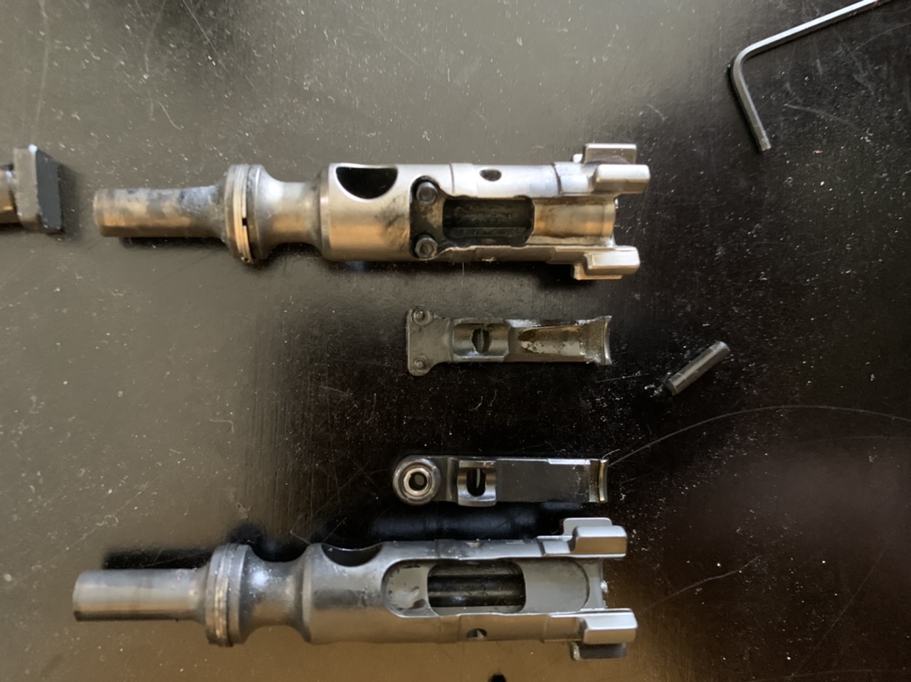

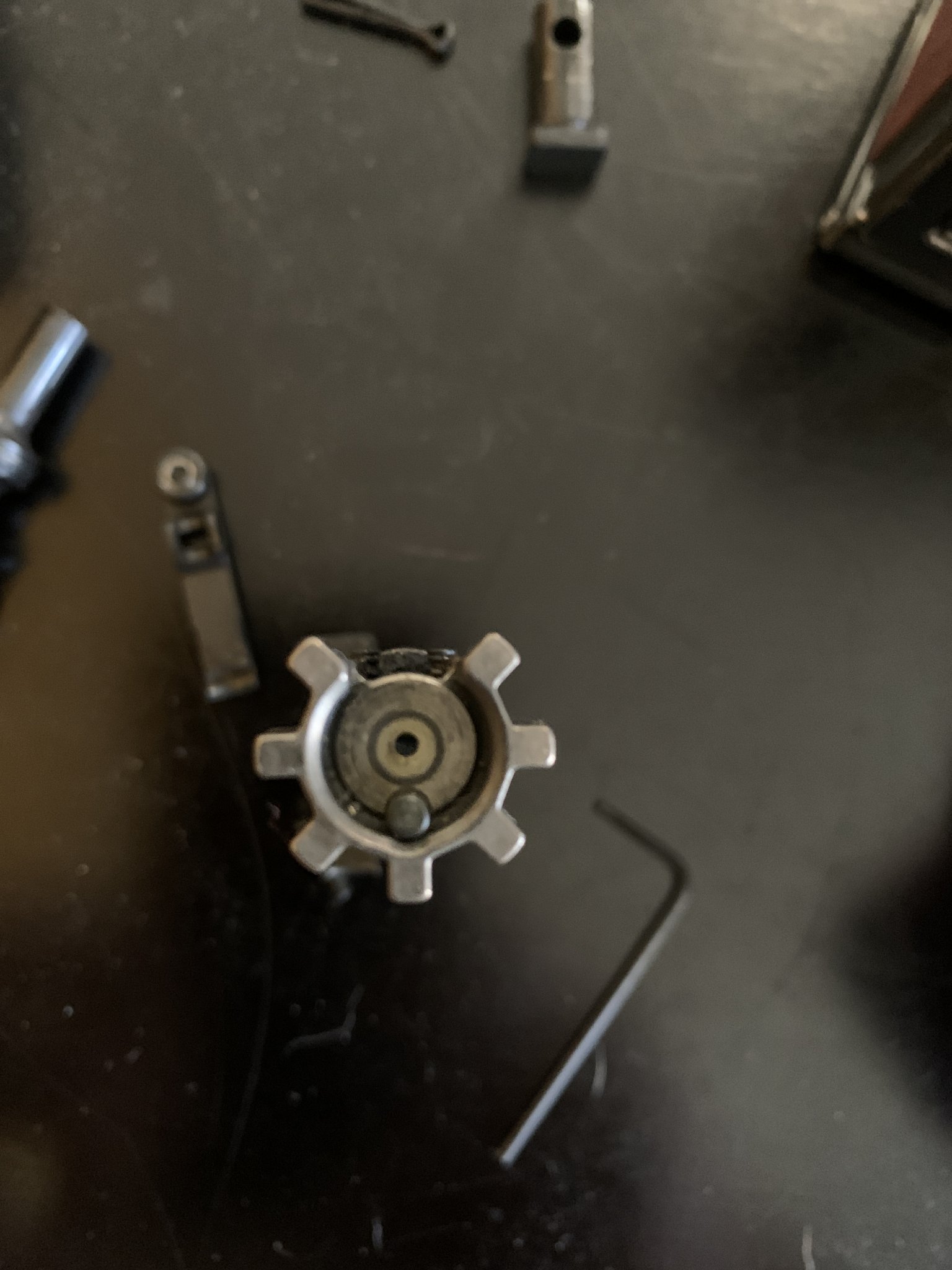

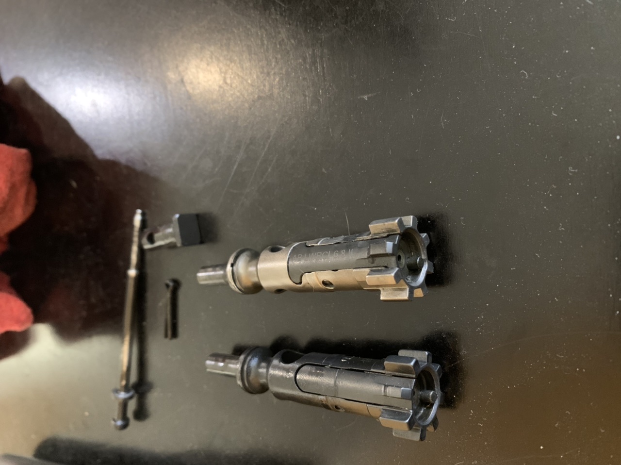

In my Valkyrie I’m running a Sharps Low mass carrier with the LWRC bolt (the best IMO 6.8 bolt).
Nothing wrong with tool craft, but I have had issues with 1 of the 2 I’m running. Their CS is excellent.
Below pictured is a toolcraft .422 from my 6.8 SPC next to the LWRC .422 bolt from my Valkyrie.
You can see that the LWRC extractor is wider & gets more purchase on the case head. The real trick is that they did that without undercutting the 2 lugs adjacent to the extractor. Not sure if LMT is the same, but this is a pretty big deal for lug strength.
Also look at bolt face. Full case head contact for the LWRC & reduced support for the traditional extractor cut on the Toolcraft.
