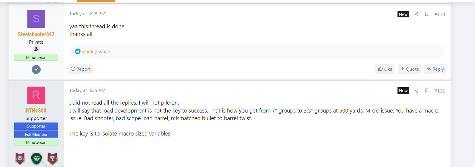

I did not read all the replies. I will not pile on.
I will say that load development is not the key to success. That is how you get from 7” groups to 3.5” groups at 500 yards. Micro issue. You have a macro issue. Bad shooter, bad scope, bad barrel, mismatched bullet to barrel twist.
The key is to isolate macro sized variables.
IlI have never had substantial success with load development or bedding
Give “Unkown Munitions” a call and have them putogether a couple loads for you. they don’t need your rifle to do it either. They have great shooting loads for just about every caliber out there.
If they don’t shoot then it’s probably you. If they do, you’ll have the recipe.

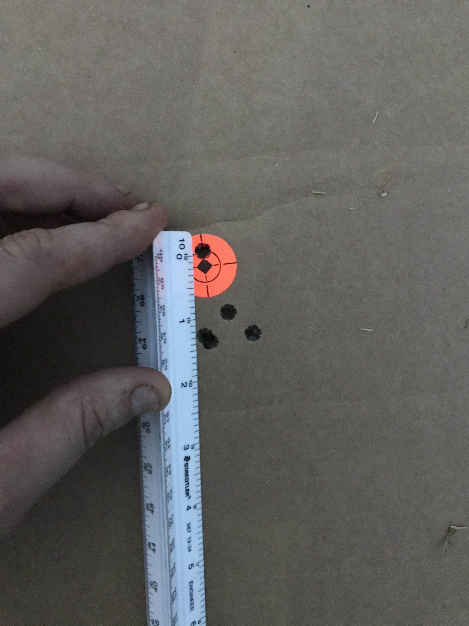

did my seating test today. found the accuracy node was very obvious on my posted target. . . . . . . . . I was able to replicate the .5 moa group I shot yesterday so I know thats my node.

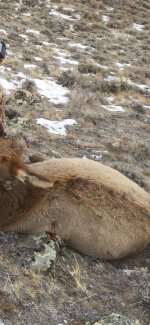

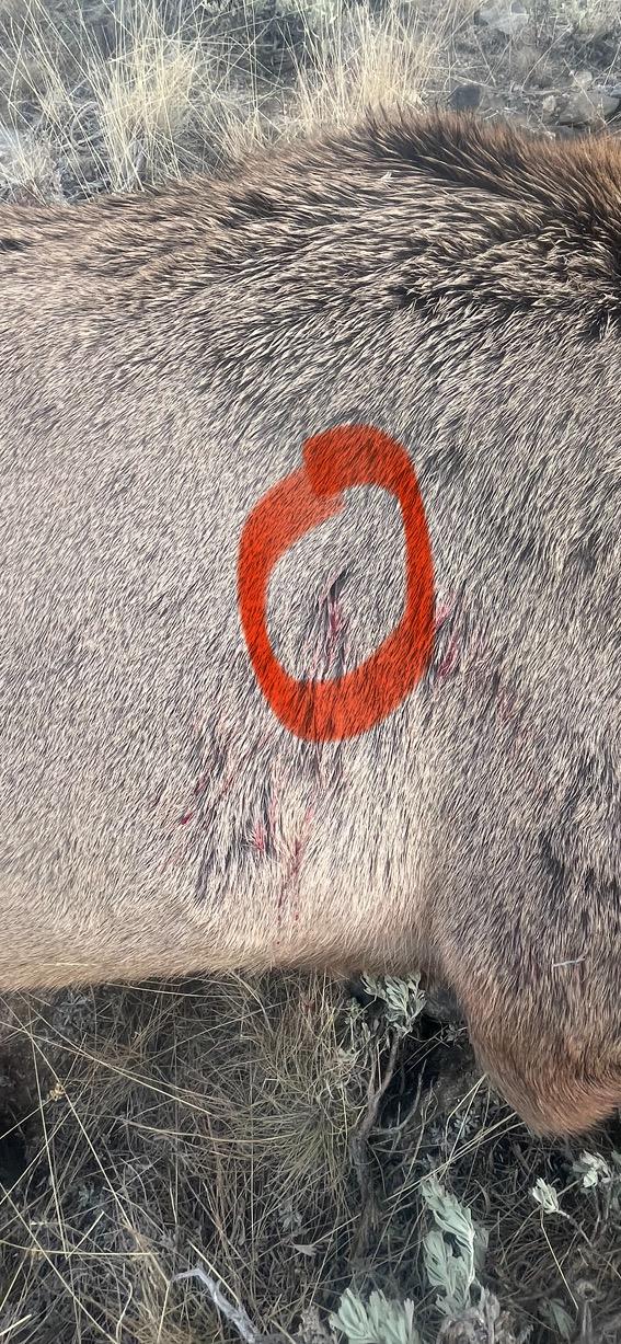

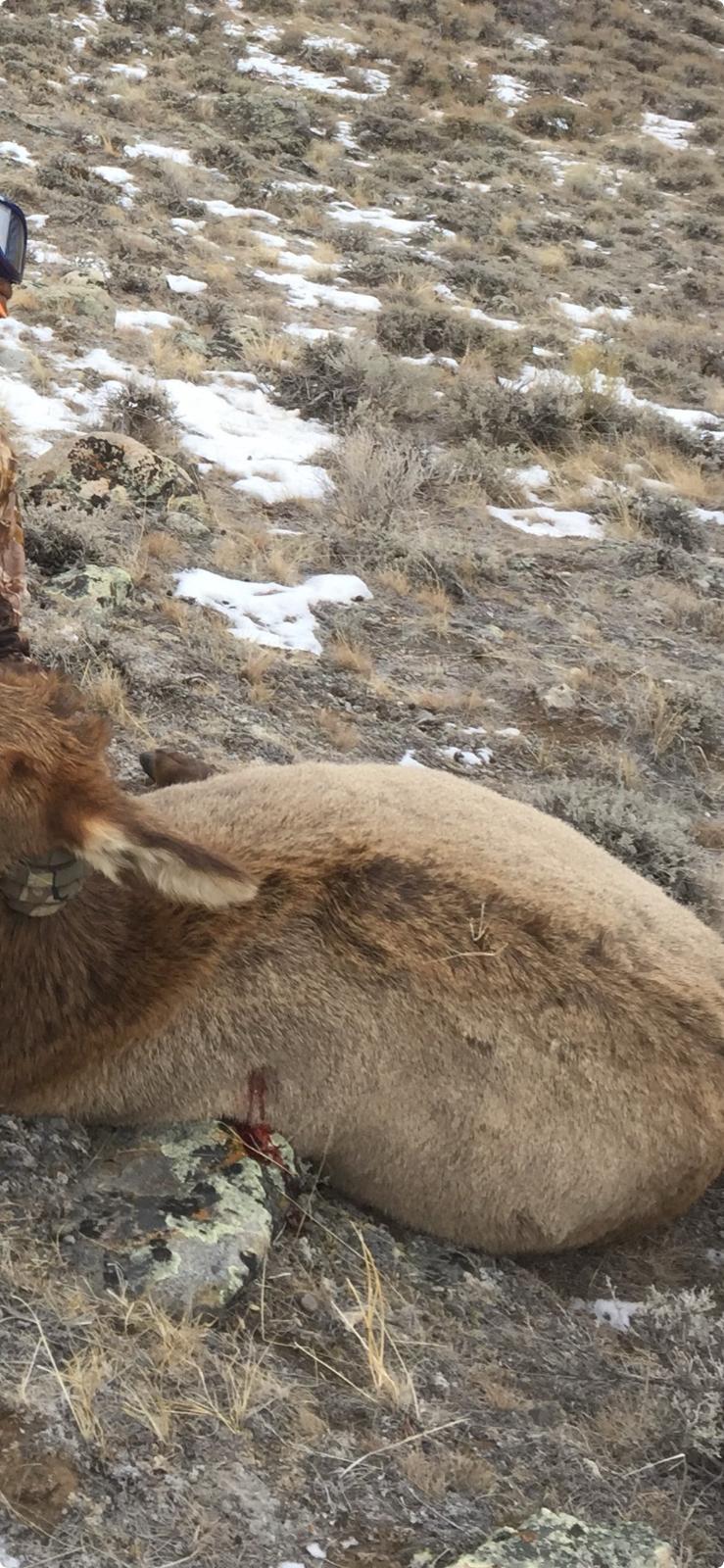

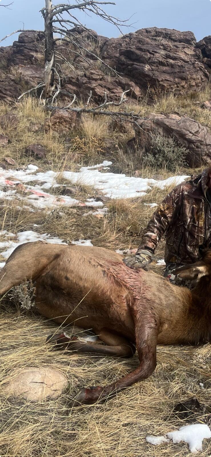

Seriously? I'm not a competitive shooter. I shoot long range a couple times a week starting towards the end of July through Sept every year regardless of the wind. Red circle, 2023 elk center mass 654 yds. Middle pic 2022 elk center mass 524 yds. Far right pic 2021 - exit wound center mass 867 yds. I have a pile of deer pics shot from similar ranges all center of mass. Spend the time, make the shot...
Reactions: DJL2 and 308pirate

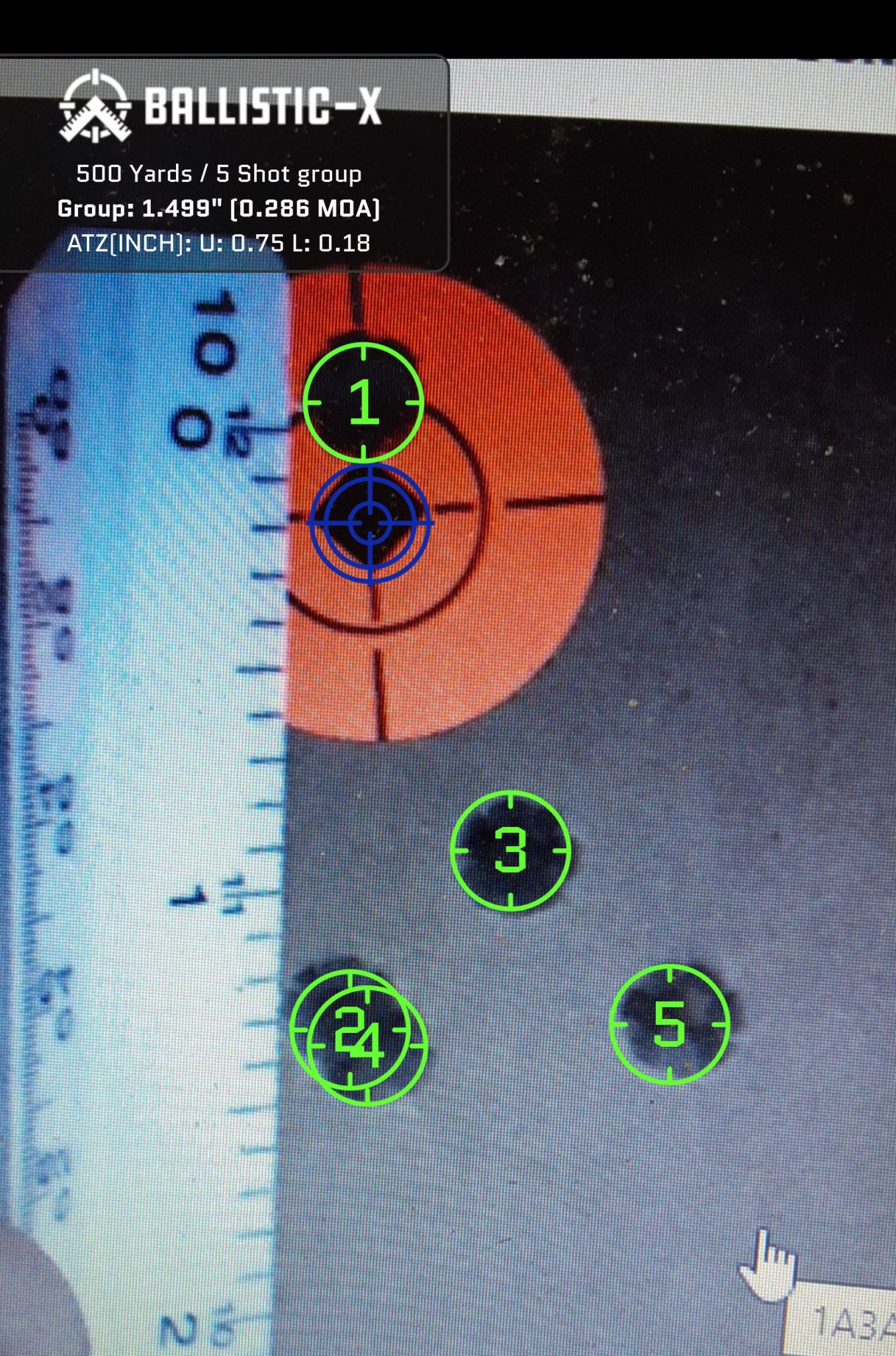

Here’s a 5 shot group at 500 yards from my fclass 284.
And here’s a 600 yard group from my 260 Savage
It’s not hard to get even MOA at 500. But you need to put in some effort
Right now you’re just sitting in the corner of the bar waiting for the hottest chick to run over and climb on your lap. Doesn’t work that way
Nice. I don't know the impact order, so I kind of guessed.
Am I close?
Am I close?
The higher round was shot 5 if I remember. Was having issues with donuts in the neck from my Redding bushing dies. I sorted out the rounds that chambered good vs the ones that had some effort closing the bolt. At the time I didn’t realize a donut was my issue
That round is the one that closed harder on the donut. The speed was slightly higher as well. They still shot good.
I shot a 198 and 195 with the good stuff at 1,000. When wind picked up in 3rd relay I went to my tight ammo. Didn’t have enough good stuff to shoot the full 20 plus sighters and didn’t want to switch mid string. Ended up with a 189 or 192 on that one. Vertical was an issue with those
The whole reason behind this group was to test the difference between the two. I shot this a couple days before the match
This was 6.5-284 necked up and turned
