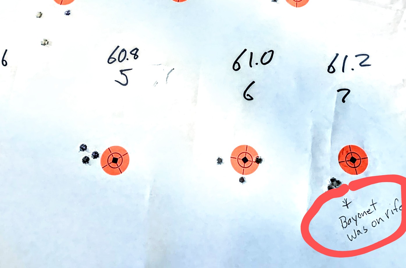

How does a rifle shooting 24” groups at 500 produce the groups he shows on paper above?
Unless he goes back to those loads and retests that we won’t know if the mount/scope etc crapped out in between. It’s the only way at this point to learn anything about his 500 yard issues.
Repeat what worked. If it doesn’t work then something is wrong
For all we know now he may have screwed up and used the wrong components on the 500 yard target or something else on the reload end. OP doesn’t seem very knowledgeable when it comes to reloading and should take a step back and reevaluate

This was my first attempt at load development
What do you mean in the last group that didn’t actually look like shit “bayonet was on rifle”? A magnetospeed bayonet or an actual bayonet?
That group tightened right up and looked acceptable. You may very well have a harmonics problem and could have other problems as well. I’d try a different bullet and a tuner. 280 AI has a factory ammo available as well that might be worth a try.

did my seating test today. found the accuracy node was very obvious on my posted target. The group with the bayonet through me off and I used that for charge for seating depth. The result I got from that was to look at the node at 60.8 and how obvious it is. I just have to do some seating depth test at that charge and I'll get .5 moa or better. I was able to replicate the .5 moa group I shot yesterday so I know thats my node.
this rife is extremely finicky about which loads it likes. I've put together several rifles and never had such a picky rifle. But all in all I've found my 500 yard elk rifle. I'll post my 10 shot 500 yard group after I can find the time to get out to my range. I got to make money now to pay for all this stuff' Glad you all enjoyed my post.
When I go back and look at the photo of the target I posted you can't see the 60.6 charge group so the node isnt obvious from that photo. Man the info was staring me in the face but like i said the bayonet group was a huge red herring.
