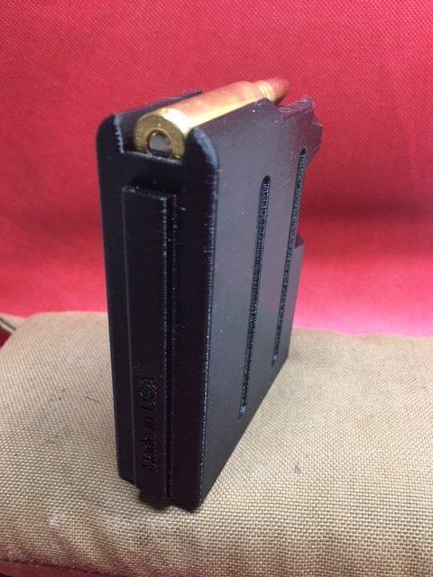

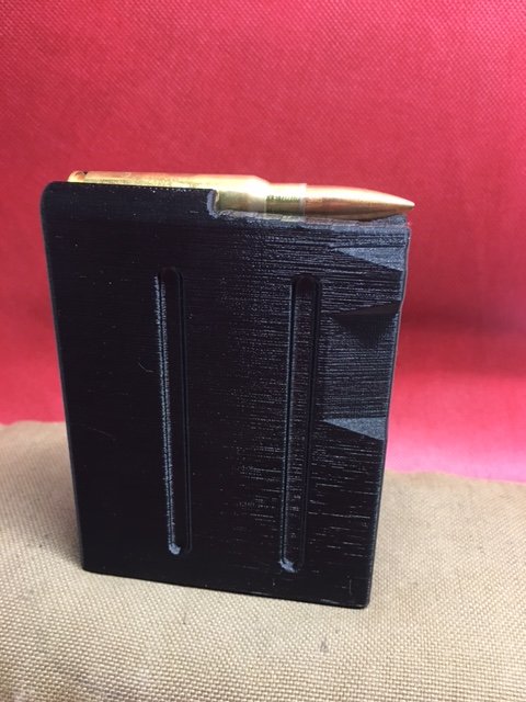

As far as #1 goes I am having a single shot mag block tested right now. I am not sure about the RPR's, but my long range rifle's all require single round feeding when loading out to the lands, unless you have a chamber put in that has a short throat.

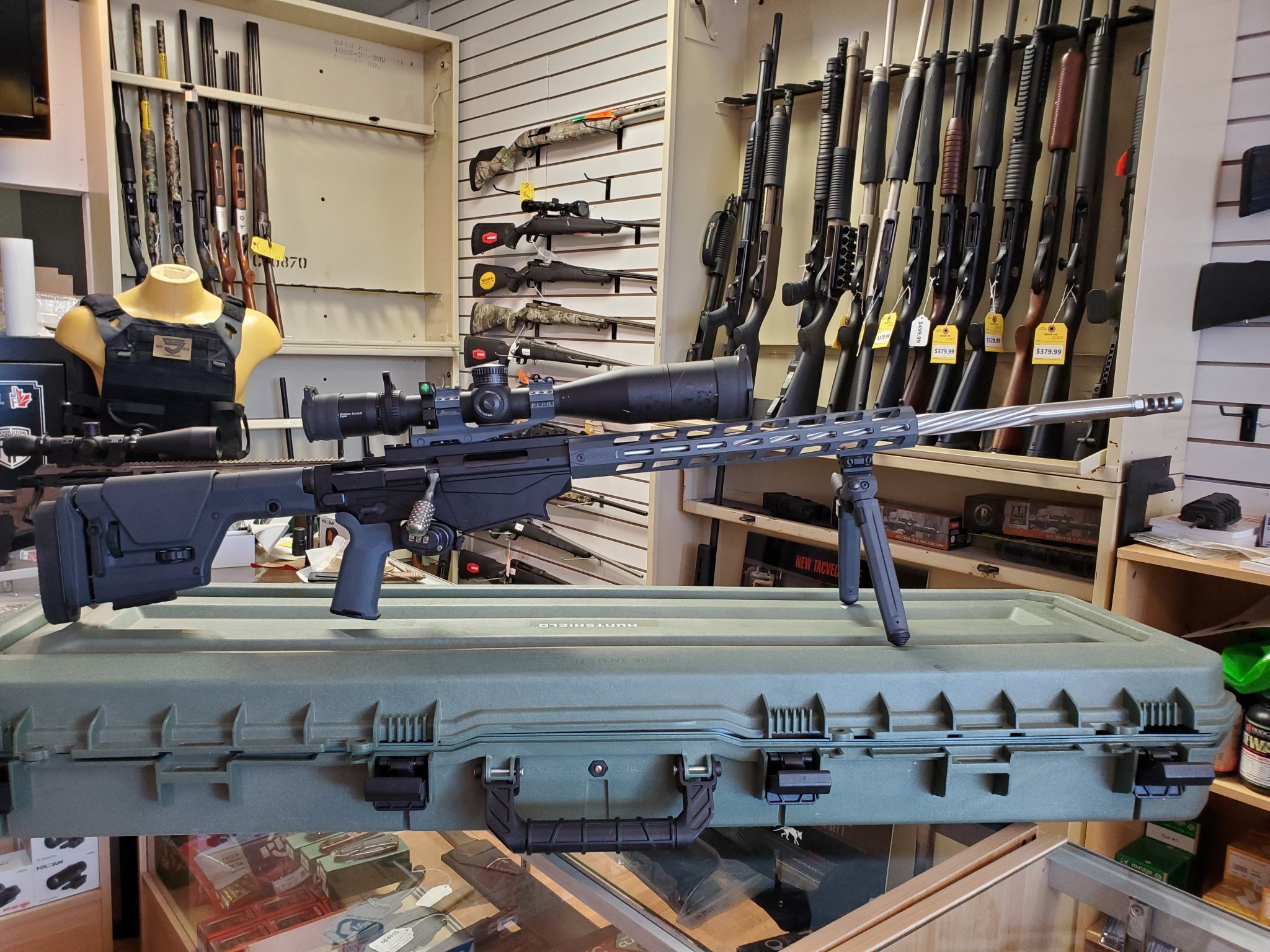

Just purchased a RPR in 300 Win Mag ,Atlas Bipod, Vortex 5X25X50 w 34mm tube Mildot scope, waiting for my surefire muzzle breaks and blast director. Plan to change the trigger to a 2 stage Timmney trigger break in the barrel then pray enough Republicans have the balls to stand up to the Demonrats and I will be able to freely purchase enough ammo to hit a few schools and hopefully make a decent attempt to hit a target at a mile. Common availability of ammo led me to .300WM rather than the more potent .300PRC or .300 Norma Mag.

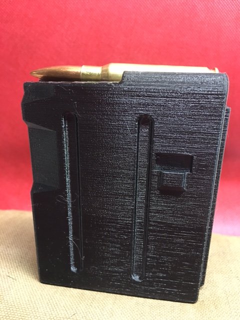

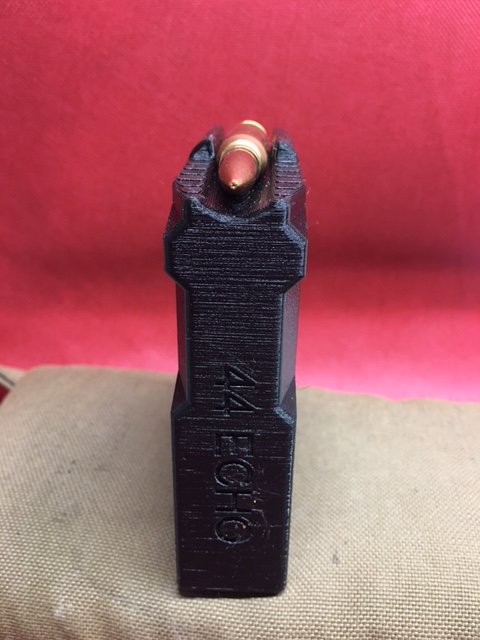

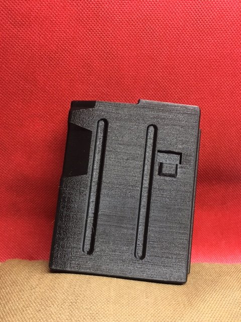

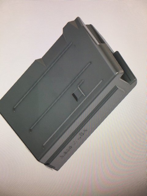

For those of you interested I now have Single shot mag blocks for the RPR, its based on the pmag 10 lr/ sr. great for load testing and development and for long range matches. If anyone is interested let me know.
View attachment 7587513View attachment 7587514View attachment 7587515View attachment 7587516View attachment 7587517
These work great, folks. I have one for a 6mmCM, feeds nice and smoothly. Excellent product for a great price. Great seller, buy with confidence.

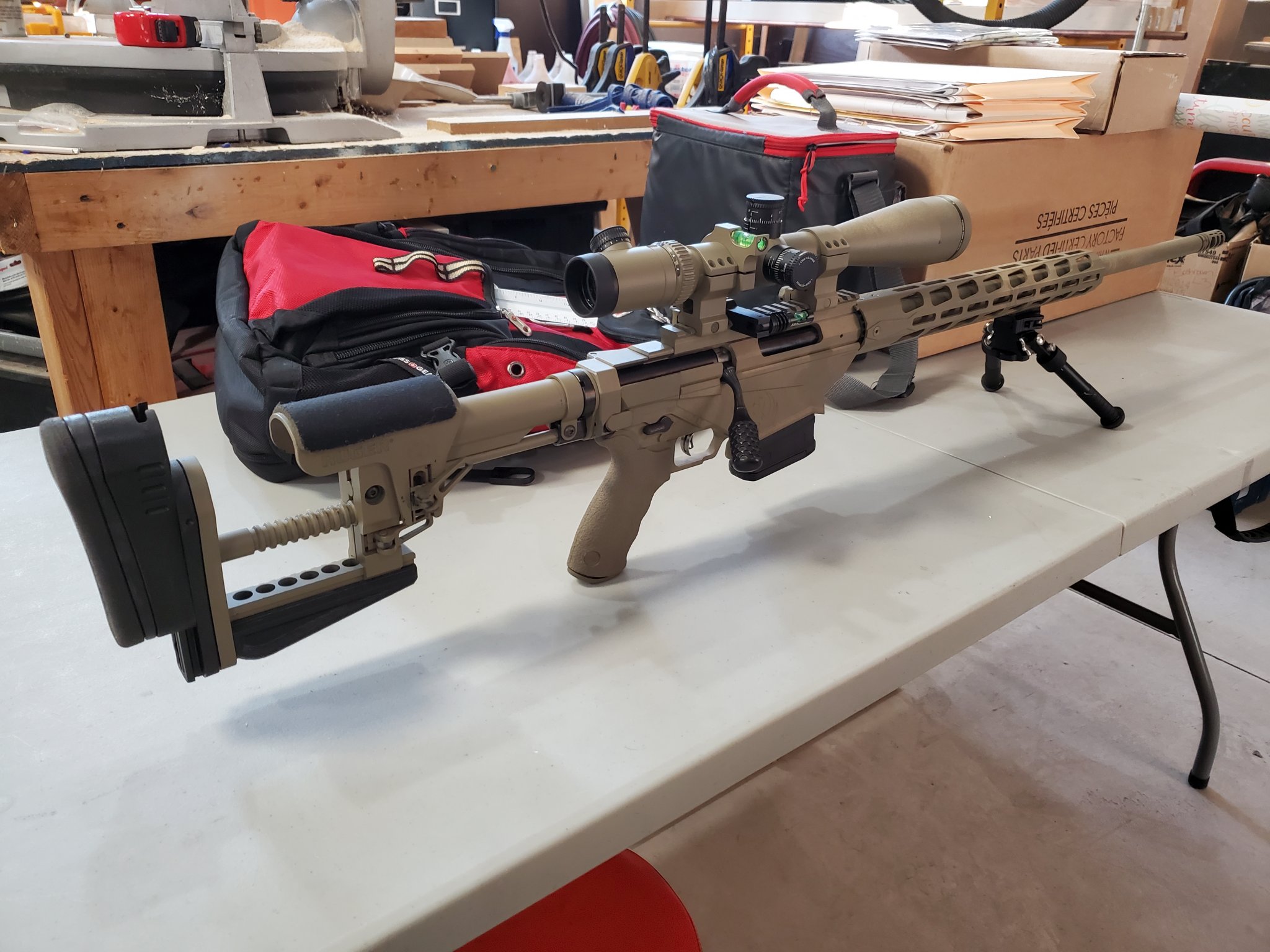

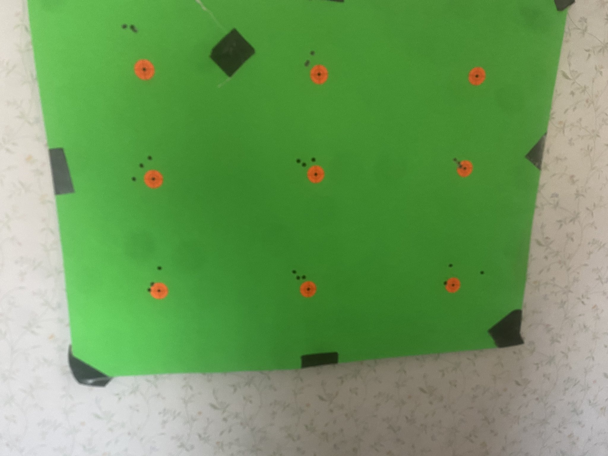

Setup a 6.5 creedmoor RPR with the help of some local guys and this was my first range trip trying to make a load for it. One group is right at .500”. Going to see if I can match it tonight and then work from there. 3 rd shot groups @ 100 yds.
What I feel is working good for now is:
.020” off the lands oal is 2.790”
43.0 gns of h4350
120 gn Barnes match burners
Hornady brass with cci 200 primers
Tightened up my groups a little last night, I think most of it is the shooter. I did also get some 130 gn Sierra Nevada TMK’s and some 140 gn match burners. Might make a few with 140 gn and see how the perform. Thanks for the advice!
