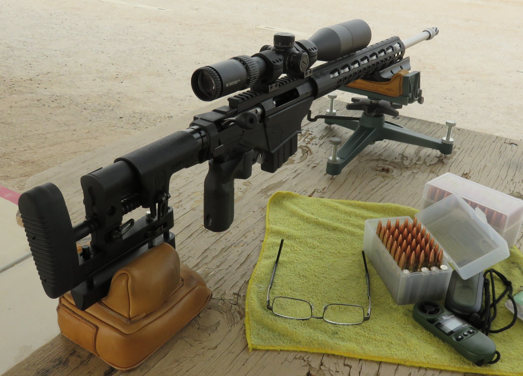

RPR .308 IN DA HOUSE!
Initial impressions -
1) The hand guard seems a little sharp on the edges. I was thinking of a verticle grip, but I could also use a bipod and shoot it seated and prone.
2) My top Rail is not as long (does not extend over the HG), but long enough to mount the scope.
3) I'll find out if my current HG allows me to mount a bipod.
Otherwise, all is well with it. I'm now looking at a bi-pod and the scope... maybe also the trigger. Then I'll be ready to zero it in... And I'll consider a JTAC membership at that time.
But we're on our way!

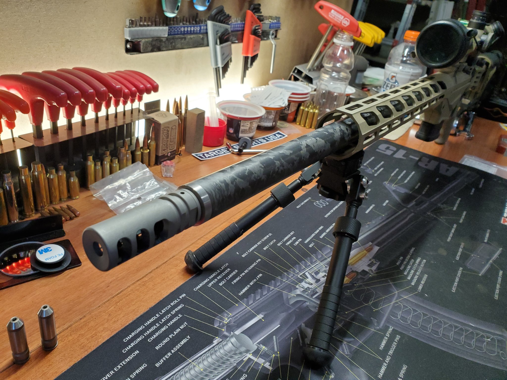

22 inch proof research carbon fiber barrel
Smoke composites carbon fiber handguard
Smoke composites carbon fiber grip
Smoke composites carbon fiber adjustable stock
Tier one evolution carbon fiber bipod
Black collar arms carbon fiber rings
Timmney trigger
Leupold lrp 8.5-25x50 scope
Area 419 Hellfire muzzle break
Anarchy outdoors gold fluted bolt shroud
Anarchy outdoors handle
Anarchy outdoors gold nob
Final total weight?
Interesting build. I am considering something somewhat similar.
How does she shoot?

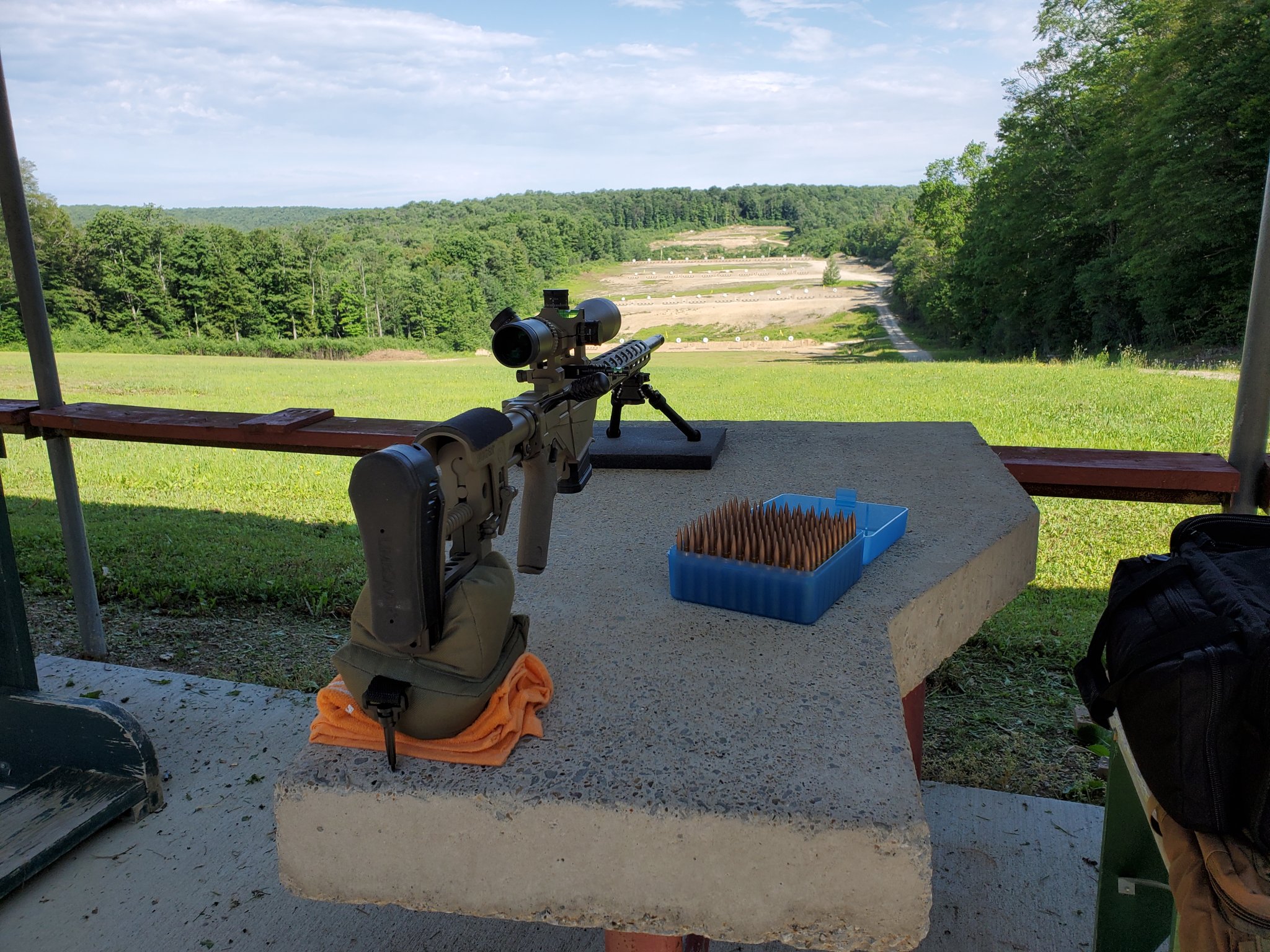

My .308 RPR likes 168 Sierra HPBT's so far. Haven't tried anything else yet for accuracy. I am not the best shot yet, I am learning to deal with
my natural body shakes, however, the RPR's are accurate. I have a Sightron SIII 8x32x56 with the MOA-2 reticle mounted on it.
I bought a 100 of the new 169 gr Sierras to try.
This is at 200 yards.

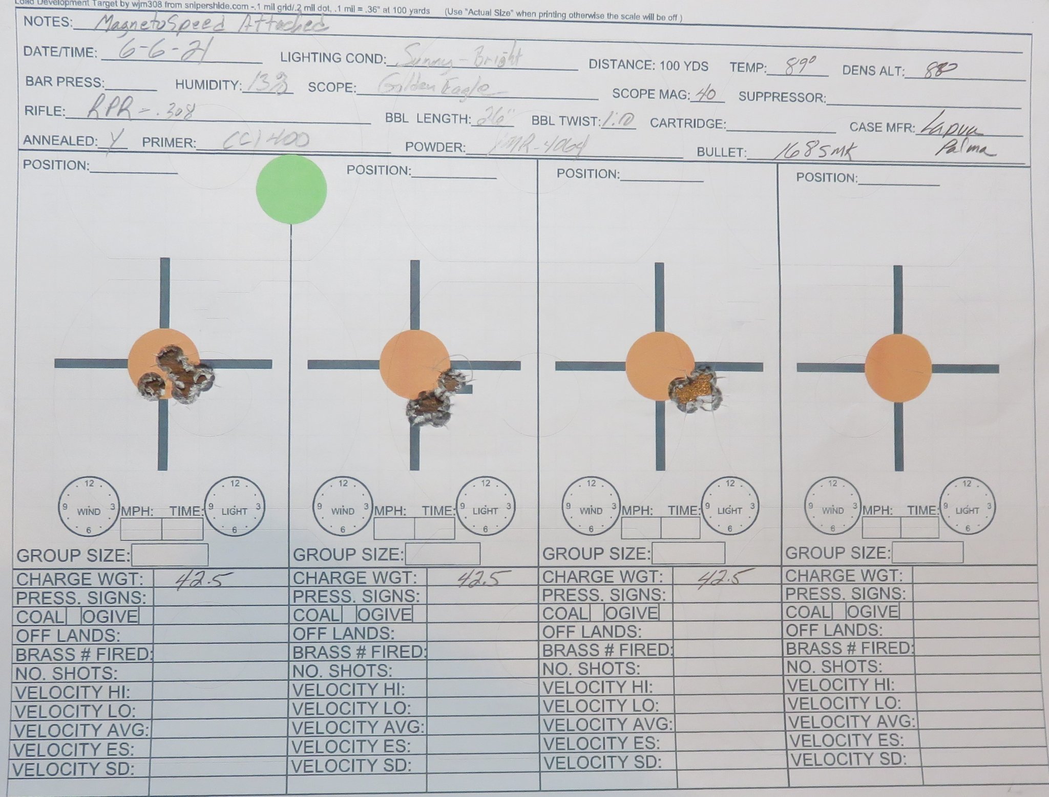

I'm so satisfied with my .308 RPR, I've just recently purchased a 6.5 PRC RPR. Now if I can only find some brass for it. ;)
That's very impressive. For the price, I really don't see a better option. I shot a few of them and I was surprised how nice the trigger was.
Apparently, a lot of people don't like that type of trigger. But I was very happy with mine. Even when I tried a Timney trigger, I didn't really find any difference, other than the feel of the blade and that's never bothered me at all. For my factory trigger, I did remove the trigger tension adjustment spring in order to get the pull down to 12-14 oz, which is where I like my triggers to be for my bolt guns.
BTW: When I bought my .308, I got if for $1,025 and my recent 6.5 PRC purchase for $1,050 (both being new). Got both of them from GunBroker.com where I got my .308 with no shipping, tax or credit card fee, but the 6.5 PRC purchase added all that winding up for a total of $1,220 out the door.
Note, that 1st Krieger barrel was the 24" with muzzle diameter of .750 and the new one that's on it now is the 26" .900 muzzle diameter one. If or when you contemplate a barrel upgrade for a RPR, I don't think you can go wrong with a Krieger barrel.

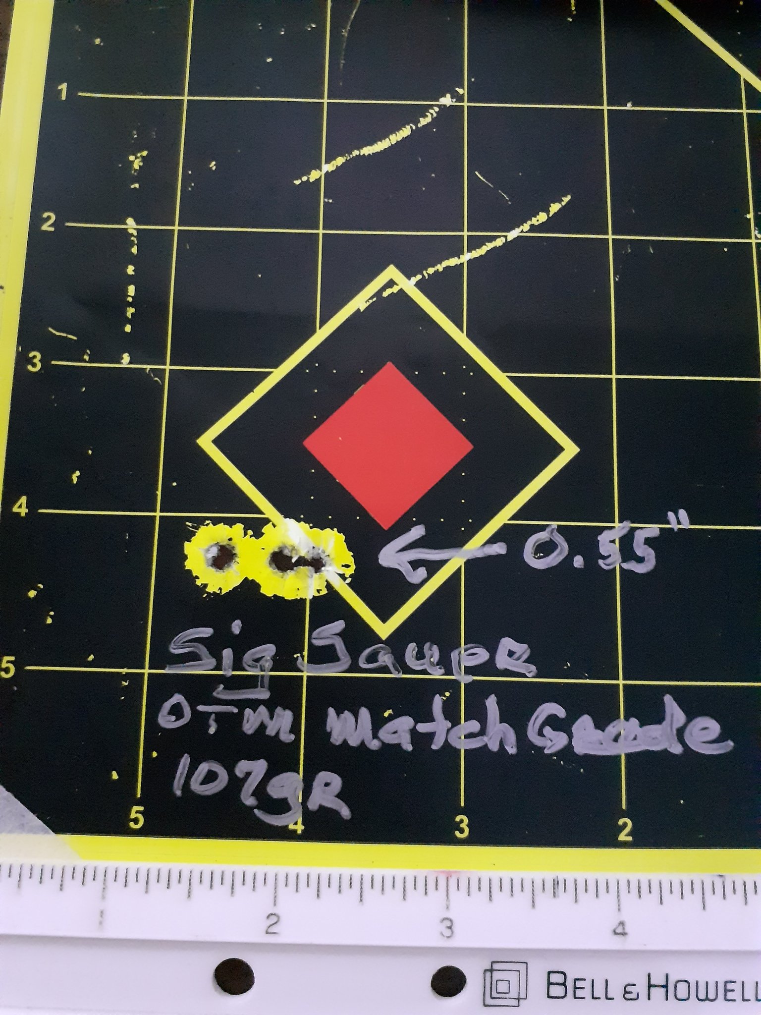

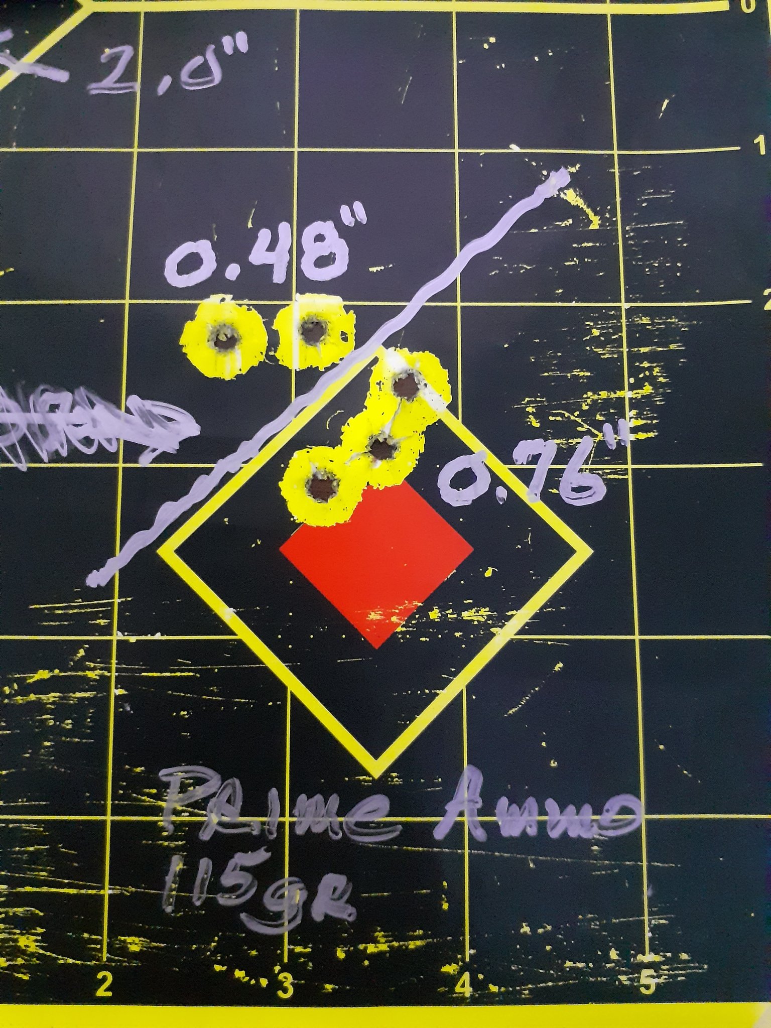

Got out to the range the other day, 6/13/21, and got to zero my scope finally after all the Covid BS shutdowns, using only every other point, etc, etc. here in New Mexico but here are a couple of pictures of my target. The 0.48" and the 0.76" were shot about ten minutes apart using Prime Ammo 115gr 6mm Creedmoor and the 0.55" was shot with Sig Sauer OTM Match Grade 107gr and this isn't too bad considering I'm getting started with this at 70yrs old! I have a RPR 3rd Gen 6mm Creedmoor with an adjustable bag rider and bag and just ordered a MPA vertical grip to try and improve my consistency with the trigger pull. Also have a Vortex Strike Eagle 5-25x scope.
