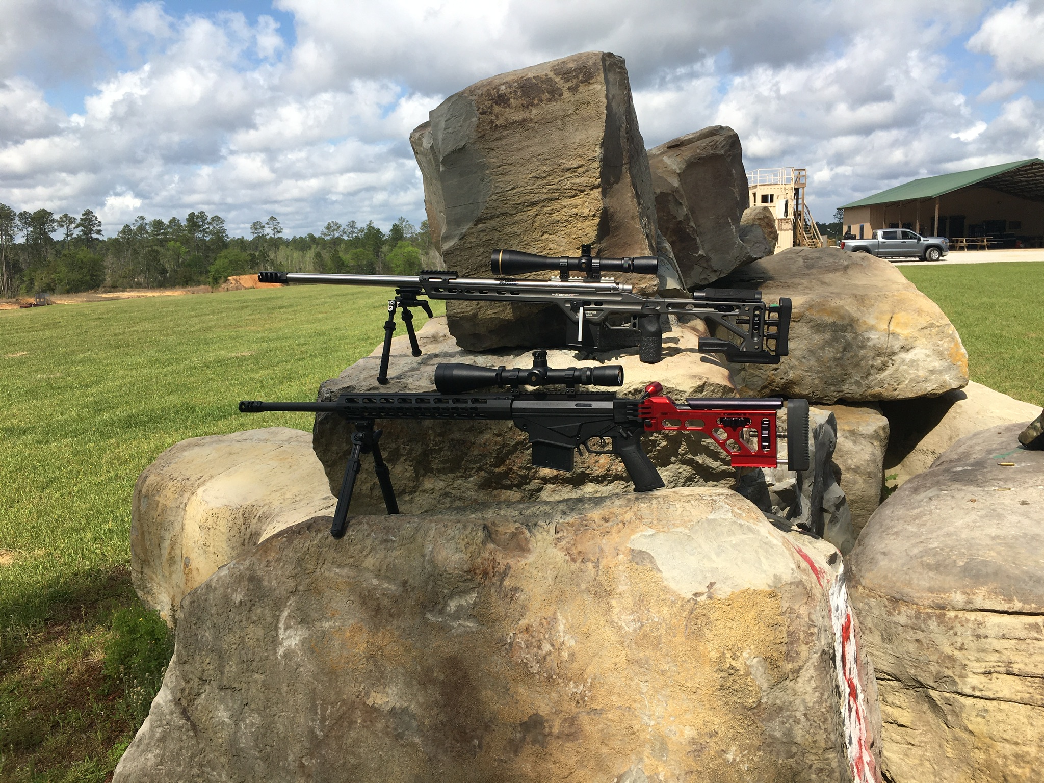

Nice gun, the fluting looks awesome.
The barrel on my RPR is pretty much shot out so I'm gonna be picking up an IBI - is that the heavier contour?

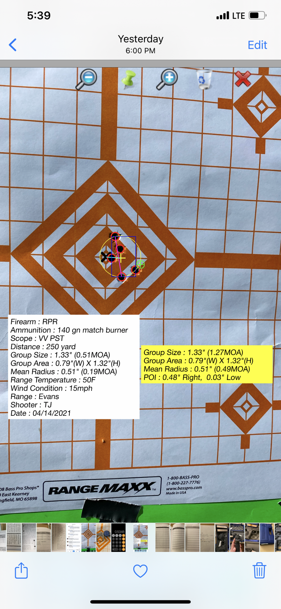

yes it is. shoots good still having a bit of trouble with load development. have been using 140gr eld match with h4350. but ran into trouble today with pressure issuses. so had to stop. was at 41gr of h4350 but now will have to start less and work up again
Went to the range after reassembly and ran some ladder loads at 100 and 250 yards. Let's just say I found one that should fit the bill quite nicely.

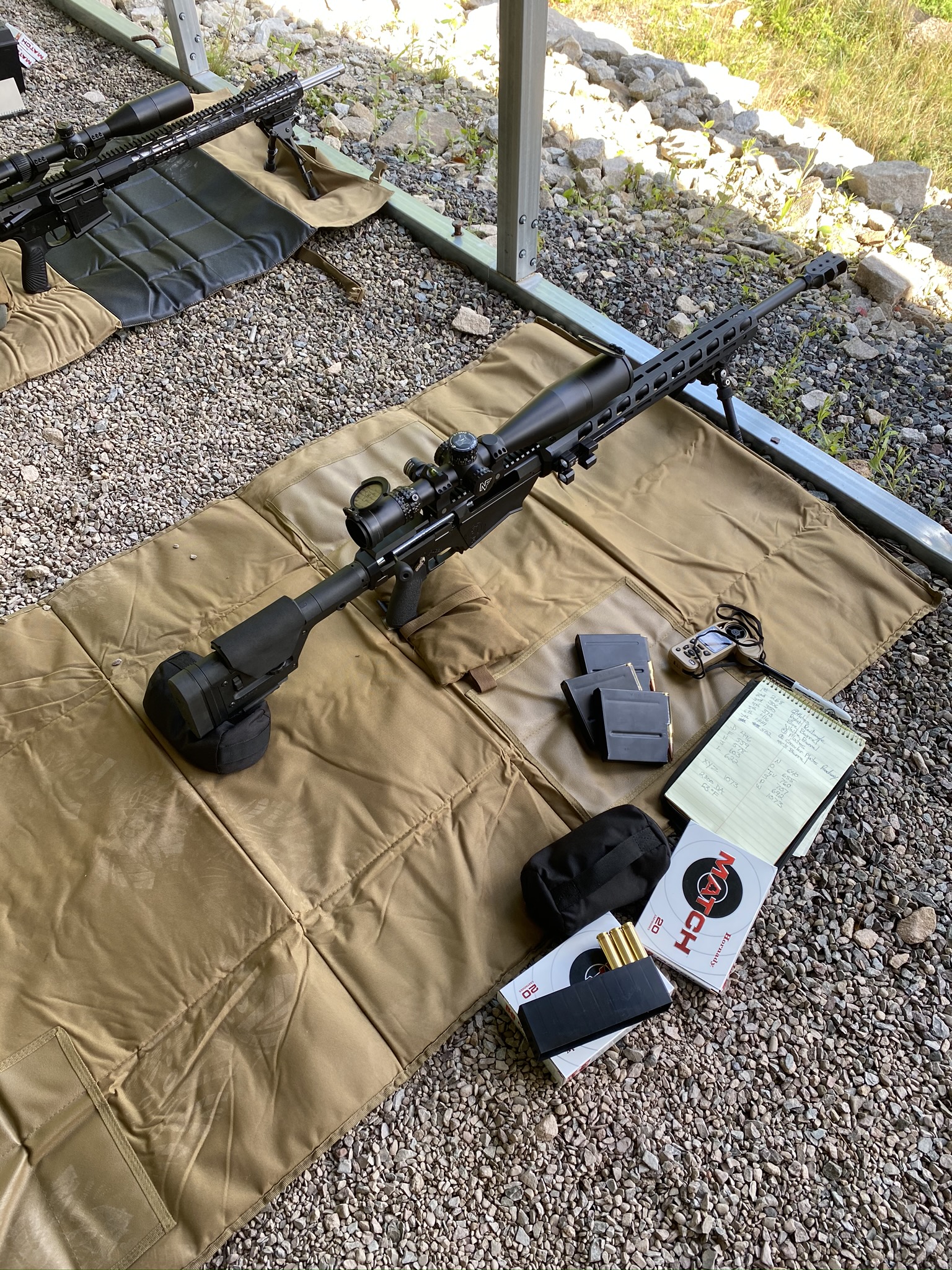

Tried the magazines used for the MPA Pro. Loded rounds from the magazine just fine but locked fully before getting to the rear when extracting a round. The bolt appeared to be catching the front of the magazine. dropped the magazine, empty case extracted and ejected just fine. This is not a problem using MDT AICS mags as they work fine. The MPA mags work flawlessly in the MPA so I suppose this is really a non issue. Do prefer the MDT mags over the plastic mags Ruger supplied but it is strictly an aesthetics issue as the Ruger mags worked without any problems.

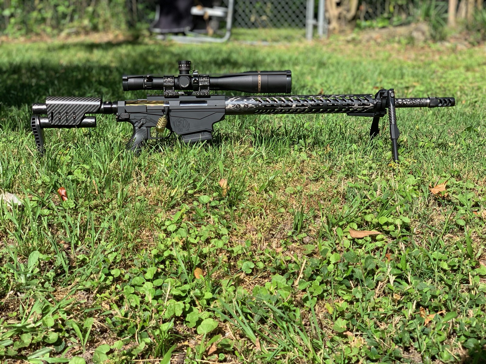

22 inch proof research carbon fiber barrel
Smoke composites carbon fiber handguard
Smoke composites carbon fiber grip
Smoke composites carbon fiber adjustable stock
Tier one evolution carbon fiber bipod
Black collar arms carbon fiber rings
Timmney trigger
Leupold lrp 8.5-25x50 scope
Area 419 Hellfire muzzle break
Anarchy outdoors gold fluted bolt shroud
Anarchy outdoors handle
Anarchy outdoors gold nob
Timmney trigger
Nice build; what caliber?
