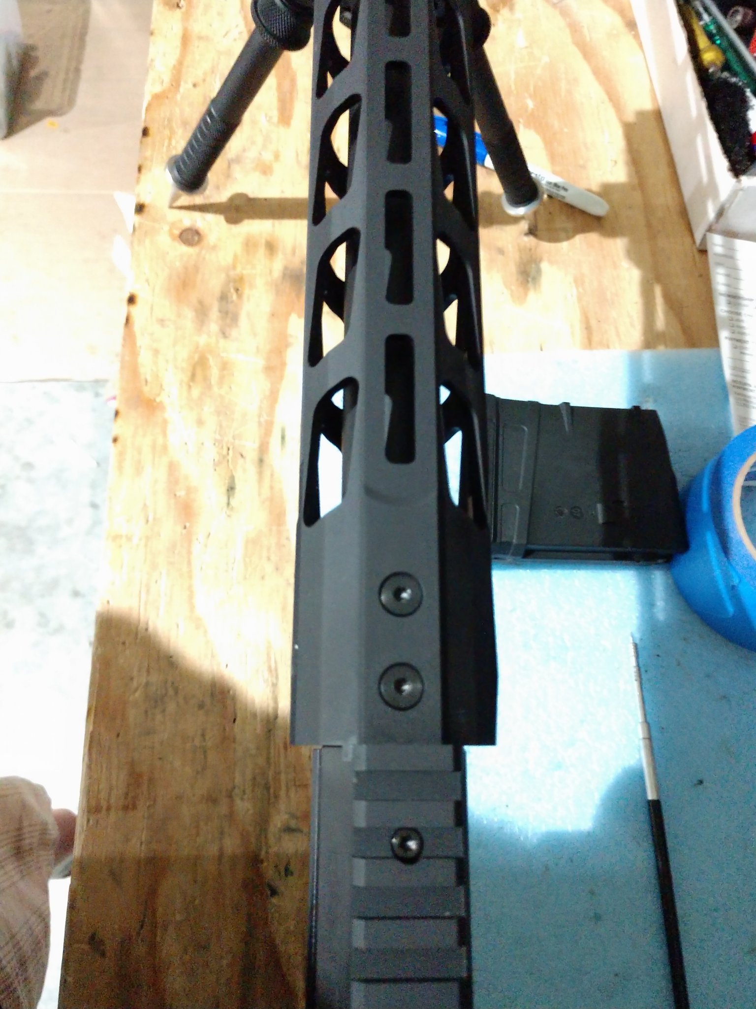

No, the new Gen 3 is a completely different handguard in all aspects.
I'll post some pics to enlighten tomorrow.

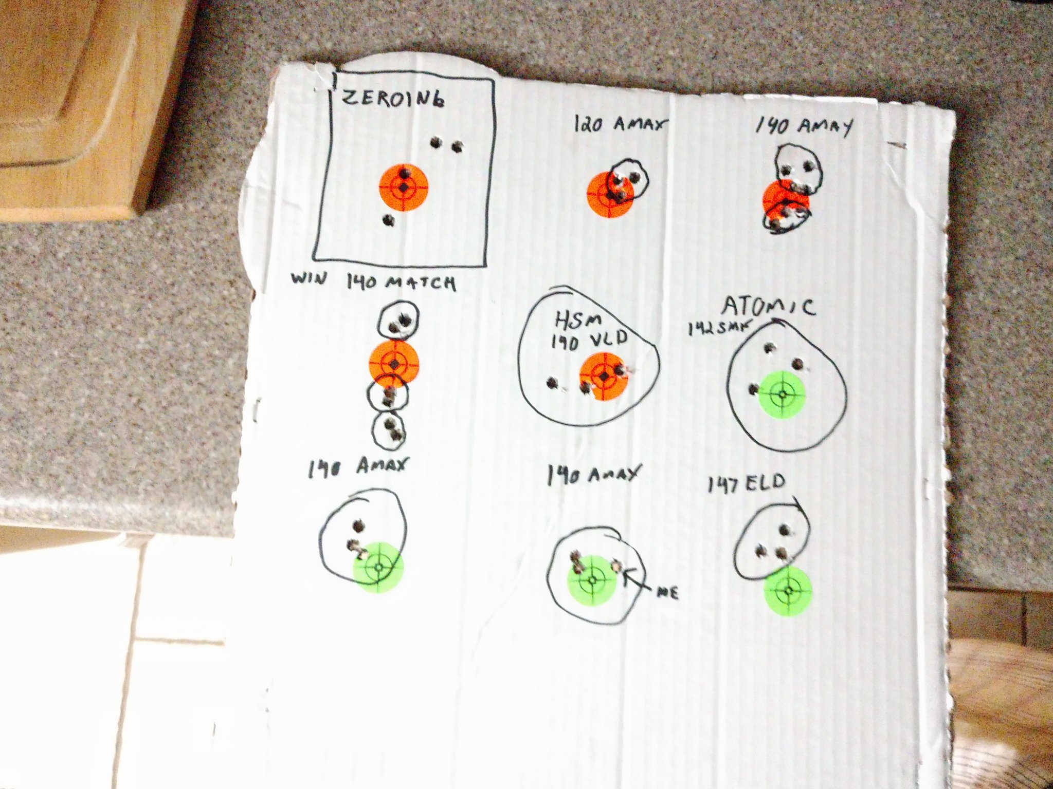

BTW, shot six different types of ammo and 3 out of the 6 shot .5-.25 MOA, I'll post pics of them as well. It really liked the Hornady 120gr Amax, and Winchester 140 Match

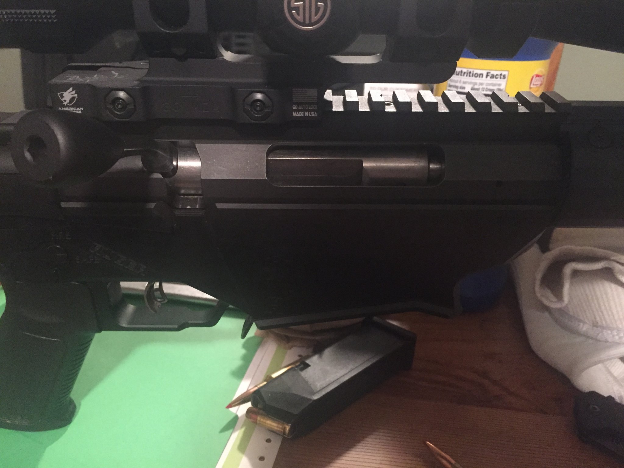

So I got my RPR rebarreled finally. It only took a torch; pb blaster; a vice a 3/4" wrench and 6' breaker bar; and the bench started to lift before the barrel broke free. After hradspacing it and getting it back together, I tried to chamber one of my old handloads. I think it’s safe to say my old barrel was.... well broken in, as this is as far as it would go.

No I couldn't find any in stock at my local stores, but will definitely get some when I see them in stock and I will be conducting another Range Report when I do, and take her to distance, especially since I know what to feed her now.
As you can see, it did not like the Atomic 142 SMK or the HSM with the 140 hunting Berger's. But damn it really likes the Winchester 140 Match Ammo. All of the are 3rd groups.
That's .25 MOA from the OEM Barrel!! That's pretty fucking awesome. And I'm sure once I get 100-200rds down range the barrel should settle in and tighten up some. If you notice in the pics I haven't even bothered to install the Timney Trigger yet, so thats a completely bone stock rifle, shooting Factory Ammo. The only parts I'm waiting on now is the MINOX ZP5 MR4 From CS Tactical.

Going to go ahead and say that the other two shots are me not the rifle/ammo. When I set the scope up I was kind of in a hurry and needs to be back a little and after some shooting I need to play with butt pad a bit. I def wasn’t 100% comfortable behind the gun and it still shot pretty damn good.

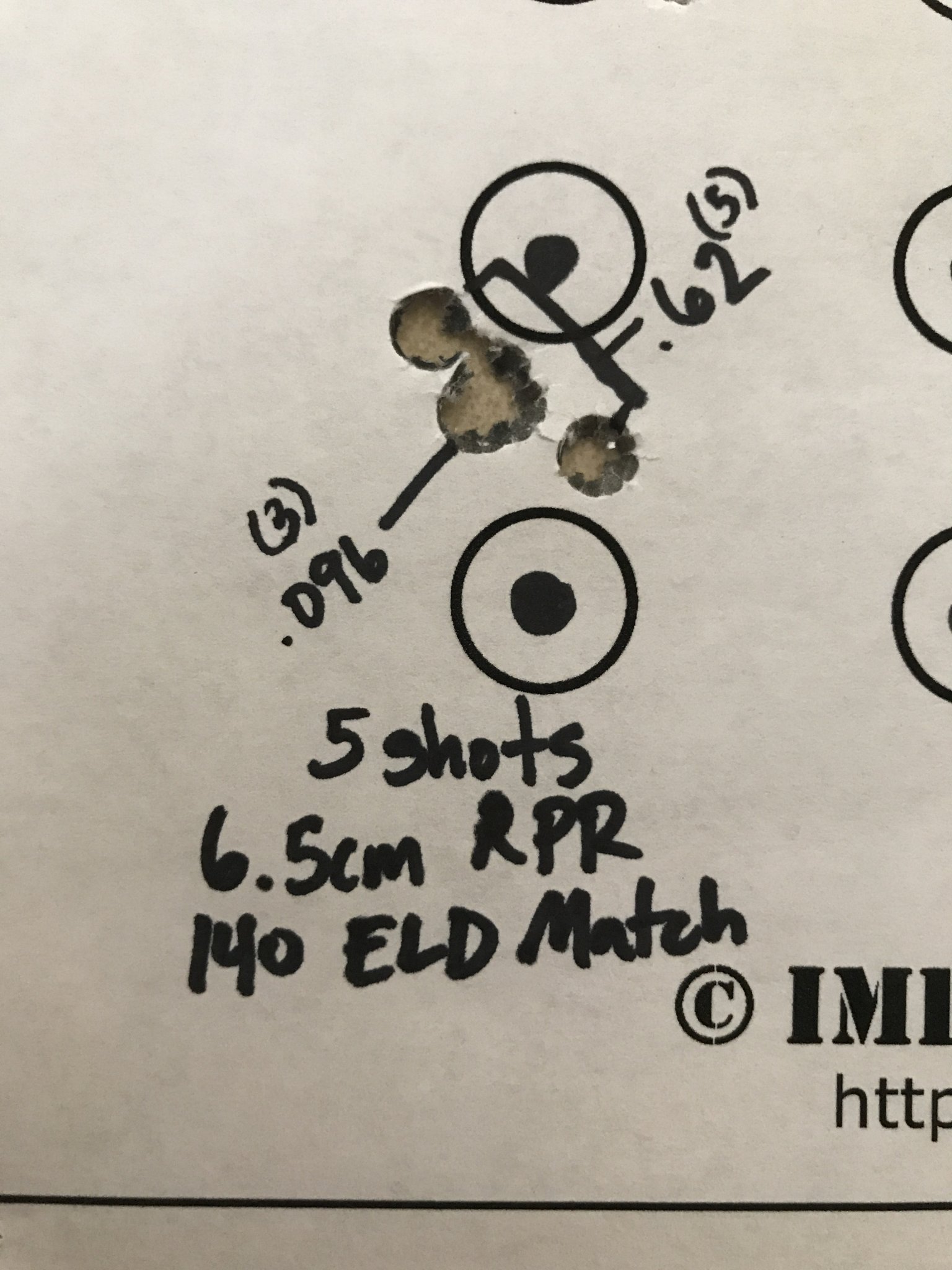

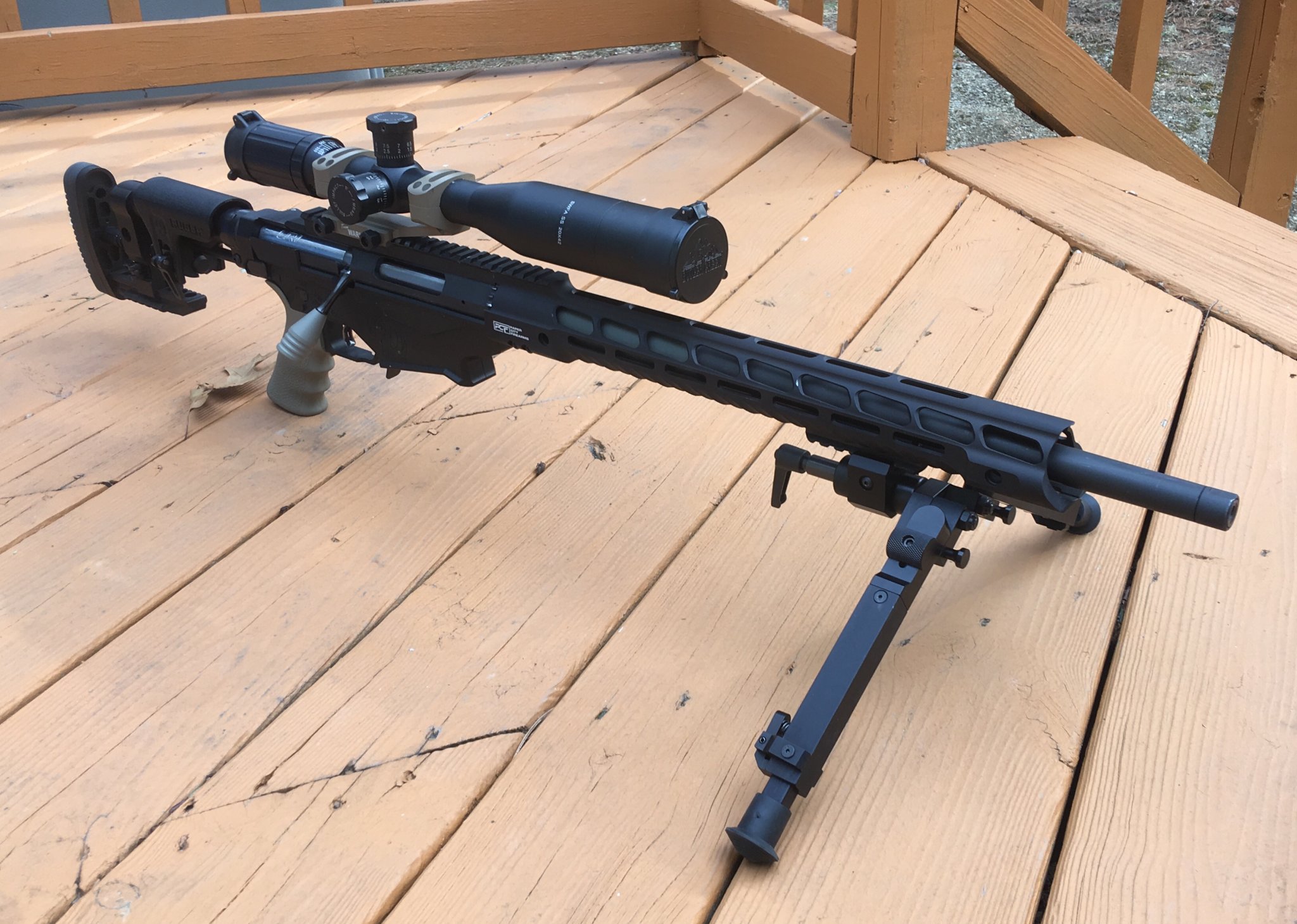

I’ll add my review of my new RPR a Barrett Brown 6.5. I added the new Nikon FX1000 and a Harris bipod.
If I do my part it can shoot. I used Hornady brass and 140 grain ELD with 40.9 grains of IMR4350.

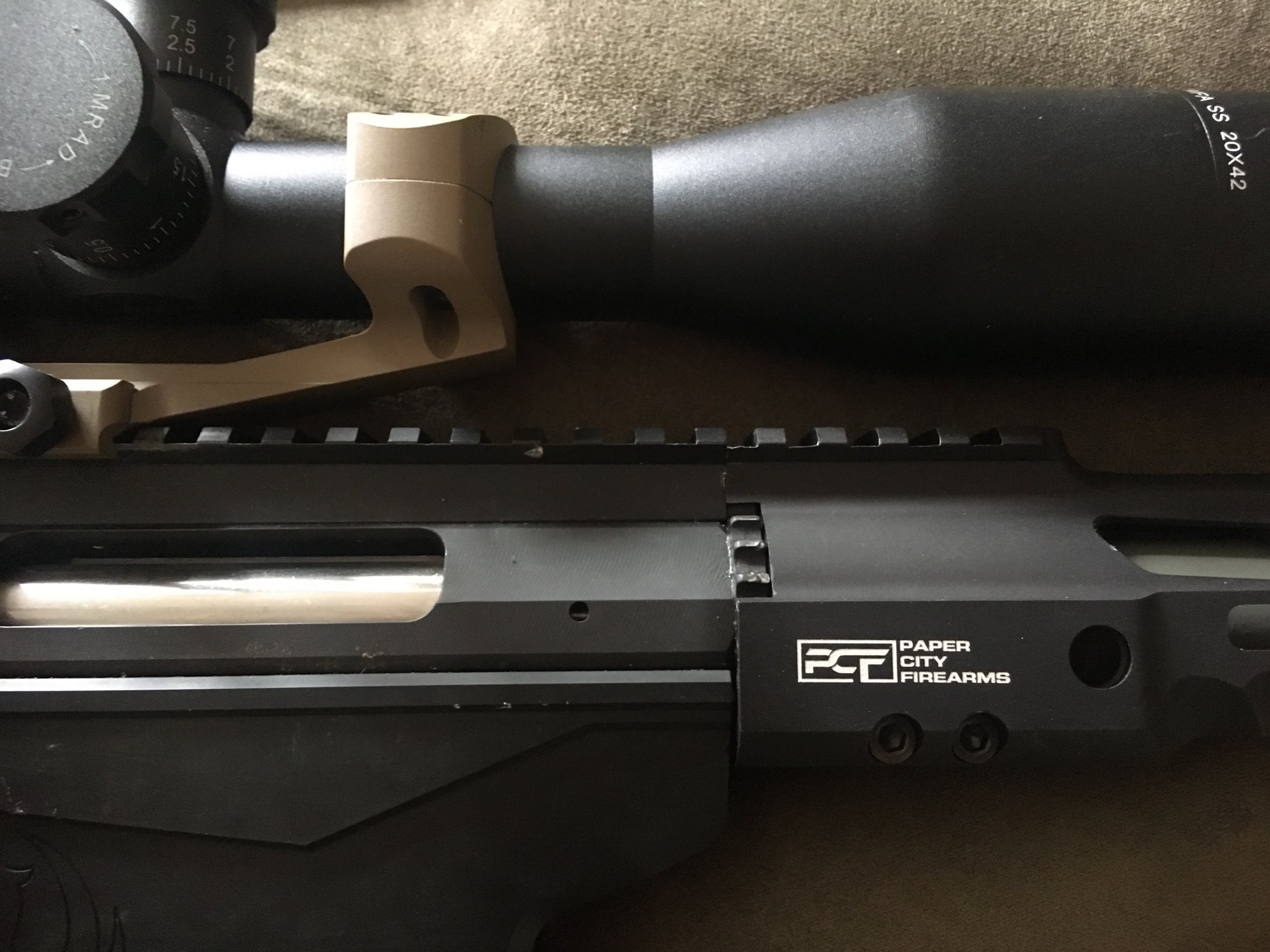

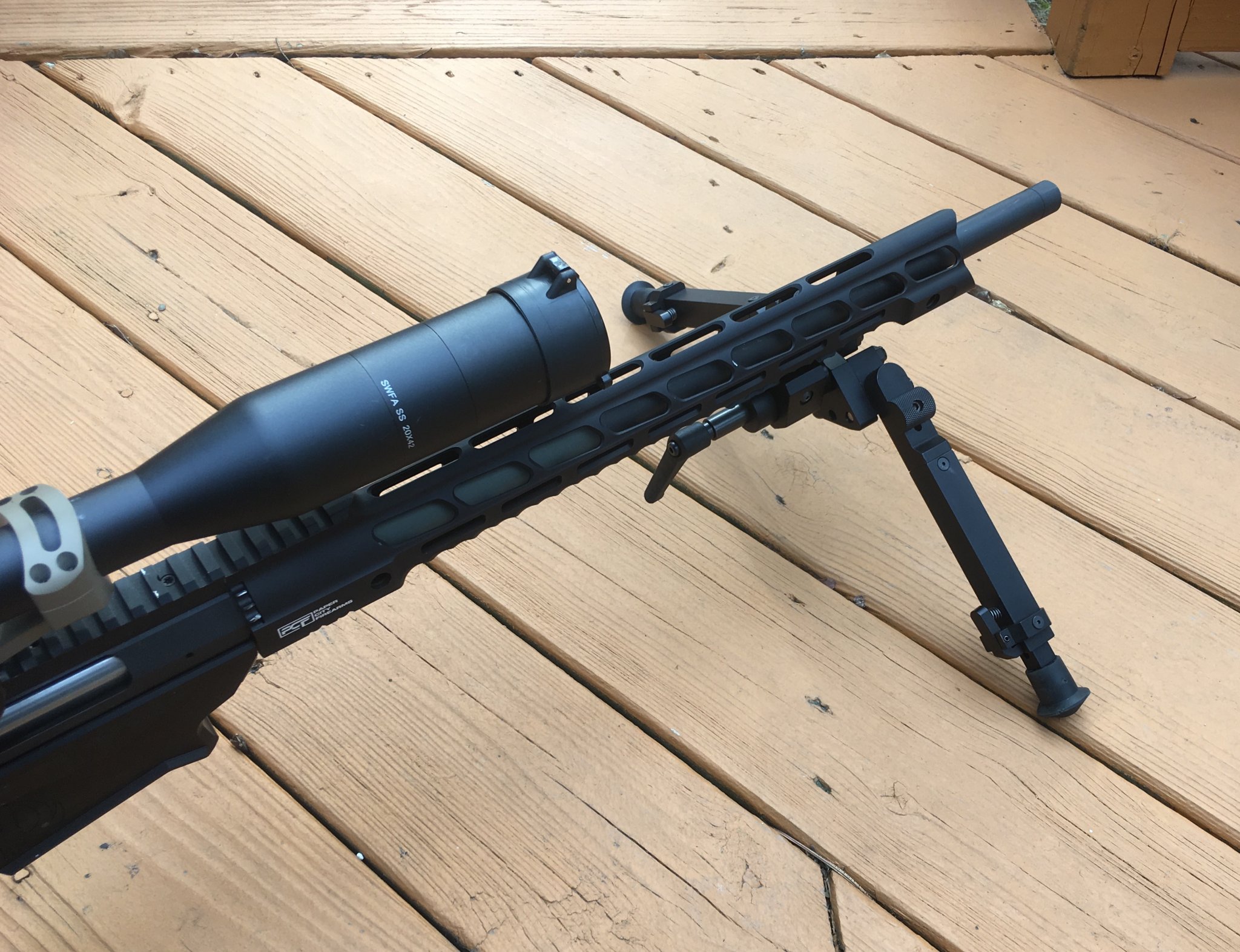

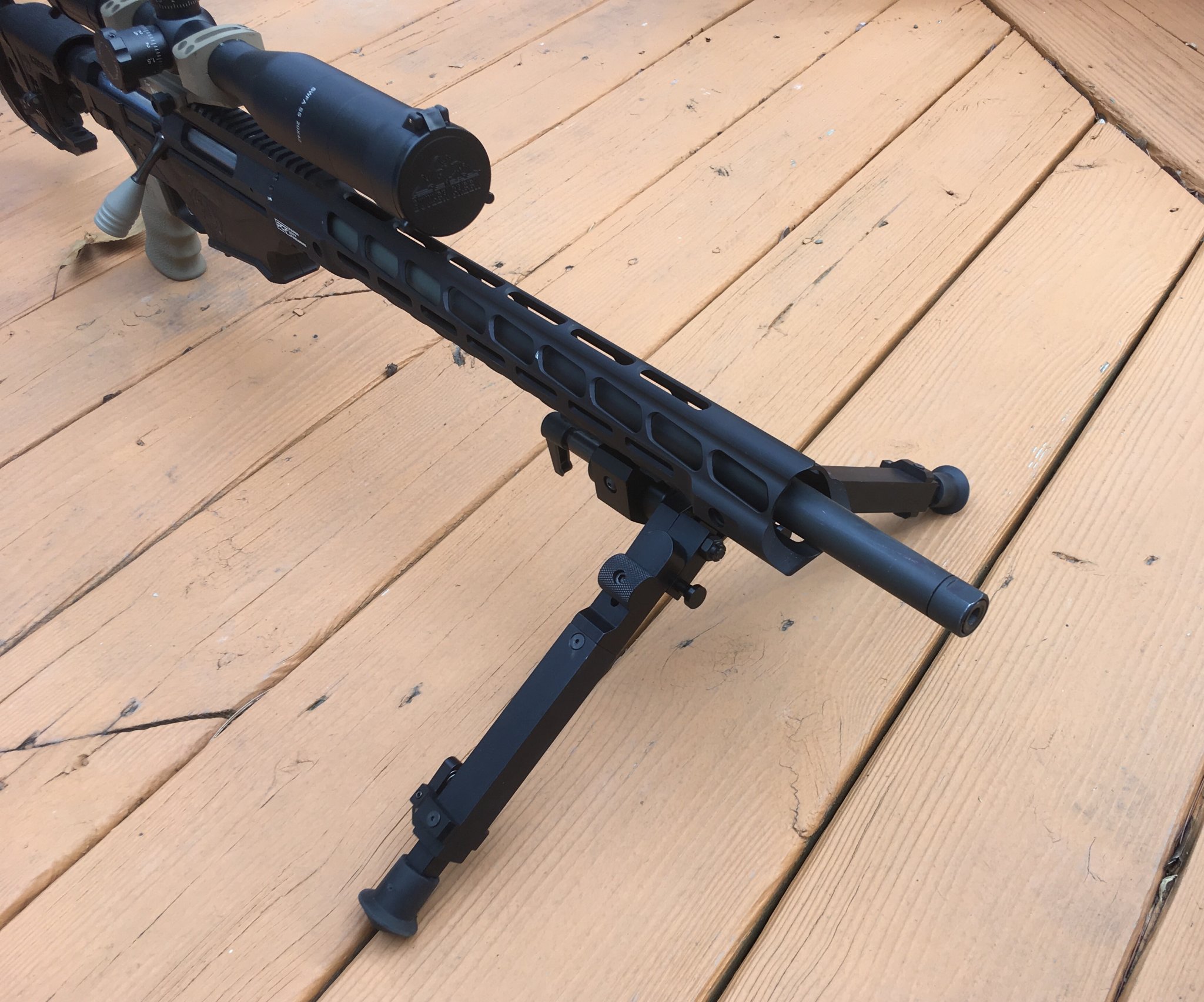

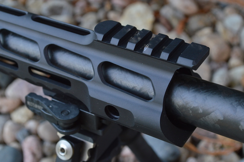

Received the Paper City handguard and installed it. Super easy. Their handguard nut just threads on to the barrel nut and doesn’t need to be timed at all. I’m very happy with the way it looks, and it seems like a high quality piece. Time to do a duracoat job on the barrel now...
View attachment 6893266View attachment 6893268View attachment 6893269View attachment 6893270
That’s looks pretty sharp. I really like the way that looks. I have my factory rail on still. But that has my interest
^ Thanks. I first saw it when that guy from Major Pandemic did an RPR build and used it. I think I took my factory guard off and installed this one in less than 5 minutes. If you go to papercityfirearms.net you can get it for $195 free shipping.
If you use an mlok rail and don’t already have one, you can get one from them or elsewhere. It doesn’t include the rail.
Reactions: CV_Ag
