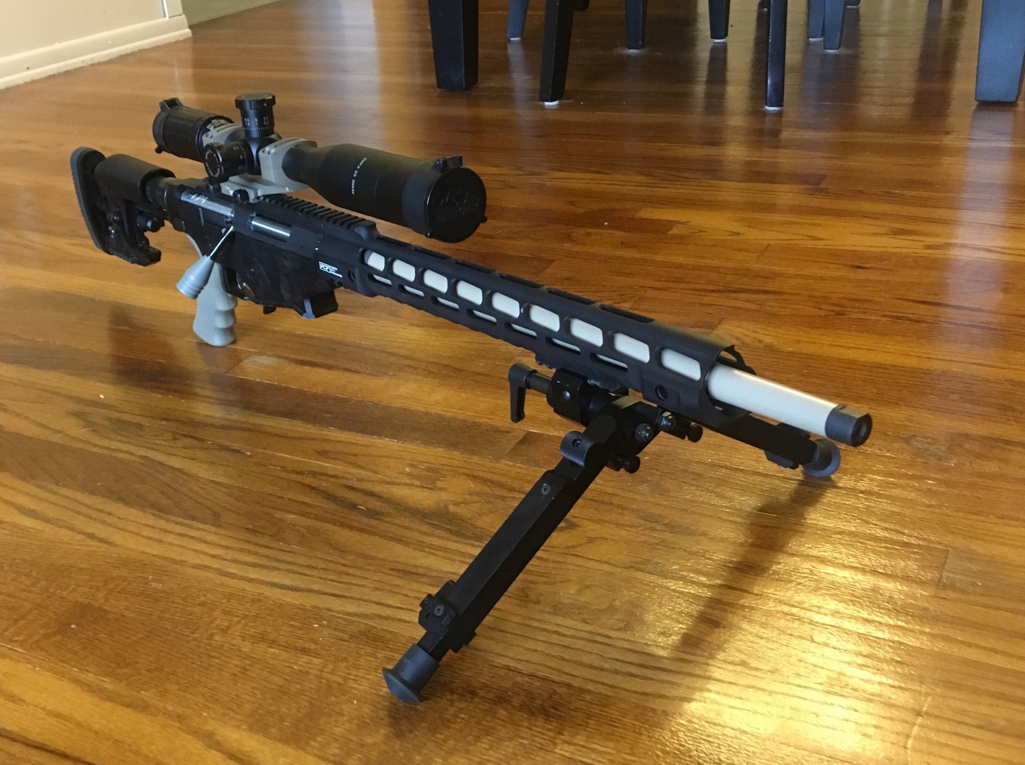

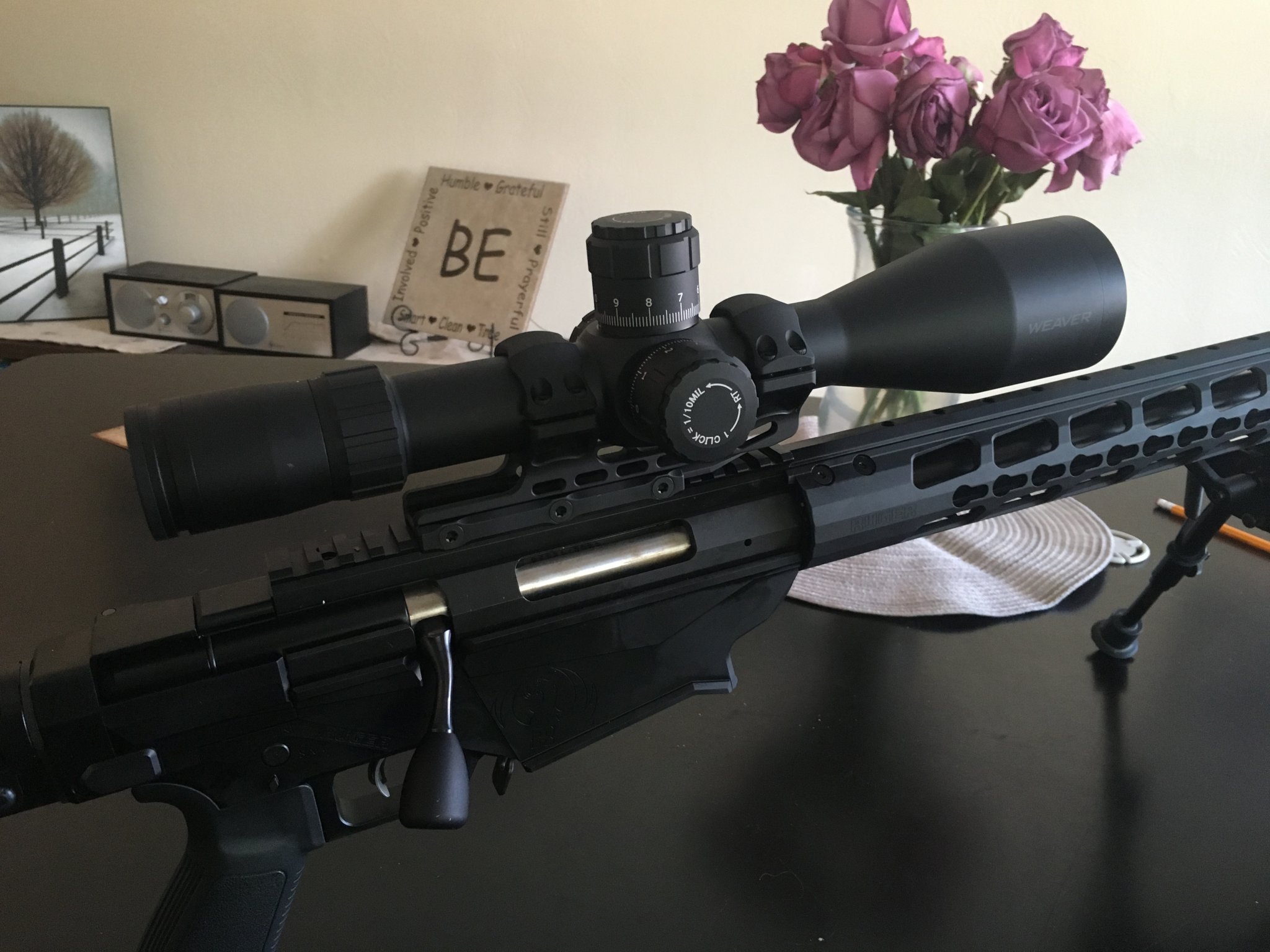

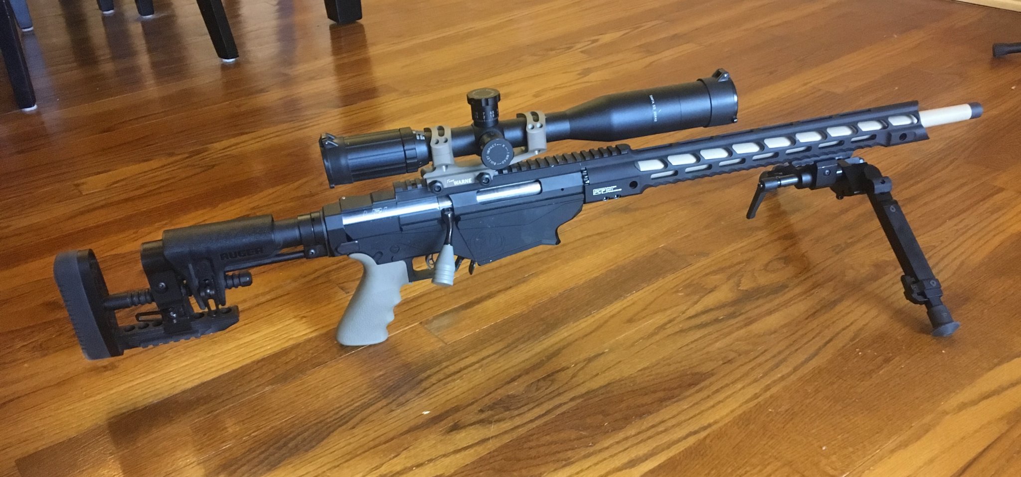

So you guys know, there is another barrel option out there. Kreiger is now making rpr drop in barrels. They are amazing. But the other option is what I just had done. I have the first gen 2 with a direct mount barrel like a Remington 700. Kreiger tossed the barrel nut and lapped the lugs. They said the less parts that can move the better. Even tho the group shown is from a Seb rest, I think it shoots pretty good with factory ammo
So there is NO barrel nut on your RPR, just a shouldered barrel that tightens against the receiver. Correct?
How is the barrel shroud mounded?
That is correct. By shroud, you mean handguard? If you were looking at the barrel from the side, there would be the threads that screw into the receiver, then from there, there is a set of threads that are bigger that are part of the barrel where the barrel nut would normally be. Does that make sense? Honestly, the machine work they did is amazing. The 2 sets of threads had to be timed perfectly or the hand guard would not fit right. I’m very impressed with their work

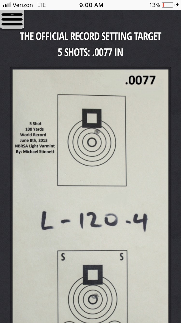

I talked to proof research at shot show, as cool as the CF are, it did not sound like it was quite as accurate as non CF. P.S. that’s why I shared about the direct thread, not many people know that’s an option. Tho, you will have to send your gun out to get that done. I feel it’s worth it tho
I don’t mean keep repeating myself, I believe kreiger is the best barrel out there. They hold the world record in benchrest for the tightest group. And the other top barrel manufacture (don’t want to name). We’re guys who learned from and worked at kreiger...... photo is the world record lol. I am a fan boy

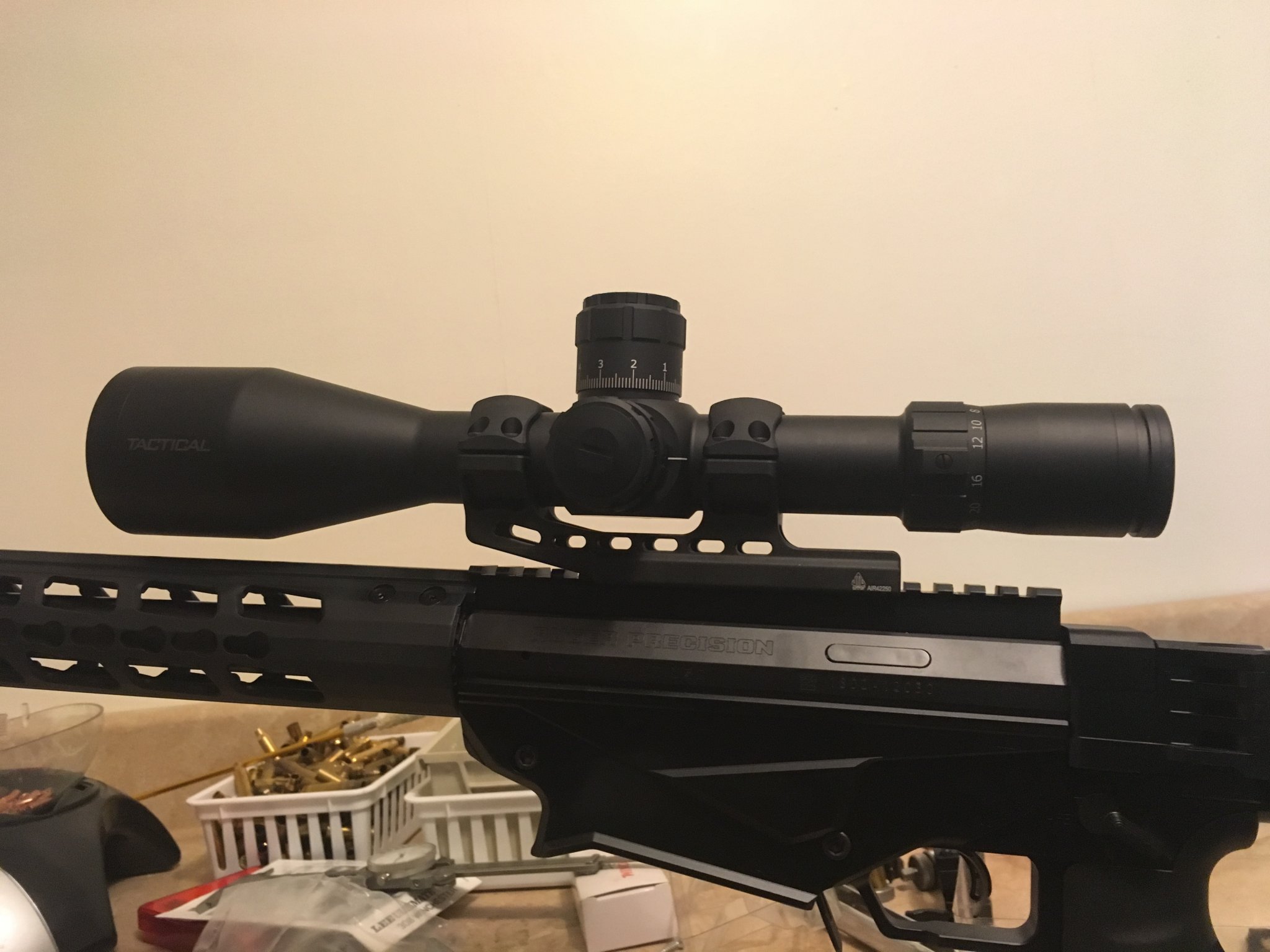

Anyone with a 56mm objective razr hd gen 2, what ring height are you running on your ruger precision?
I have a 56mm bell, not a razor though. I used 1.45”. I have a factory rail. If you have an aftermarket one with a continuous rail you’ll need 1.45” I believe. I have some clearance on mine, probably could’ve went with 1.25 or so but I got a deal on some Seekins rings so I’m happy with my setup.
I would recommend at least that size for any size objective. Barrel is inline with the stock like an AR. For comfort id recommend AR heightish rings on the RPR.
