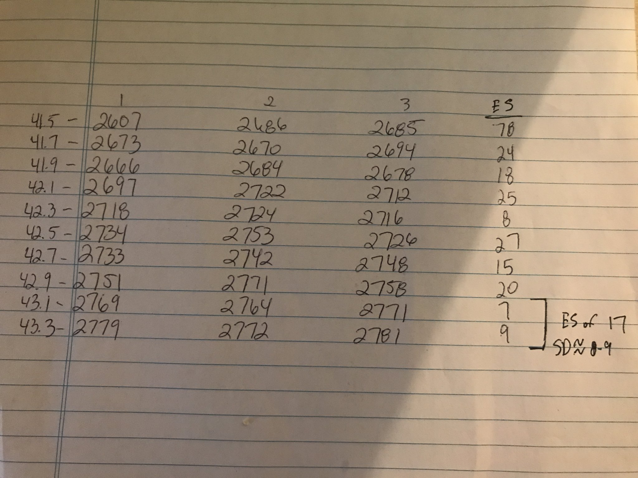

Went out and shot this earlier. Just shot 3 velocity ladders into the berm. Was in a hurry and didn’t really care about targets anyway. Basically doing my own blend of Scott Saterlee 10 round load devopment and OCW w/o targets lol. Just the numbers. Looks like my load should fall within 43-43.3 of H4350. I’m .020 off the lands with 140 ELDm’s.
Also the above ^ was done with Lapua Brass and CCI 450 primers with no pressure signs or primer cratering. One of the 43.3 loads might have shown the slightest sign of cratering but it doesn’t really concern me with the SR primer and a non bushed firing pin.
How many rounds do you have down the tube? With 43.2 grains I’m running 2840 FPS on an aftermarket barrel. With factory my nose was 43.0 at 2835fps. Seems as though yours is running a little slower?
Only 130 on this barrel. It is slower than I hoped. It shot factory 140 eld match lights out so it’s a shooter. I can live with it for now

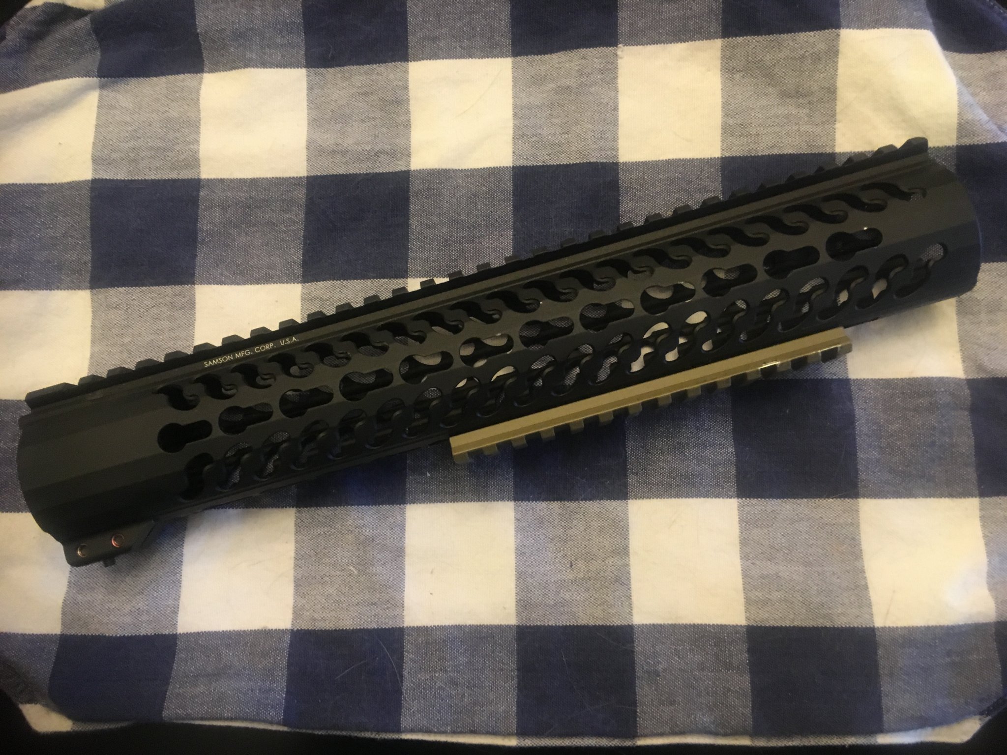

Hey guys. Just so you know, I have this up on eBay for $49.99. Of course I will sell it to someone here first. I don’t know if there’s a market for this or even what it goes for, but if someone’s looking for a gen 1 RPR .308 handguard including FDE pic rail and handguard nut/bushings, I’ve got one.

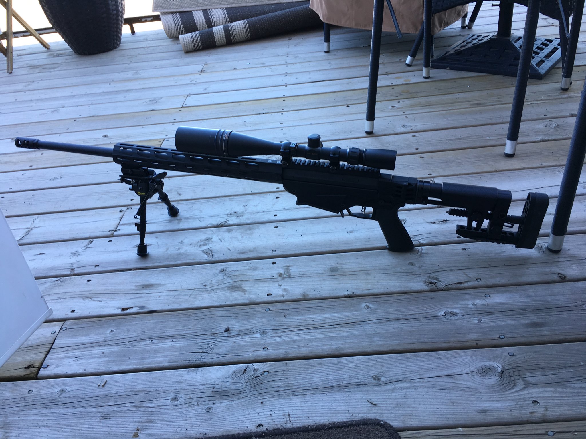

I just purchased a Gen 3 RPR :)
I attached a scope from another rifle on it - Sightron SII 6X24 42mm objective. I cannot find a way to adjust the stock so I can comfortably look through the scope. Scope seems too low as I cannot lower the cheek any more. However, it’s this low on my other rifle which is on a Hunter Magpul stock and it’s perfect.
Suggestions please? Thank you.

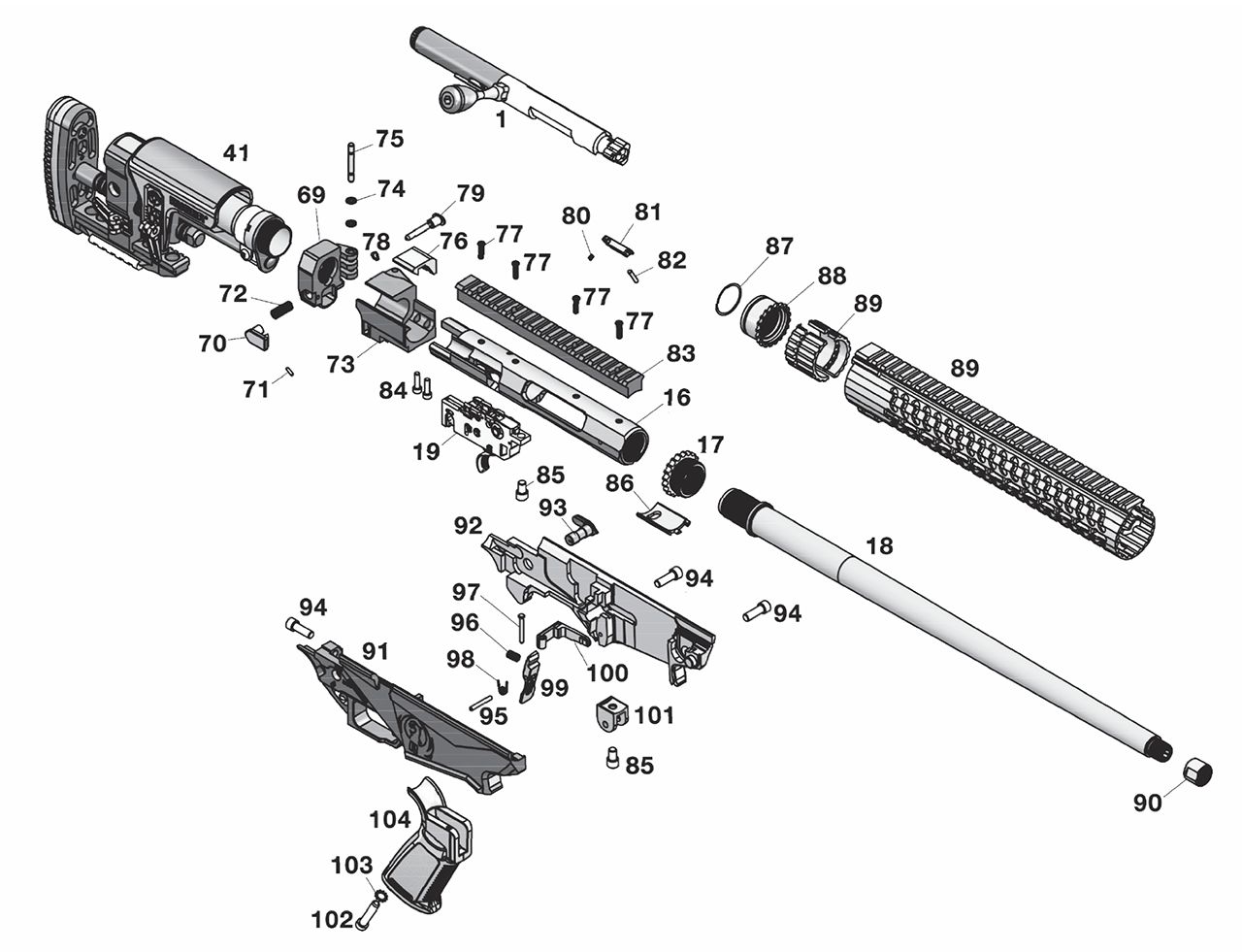

Yeah. So I spent a few minutes looking things over and I figured it out. It’s the small details.
I had reassembled the bolt incorrectly, specifically the firing pin. So I stripped it down and actually reset the pin by taking the little tool out and then resetting it and reassembling. Safety works now but I haven’t tried taking the lower off. I’ll do that in the morning. But I’m confident it will slip right off.
One thing I do note however is that not all RPR’s have a safety spring. It’s not even shown in the parts diagram you posted. I define do not want to separate the lower halves though because I really don’t want to rebuild the magazine release system. It’s just one of those things. I wasn’t paying close enough attention to what I was doing.
Get taller rings
When I changed my grip I thought it was weird too there’s no detent spring for the safety. Glad you figured it out!
Like tacticaldillhole said, get taller rings. Yes the newer handguard will allow you to use lower rings and clear the handguard. The stock being inline with the bolt/barrel, like an AR platform, to get comfortable you need ARish hight rings.

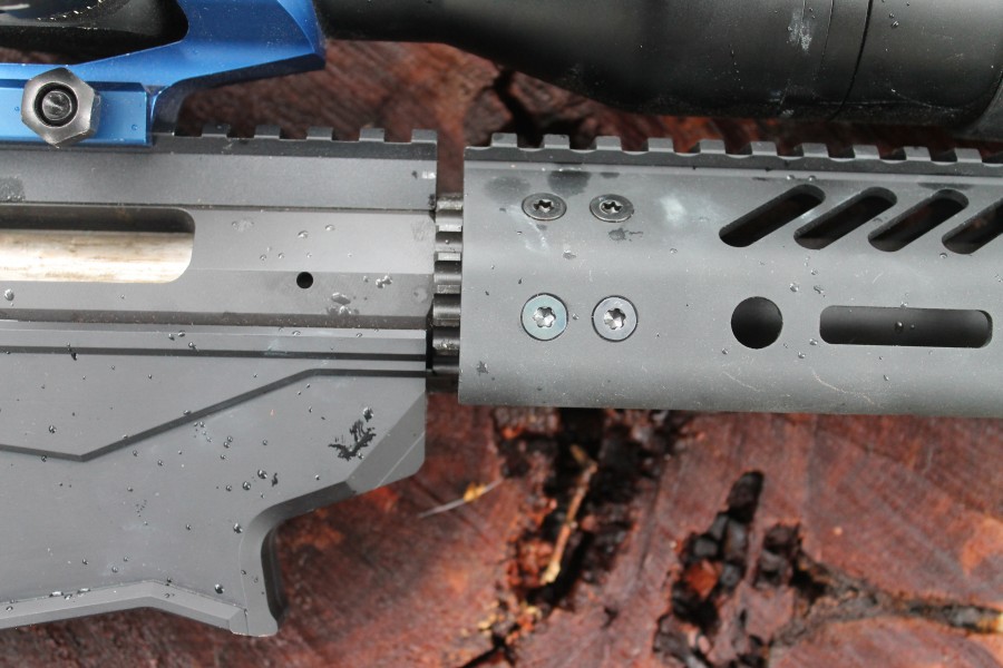

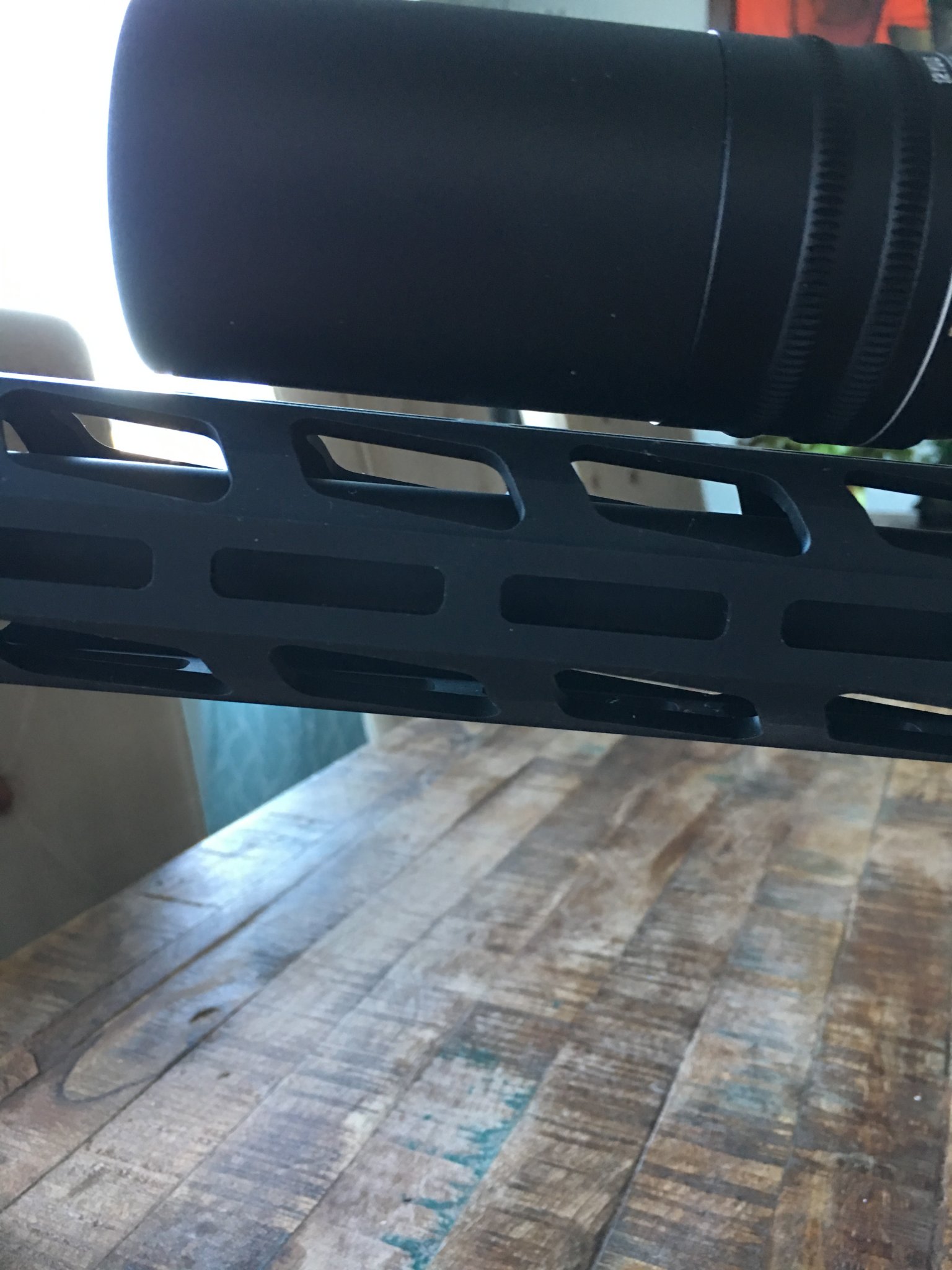

Howdy all, newbie here, been lurking and learning for a while. Picked up a new gen2 308 from Cabela's, couldn't get the keymod pic rail to fit the hand guard. The QD sling mount fits fine. The pic rail isn't machined right on the bottom where the nuts fit. The instruction book shows how to install it, but it shows to put the nuts in backwards from how the keymod drawings I found online show. I called Ruger, they sent me a replacement rail, but it's the same as the first one. The person I talked to at Ruger said that they were not aware of any problems. I couldn't find any mention of this looking at all 35 pages of this thread. I can't be the only one that has run into this issue. Anyone out there ever see this? I milled the slots in the bottom side of the rail so the nuts would slide far enough, now it fits fine. Is this why the gen3 went to m lock?
Reactions: Burnbio
^ Nice! I have my gen 1 in .308 as well. Soooooo many people have issues with their rail. I remember it was a bitch for me as well. I eventually got it, but I didn’t have the same handguard as you. The Paper City one is mlok and I have to say I like mlok a lot more. It’s quicker, easier and seems tighter. JMO
Weird. I never used the factory rail and used a alum BCM keymod rail chunk I had rolling around and slid right in. I’ll check the factory one and see if it fits tighter.
***factory rail did fit tighter on factory handguard and Seekins keymod, but still went on fine eventually***

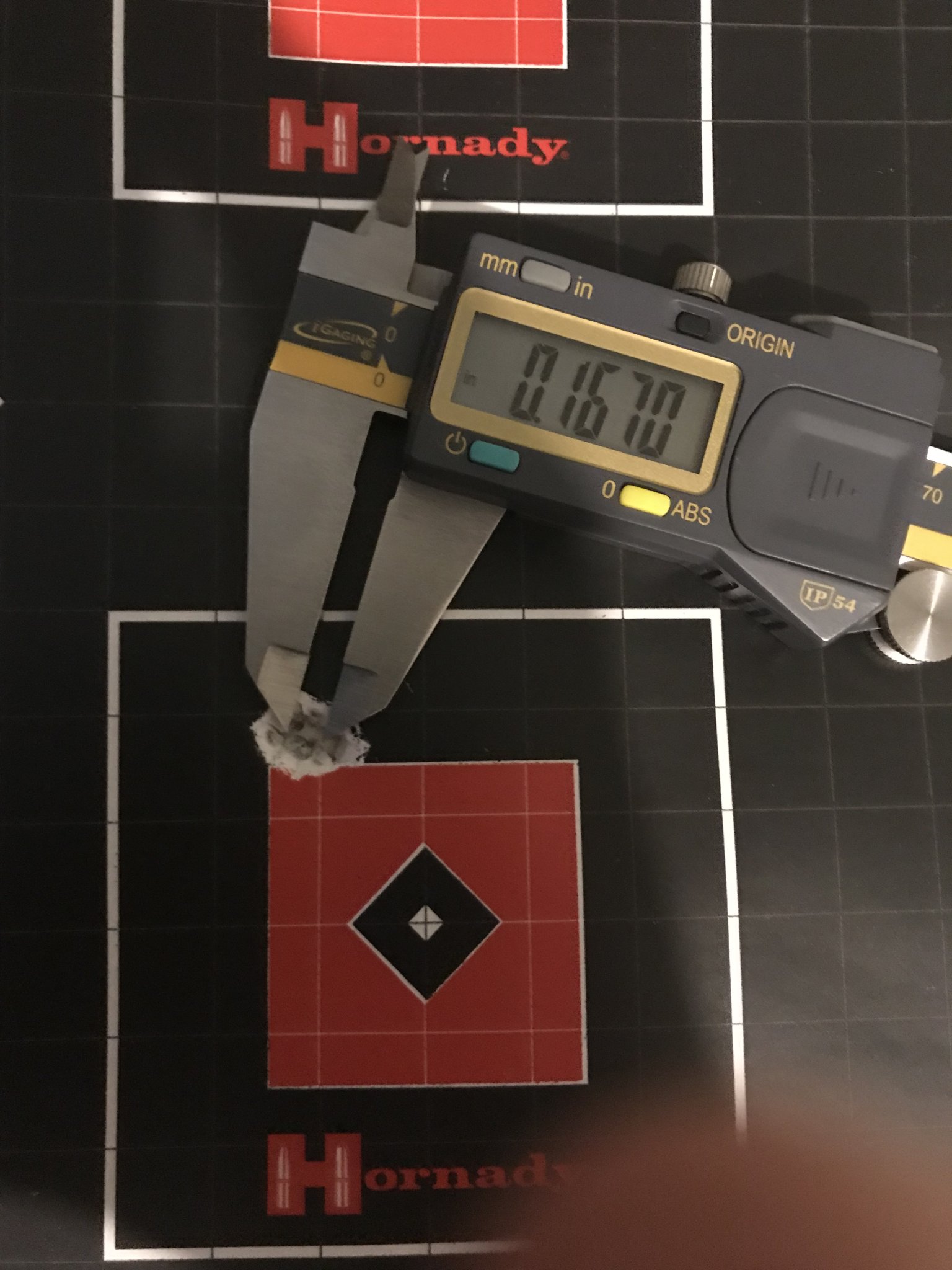

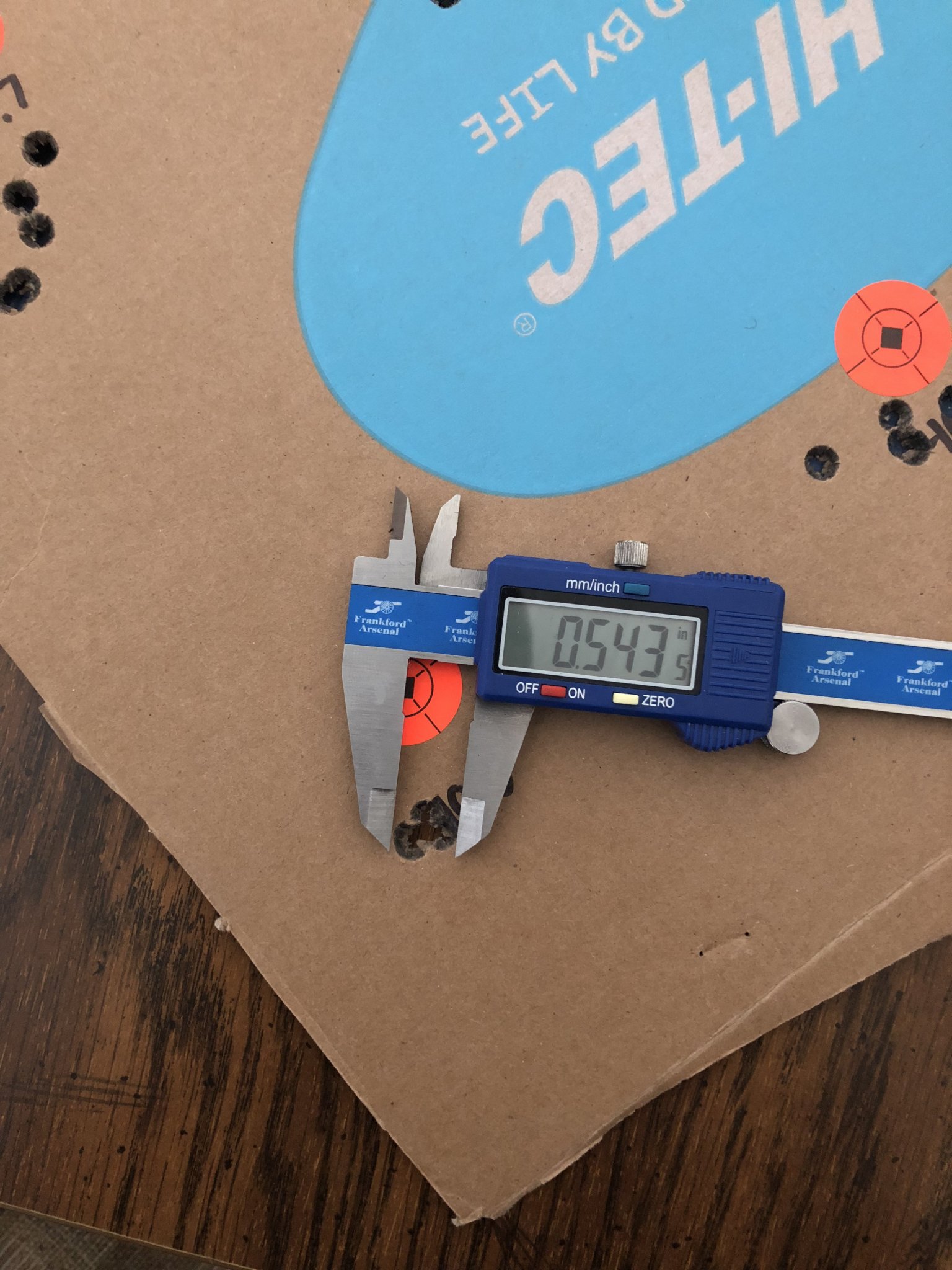

Ive got one in 308 that shoots good with my load.. all stock. Theres a couple rds that look like fliers, but they are from another shooter. Measured that top group out to out! The factory trigger aint bad...
Very nice group! Had similar 1/2 MOA results with a Hornady factory ammo this evening. New Gen 3 barrel doesn’t seem to be fouling with copper after the first 10 shots down the tube. Just need a good scope now!!

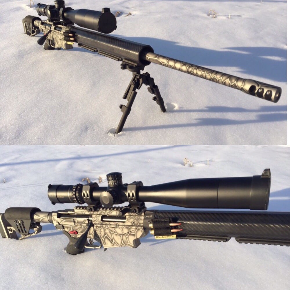

So you guys know, there is another barrel option out there. Kreiger is now making rpr drop in barrels. They are amazing. But the other option is what I just had done. I have the first gen 2 with a direct mount barrel like a Remington 700. Kreiger tossed the barrel nut and lapped the lugs. They said the less parts that can move the better. Even tho the group shown is from a Seb rest, I think it shoots pretty good with factory ammo

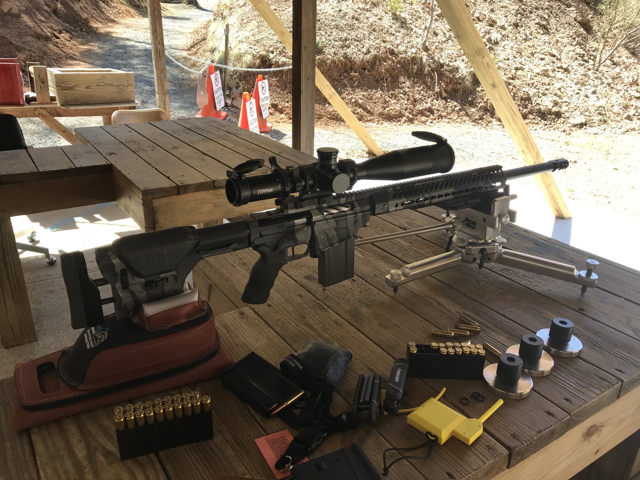

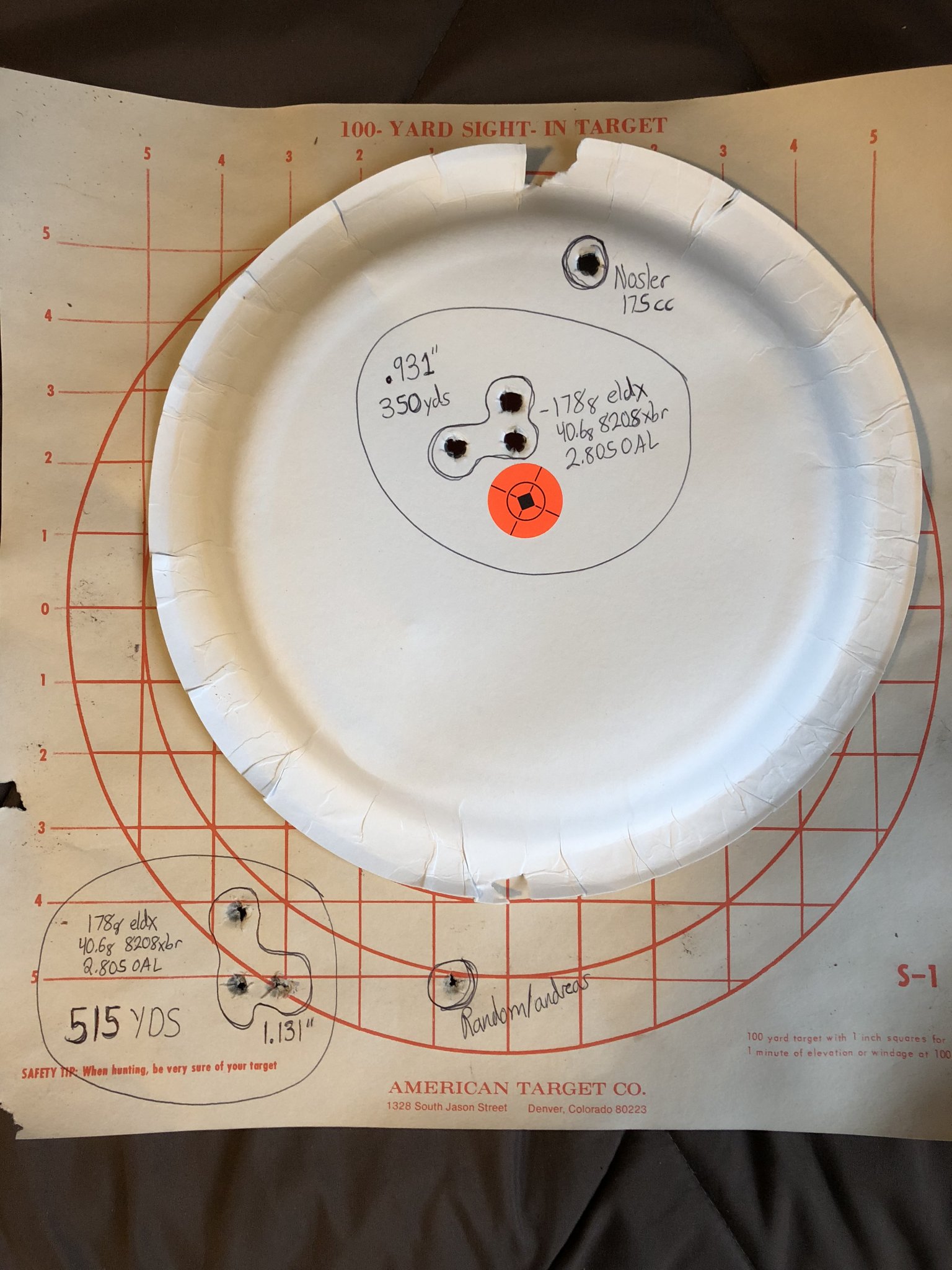

I managed to get out on Saturday and put about 70 rounds down range with my Gen II in 308. The first 50 were some light hand loads that I made up 3 or so years ago for a rifle I no longer own. They were 148 grain BTHP. I used them for bore sighting and the the rest just to do initial barrel break-in at the 50-yard mark. Then I opened up a little to 100 yards, and shot 20 rounds of PPU Match, 168gr ammo. What a smooth shooting rifle.
I also had an issue getting on the cheek rest due to the medium height rings (kept knocking my ear muffs off), but a position that worked pretty good.
the glass is the SWFA SS3-15X42 FFP that I picked up from the recent "Tax Day" sale at SWFA. Excellent glass, loved the function and clarity.
