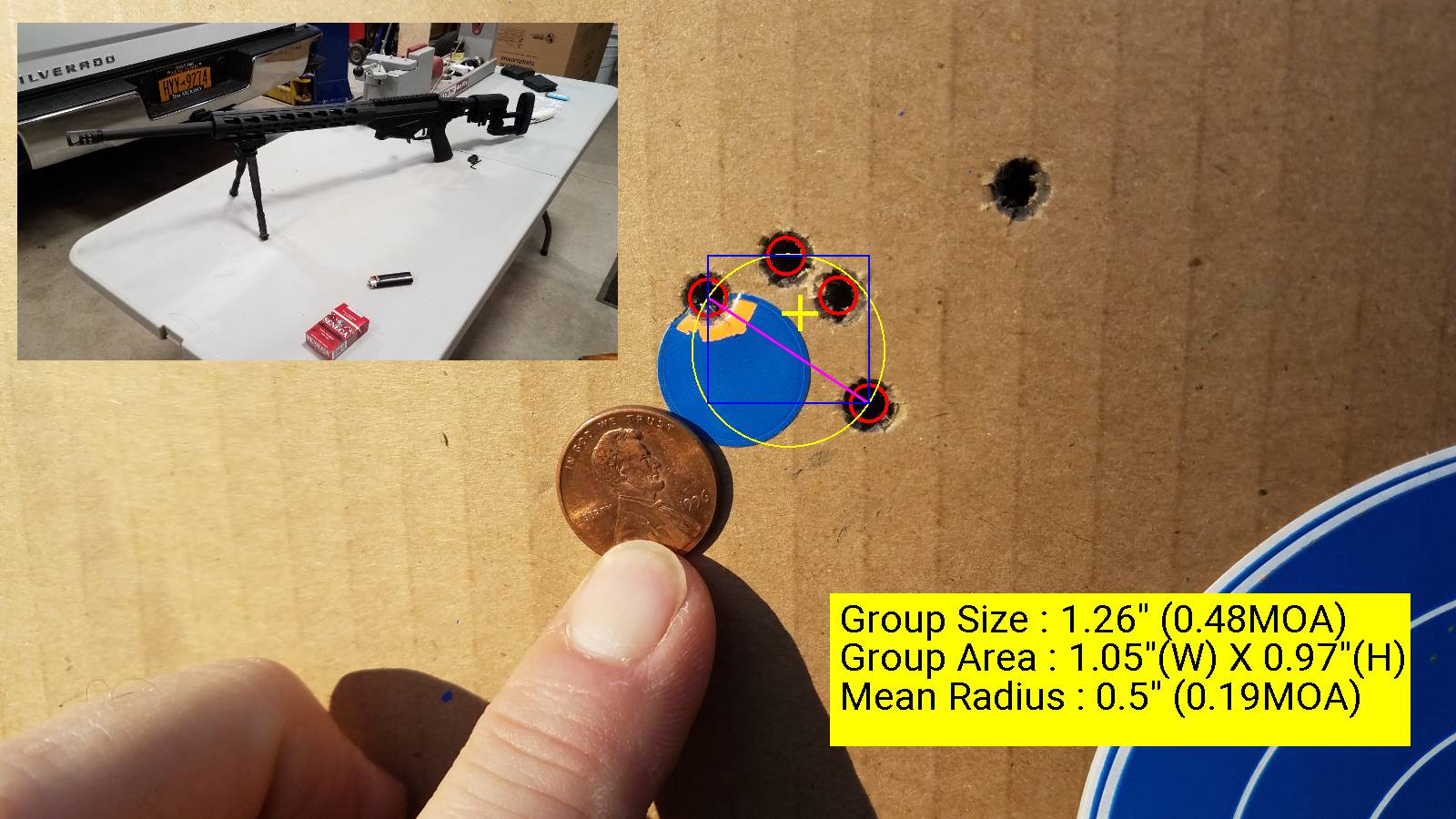

My 6mm was my first "big money" gun to date. I dont have a ton of disposable income and things are tight but my good friend has one in 6.5 Creed and I shot it a couple times. I liked it. Mine could shoot some pretty solid groups.
This was one at 250 yards....
Only ran Hornady match 108's through it. I did find out I had an issue (no freebore) and it was sent back to Ruger.
For reasons beyond my understanding (I have my suspiscions) they couldnt make it right. I'm thoroughly pleased with how they handled the solution.
In a week or so I should be into the replacement and hope to have all the hand loads I want ready for testing. I wasnt set up for hand loads when I had the first one.
Can "better" rifles be had than this? Surely. This was, as it is for many, a lower cost start to play the game.

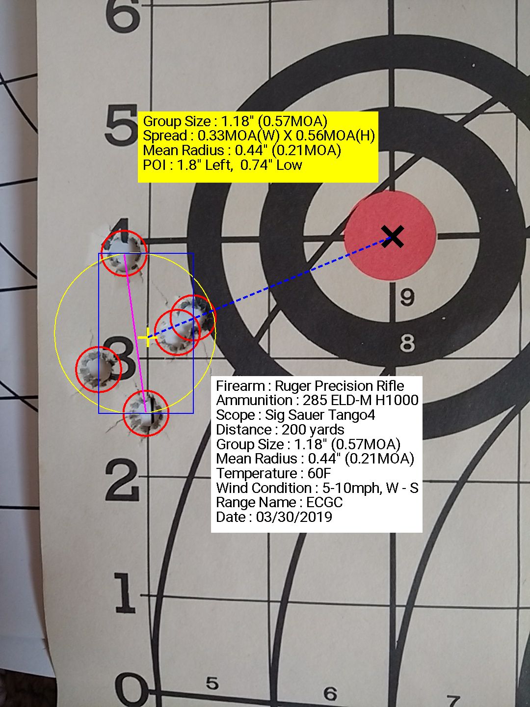

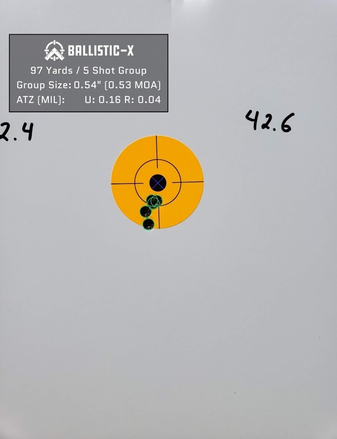

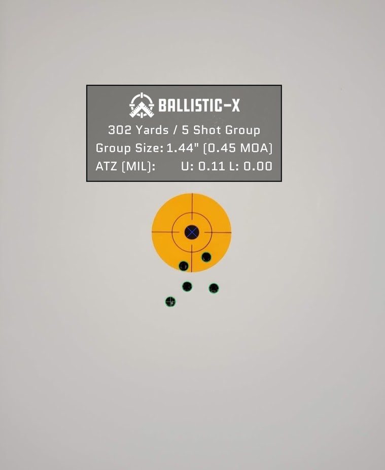

Finally got out and did some load testing and found a winner. 140 grain ELD-M over 42.6 grains of H4350 with a COAL of 2.825" seems to do the trick. Getting 2720fps out of the factory 24" barrel with around 1/2 MOA groups. Bone stock RPR with the exception of the Magpul PRS swap.

Same exact 42.6 grain high node and COAL as I found on my 6.5 CM RPR with the 140 ELD-M bullets. Only difference being I settled on the node just below yours at 41.2 grains of H4350, COAL of 2.825", and an MV of 2685 fps. I was hoping to get slightly extended barrel life at the lower node and so far accuracy and velocity are still good with 2242 rounds down the tube.
Five shot groups still consistently hover on either side of 0.5 MOA as well.

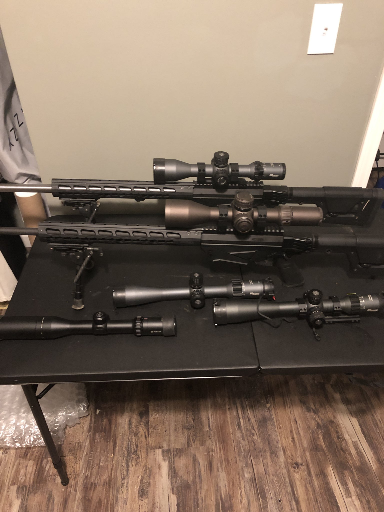

Any suggestions on the best setup for mounting a Gen II Razor 4.5-27 on a RPR? Best ring height?
I have used nightforce rings for my other scopes, but I'm wondering if it would be better to go with something from vortex for this scope. Also would like a scope level in the rear ring cap.

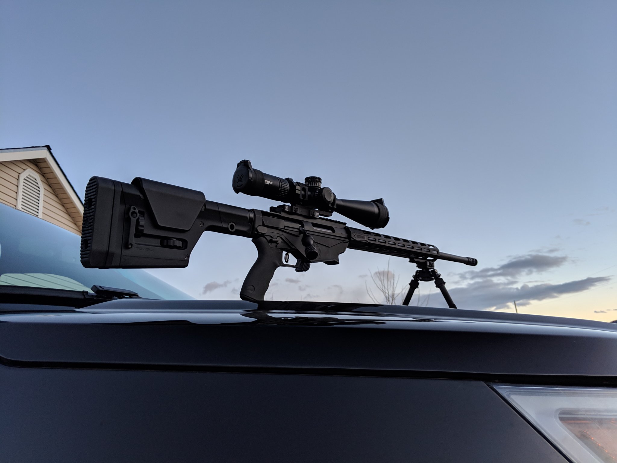

A few people I know are running ARC x-high rings. I’m running Seekins x-high with my razor. You need roughly 1.42”

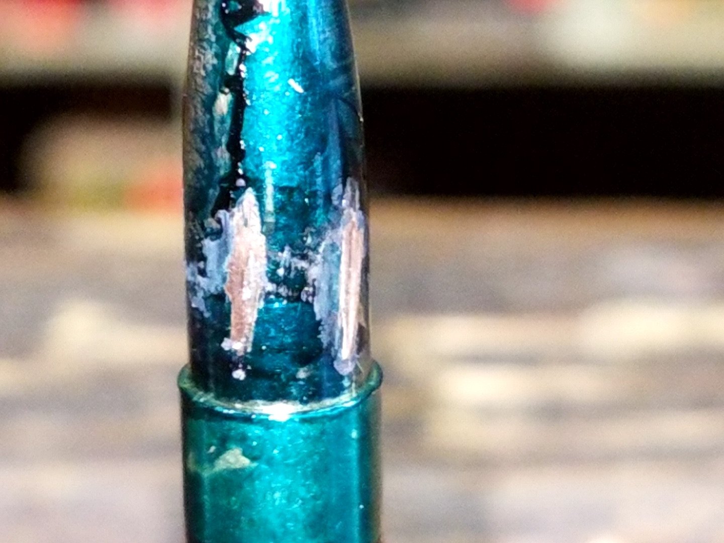

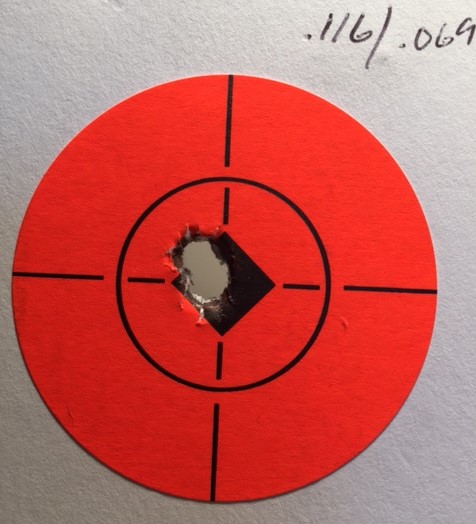

I'll post this up purely as a gesture to help fellow members here as no one said a word about the last post I made about this issue. My replacement RPR showed up today and it has EXACTLY the same issue as the first one I sent back to the factory. Its jamming factory ammo into the lands.
Could barely close and open the bolt and it pulled the bullet out of the case around .015" just to get it out.
Theres something going on with their 6 Creed barrels and no one seems to be talking about it. The odds of me getting two different guns in two different generations with the same problem has to be pretty slim.
That sucks. Mine is 2 months old and factory 108 ELD’s are .005 off the lands.

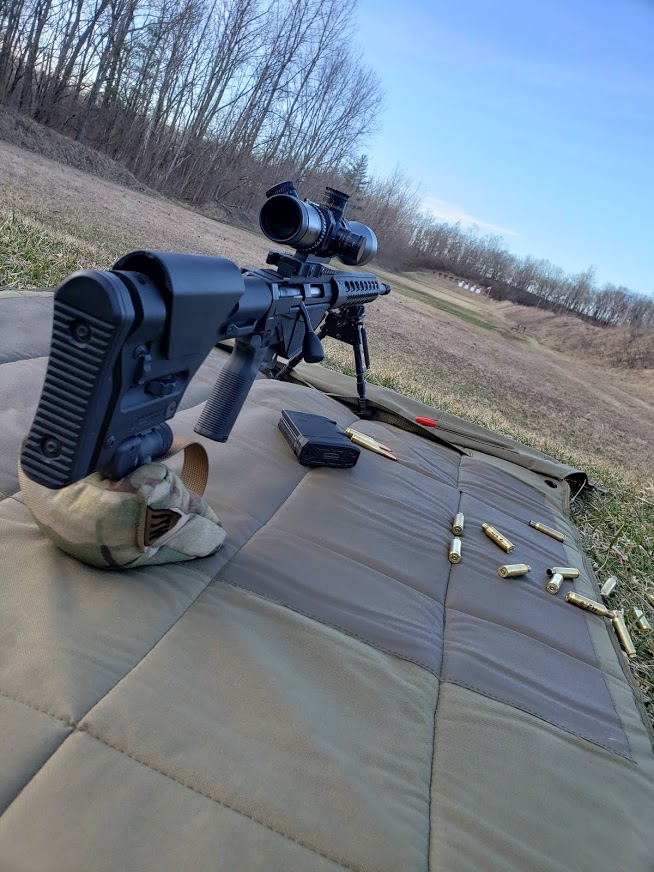

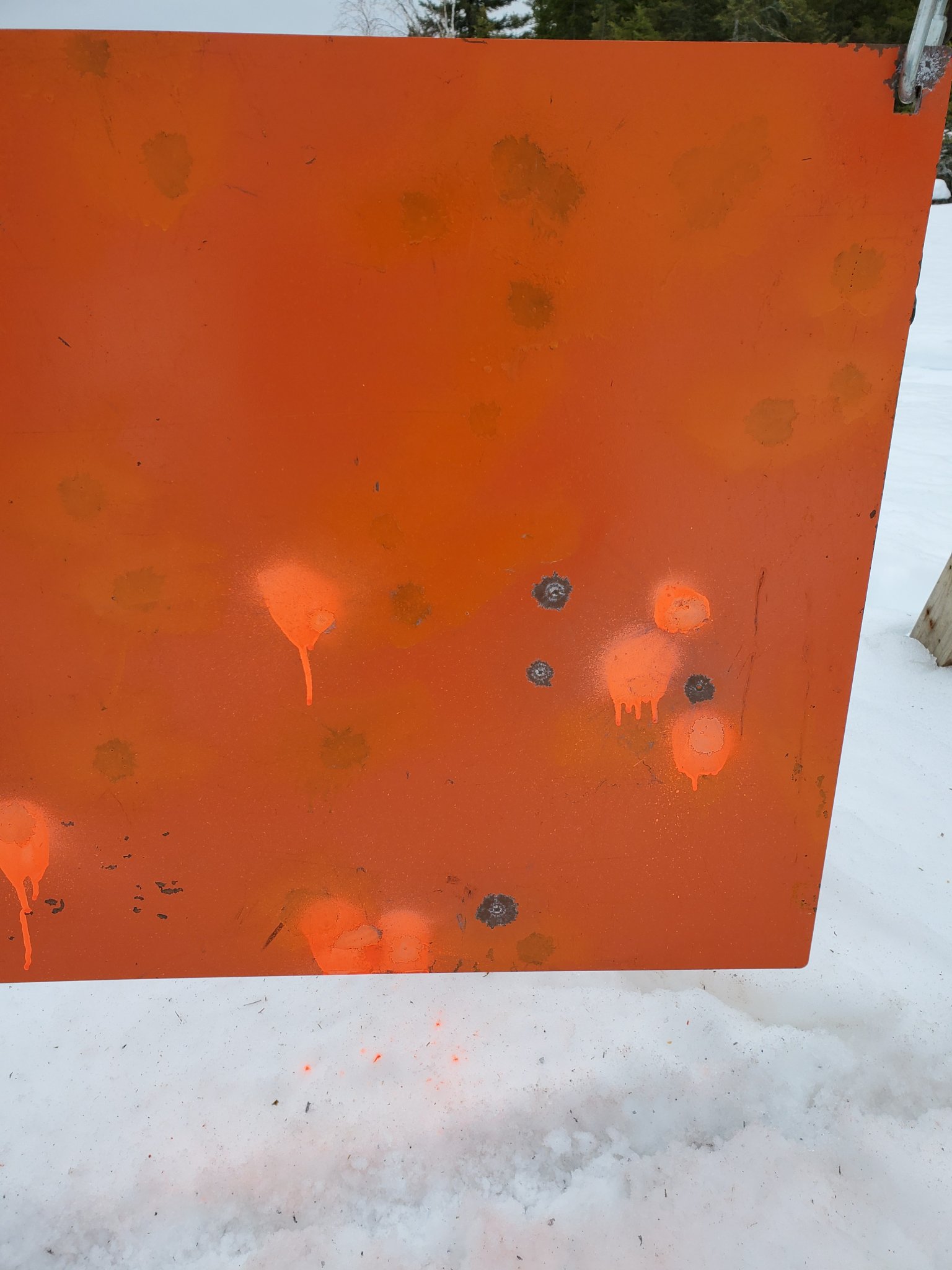

I haven't had my RPR out since last summer, so I dusted it off and put a few rounds through it today. I tried a new load and apparently my rifle REALLY likes it. Shot one of the best 5 shot groups I have ever managed with any rifle. The rifle is a Gen 1 RPR I had re-barreled to 6 Dasher (26" Hawk Hill) by PVA back when the RPRs first came out. The original 243 Win factory barrel was a turd.
Load info: Norma brass, CCI 400 primer, 33.5 gr VVN-550, 107 gr SMK, 2.353 OAL, muzzle velocity 2902 fps, per Quickload. I didn't actually chrono it. This is well below max and there were no pressure signs. I did try moving up on the charge in .2 grain increments to 34.1, but the groups started to open up although there were still no pressure signs. 33.5 grains was definitely the sweet spot.

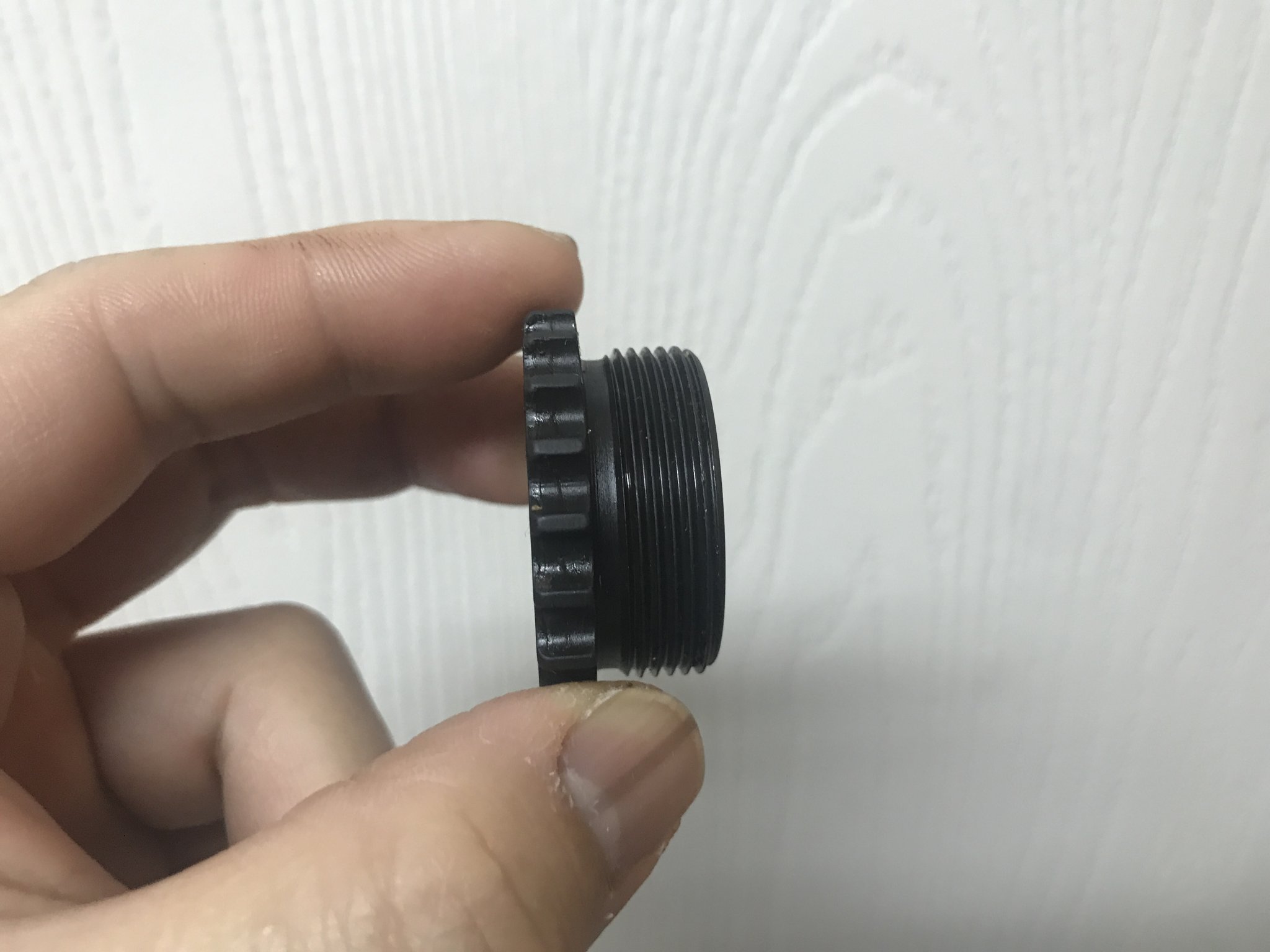

Yes. One is the barrel but and the other is the handguard nut. Seeing as how the threads are exterior on the one you attached, I believe that one is the barrel not. The handguard nut then threads over top of that one
Thanks again. My RPR has been dormant for awhile. Just going through stuff I had in a box. I’m using a PVA nut setup with a Seekins rail. Thinking about getting the Catalyst Arms Fast Track rail and per their instructions retains the factory jam nut.

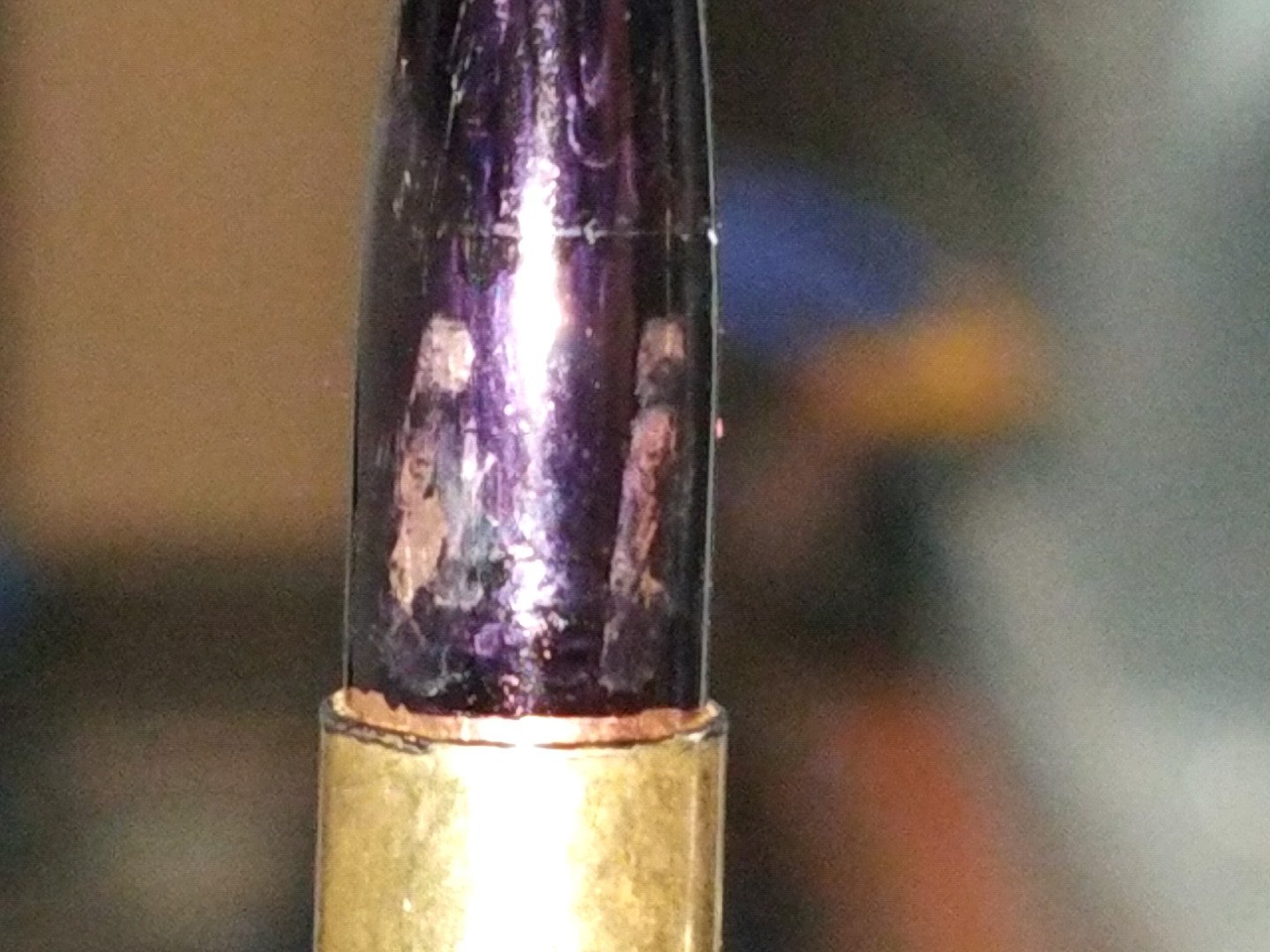

I just checked my factory 6 creed bbl with a factory Hornady match 108gr ELD bullet colored with black sharpie marker. Mine showed 5 smooth copper "marks" that were approx. 0.2" long that began 0.060" past the end of the brass. No hard bolt closure and no pulling out the bullet in the least. Shoots well approx. O.5-0.6 MOA. Sorry you are having problems.

Can someone please refresh my memory. Is this the factory barrel jam nut to set headspace? Just going through my parts bin..
Yes, it's the barrel nut.
So that some other's who read this may not be confused with your question, this barrel nut does NOT "set head space". It will lock in the head space after you set it by how far you screw the barrel in having measured the distance with go & no-go gauges.

I just checked my factory 6 creed bbl with a factory Hornady match 108gr ELD bullet colored with black sharpie marker. Mine showed 5 smooth brass "marks" that were approx. 0.2" long that began 0.060" past the end of the brass. No hard bolt closure and no pulling out the bullet in the least. Shoots well approx. O.5-0.6 MOA. Sorry you are having problems.
Maybe I'm just a lucky guy.
