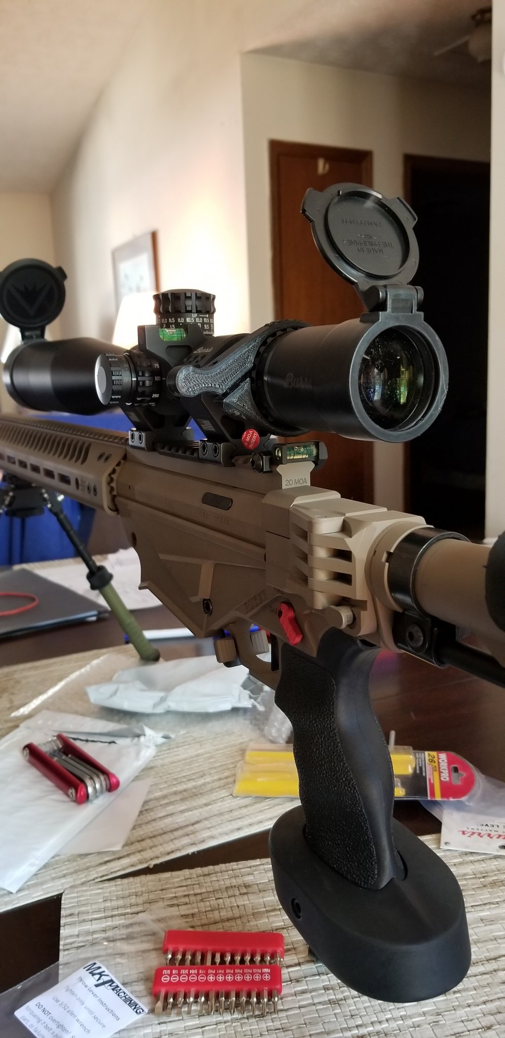

During my two month leave from here, I did a few things to mine. Cant remember where I was with it when I got banned but I'm back and its shooting flawlessly.

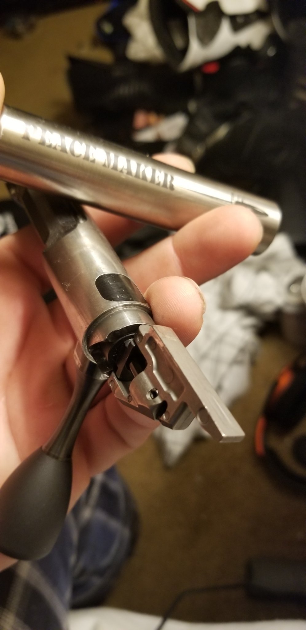

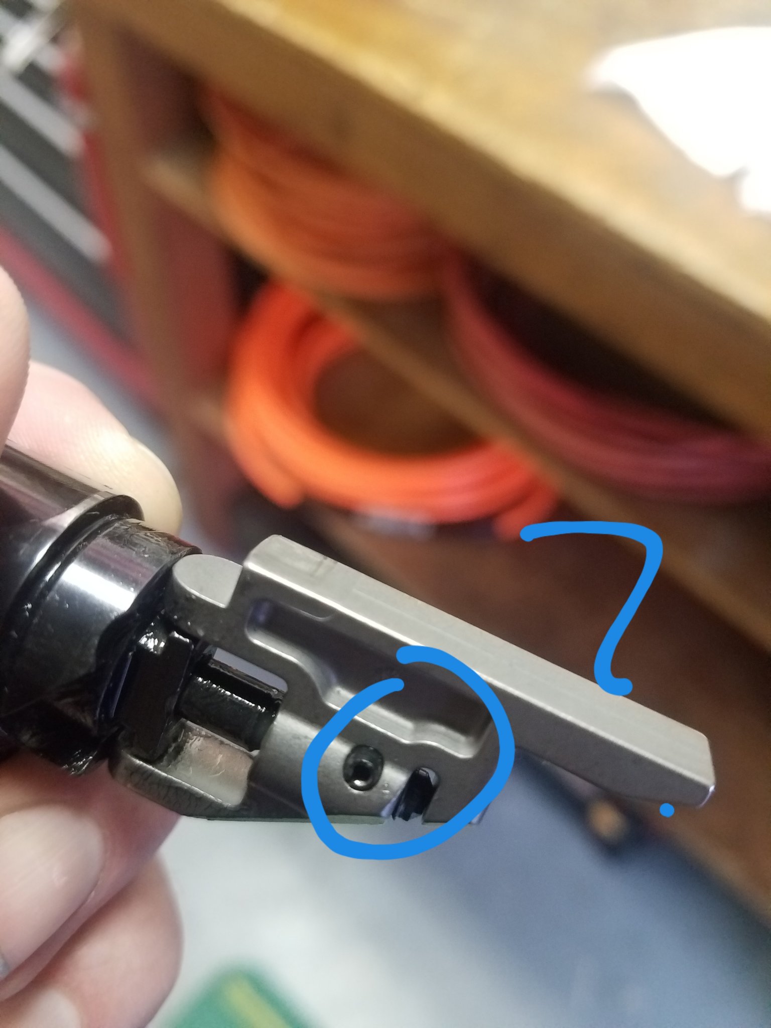

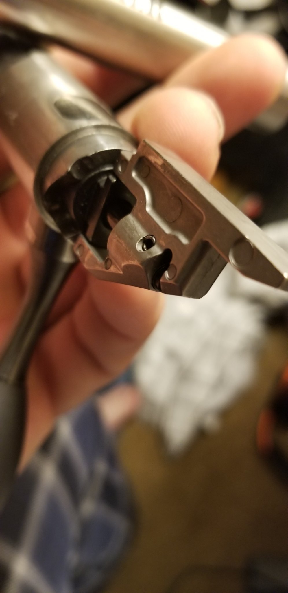

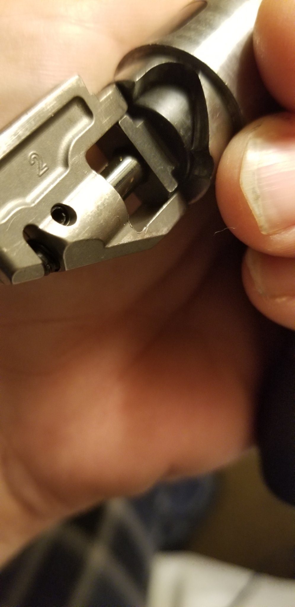

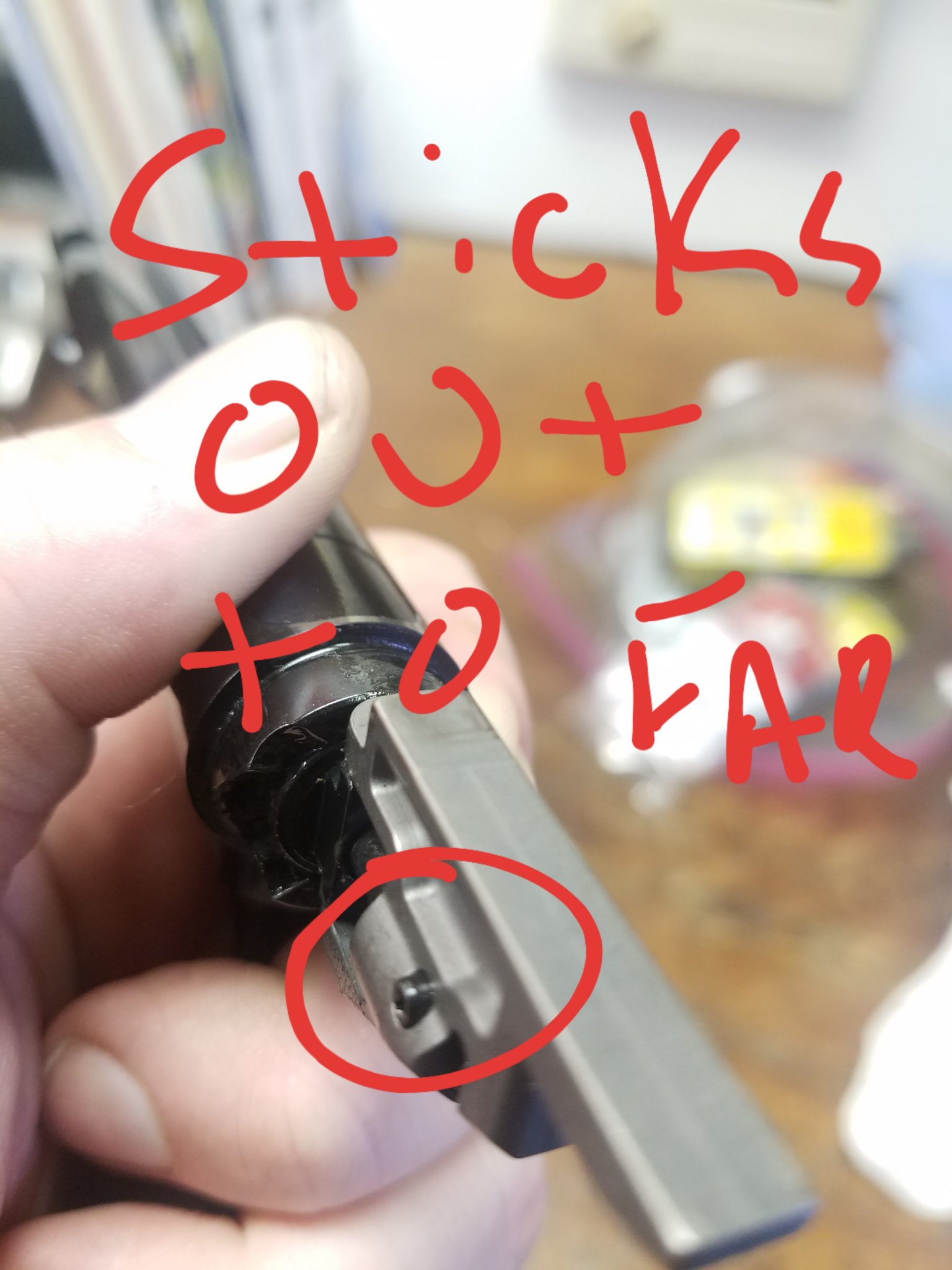

Can youguys with rprs do me a favor and take a look at your firing pin /bolt assembly. I have a retaining pin? That looks like it's wiggling its way out of my firing pin assembly. I tried grabbing a punch and lightly tapped/pressed it to see if it would go back to being centered inside the hole, but it won't budge. Now I'm wondering if it's supposed to look like this? Can you guys see if your setup looks like mine? Posting pics in a min...
Sorry for the crude photo editor but this pic looks. Like the pin sticks out way to far and the other side has no part of the pin showing at all
7057162
Yours does look like it's out a little based on my pics. Mine is a Gen 2 6.5 CM which probably doesn't matter.
NO! It's not supposed to be like that. It should be centered. You will need to more than "lightly" tap it to get it to where it should be. That pin is in rather right, so needs a little muscle to get it in.
BTW: Am just curious, did your RPR bolt come with that much goop around the firing pin?
Actually I just got it back from ruger from a unrelated repair and yes they put a ton of goop/grease in there.
Reactions: GA_medic

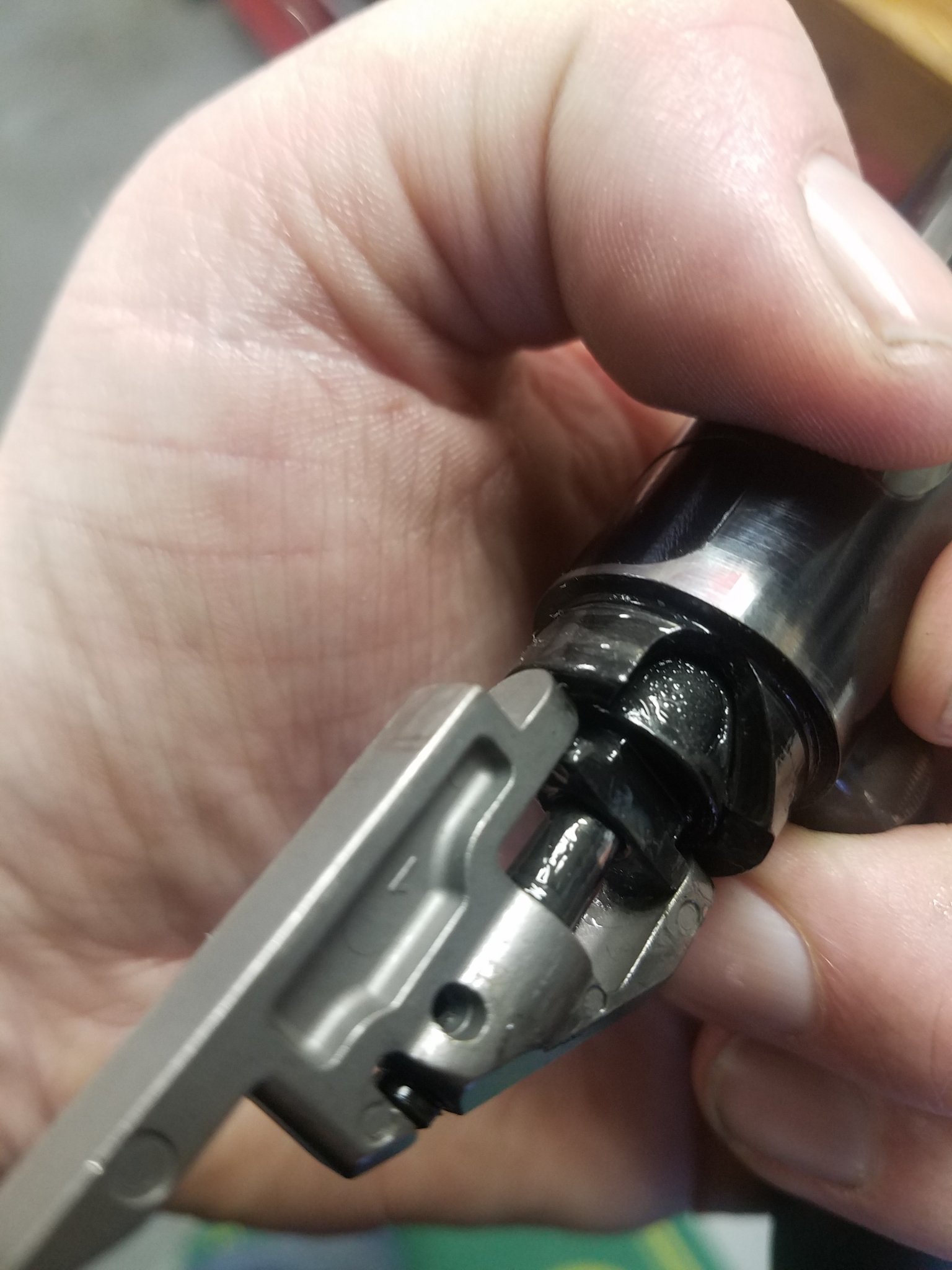

Okay any tricks for getting the pin to go back in place? I got the brass punch, steel punch and beat on it for a half hour and it is not budging. It actually started shaving brass off my punch.
Clearly the pin is under pressure, I tried using the little tool in shroud to take the pressure off the firing pin and still couldn't get that pin to budge. I tried a little oil as well and am not having any luck. I put it all back together and just went shooting. It appears to be staying in place, but I know it's not right. Any tips for getting the damn thing back in place?
Isn't that under tension from the firing pin spring? Is there any way you can relieve that tension by pushing the firing pin back? On the other hand, the depression the pin rides in may need to be pushed forward.
Some further disassembly may be required. It's fairly simple. You just need to remove one pin.
Sorry. I couldn't resist.
Reactions: Pilotscrappy
OK, I'll try to make up for the unhelpfulness of the last post.
If you don't have the manual, you can download it from Rugers website. It has a full parts list and exploded views.
I've never had this pin out or had any of this trouble . . . but, I would approach it like Howland suggested above by removing the firing pin. And if I were doing it, I'd simply tap the pin completely out in the same direction that it's already started. This way I could inspect the pin as well as the hole to see if the pin needs any work on it in case it dented or bent. Then, I'd clean out the hole and reinsert the pin. I think the hardest part of all this would probably be trying to get the firing pin back in place as that spring is it can be pretty tough to compress and get it all back in place at the same time.
You'll need to take a look at the youtube videos for 'Ruger Precision Rifle Firing Pin Dis-assembly.' That roll pin is mostly under pressure from the threading. You'll have to remove the firing pin assembly from the bolt and turn the cam back about 1/16 turn to remove the thread tension to get it so the roll pin can be driven back to center.

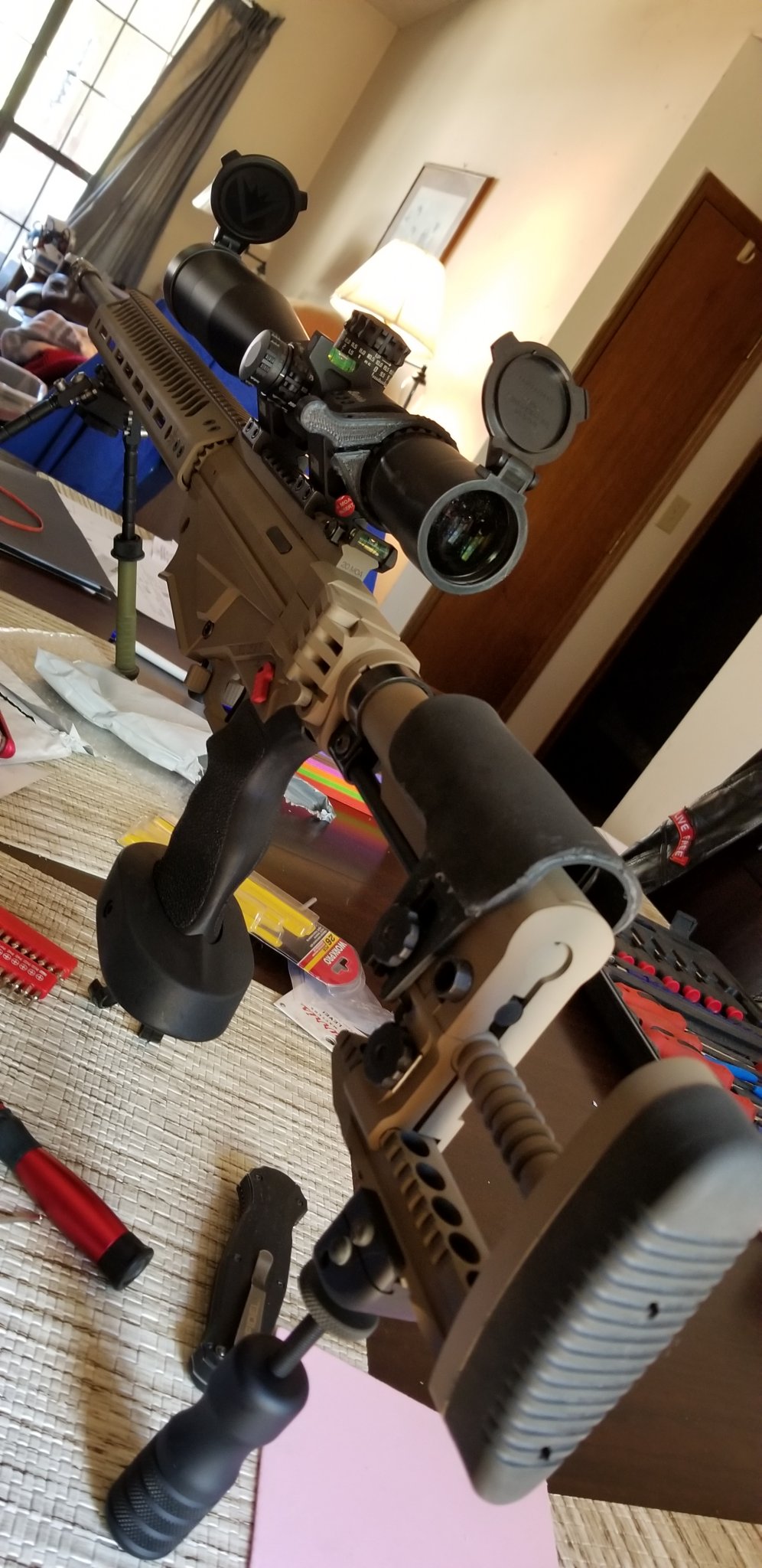

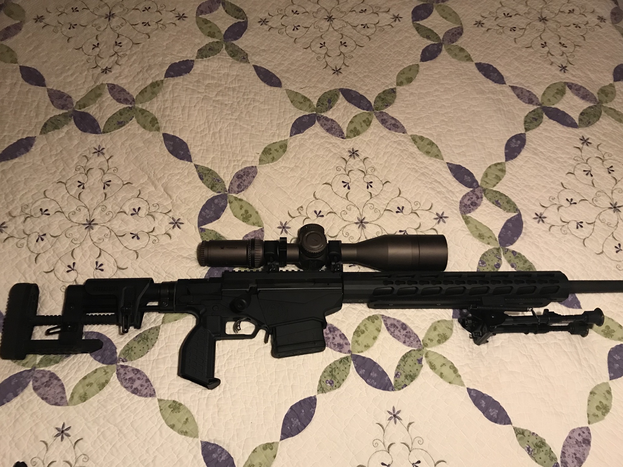

So like many others I have been in constant search of ways to improve my RPR. I want to be able to shoot as good as my RPR can/does shoot. My RPR is for precision matches only.
I have been completely un satisfied with my stock grip. I have looked at many replacements but none have felt perfect.
Until now ... I got the new grip from Necolabs/Anarchy Outdoors. Install was simple. Fit and finish is excellent. Went to my dry fire station and dry fired myself silly. This grip is excellent. I’m going to get some range time and will report back with lead down range results. This grip puts my hand in perfect trigger position. Thumb shelf is right.
Attached are stock grip and the new grip pictures.
