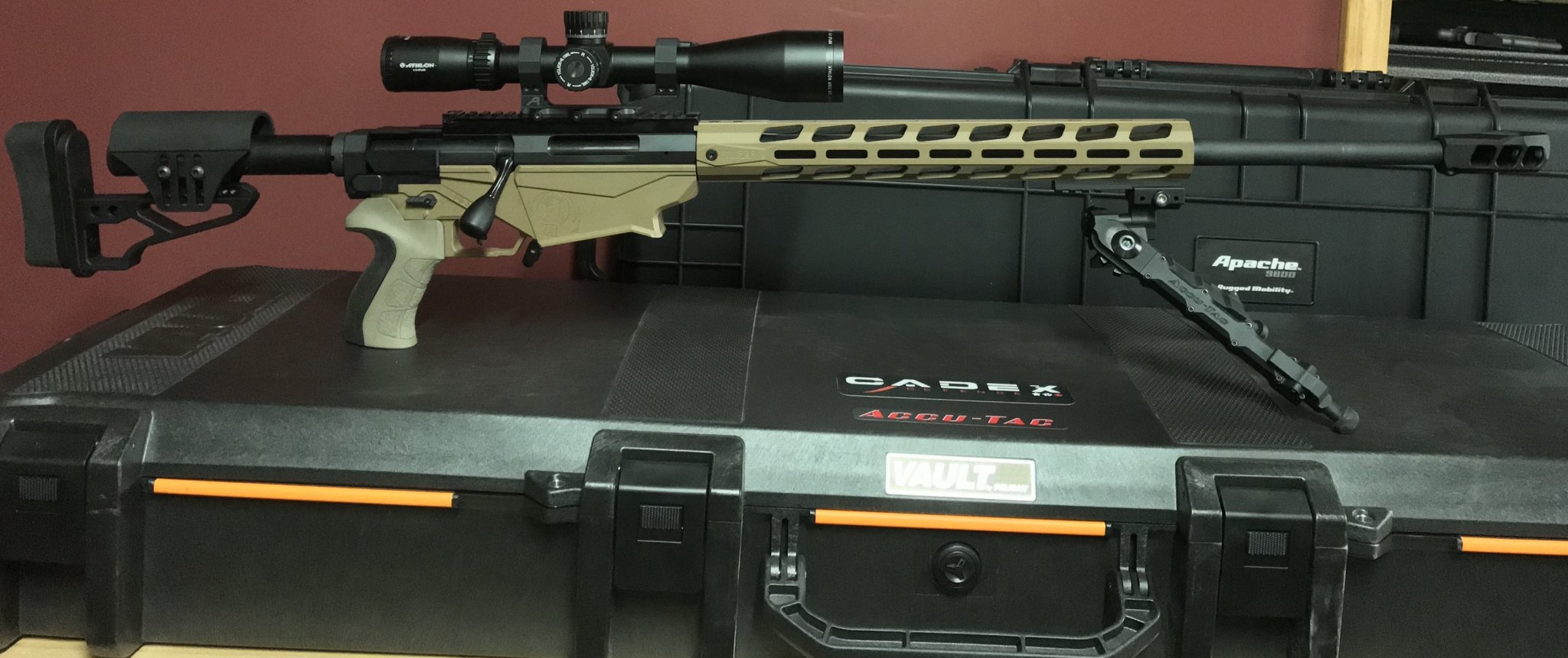

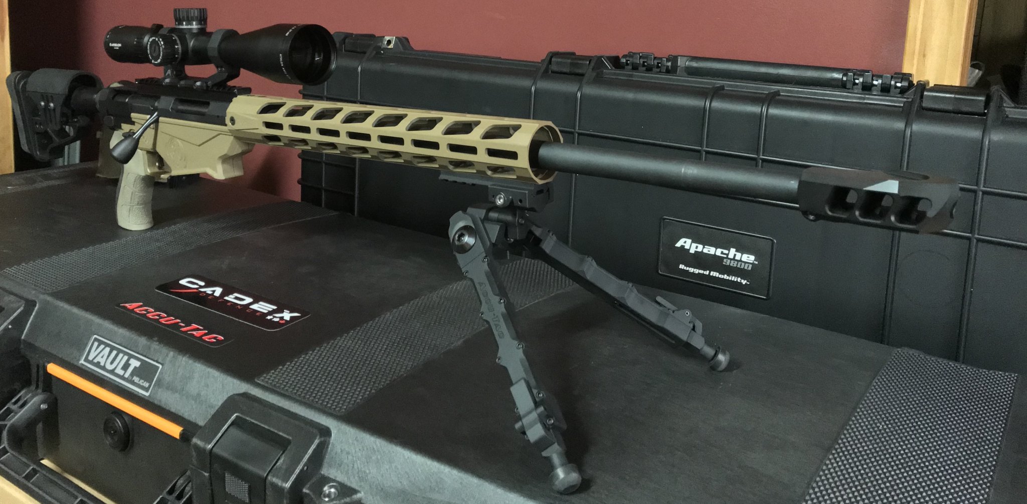

GA_Medic, went shooting Saturday, I like XLR butt stock, feels better shooting. Loved that I could adjust it easier even having use screw driver with 4 Allen bit than messing with the ruger stock. Just my personal opinion.
7065597
7065598
Changes so far
XLR tactical lite W/ dual conversion plate
Cadex M1 Muzzle break
Seekins Precision Ambi Safety
Catalyst Arms Mag Release Extension
Athlon Ares BTR
Accu-Tac bipod
Pelican Vault V800 case
Still coming, sometime lol
Timney trigger
Spuhr scope mount
Titanium bolt shroud
upgraded bolt handle and bolt knob
Possibly fluted bolt
Possibly Midwest industries hand guard , and hand guard/ lower receiver Cerakote in Tungsten

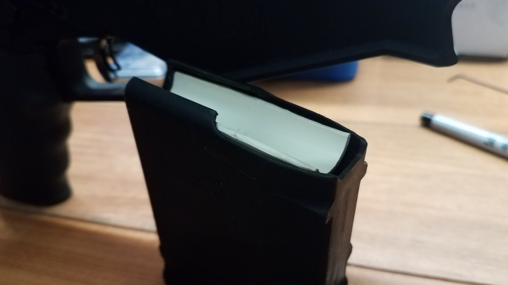

My friend wants to use his RPR in F Class competition, and the rule is that you can only load one round at a time and not from a magazine. He says the bolt on his RPR locks back when the mag is empty. Is there a way to make the RPR work for F Class?
I don’t have time to look it up myself right now, but 8541 Tactical has a YouTube video where he goes over a number of different mags on the RPR Gen 2. The factory mags cause the bolt to “lock back” when empty, but other mags do not.
Reactions: pewpewfever
It's been quite a while since I read (somewhere around here) that one could make those mags work by filing/grinding of a piece of the mag at the back that keeps the bolt from moving forward when empty. I didn't do this myself as I simply bought a single stack MP mag that allowed the bolt to close when empty.
I made a single load follower that slips into the MagPul magazines. It is made from a section of PVC pipe (1 inch, I think). It holds the follwer down and allows the bolt to close. It slips in like a cartridge. See photos below.
