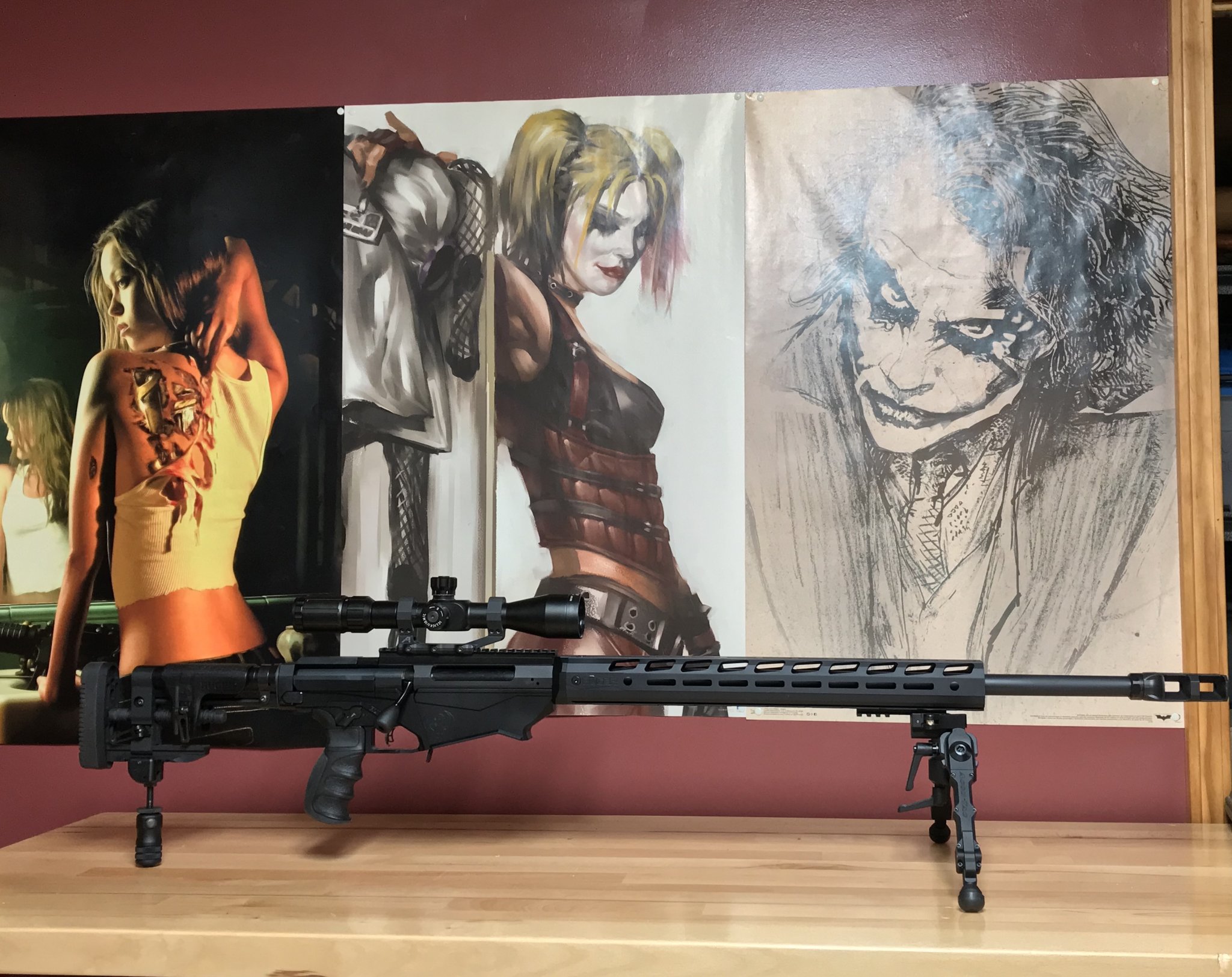

Well my new RPR 300 PRC is at least shootable. Found a old Primary Arms scope as Temporary scope, until I decide what scope I want + Spuhr mount to go with it

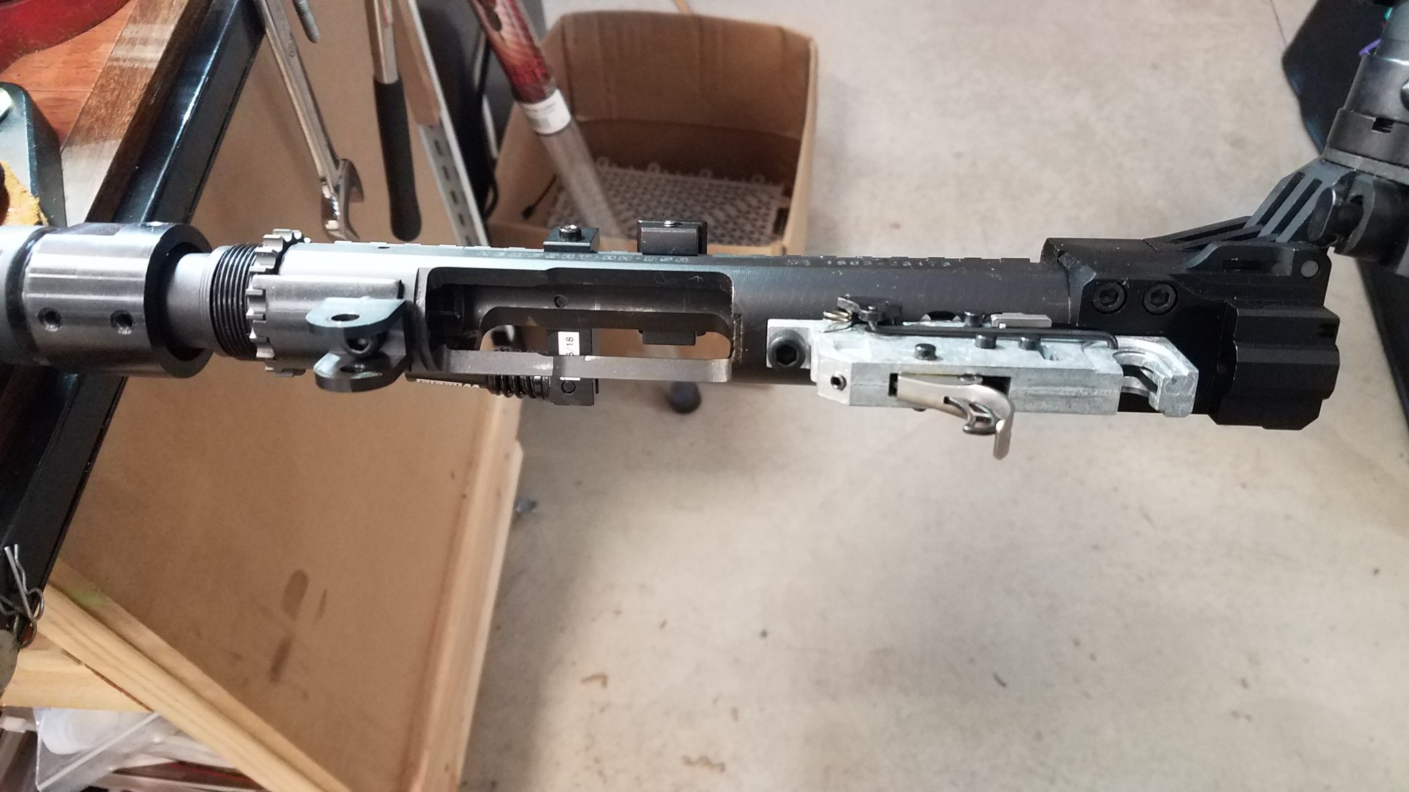

Once my barrel gets here and I get it mounted, I'm gonna send some pics of my paint job along also.

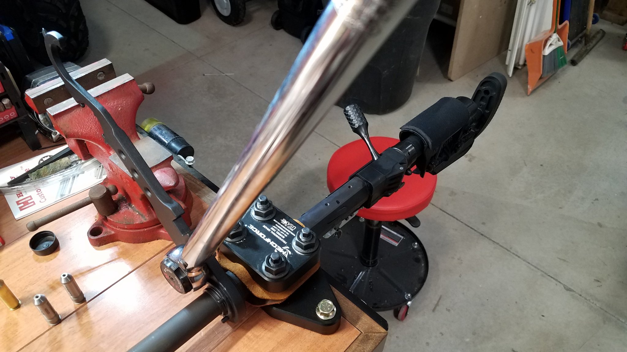

I rebarreled to 7mm-08 from 6 Creed. Ruger honestly needs to team up with Magpul for their stocks. The OEM stocks suck ass . Just my opinion though.

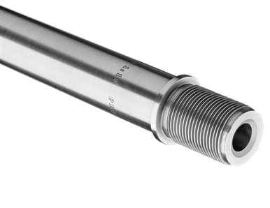

I just bought this Proof barrel on sale for $479 at midway will be shooting it at 1000 yards this weekend I will let you know. I wish I had cum across the price you posted very nice

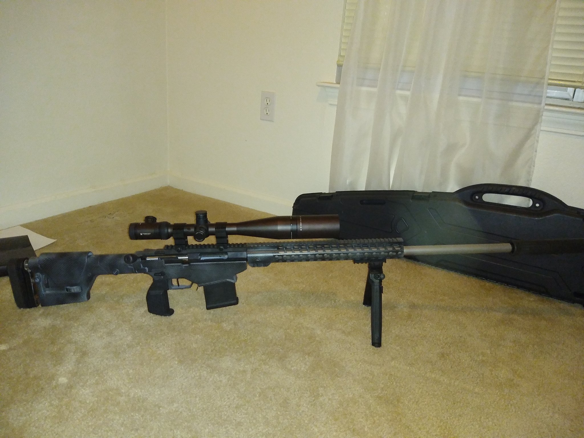

Here's how mine sits now.
RPR
27" 7mm-08 barrel from preferred barrel blanks
Timney flat trigger set at 1.5lbs
Magpul Gen3 PRS
Tuxedo Grip from anarachy
Stock bolt
AAC Brake for my can
Magpul bipod
EGW 30MOA rail
Vortex Viper PST 6-24 ebr-2c MRAD
Snakeskin paint job by me

Hey that paint looks very nice. I’m thinking about doing something similar to my RPR. Would you mind sharing how you did that?

I loved the outcome of it myself.
First off I took off everything I didn't want painted.
Then I sprayed all the parts with brake cleaner.
Let dry.
Sprayed base coat of Dupli-color silver with ceramic. Let dry.
Took mesh laundry bag and laid over parts. Sprayed with flat black Dupli-color with ceramic.
Let dry and reassembled.
The mesh bag was just laid on top, not tight at all. Was about 2 inches away when I sprayed black paint. Took mesh off immediately and let dry.
I think it looks pretty good for a garage paint job.
