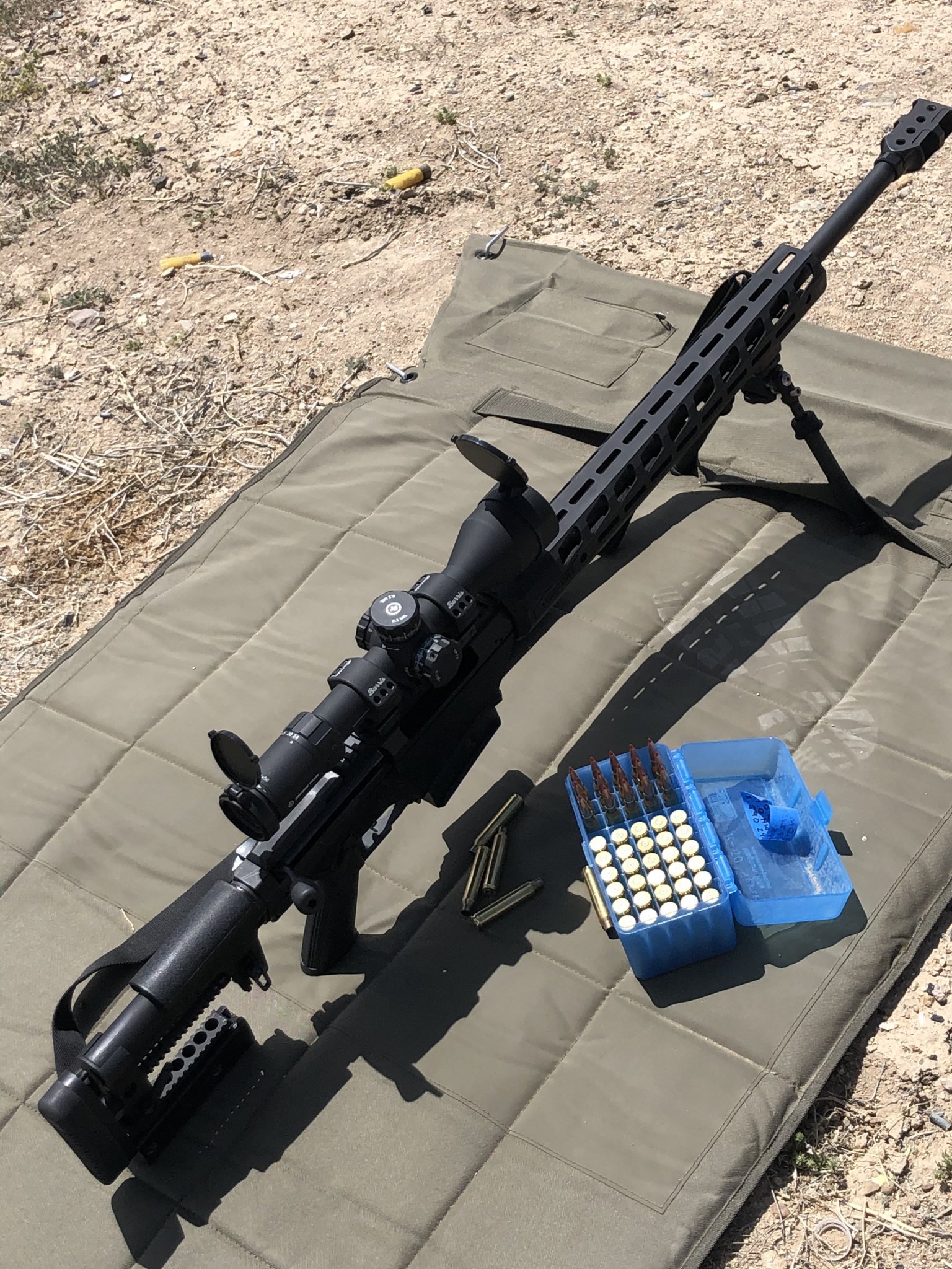

I recently purchased a LRI 26", 1-8 twist barrel, plus little bastard brake and seeekins forend. My RPR is a 1st gen, 6.5 CM with aJard 20 ounce trigger and Magpul PRS stock. Due to medical problems and covid19, haven't got to shoot it yet. Really looking forward to getting on the range.

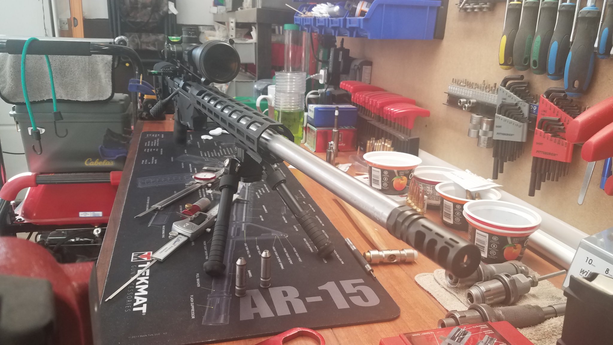

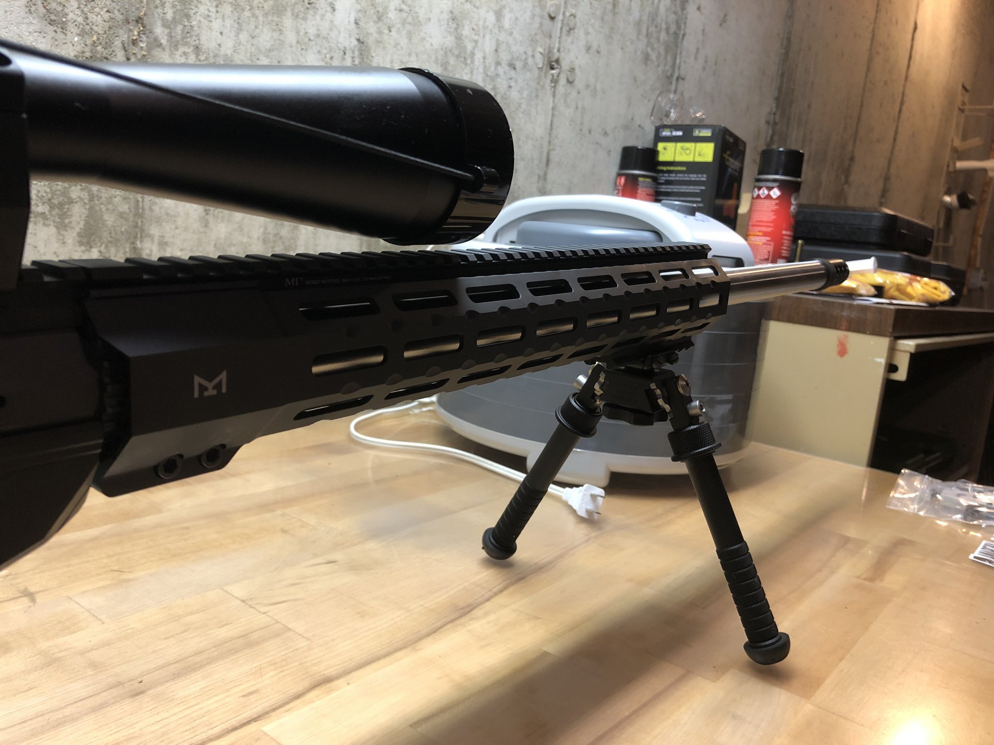

Just finished upgrading my RPR. One little watch out, when you get your barrel made, make sure the Max OD after the threads is 1” or check the max OD before buying a handguard. Mine came in a little big at 1.014” and it no longer fit the standard handguard or one from Seekins (1.008” ID on Barrel nut). I had to get one from Midwest Industries to get it to fit. Minor issues but things to keep in mind when doing a barrel swap!

What Ruger gen handguard do you have? Who made the barrel and what contour is it?
It’s a Midwest industries 15” handguard. They are actually discontinued so I got extremely lucky to buy one while Brownells still has inventory (last week). Barrel is a 26” 1:10twist heavy Palma from Patriot Valley Arms. I gotta say Joe is top notch over there and was great at replying and helping me along the way. I did my barrel swap myself (first time) and it was extremely easy. I’m just going crazy not being able to go to the range -_-
I just got a marksman 6.5 from pva. Joe and Josh were a big help in getting the barrel I wanted. What Ruger handguard did you have? What gen model rifle did you have?
I had a stock handguard but purchased a seekins precision one for the build. Neither fit per the sizes mentioned earlier so I got the Midwest. Rifle is a gen 3, bought it last year in August.
Thanks! I have a gen 2 and I believe the barrel nut and handguard nut has a bigger inner diameter to allow for the 1.25 contour. Someone correct if I’m wrong.

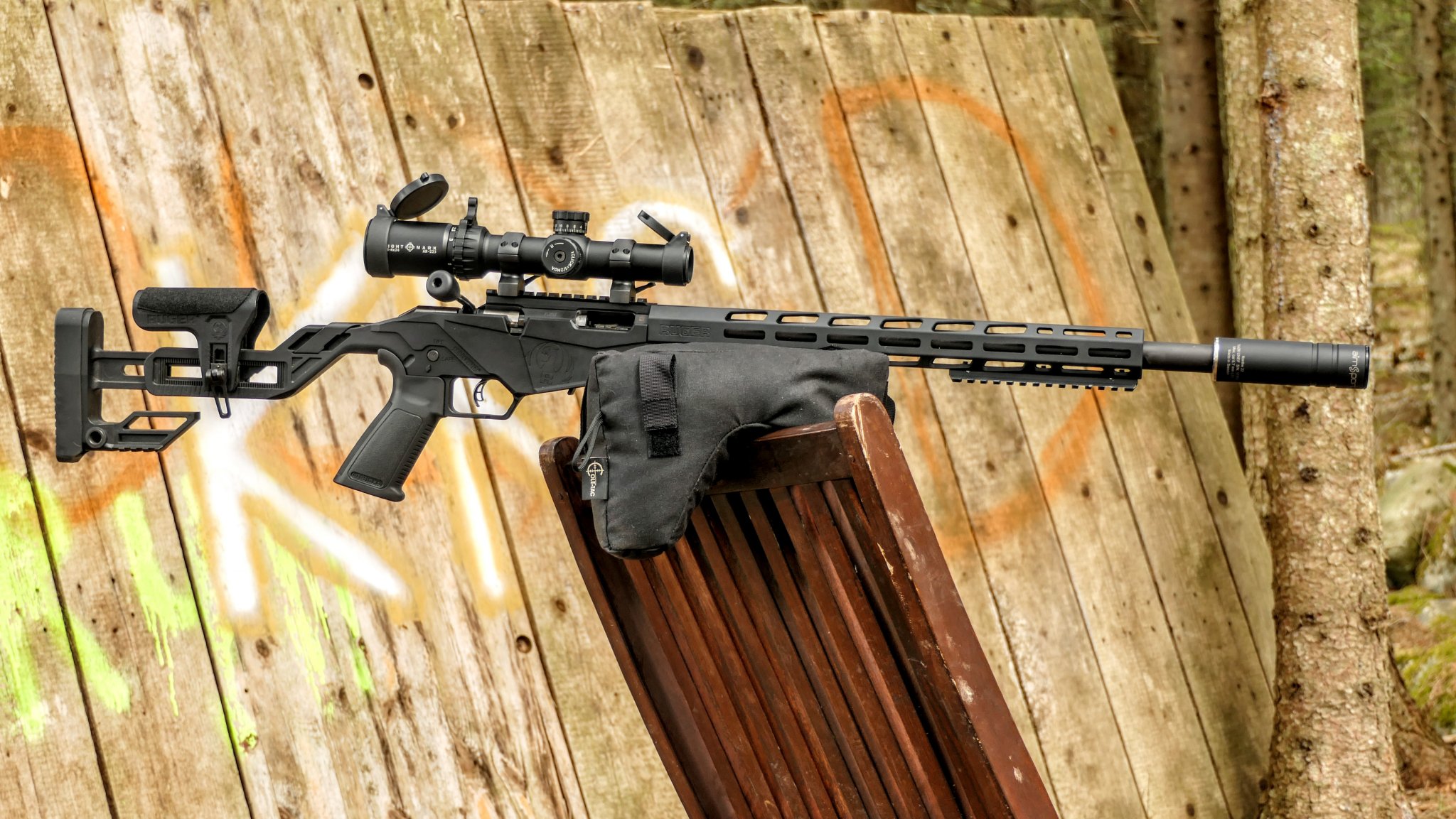

Testing these Ruger rifles.
So far the Precision Rimfire accuracy has been surprisingly good, and that rifle would be a killer, if it would have better chassis.
Free float alloy hand guard and trigger+action are nice, but that rear stock+chassis is not made for adult.
Plastic is not the material i like.
Is there any chassis made for Ruger rimfire precision?
Reactions: geek65
