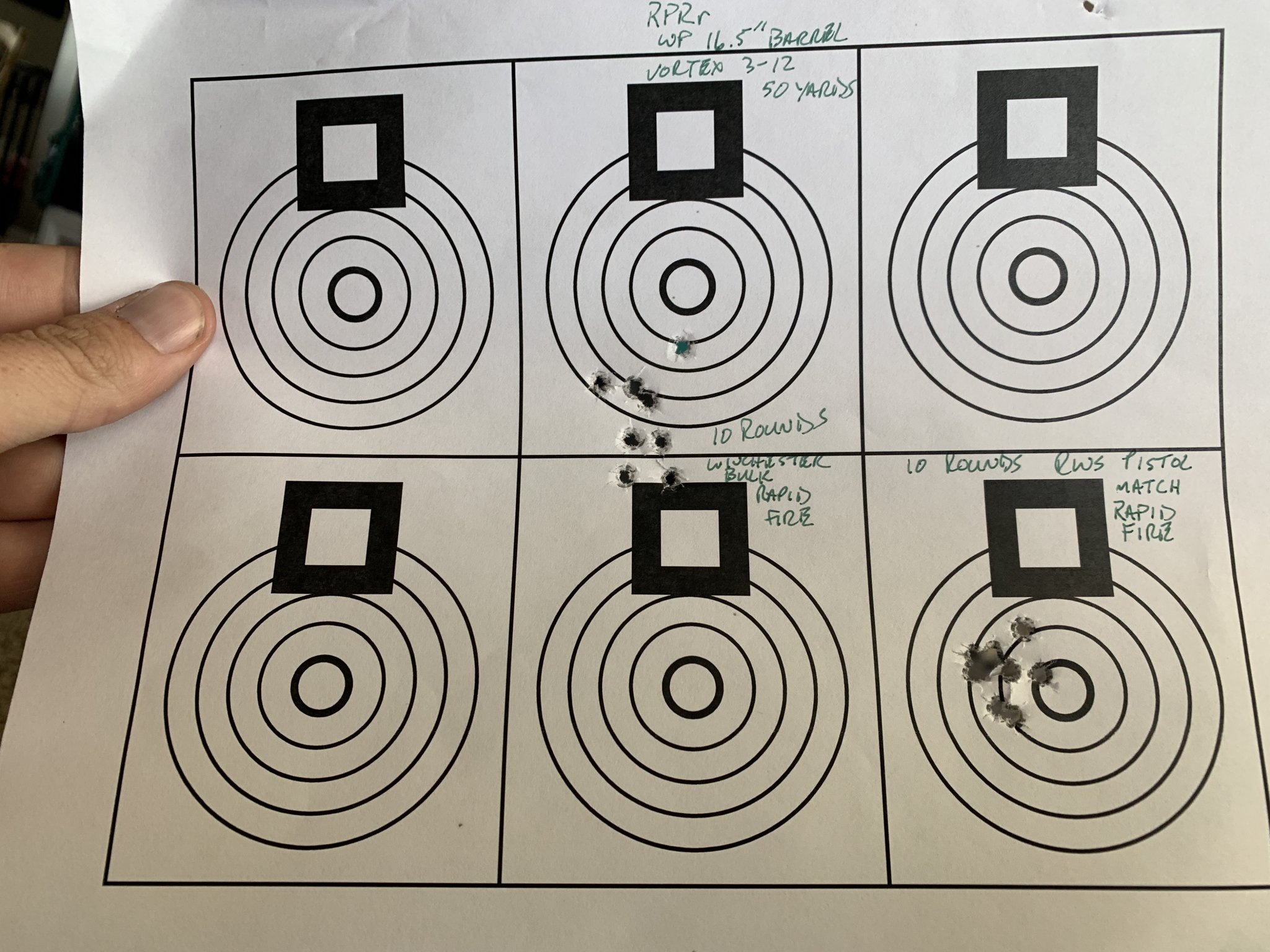

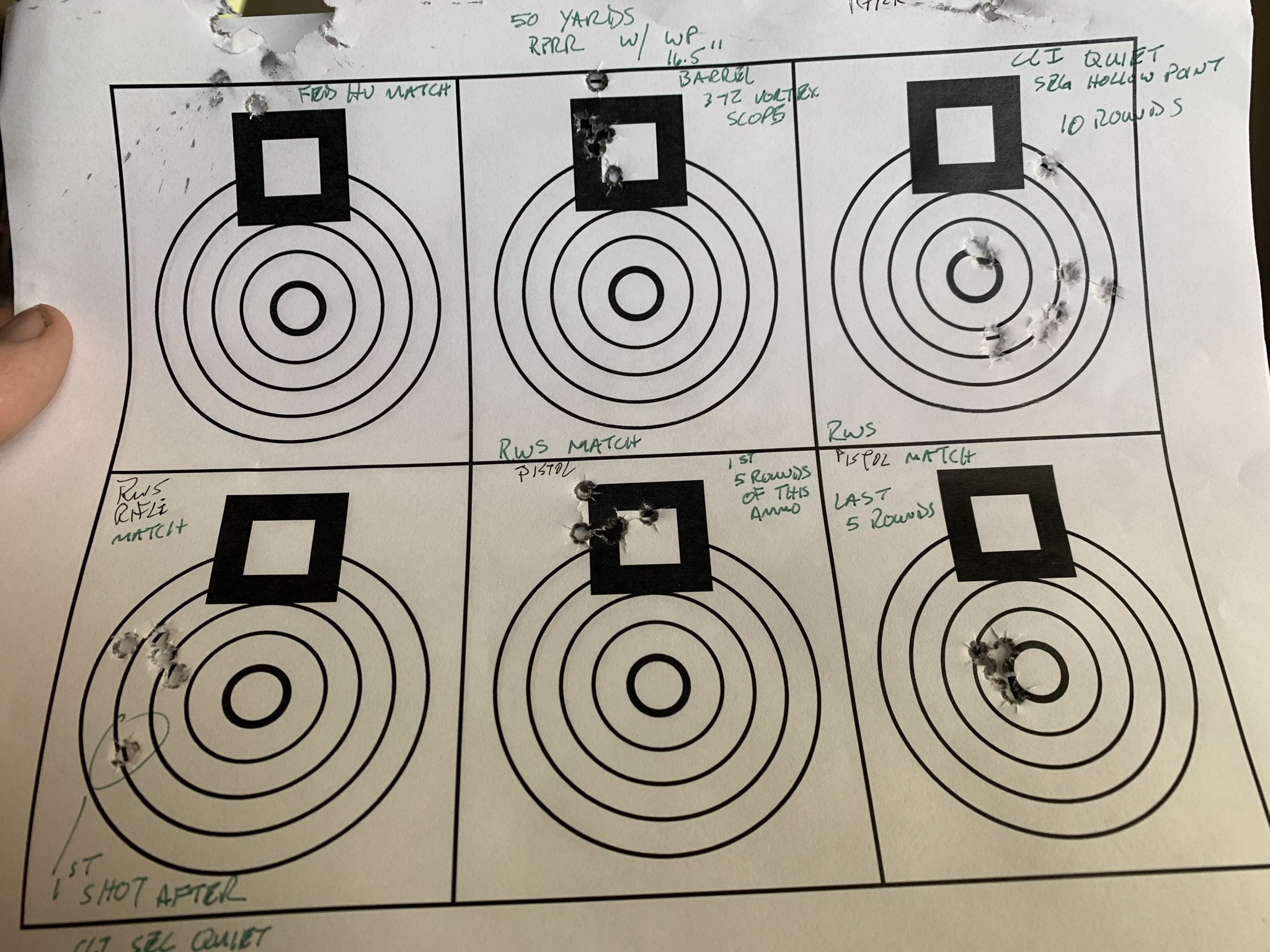

Went to the indoor range today for an hour or so.
Barrel on my RPRr seems to be getting better (whistlepig 16.5” barrel with match chamber)
I will say the barrel doesn’t like jumping between ammo types. If you stick with a good ammo or season the next with a few shots then it does better.
This barrel hates cci quiet segmented hollow points. It shot like crap at 50 yards
Pictures below were at 50 yards off a bipod and bags with a 3-12 power scope.
Second photo was “rapid” fire as fast as I could get back on the target and get steady. Probably 1-2 seconds between shots. I am not the greatest shot and someone else probably could ring more out of it than me but I am happy.
Right now RWS pistol match will be my boys go to ammo for mid grade ammo.

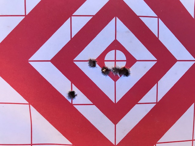

Shot my first match yesterday and was frustrated with my Ruger on the stages with the really small targets.
Someone in my squad let me shoot their Vudoo in a MPA Chassis. Granted this is at 25 yards, but both of these are 5 shot groups. Guess which one is the Ruger? Maybe I'm wrong, but the problem isn't the Indian.
Try shooting the same ammo that was in the Vudoo in your Ruger to make a fair comparison.
Reactions: FO876 and Dewey7271
Something is wrong with that RPR setup/combo. I would check all screws for torque, try a different scope, clean the barrel squeaky clean for starters.
I would check the feeding from the magazine and polish the bottom of the bolt if it is shaving/marking the bullets next in line. Try different torque values on the action screws, 15 to 40 in/lbs. Try the aluminum foil tape bedding.
Try different ammunition, as many different ones as you can find.
I personally know of 4 RPR rf that will shoot the same group as the bottom in your post, and that with CCI SV at the 25 yds you mentioned.
Mine shoots right at .300" at 50 yds normally depending on conditions with CCI SV. I have shot numerous groups at 100 yds of .625" to .750" under good conditions (which are hard to come by around here), again with CCI SV. I have shot some of the higher price spread and it really likes RWS Rifle Match, ELEY Tenex and a few others, but for what I'm doing CCI SV is cost effective. I have placed first in the Base class at each of the two NRL shoots I attended. So until I "need" better ammo to continue that trend, I'll stay with the cost effective CCI SV.
Only thing I did was polish the bottom of the bolt, change to 10 rd magazines and backed off spring tension a bit, adjusted trigger pull to minimum (1 3/4 lb), and run action screw torque to 40 in/lbs.
Good luck with trying to figure out what the problem is. Start with screws and scope.

Thanks. I'll give it a shot. I do get better groups with different ammo, but still get a flier or two. So far I've tried, Federal match, Aquila super extra, cci sv, sk SP, sk RM. Some are better, but nothing like the Vudoo I tried.
Im using the Vortex Diamondback tactical ffp scope.
I would still try a different scope, just because. I would start with a clean barrel. Use your preferred method, I use Rem 40X bore cleaner (the old Gold Medallion), and have since its introduction.
I don't know how many rounds you have shot, mine was good from day one, but really "tightened" up after about 500 rounds. Could have also been the change in scopes as I started with a 3-9 X 40 AO while waiting for my 6-24 X 44 SF to arrive. The change was made around the 500 round mark.
Good luck and keep us posted.
View attachment 7116210View attachment 7116211
That's what an extra 2 thousand dollars will get you.
Actually 60, I had a wet spot at 50 from the rain.
I'm gonna play with mine more on Thursday and hope it gets better.
I have a Masterpiece arms in 6.5CM and I think I'm just gonna get a Vudoo action and just swap out the chassis depending on the matches I shoot (nrl22/prs). After I save a little more coin I'll get a dedicated MPA chassis for the Vudoo.
After shooting Vudoo last weekend.......I'm convinced on the Vudo

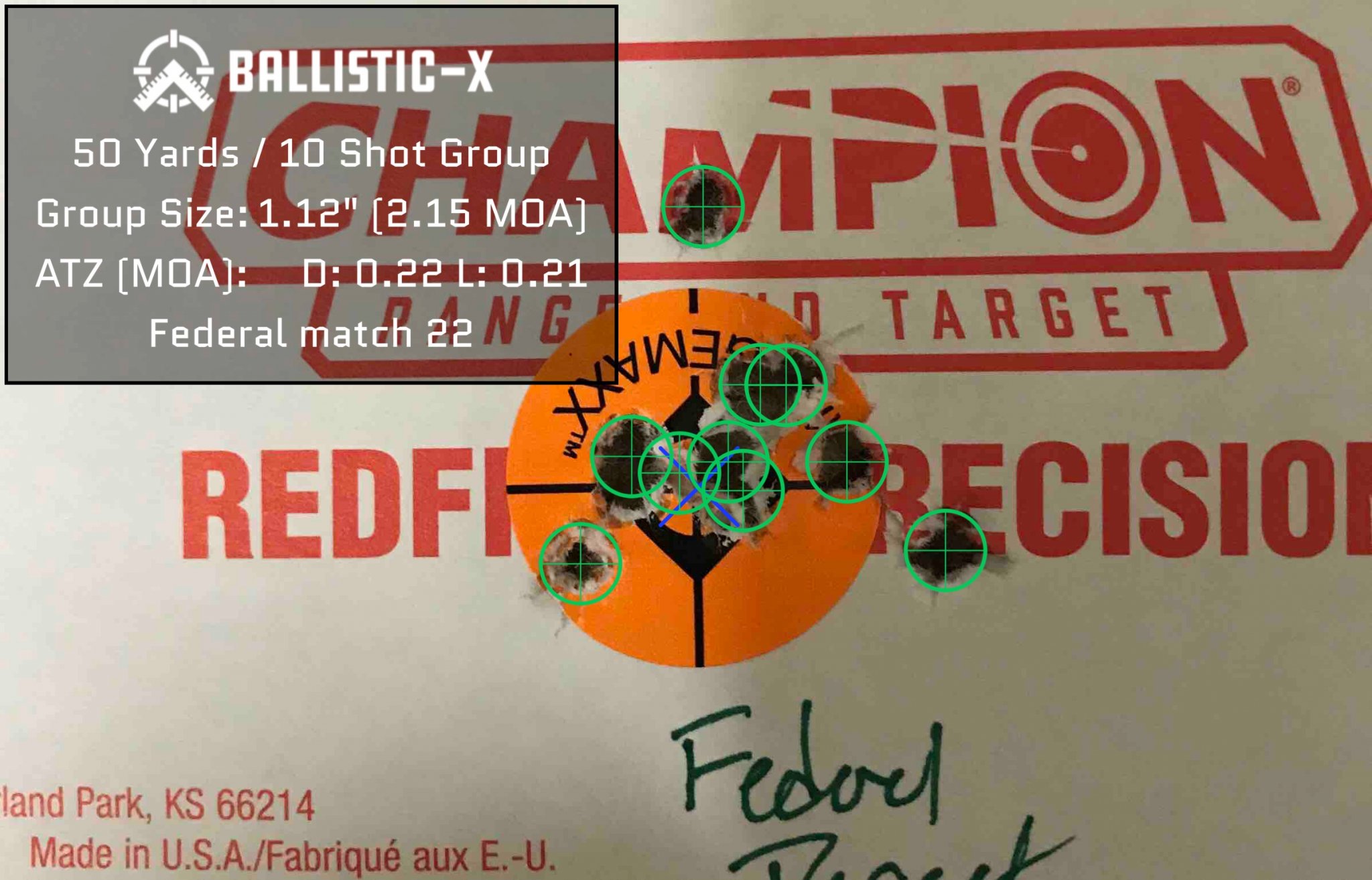

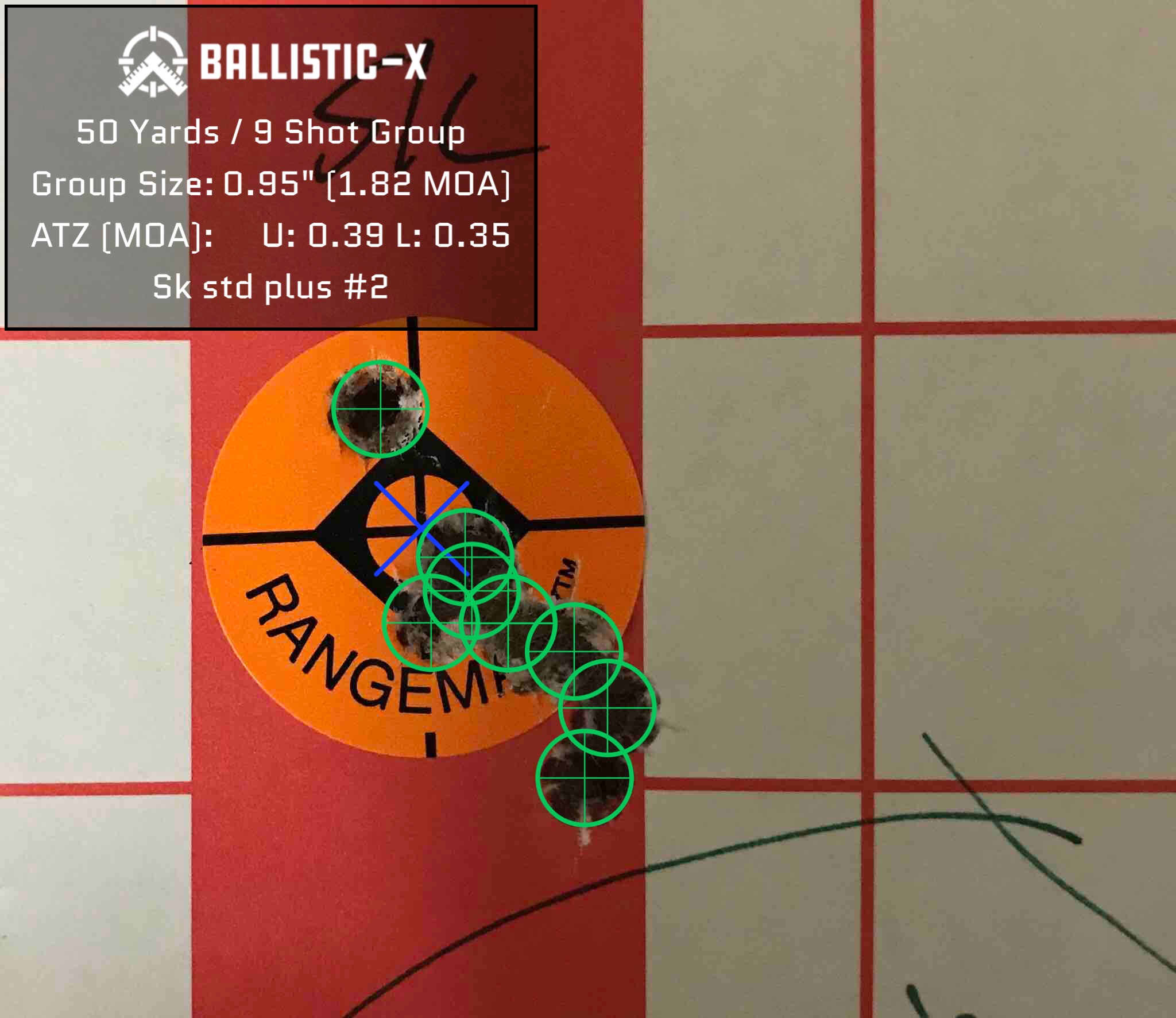

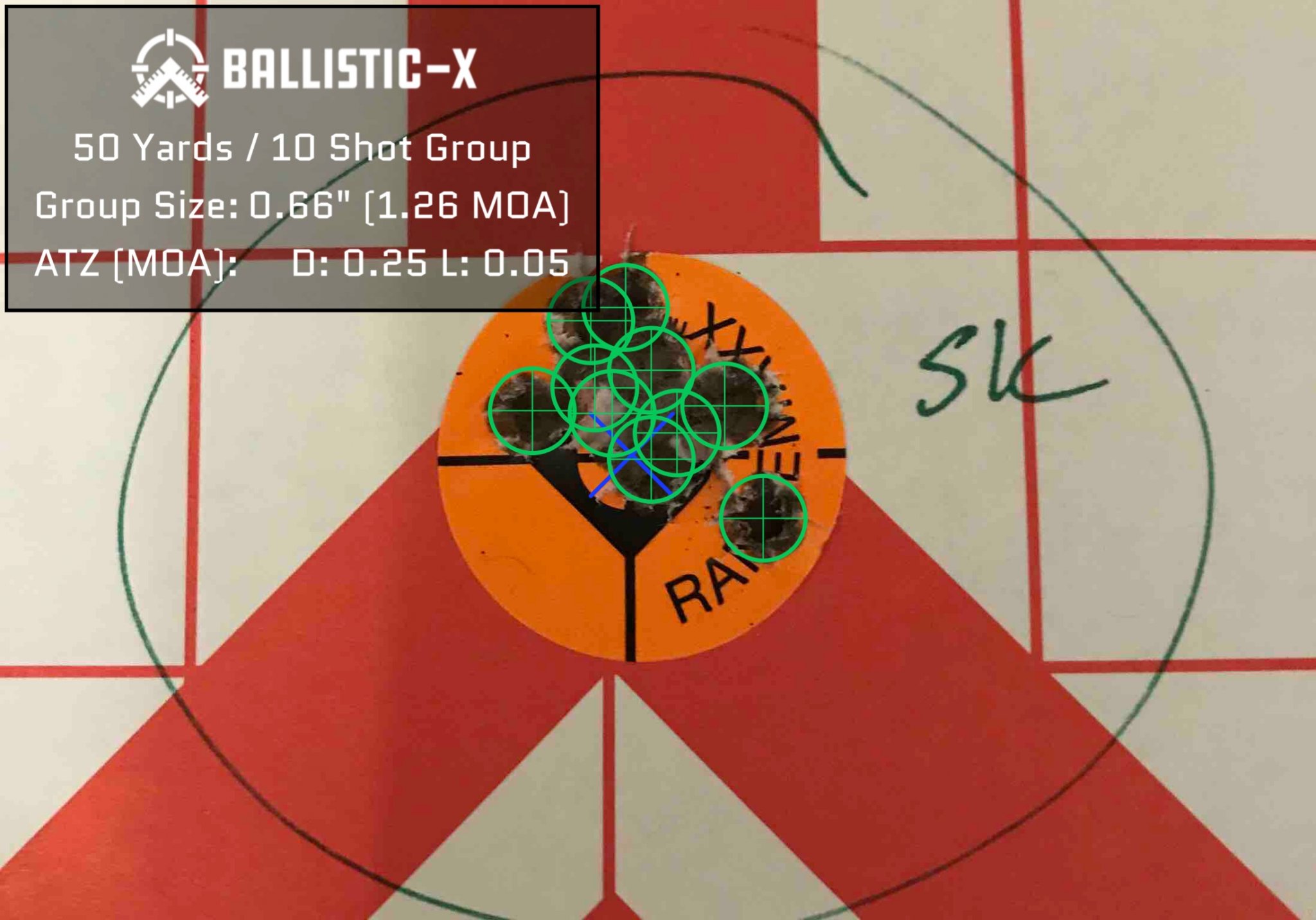

Ok here are the results from testing today. I had the best luck with SK Std Plus. I tried a 10 round mag, but. did not see any noticeable difference.
I did 10 shot groups @ 50 yards.
Best SK grouping was .66"
Not sure how this compares with what others are seeing. Thoughts?
