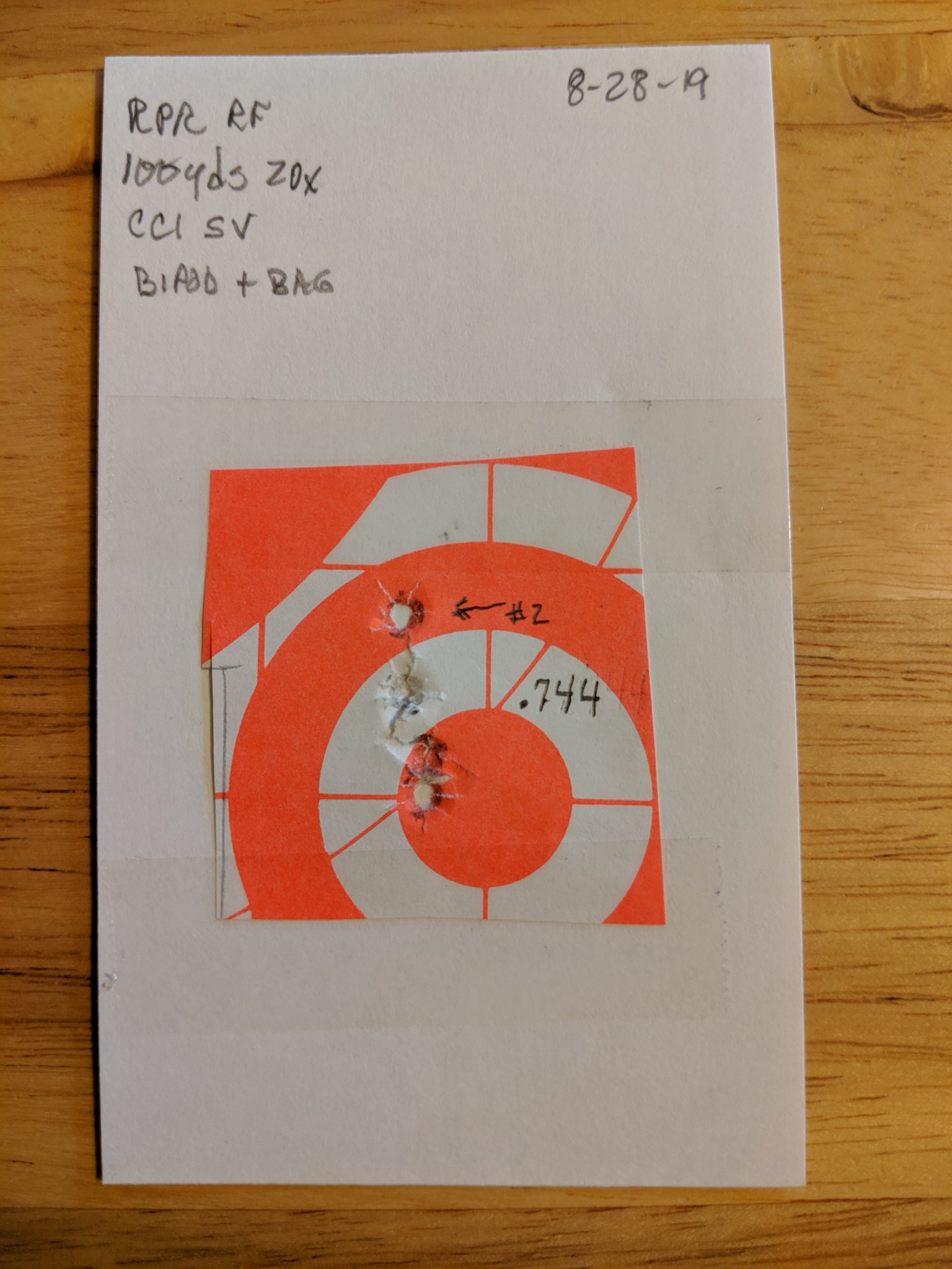

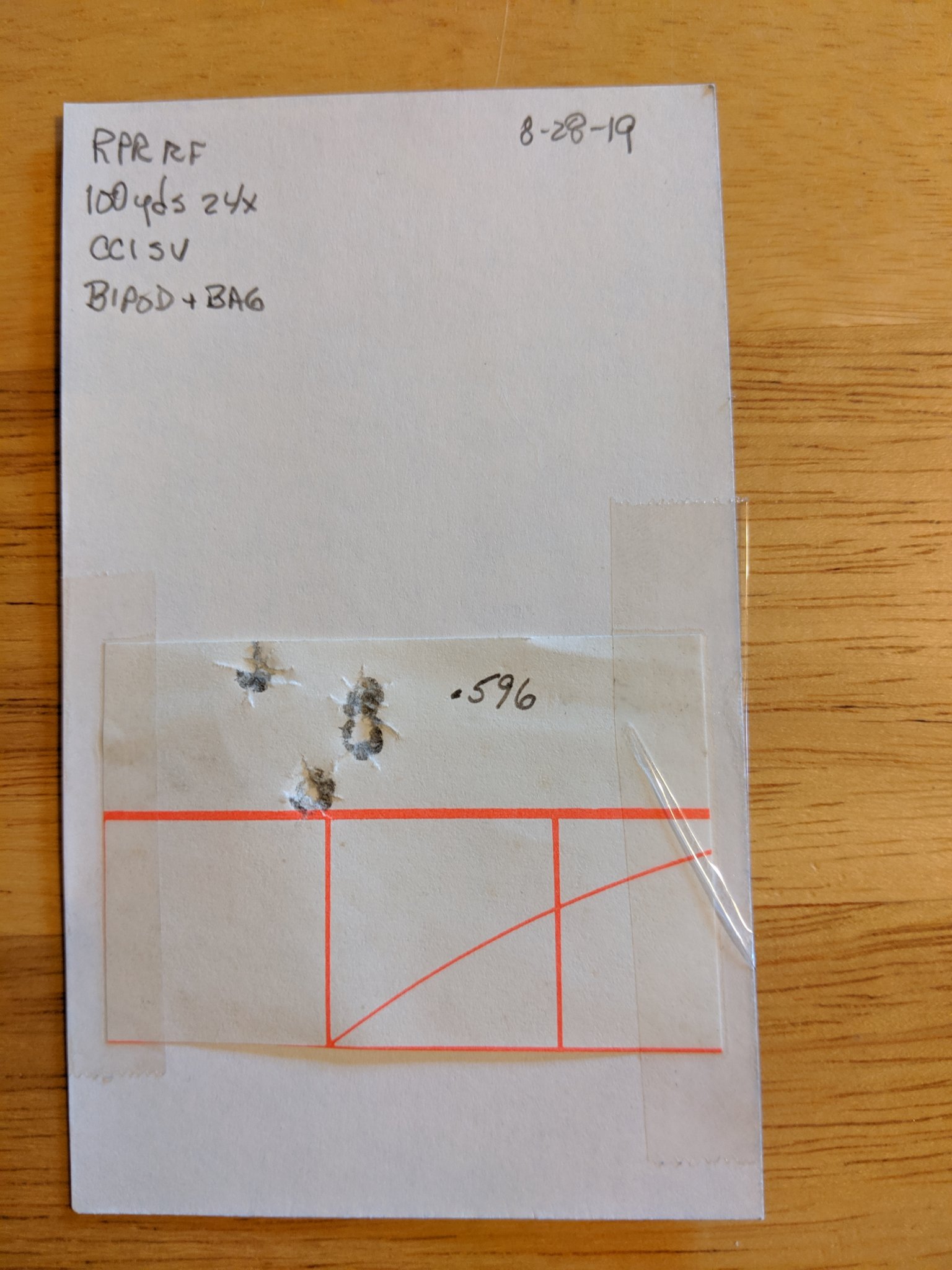

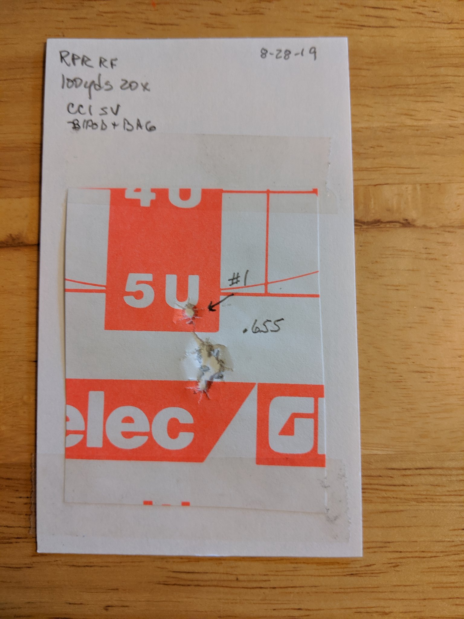

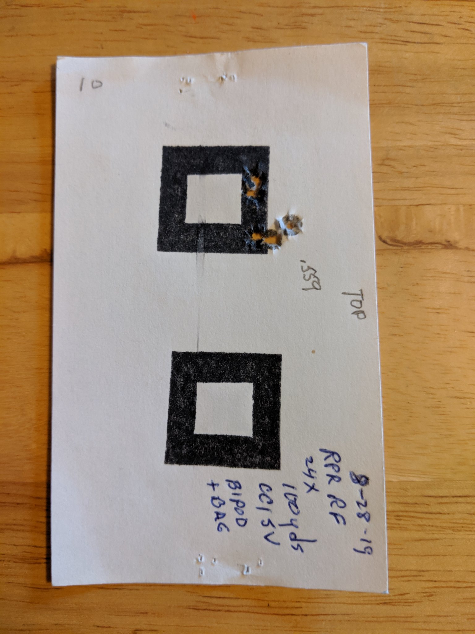

Bit of cherry picking here, but here's my best group of the day on a recent range trip - same ammo as before (CCI SV), same lot no, same setup - SSWA 10x, no bedding, stock trigger, etc off a bipod and squeeze bag at 50y... 5 shot group
I'll likely put the 6-24 back on it soon and see how it does reaching out a bit further, but again this particular sample smokes the one I had previously.

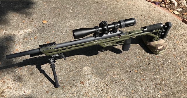

I solved my Ruger Rimfire accuracy issue........
Vudoo barreled action arrived today and I quickly put it in my MPA chassis. Problem solved. ;):cool:

Finally had some decent conditions at the range this morning. Here are a few of the groups I shot at 100 yds using CCI SV. Rifle is all stock with just minor polishing on the bolt bottom to prevent scraping the bullet during operation.
IMG_20190828_130006.jpgIMG_20190828_130018.jpgIMG_20190828_130034.jpgIMG_20190828_130046.jpg
