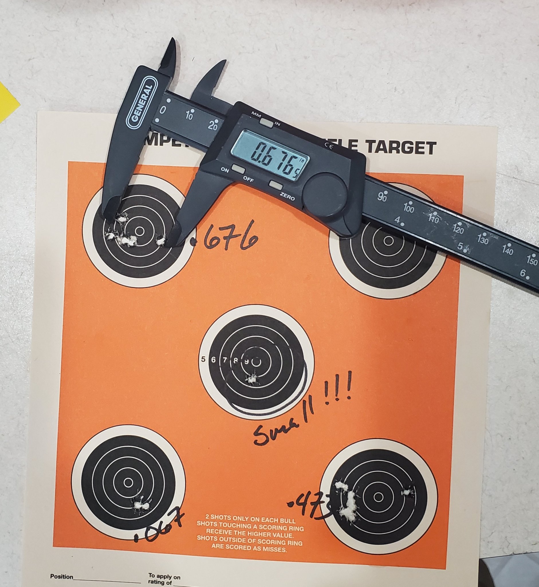

I measured my targets and as promised here are the small amount of result.s. I found one box of Eley Targt at our farm & ranch store, cost $4.69, and decided to try it. I shot three groups at 50 yards and was shooting into a stiff breese just slightly off to my right. Results for three groups were .447", .416", and four into .407" with one that just dropped opening the group to .636". I watched the crosshairs stay on the bull and the bullet impact low so I'm certain it was the ammo and not me. I moved to the 100 yard target as the wind was getting stronger and shot one group before I saw my flat tire that put a halt to my shooting. It measured 1.201".

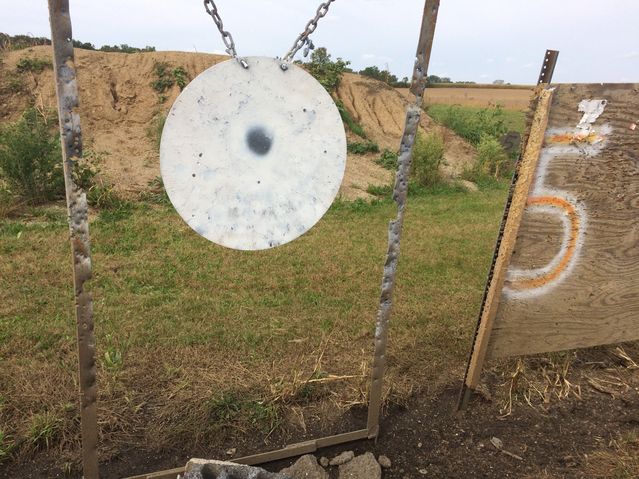

Went shooting this week, with my RPR 17HMR shooting at 100 yards with 15 rounds in each target except for upper left, got bored and went home.

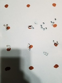

Shooting @ 1” dots @ 50 yards with cci sv. Just bought this rpr 22lr not too long ago, and all I did was torque the action screws to 30 in lbs and turned the trigger down. Trigger sucks by the way. Any recommendations for a superior trigger?

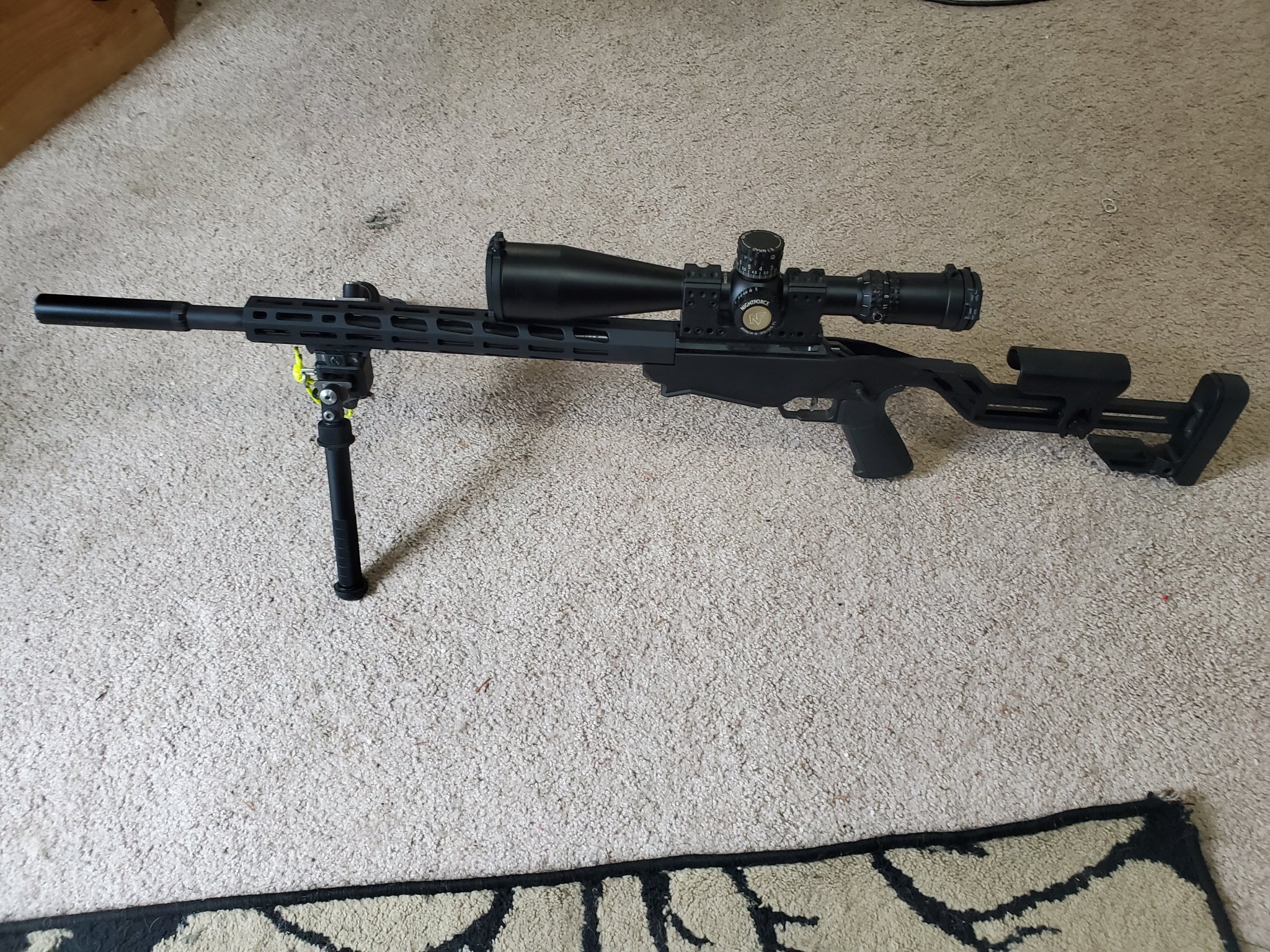

Here's the most worthy thing I have to post here. Very light, very accurate, very quiet. :)
Ruger 10/22 receiver and bolt
Kidd 16.5" Ultralight barrel (shown with AAC Element II)
Kidd complete FCG
Kidd bolt handle kit
Magpul x-22 (milled insert/freefloated)
Burris 2-7x
Shoots pretty consistent .5 moa at 50yds with CCI SV,

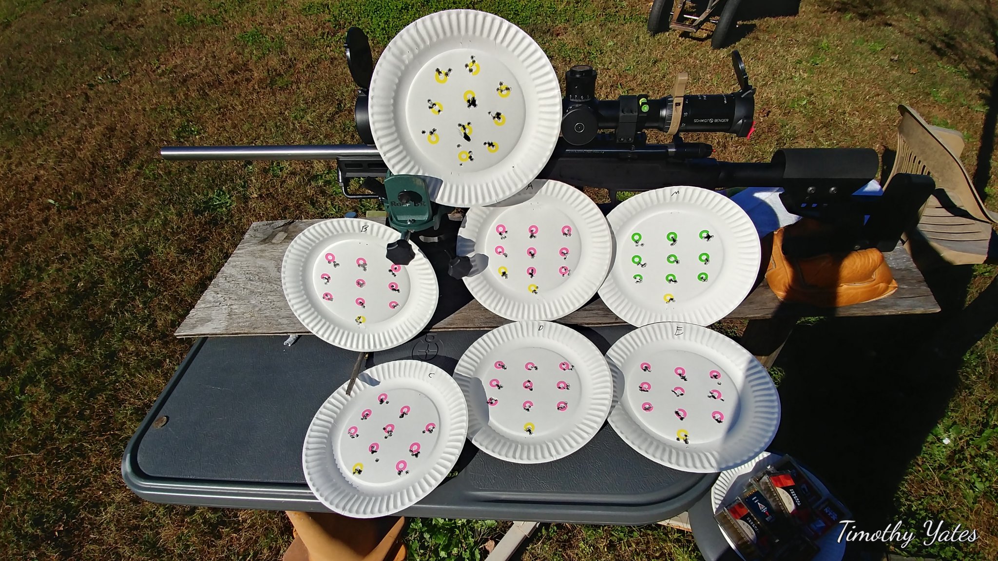

I had a few other boxes of ammo to try some with only a few rounds left so I didn't shoot the same number of groups with all of them.

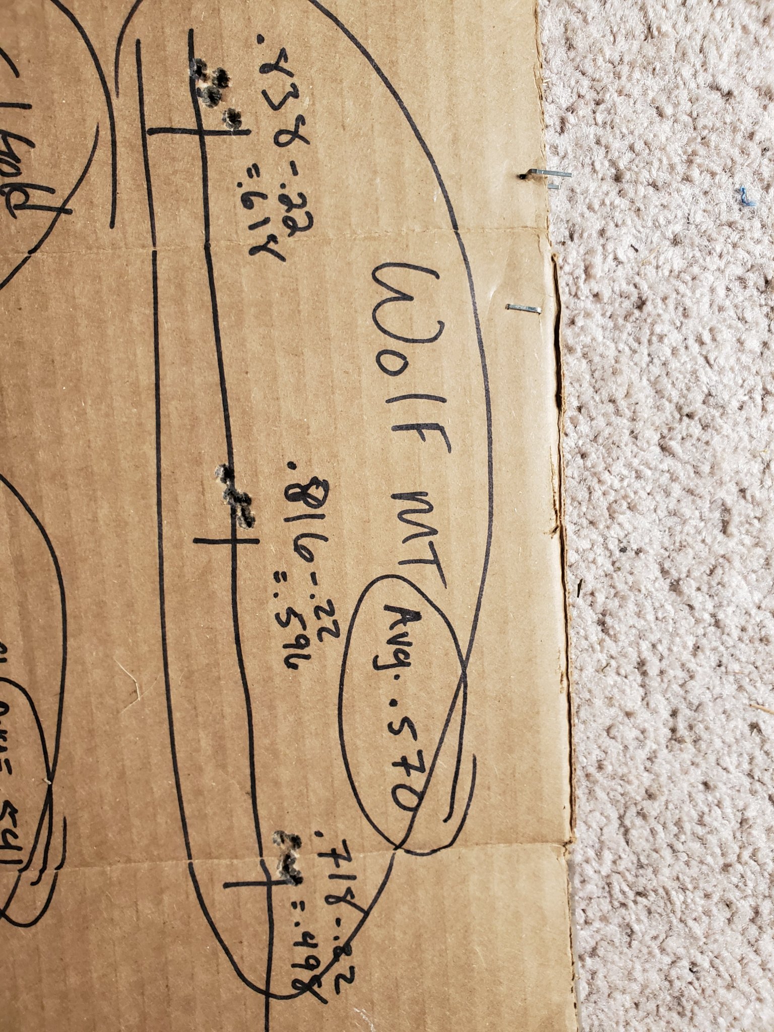

The Eley and Wolf MT all shot around or just over 1/2" the federal shot almost as bad as the RWS.
I'm going to play with some tension tuning so see if it tightens up at all. If not it'll be good enough for the boys at 1/2" at 50yds.

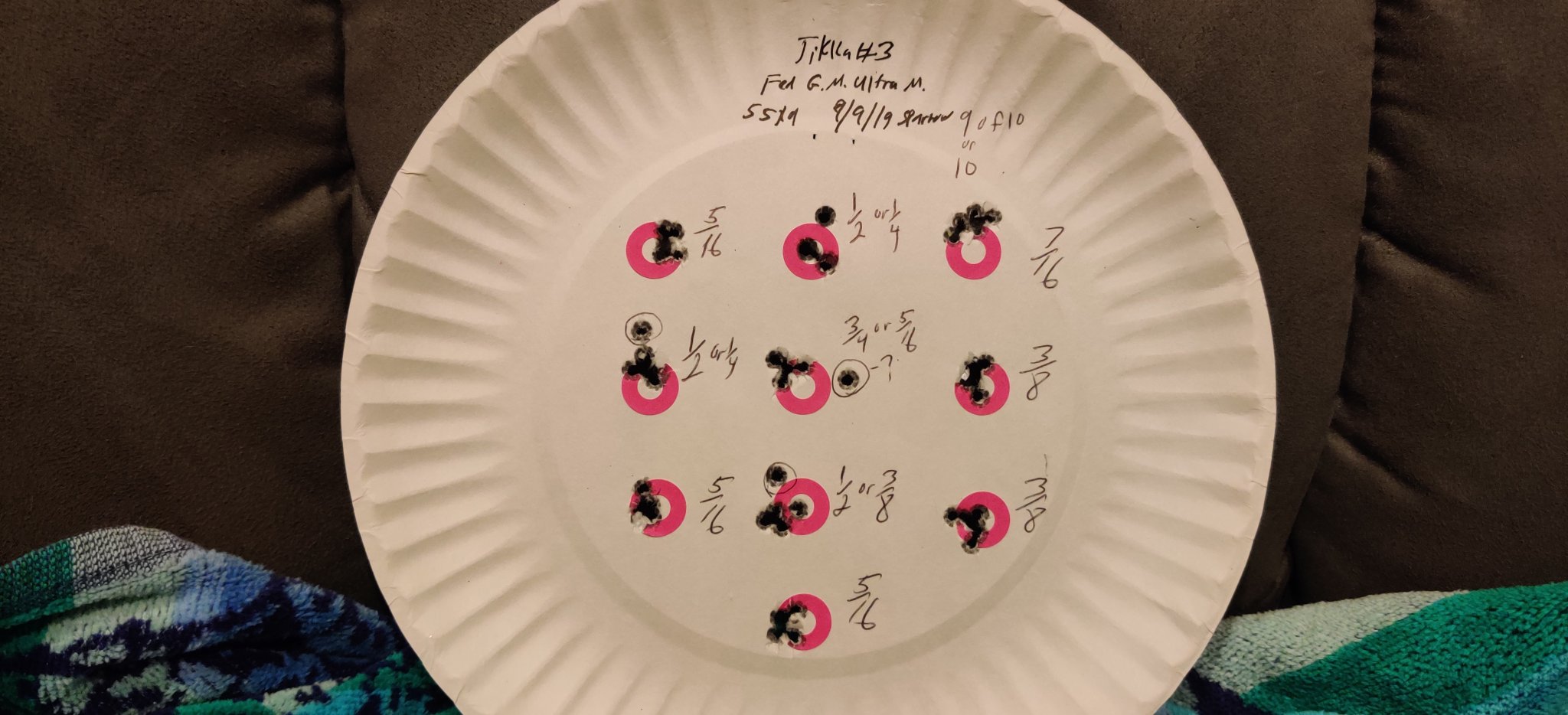

In the end, whatever you do, have confidence in your method and do it consistently. Here is an example, I shoot the same paper plates with the same size bullseye and don't deviate from that. This way I can accurately and quickly compare results over time and between different guns.
