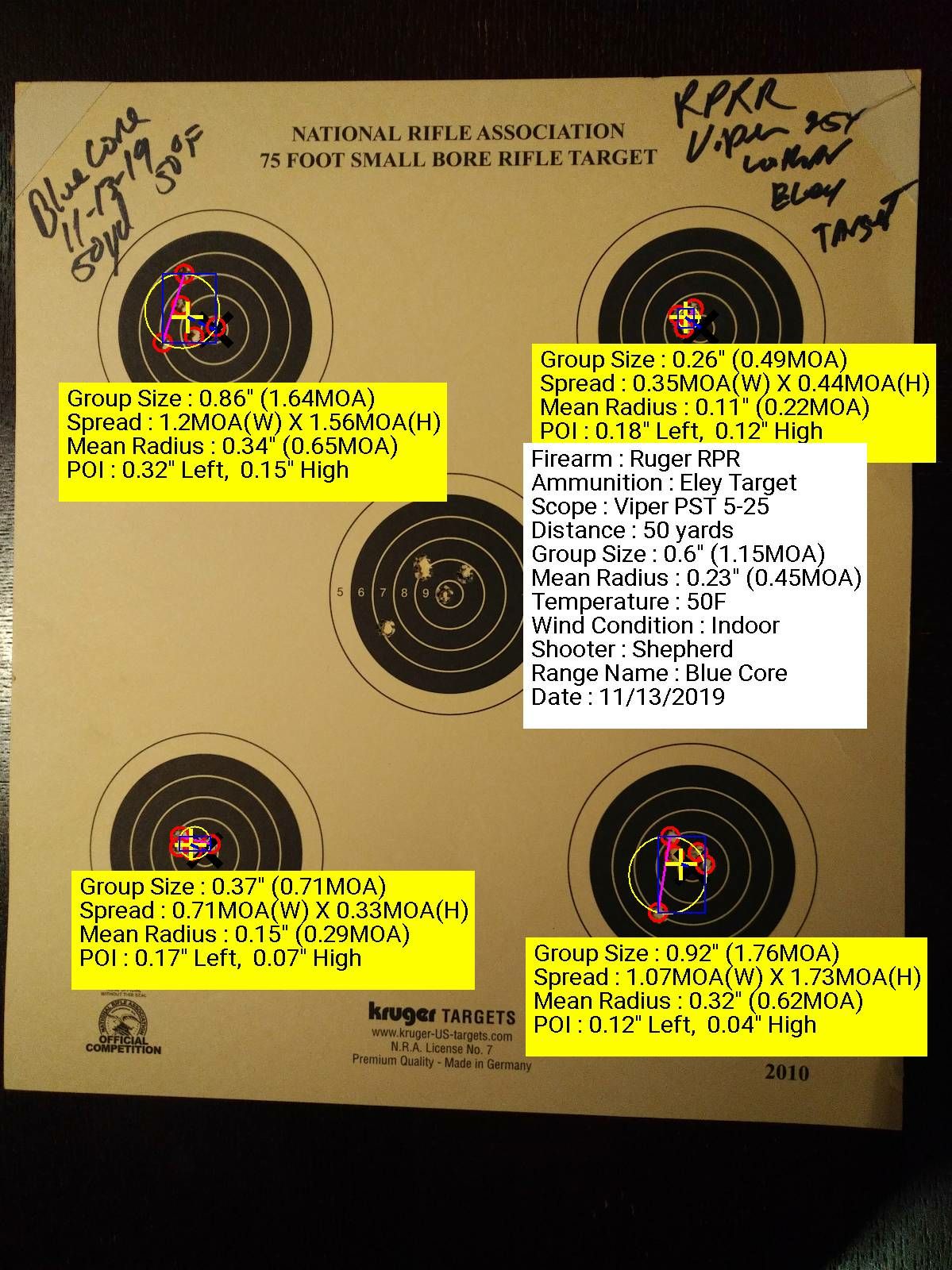

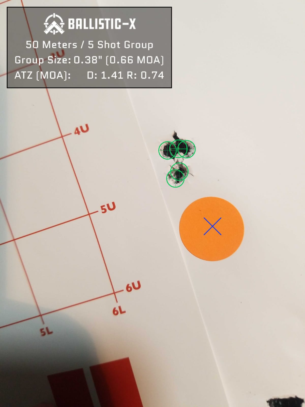

So I got the Lothar-Walther barrel mounted up and took it to the indoor range to break it in. I only got about 50 shots down the tube but it is looking promising. I did not feel like I was holding very good but there are a few tight groups in there that are encouraging.
With the Stock barrel I never got anything this good even with high end ammo. Hopefully with some more testing I can hone in on a good consistent performing ammo combination. I hope to get some more rounds down the tube this weekend. I will post some more groups after that..

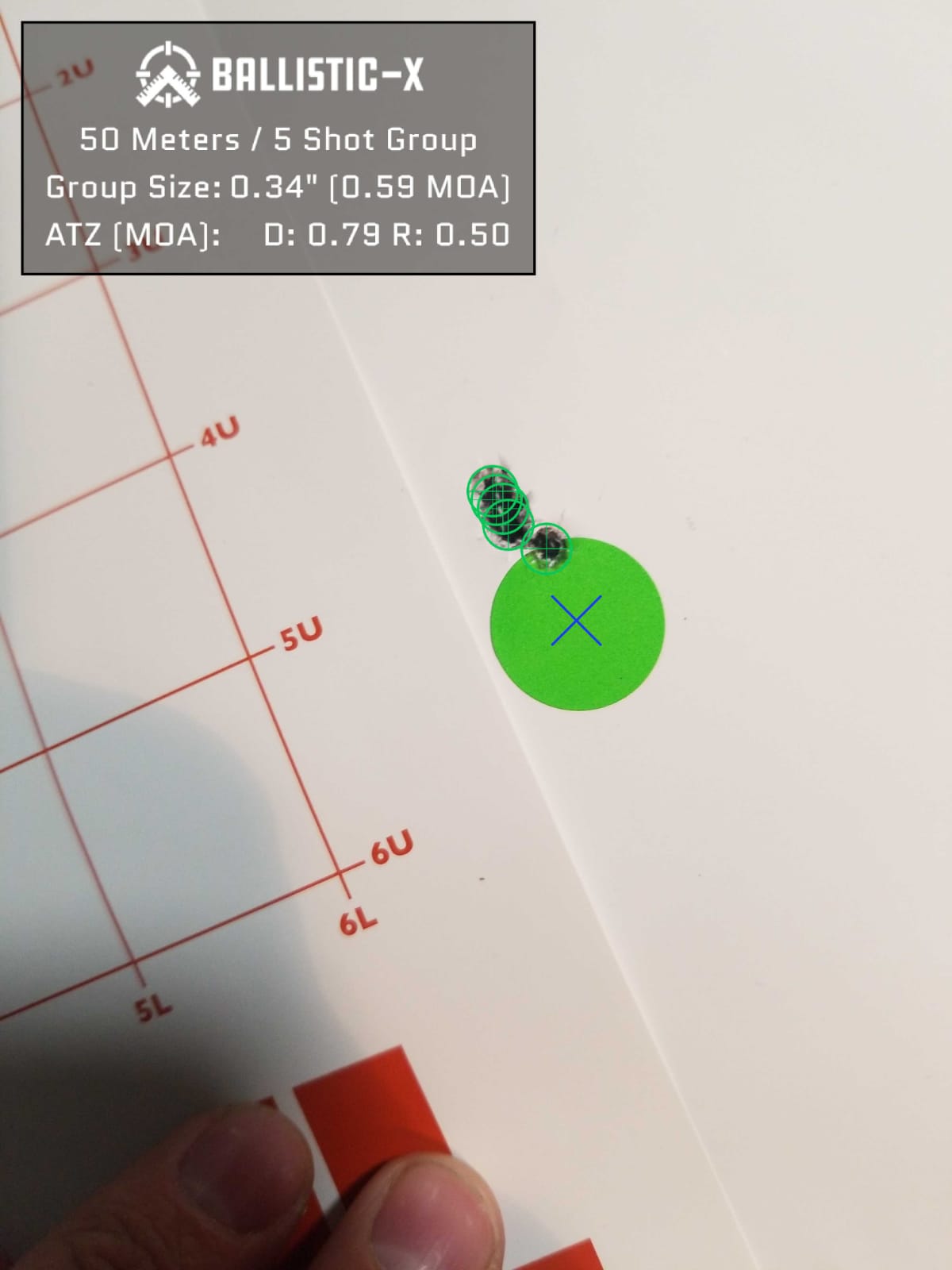

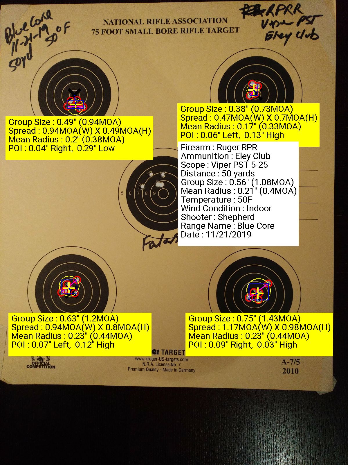

got some more time with the RPRR and the new Lothar-Walther Barrel today. I have about 150rds down the tube and I think it is starting to settle in some. I cleaned it before this session for the first time but it was not very dirty. I did have some problems with the Eley Club not extracting but no issues today after the cleaning. Also I think I am getting better at shooting this off the shaky bench.. :)

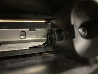

Mine is having issues extract spent casings from my match chamber barrel.
Any idea if the extractors are the same as the ruger American rimfire extractor?
Or is there a way to reshape it better?

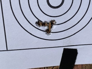

Mine is shooting about 1/2”@50 5 shot groups with midgrade ammo (RWS subsonic hollowpoints)
below is a picture fromTuesday session. Wing was blowing from my 8’o clock at 5-20mph.
Most groups are like this as long as I load the stock the same way each time.

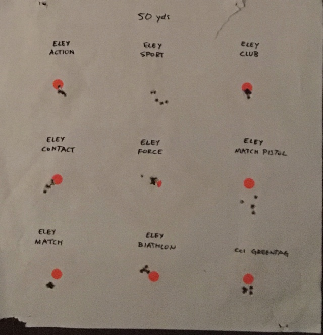

When I look at the 50yd results it looks VERY much like what I've experienced with the Eley products I've used ( the Eley Club, Eley Contat, Eley Match, CCI Greentag that's shown). Greentag was a huge disappointment (had bought a brick of it, expecting it to do well) as it grouped jut awful (Mini-Mags did much better). The Eley Club did so well, much like what's shown here, I went out and bought a few bricks of the same lot and have been happy with it since (especially at the price point). The Eley Match did well, like what's shown here, for me too and bought a bunch of that also. Two other cartridges did as well, actually better, was Center-X and Federal Ultrimatch . . . so yes, I got a bunch of that too. :cool: :giggle:

what's your issue? just that it won't extract out of a match chamber? bend the spring clip more. I literally did this exact thing this morning. the extract is too loose. so i compressed the spring clip a little bit and put it back on and i havent had an extractor problem for the next 200 or so rounds i put down the pipe today

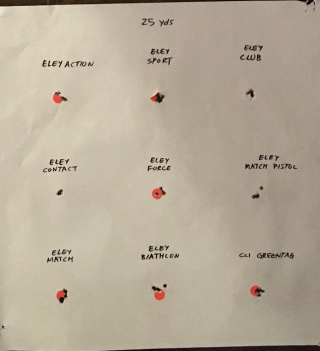

Attached are photos of the small test i did with the International barrels 22" barrel i recently received.

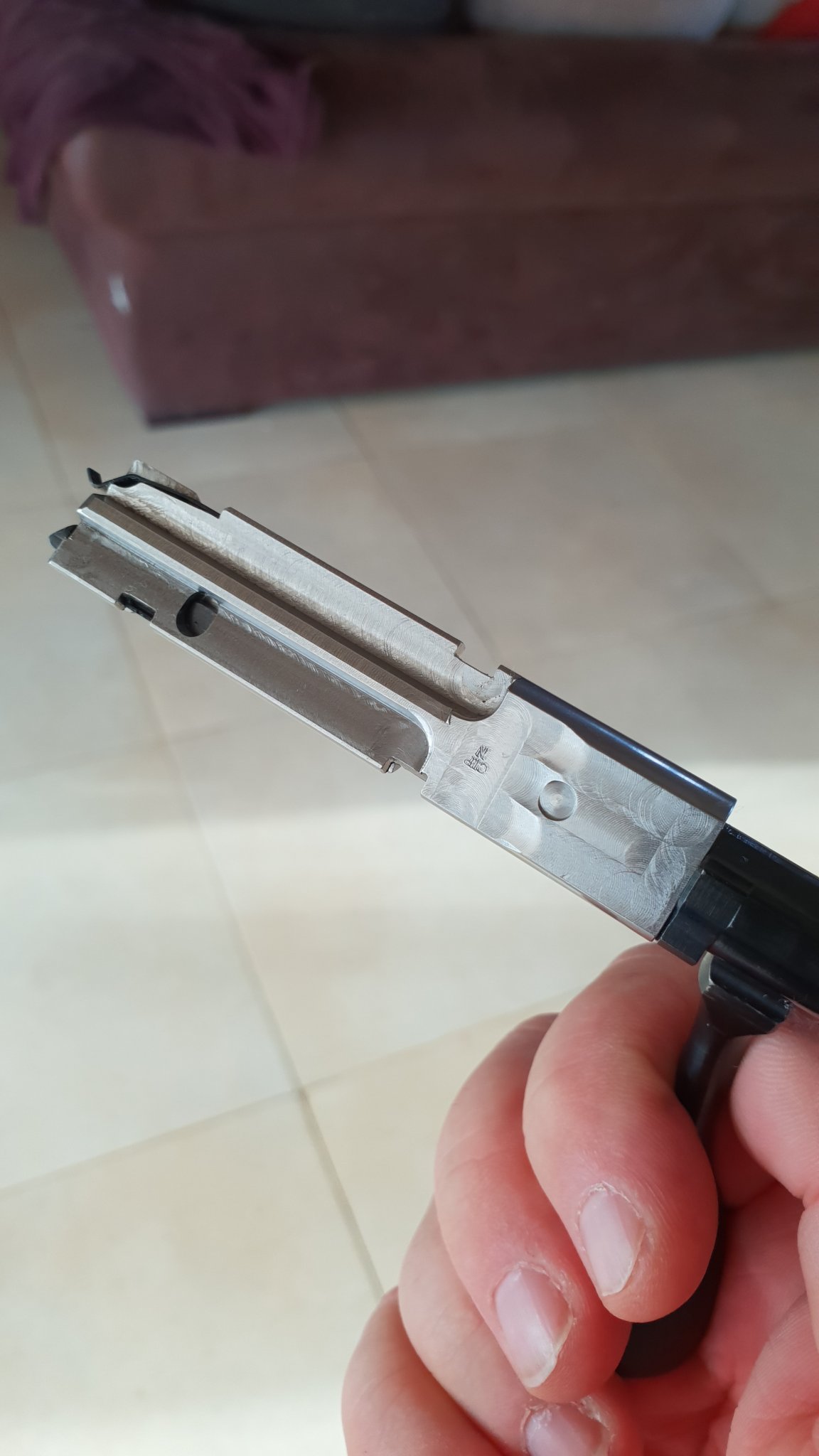

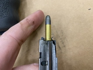

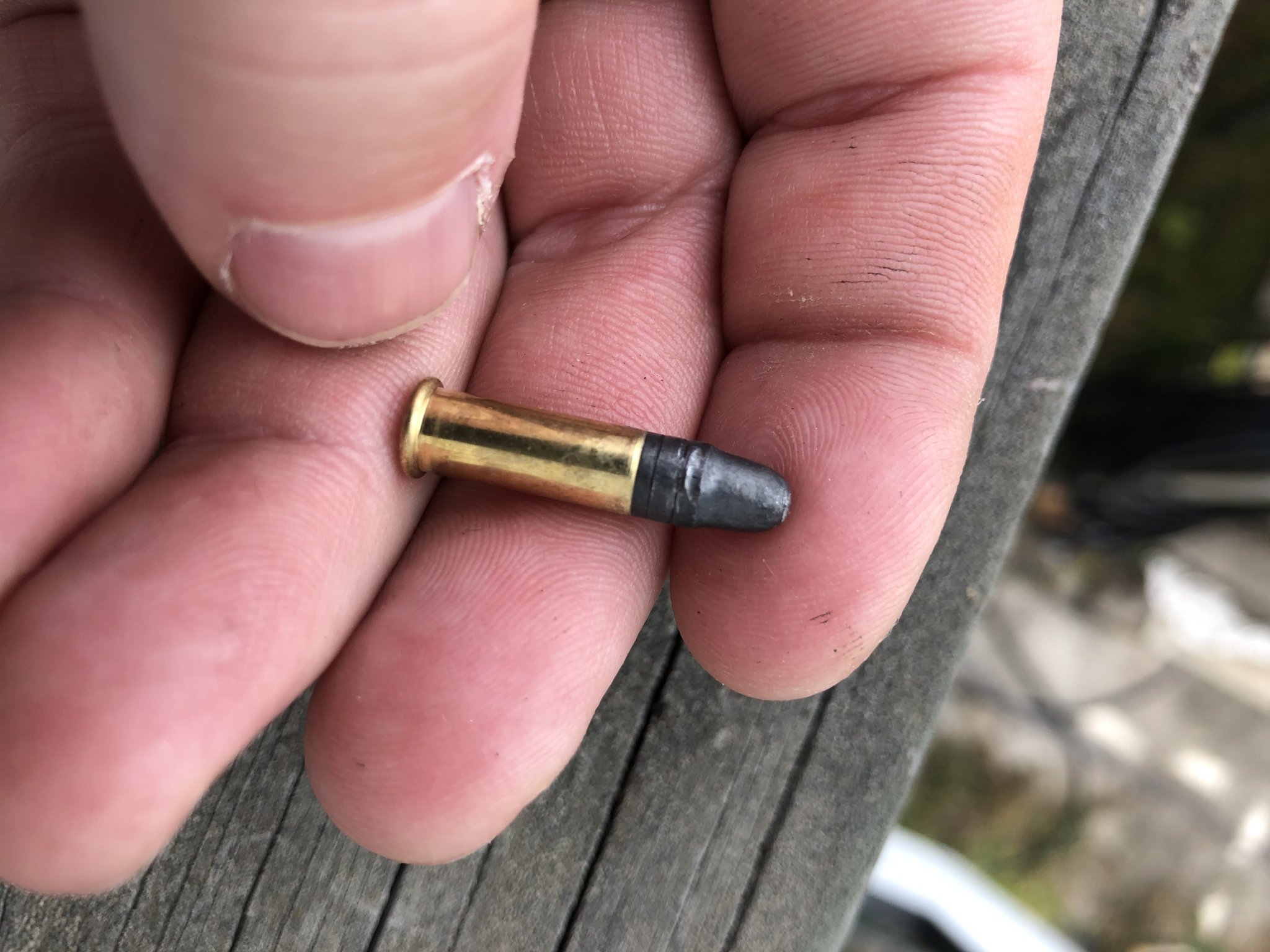

The spent casings keep getting stuck after being fired and I have to reach up and remove them by hand
If that doesn’t work (bending the clip spring) maybe I will look at the extractor itself

By far, most of the issues are with the ejector spring rather than the extractor. As I modified my ejector spring to have a tighter fit on a cartridge, I also sharpened up the tip of the extractor and also changed the interior angle of the extractor tip so the sharpened tip put a good grip on the case rim.
Before I did the little mod to the ejector spring, I swapped out the one from my Ruger American Rimfire as it was the same. When I did that, I had the same problem with ejecting as I had with my RPRR, so I knew then the problem was really that ejector spring. After the mods, I've not had a single FTE . . . though the ejection isn't strong, it's good enough and so I'm leaving it alone (if it ain't broken, don't try and fix it, kind of thing ? ). :giggle:

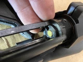

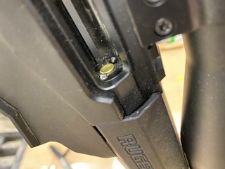

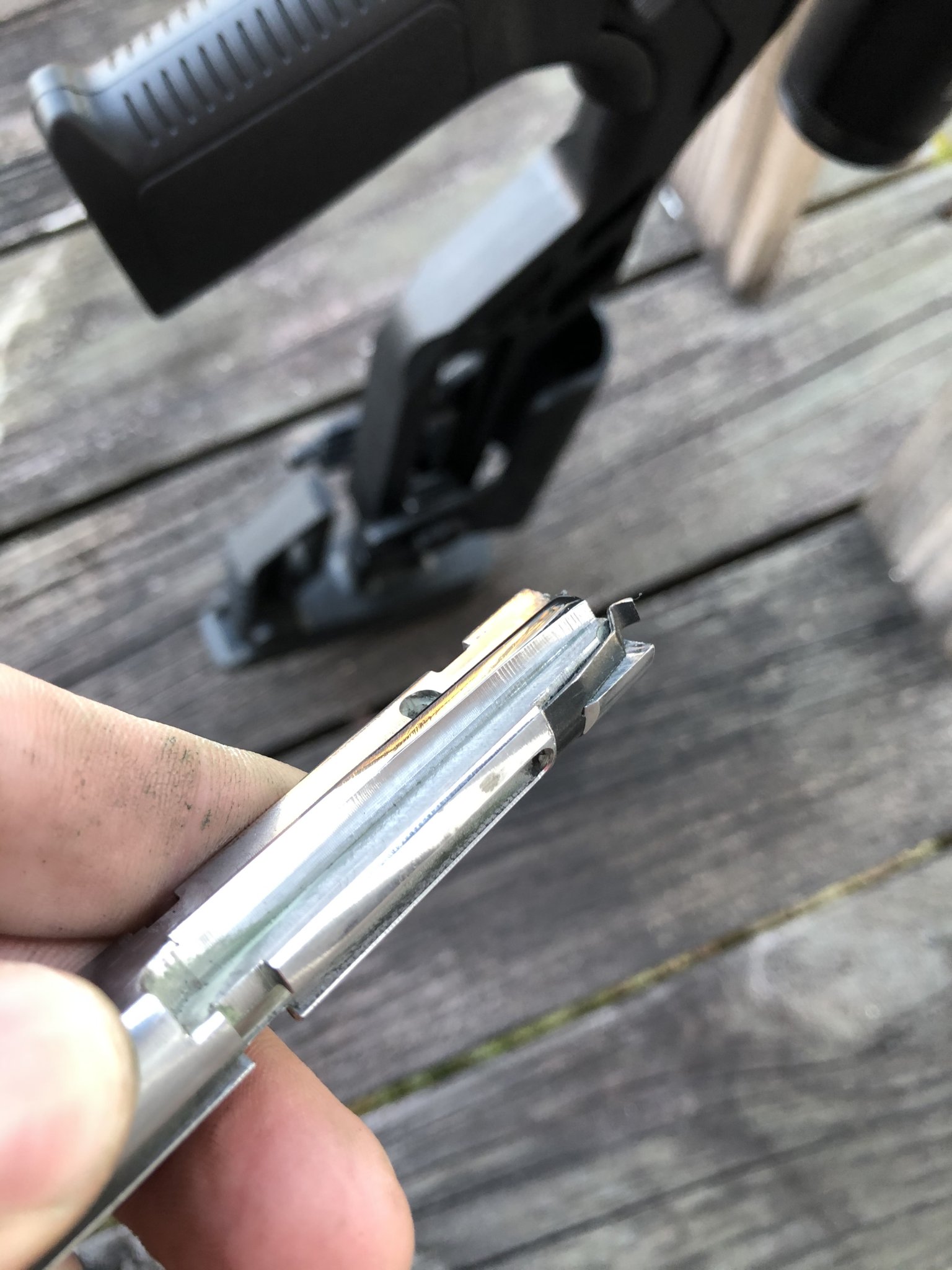

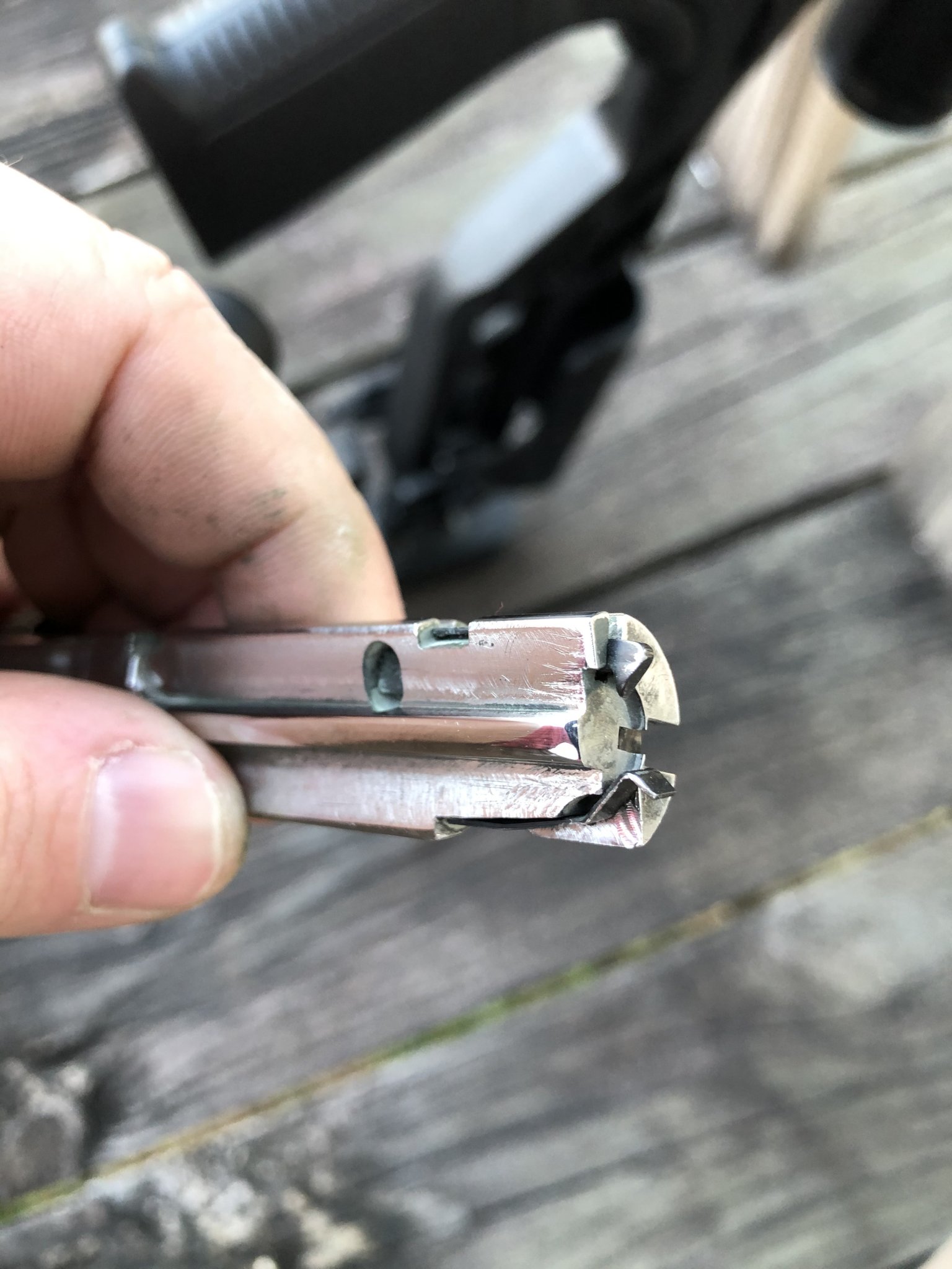

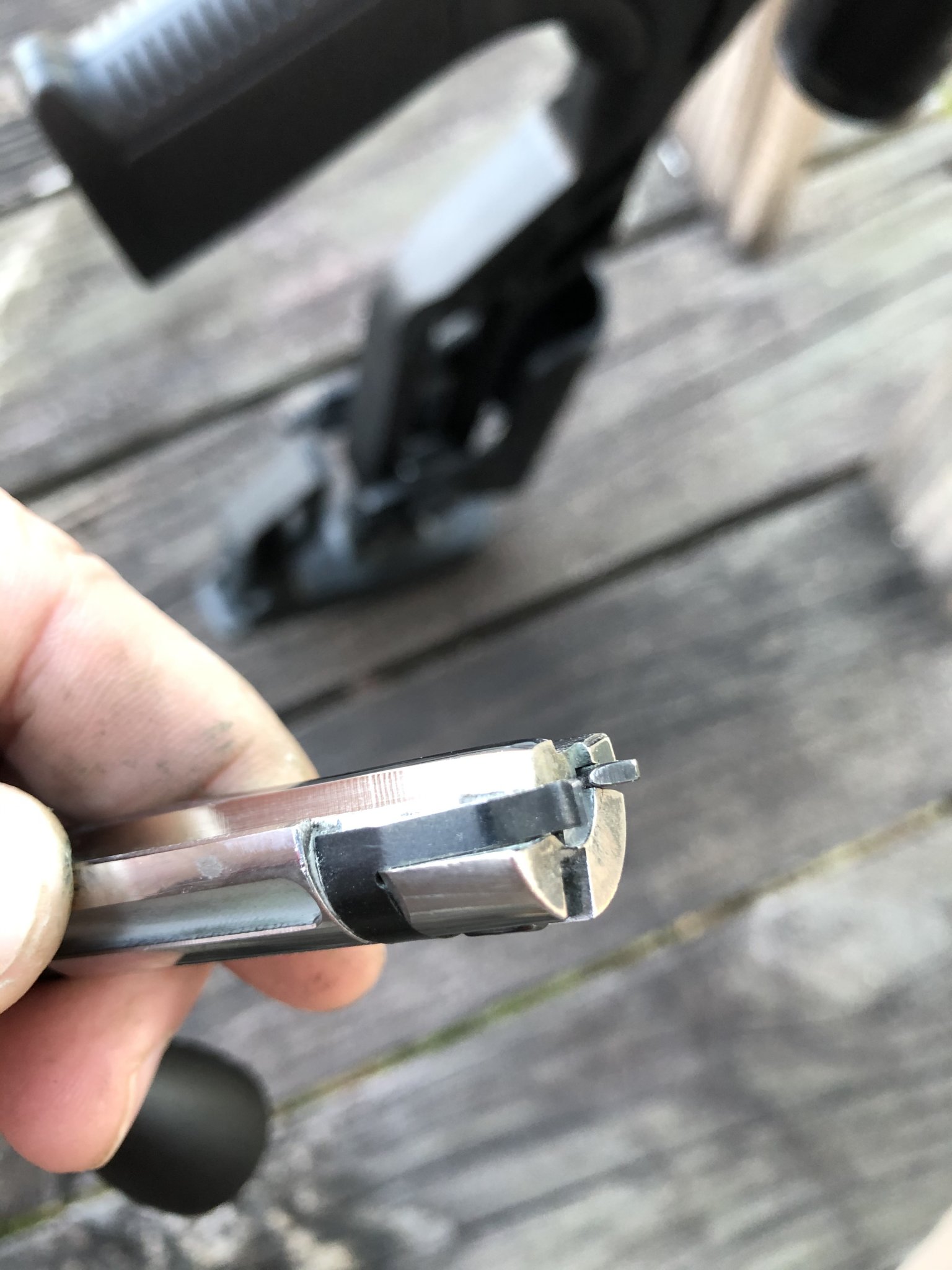

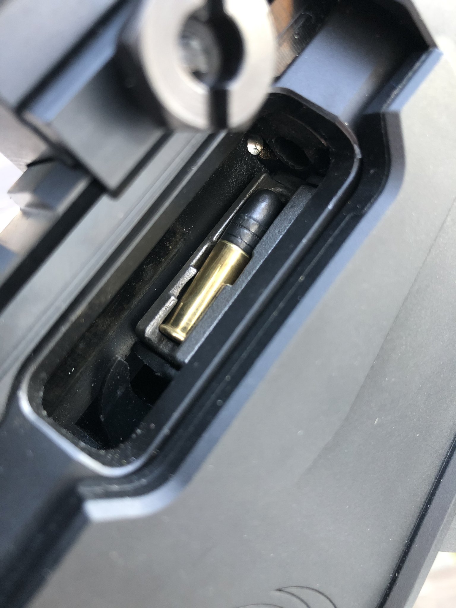

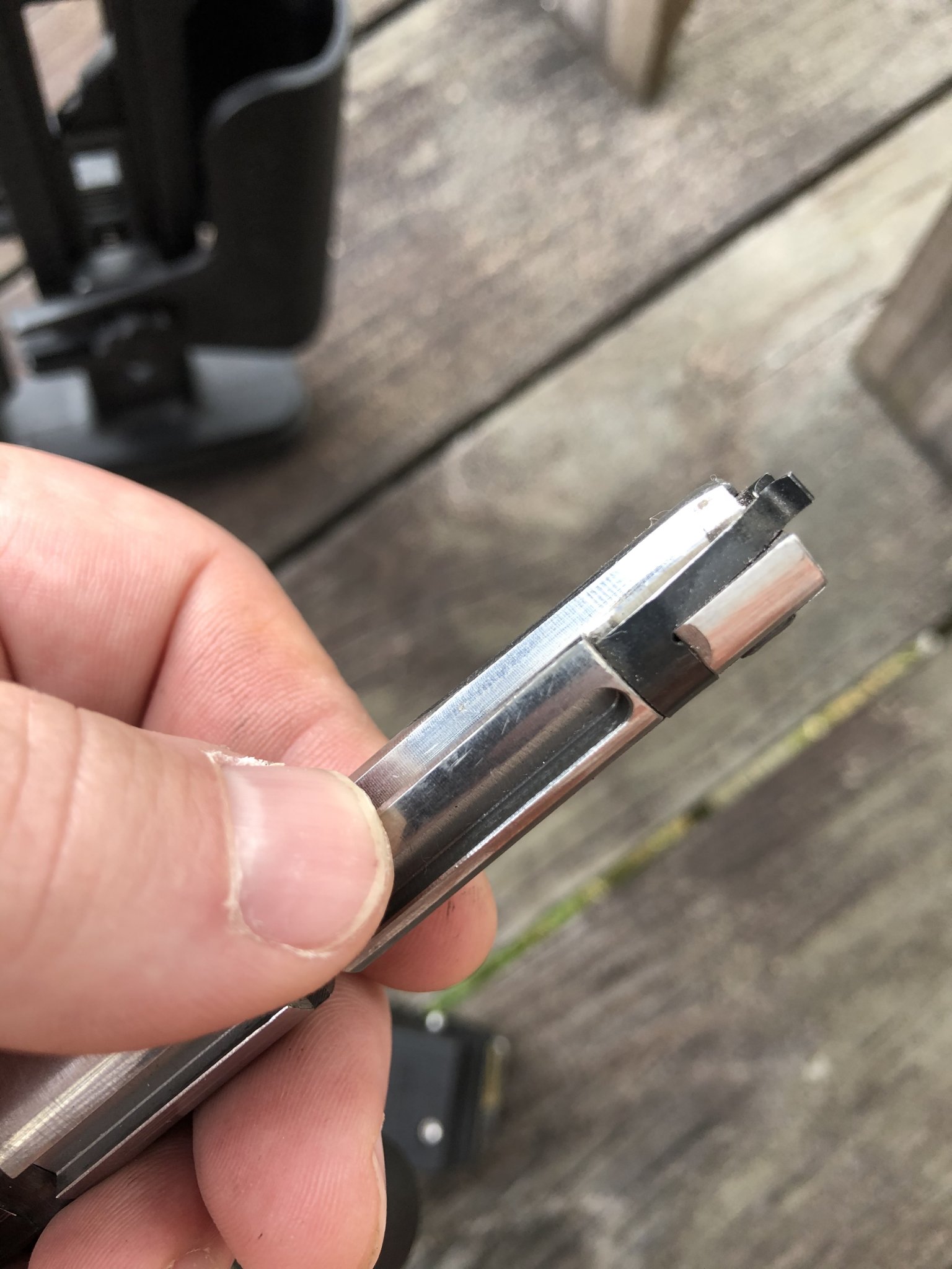

Here are some pictures before I bend it.

You wont see any change after you bend the spring clip. you will feel it when you try to pull the extractor out. Mind you dont bend the tip. take the spring clip off and just push down on it,

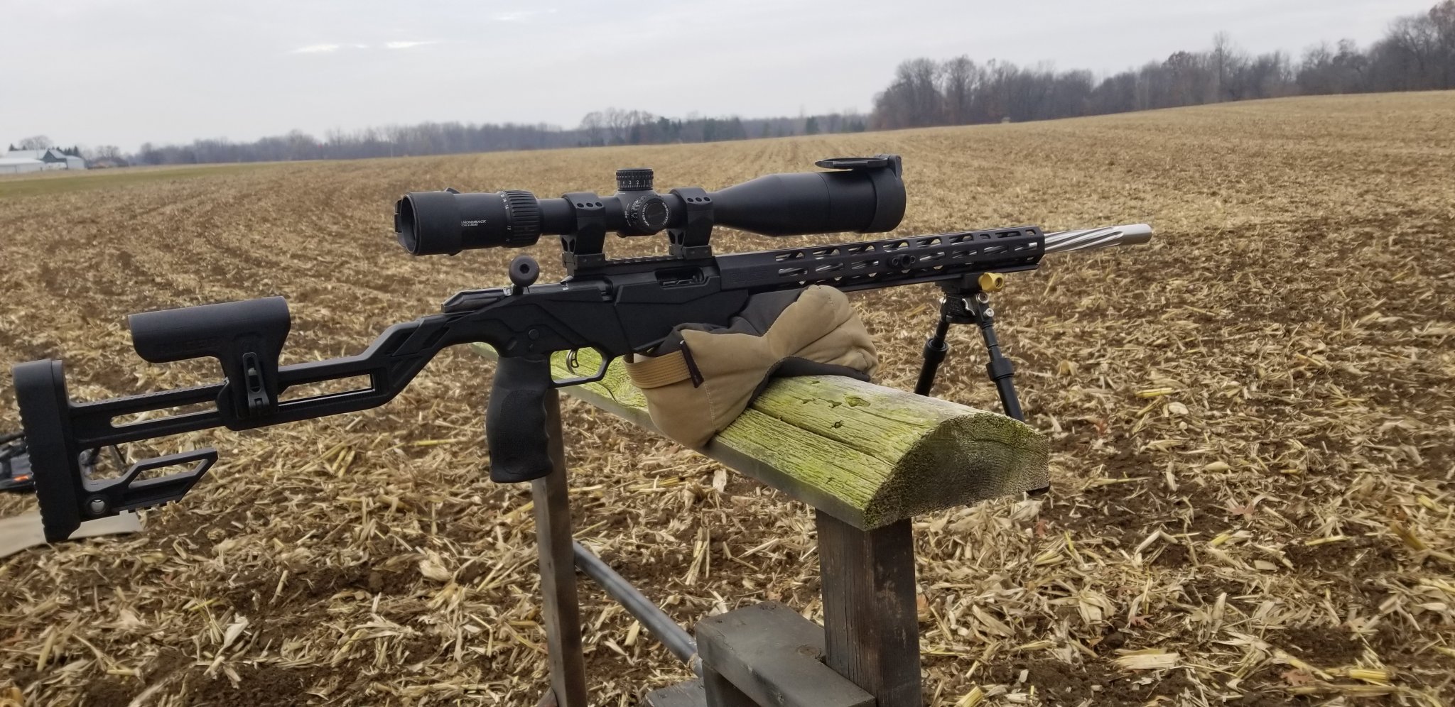

The factory barrel wasn’t too bad on the rifle. However I found that a Lilja barrel actually was a bit better. (I’m not sure the expense of the Liljia barrel was justified)...
My one big complaint about the rifle is that the stock extended is anything but steady.
overall I think the rifle is a big pass compared to other options....

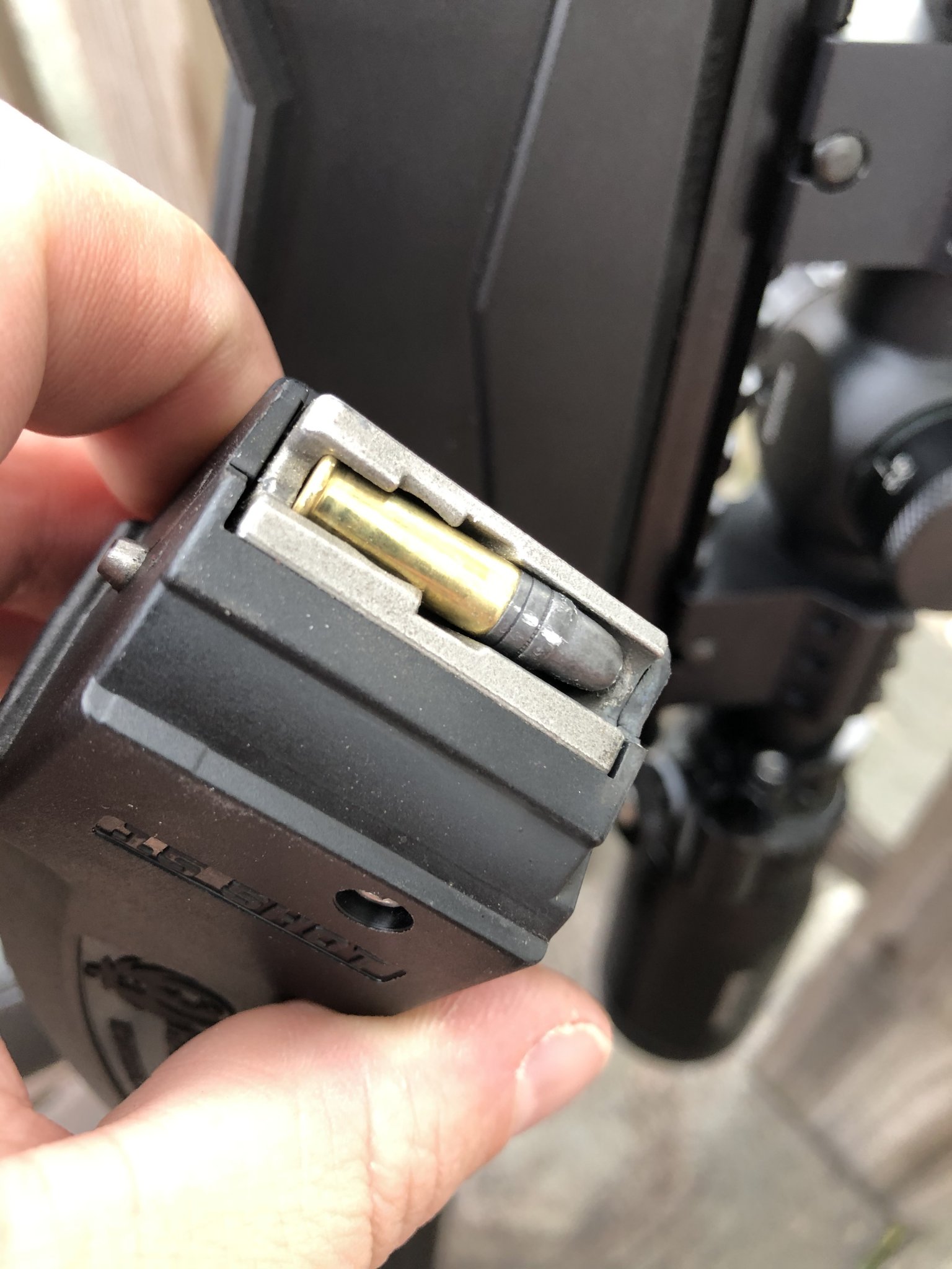

I also found that using Butler Creek "Hot Lips" magazines feed the round straight into the chamber and I never had any feeding/extraction issues with using them. I also found that when the temperatures went below 70 degrees, I'd get more first, second and third round flyers. Huh? It's one reason why I use the 25 round mags.

The standard BMX mags have the rotary feed device that feeds the round into the action, so the round goes into the chamber at a little bit of an angle. They also aid in the ejection of the round which is probably something that the 10-22 needs as its an auto loaded and that's what the mags were designed to work in.
The Butler Creek "Hot Lips" mags don't have the rotary feed like the BMX mags, and they feed the round straight into the chamber. The feed lips are made of plastic so they don't scratch the bullets. I probably ran close to 10,000 rounds through mine before the plastic wore down to a point where I started to have feeding issues. But at that point I put the Shaw barrel on and the Hot Lip mags didn't work well on the new barrel so I went with the regular Butler Creek mags. The BMX mags just felt clunky to me.

Here where I am at so far with filing the bolt. I do have a question on how far y'all brought it down. I have filed what I would consider a lot off the bolt. It still chambers a round fine no issues but I do still get nicks on my bullets.
I'm using the ruger 15 round mag, I haven't ordered any other mags yet.
I also just noticed this band where it is hitting the bottom of the chamber as it enters. So I figure this maybe more of a mag issue.
The Ruger 15 & 25 round mags in particular are prone to tilting forward, which leaves the mag follwoer and thus the nose of the round, out of alignment with the bore. That leaves the gouge on the bottom of the round.
The line on top is from the bottom of the bolt as it pushes the previous round into the bore. As far as how far to take polishing the bolt, the idea is to make it as smooth as possible, without removing much material. I'd round over just the front edge by the extractor, just enought to take the sharp edge off, then hit it with a jeweller's rouge along the whole bottom of the bolt.
Disassembling the bolt might be helpful before polishing.
This is an Anarchy outdoors video about installing their swept back bolt handles (great feel on the swept back bolt handles and the dragon scale knob, by the way). The first part of the video shows the bolt disassembly.
Got it polished this evening. No marks on next round in mags. Woohoo. Lol.
Didn't see any dents from bullets engaging the chamber bottom but that can change due to the factory mags being sloppy. Butler creek mag should be in next week.
Will try to go shoot this weekend to see of polishing the bolt had any effect of accuracy.
I don't have feeding issues or marks with my RPRR, but I don't use the 15 & 25 round mags. I don't like the 10 round BX-1 mags being totally flush, so I bought some of the Double Kross BX ROtary Mag doublers. This has the dual advantage of the lower mag giving a spot to grip when changing mags, and putting your second mag already in hand when needed.
In addition, they fit MUCH tighter in the magwell on at least my RPRR.

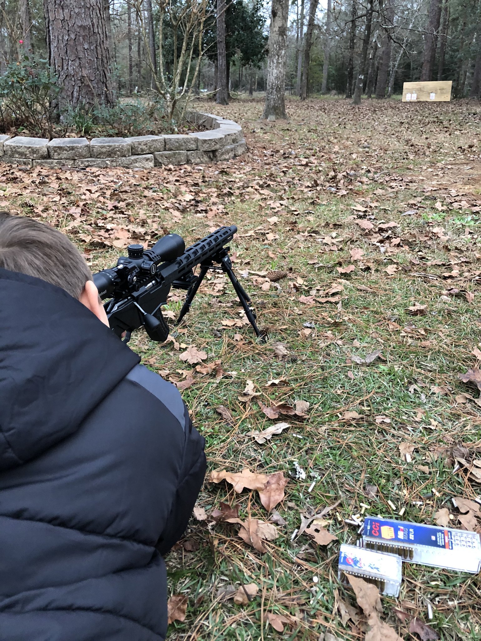

This is with the cci stingers I believe on the box they are 1640. I don't have a chronograph so I don't know what they are doing in mine.
First grouping with these was around 1.5” @ 50 yards. This one is a little over 3/4” and is 15 shots @ 40 yards. I am hoping the more I shoot it the better it will get. The only thing thing I have changed since previous shooting was polishing the bottom of the bolt. I am very impatiently waiting for the arrival of the mag and new ammo.
This is kind of my first step in shooting precision rifles. I have always been a shotgun guy. I know there are much more precise 22lr rifles out there but this one will help open the door especially since the kiddos love shooting it. First time shooting prone as well.

Not bad for supersonic ammo. You already said you had ammunition options on the way, so I won't belabor the point, but ammunition that transitions from supersonic to subsonic during flight has a relatively huge negative affect on your accuracy.
In general, try to use something at around 1000-1100 fps,, and your consistency will improve a fair bit.
