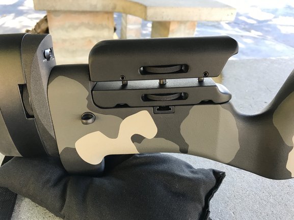

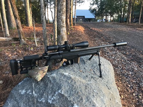

I did a couple tweaks to the -22. First some paint, Custom Coatings did a great job. Second and more important I put in an adjustable cheekpiece made by Terje. I cannot recommend his work enough. He did an awesome job. Being able to dial in the cheekpiece height really made a difference to my consistency. I still need to have it painted.
Reactions: lambsey
I also finally got around to doing some load development. Holy S**** Short Action Customs did a great job on the barrel and action truing. It LOVES 123 Scenars with 42.6 grains of H4350. The 2 fliers were me not the rifle. Also worked up a load with Berger 140 VLDs with 42.4 grains of H4350. CCI BR2 primers and Norma brass in both. 123s

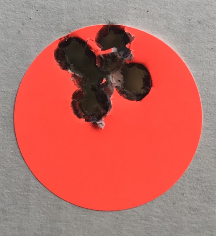

Initially I was not seeing the accuracy I was expecting. Once I dialed in the ergo stuff the groups tightened up. (Picture attached, fliers are on me.)

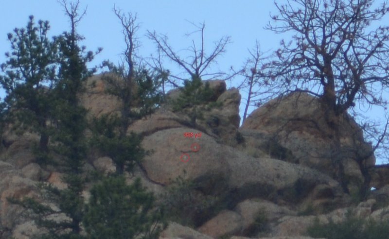

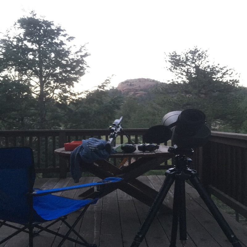

Joined the 1,000 yd club a few days ago with my 22 in .308
Lased range was 998 w/ 11 degrees of upslope. Kestrel called peak wind of 2 mph in direction of fire. Elevation from shooting location is 8500 ft.
Calculated holdover was 27.68 MOA for elevation and 1.3 MOA for wind. Actual holdover was 25 MOA based on previous shots at 615 and 900. Couldn't be bothered with wind.
Pushing 178 ELD-M in 4th firing Lapua with Fed 210 primer and 44.1 of Varget
Rifle: post-13 TRG 22 in .308 26" barrel with about 850 rounds down the pipe, Vortex Viper PST 4-16 in Vortex match rings, Harris and Little Bastard Break. Can't remember what the bipod adapter is.
Was aiming for slight crack in the rock face. Shot on the right is mine (pulled at last second) and left one is my fathers after I talked him into it. POA and POI were dead on for his shot.
Truthfully was not a difficult shot to make given the conditions and the always amazing quality of the TRG. Hardest part was just shooting off a rickety ass table with only a bipod and no rear rest - still was cake. 1.jpg

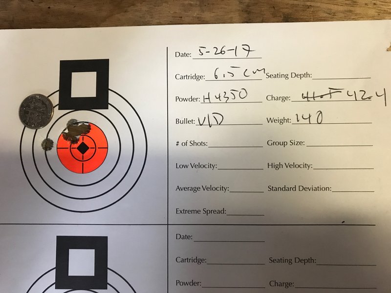

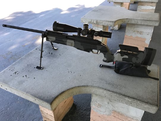

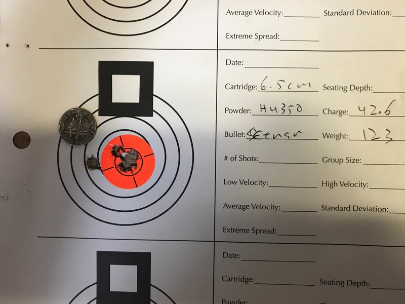

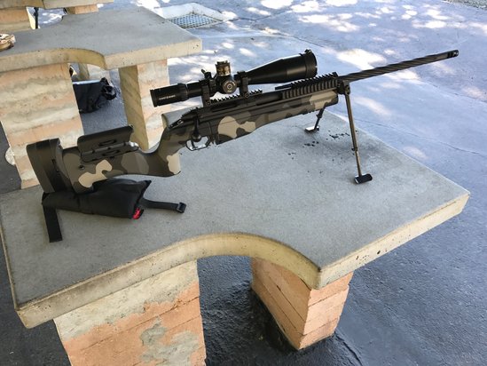

Some crappy pics of my TRG-22 in 6.5 Creedmoor. I will post better ones when I can. Specs:
Action trued and barreled by SAC. Bartlein 24" Sendero with spiral fluting, little bastard brake. LOP adjuster by Terje. Badger 35 MOA rail with Badger 1" rings. Flatline Ops articulated anti cant with Sniper tools Cosine indicator. Harris bipod with ARMS #32 throw lever. I can't remember the brand of fore end rail for the bipod. It is topped by an S&B PMII 5x25 with H59 reticle. It is a dream to shoot.

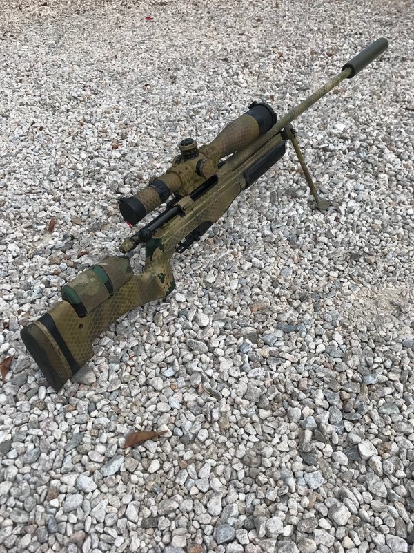

Nice looking 22. I bet it shoots as well as it looks!
Did you use the Custom Gun Coating in North Kansas City? Is the pattern their 3-color Standard GAP? I am thinking of doing the same.

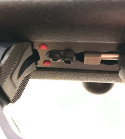

Im trying to lighten the trigger on it and I know the directions say to loosen the screw that is in front of the trigger but not to loosen it too much or remove it. How far can I back it out. I've included a picture of the screw so you can see how far out it is.
michiman if you have the newer version of the trigger (polymer guard) there is an Allen screw that limits the amount you can back it out. If you have the older version there is no limiter. If you back it out too much it would be bad. (Might need to be sent to Beretta to be fixed.)
In theory the trigger weight for the newer trigger is between 2.9 to 5LBs. I *think* the older version is 2 to 4LBs Mine (TRG 22, old trigger and M10, new trigger) are both set at 2.2LBs.
I would recommend backing it out 1/4 turn at a time and check the weight with a trigger pull gauge. I wouldn't bring it below 2.2. If you start to feel resistance when you are backing the screw out stop.
Thanks for the response. I have a metal trigger guard but I also have an Allen screw limiter. I know the rifle is a new production as it was just released in the 6.5 creedmor caliber. So I'm not sure. I guess it could be that they've started to make the trigger guards metal again?

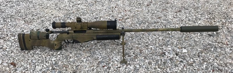

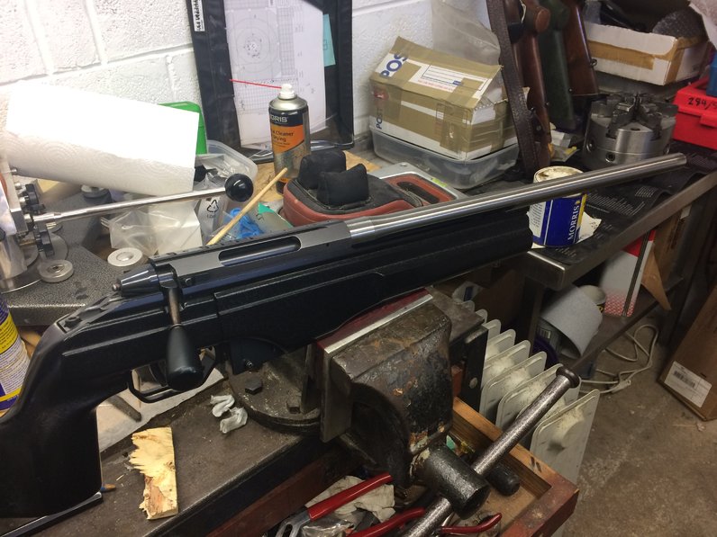

SAC turned it around remarkably quick ... here are the pics they sent over. I will repaint the stock (probably DuraCoat) as soon as I get it. Looks great to me. Thanks to Mark and Sara at SAC!
EB70C3EB-C7BA-4406-A7D9-98305FAC9D83.jpeg I am likening the colour combination. I have just had my older TRG 22 barrelled in 6.5X47. I think I will copy the green. Ignore the bolt knob it was put on but the previous owner. I have the original back in place now.
