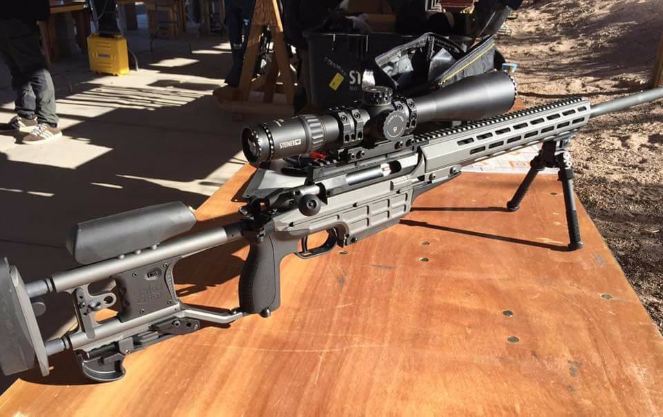

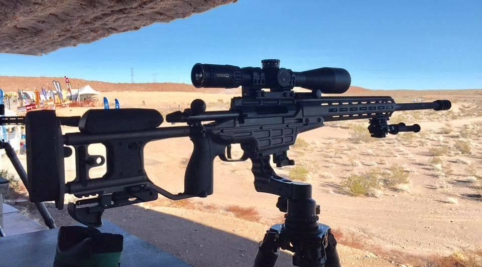

I heard that Sako is going to release M10 in 260Rem during Shot Show 2018. I will be there and hope can check the rumors.

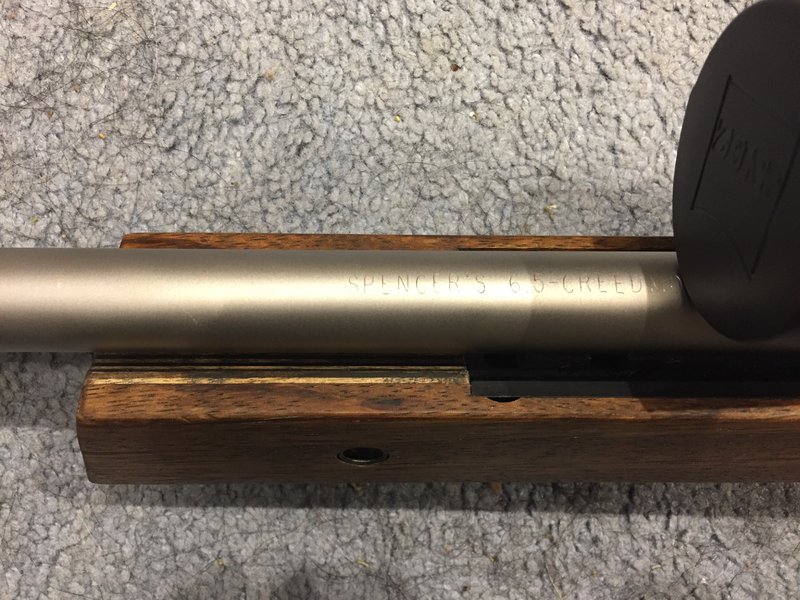

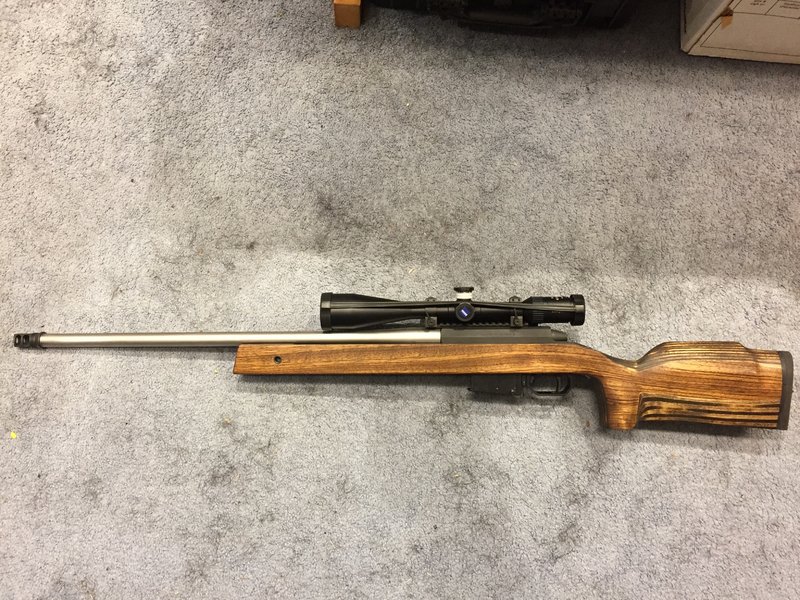

Here are some info and pictures of my TRG. I just rebarreled it to 6.5 Creedmoor, with a 26” 1:8 Bartlein medium palma. I have made about 5 laminated riflestocks now, and this is my latest. Baltic birch core with outer layers of zebrawood. Still uses the TRG chassis and trigger, and the stock serves as the magwell.
The last two pictures show initial load development, Lapua brass neck turned to .014”, H4350, CCI450, Nosler RDF 140, 2.885 OAL. 42.4gr looks very promising.

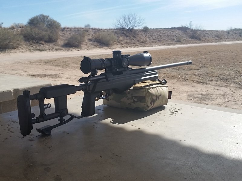

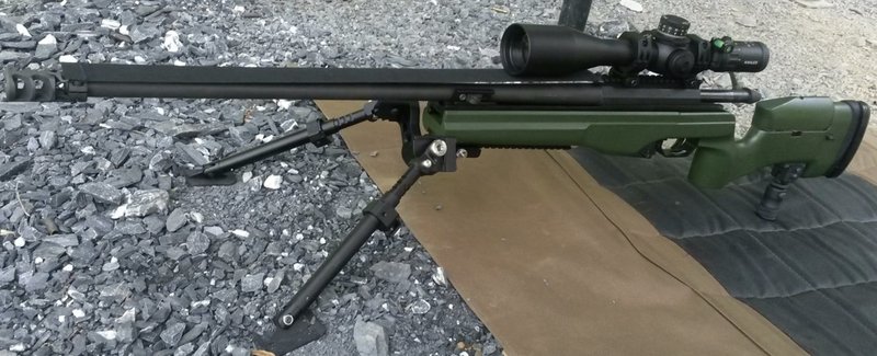

My TRG in 308 with TBAC 30BA suppressor, NXS in Spuhr 24 MOA mount and BT mono pod. Still my favorite long range rifle.

Wow- what a gem! Can you enlighten us on the paint job (who did it and what pattern)? Really nice
Thanks, I bought the rifle from EuroOptic and they called the pattern "Digital Woodland", if I recall correctly they told me someone local to them painted it.

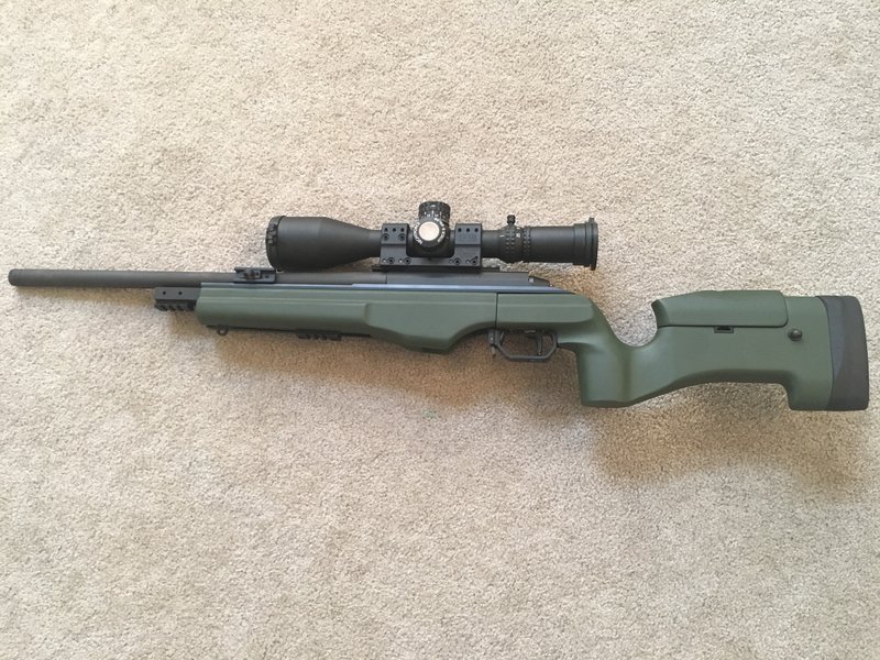

6.5 Creedmoor, 26/5R/8 Bartlein in the TRG contour. Many thanks to West Texas Ordnance.
Fits perfectly 40 inch drag bag

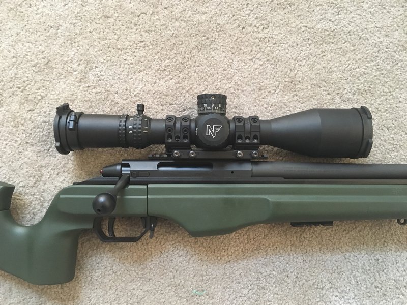

A scope will be the Atacr f1 5-25x56 Mil-C.

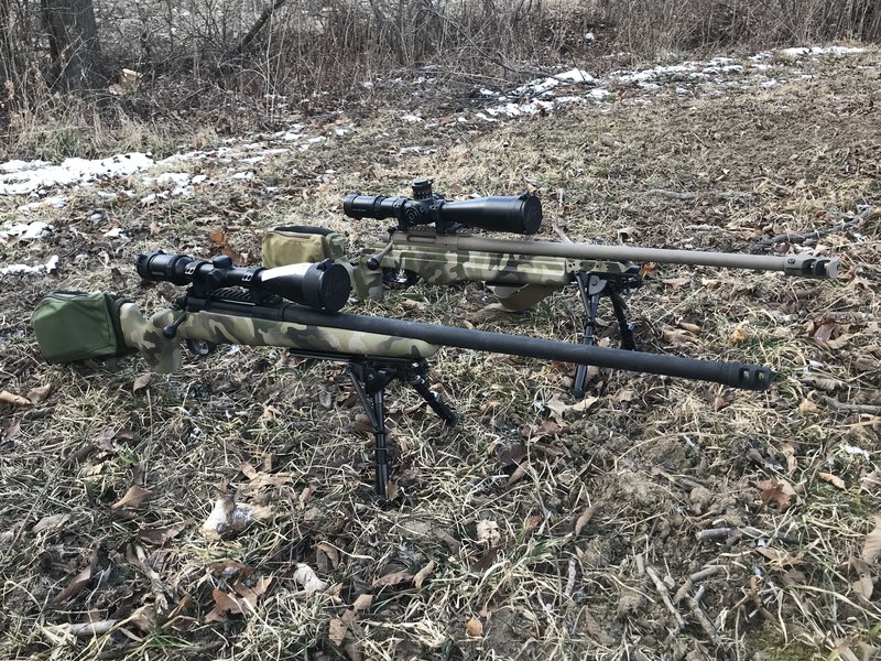

Here’s my TRG and my TRG-S. The TRG-22 is a 6.5x47. It has the KRG backbone and spigot. This is its 2d 6.5 barrel and this is a Hawk Hill installed by PVA. I got it several years ago as part of a special order run that EuroOptics did. The original TRG mags didn’t work with the short 6.5x47 and I got a lot of nose dives. I got the KRG AI mag backbone when they were still making it and it has run just fine since. It is over 16# but balances great.
The TRG-S is a 338WM. It uses either a modified TRG-42 mag or the original TRG-S mags. It has a McM Game Scout stock and a Bartlein barrel. All the ‘Smith work on it was done by Crescent Customs.

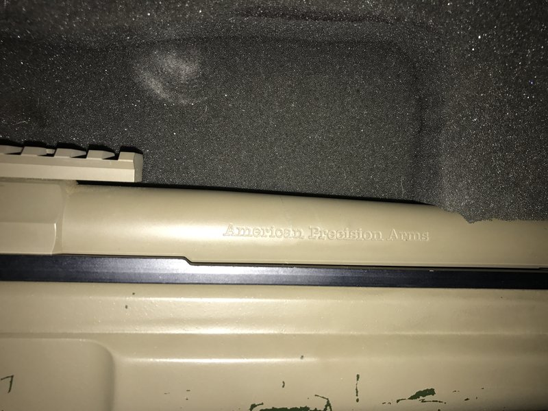

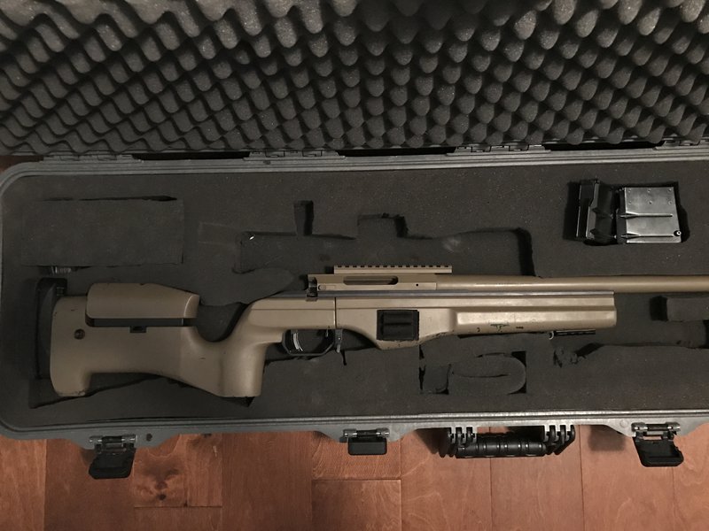

Just picked this gem up. Sako trg with 24" broughton 260 barrel. Originally from eurooptic who sent them to APA for rebarrel. She's used a little bit, but I'm excited! Does anyone else have one?
I also have a 20" 308 barrel that came with it. Doubt I will keep it.
