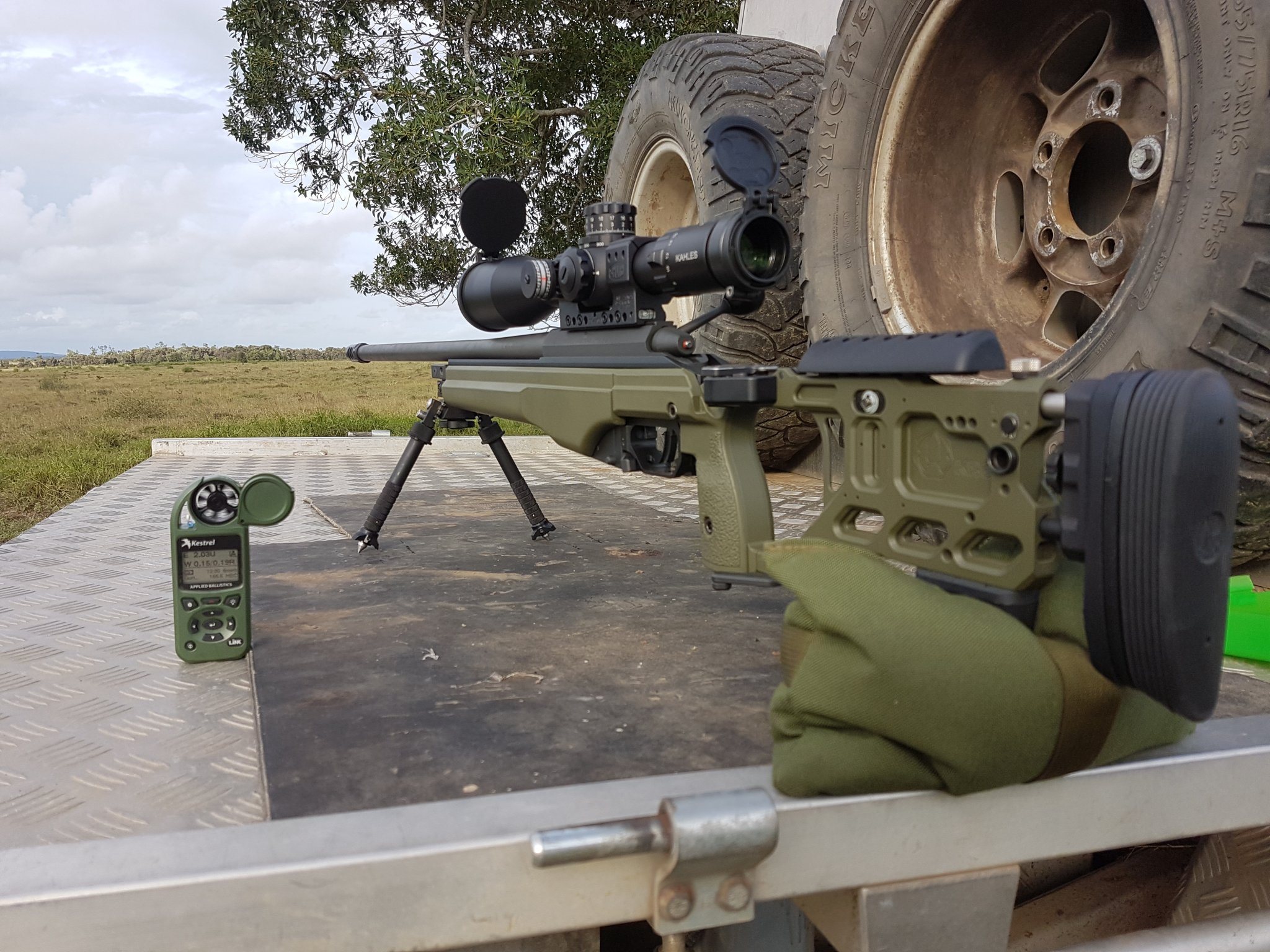

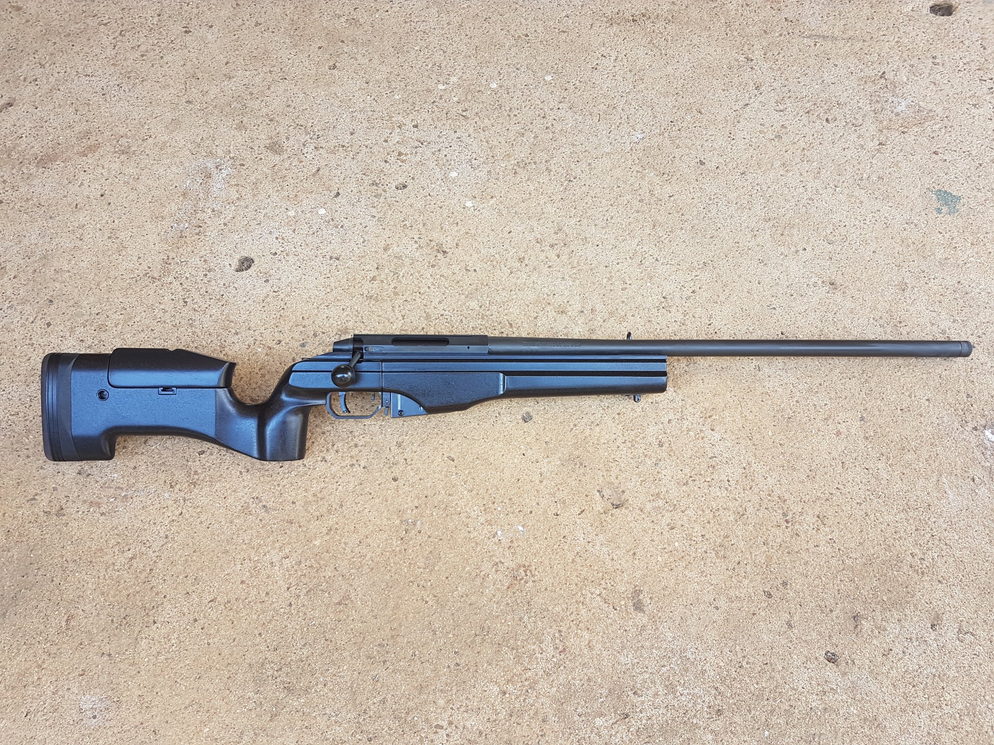

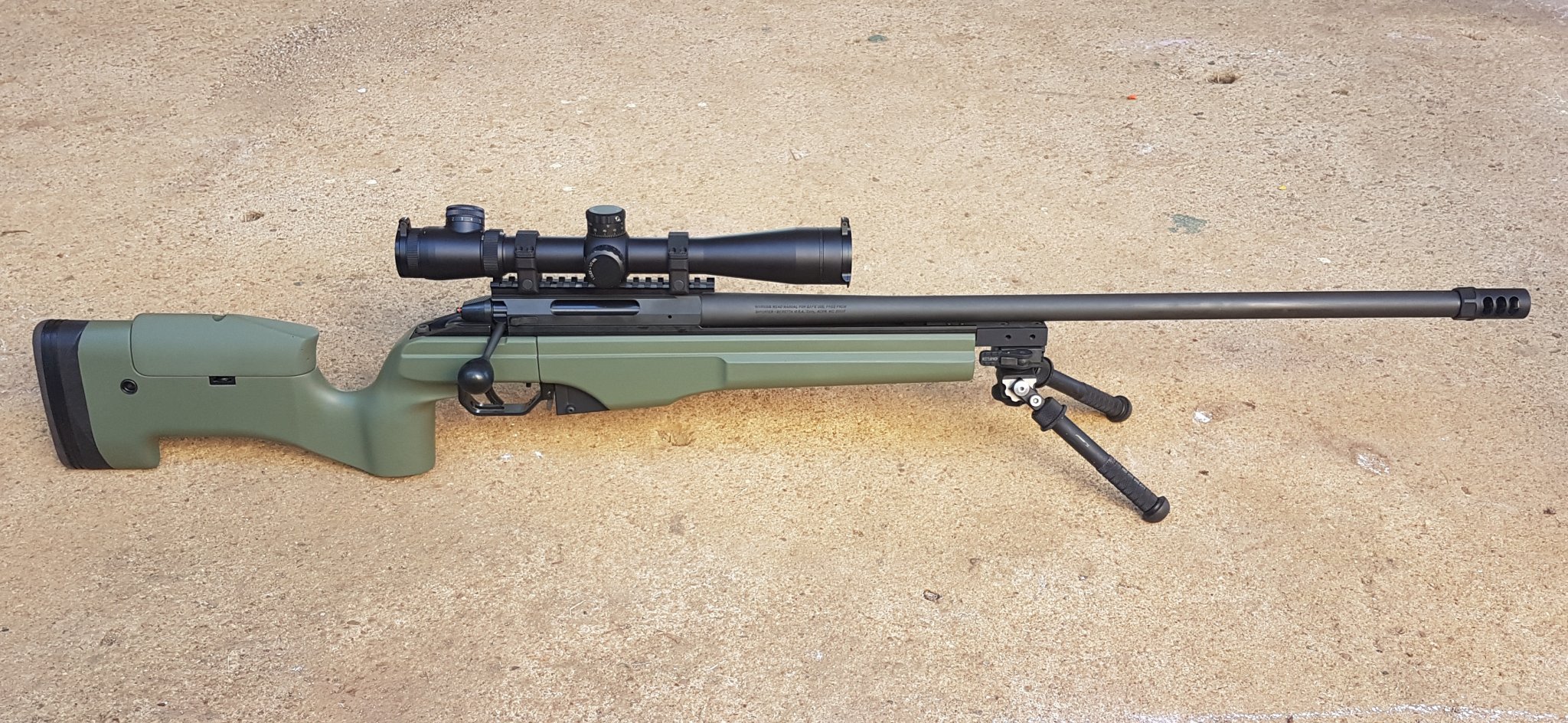

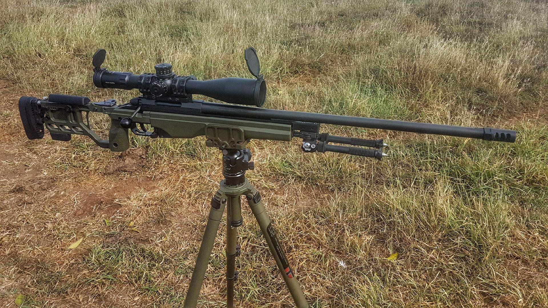

Here's my TRG-22 .308 i picked up last September.
Unfortunately the new Kahles K624i i purchased was a dud and had to be sent back to Austria for repairs. The only spare scope i had was a 'old school' Leupold Mk4 M3, so it had to do. I lick of Cerakote and i was up and running.
A few days shy of 7 months my Kahles returned. I fitted a KRG chassis and Cerakoted it OD green.
Project complete...

That is a great looking rig. You have got to love the platform!
Reactions: MPrimo and FF05
I love the O.D. cerakote job on that. Very well done.
That color appears just a shade lighter than my factory green trg-22.
You just cant' beat the sexy lines of a trg.

That makes me want to get the KRG folder. Awesome setup!

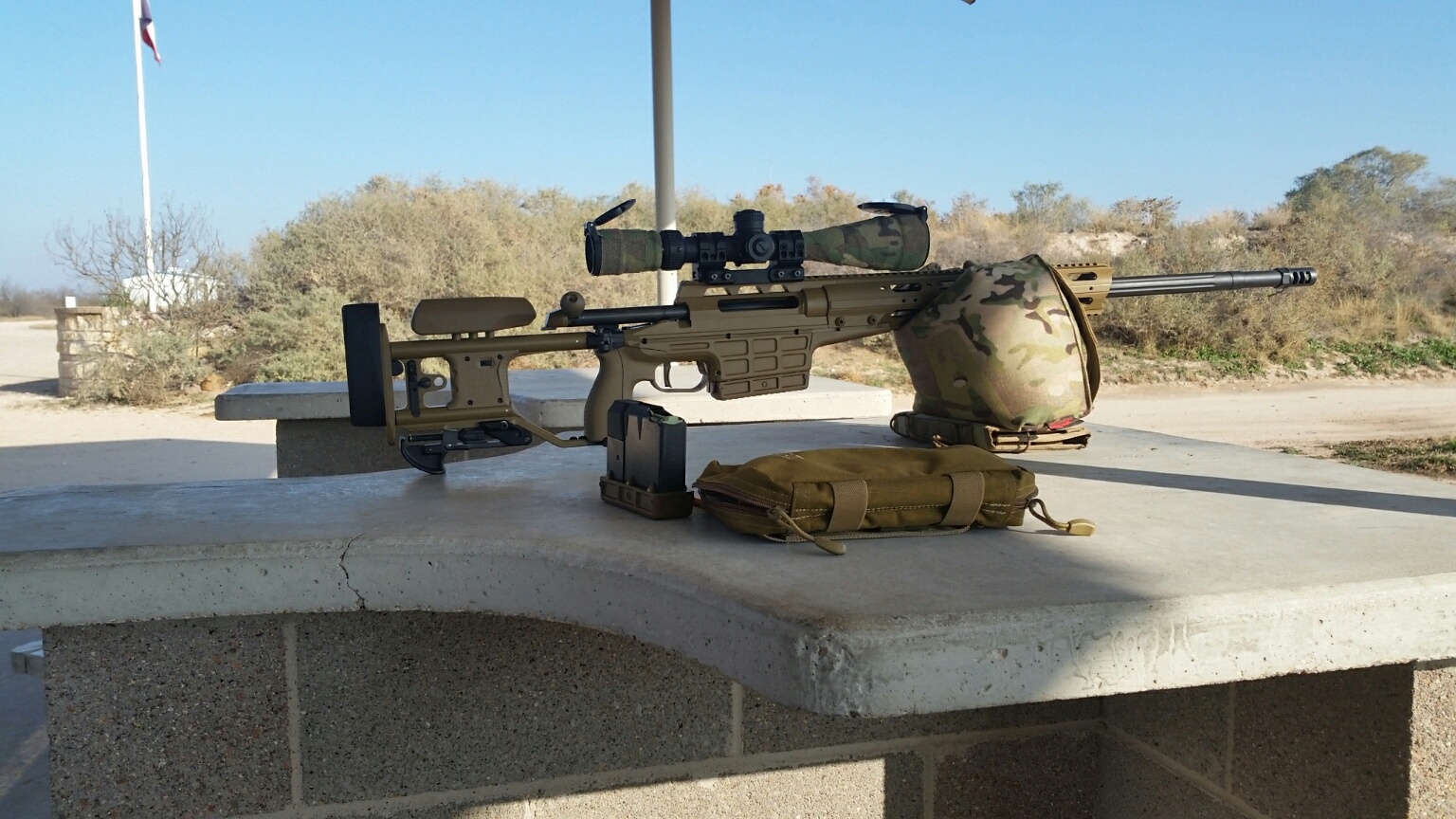

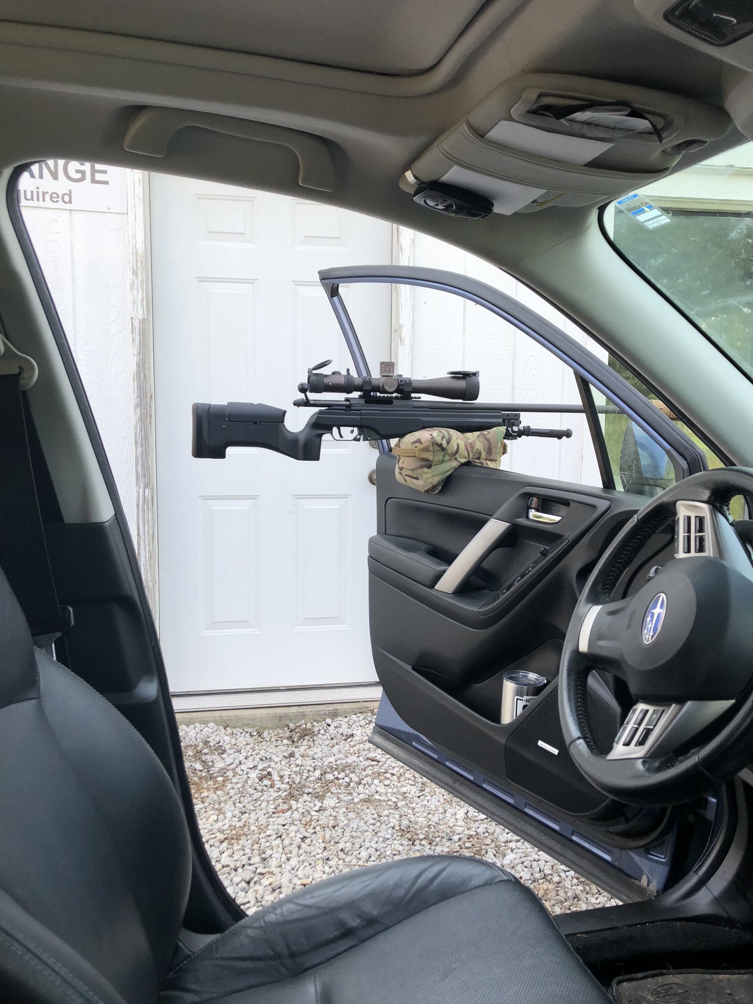

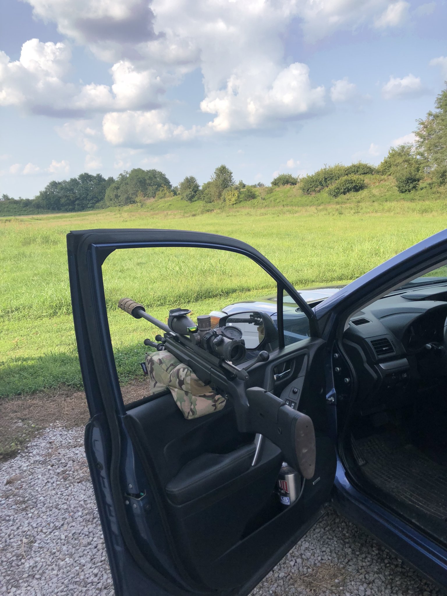

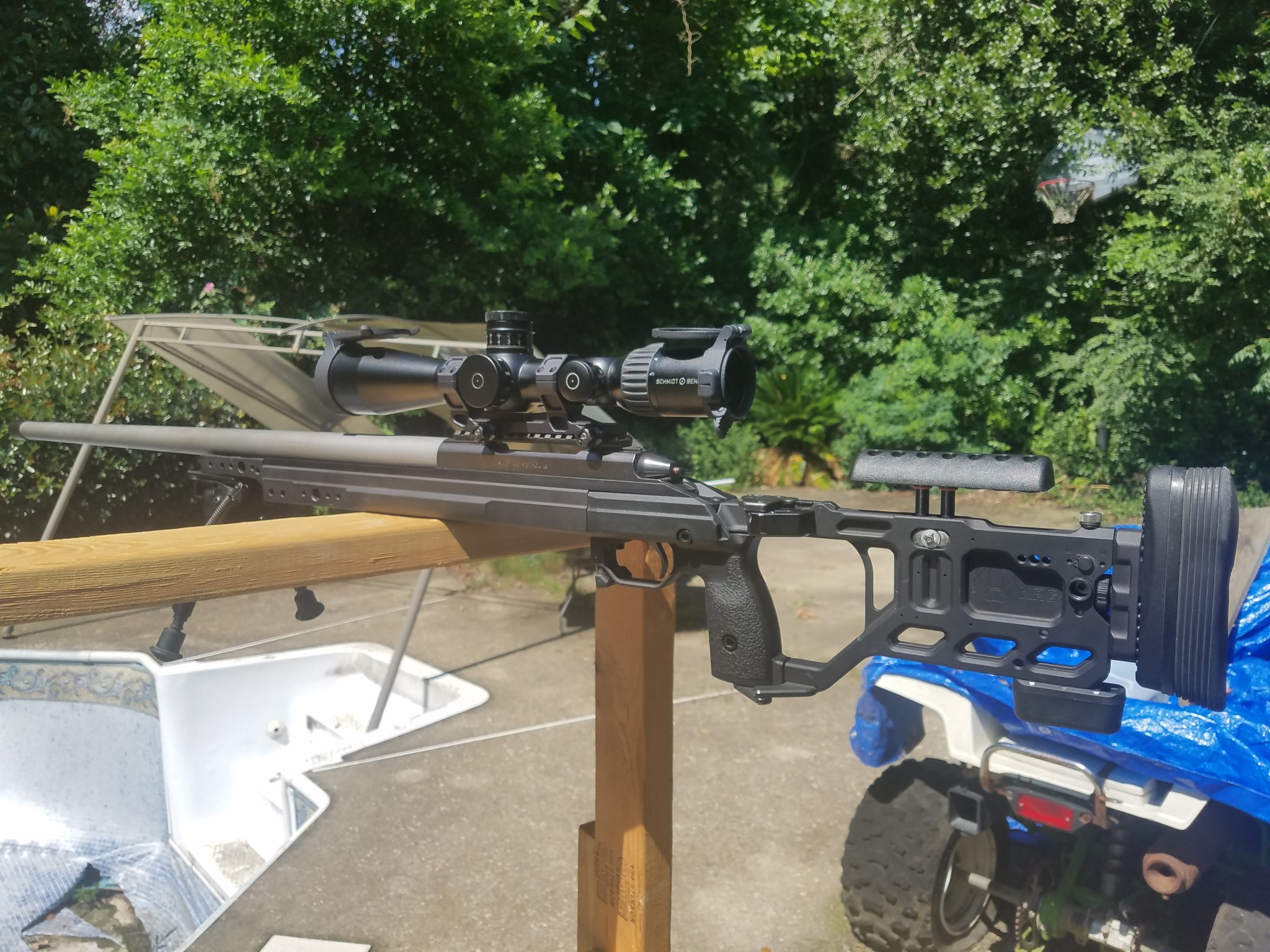

I decided to get a new scope so that the Sako is always ready to put meat in the freezer.
Love the mount, just seems a little tall and forward for the application, no?
It's tall because there's no handguard on top that would normally take up the space. The scope is still the same orientation it would be on an AI rifle. Or any rifle witb a round handguard on top. It looks a little goofy but it does work.
I also lay pretty far forward on the rifle so it doesn't bother me a bit.

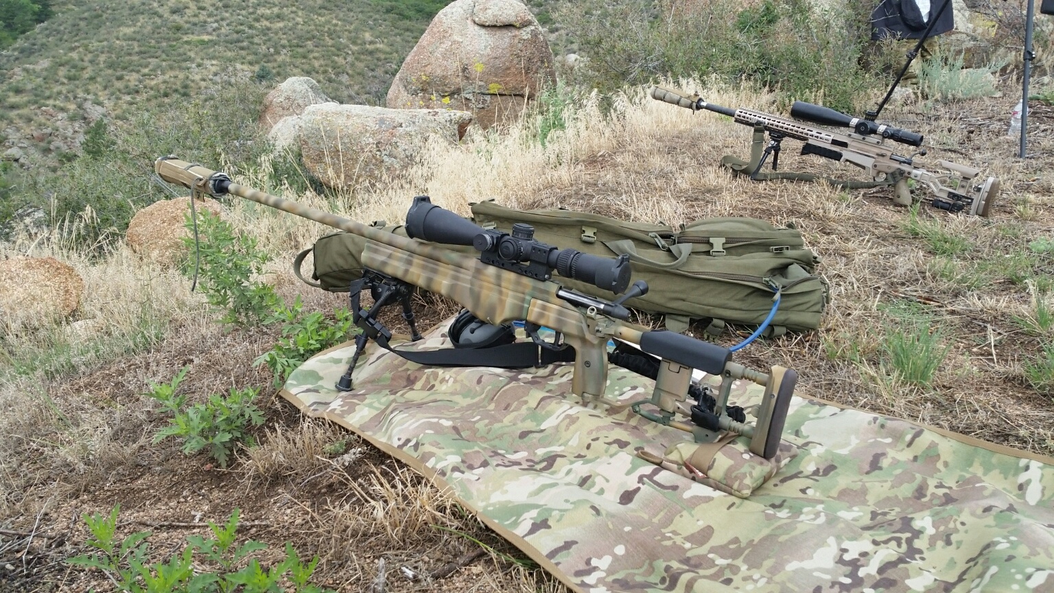

I feel bad. I haven't shot this one in over three years.

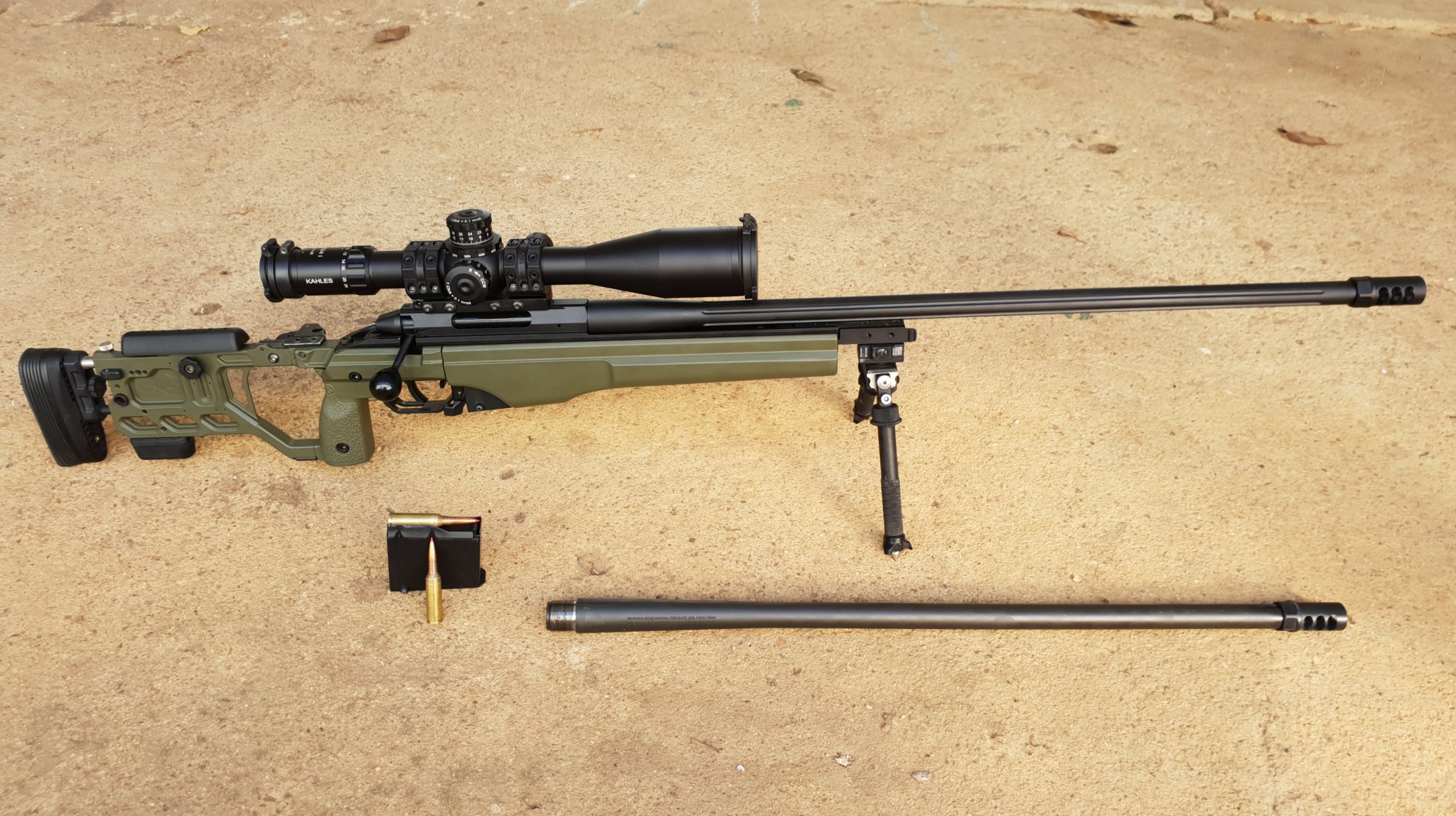

The mag well and ejection port needed to be widened slightly to accommodate the fatter round. The feed lips had to be bent out a little, along with the bolt face opened up to Magnum size.
It feeds flawlessly with the rounds loaded to 2.945" COAL (magazine lenght). I used the PTG '0.130FB' reamer, i believe this will jam factory ammo 10thou. I handload, and this reamer will allow handloaders to set thier own jump within magazine lenght.

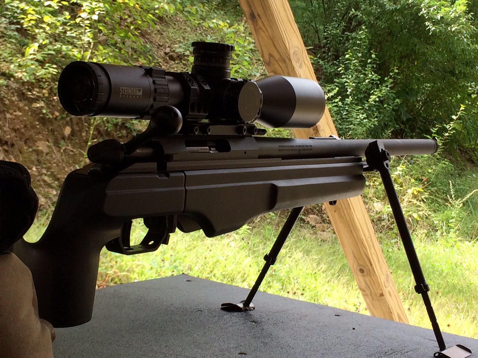

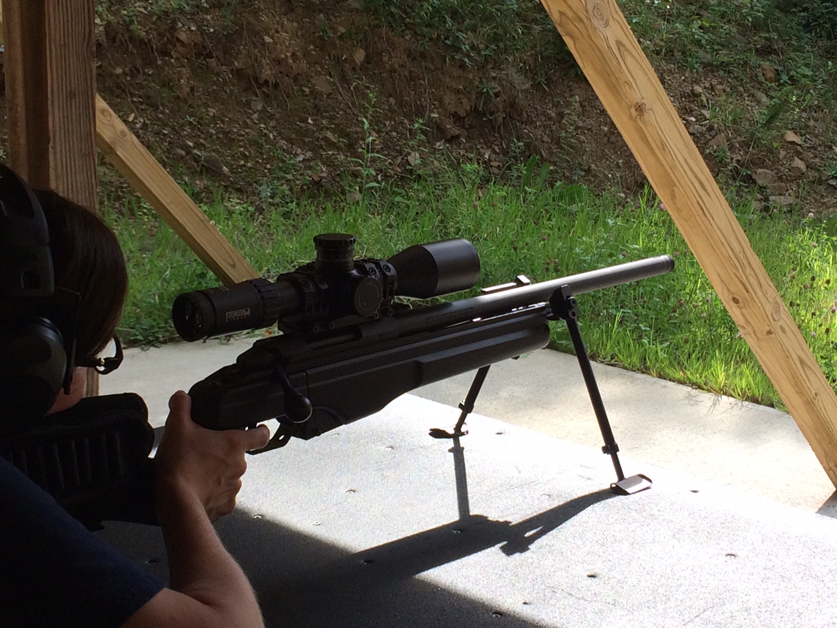

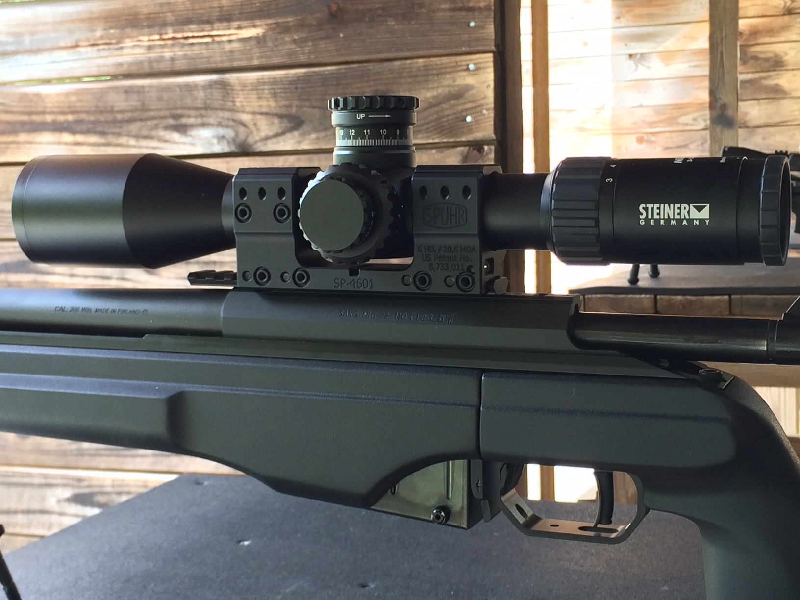

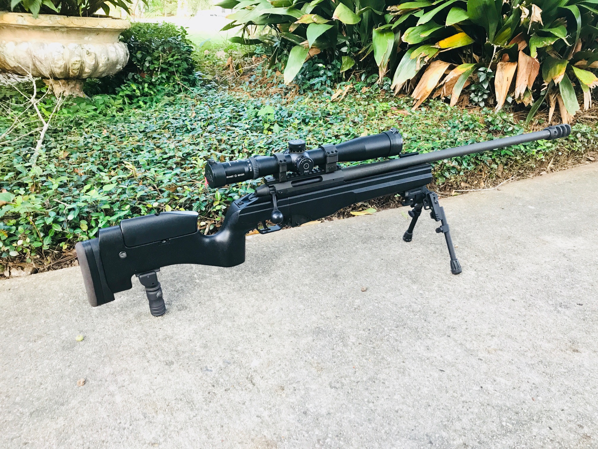

Here is my basic TRG in .308, it has Steiner m5xi 3-15 for glass, Spuhr 4601 mount, and oem bipod. Straight out of the box it is shooting pretty well. Next upgrade is possibly the m7xi when it becomes available or a 5-25 PMII. I am wondering if anyone on the forum can put me in touch with the member that makes the adjustable cheekweld?

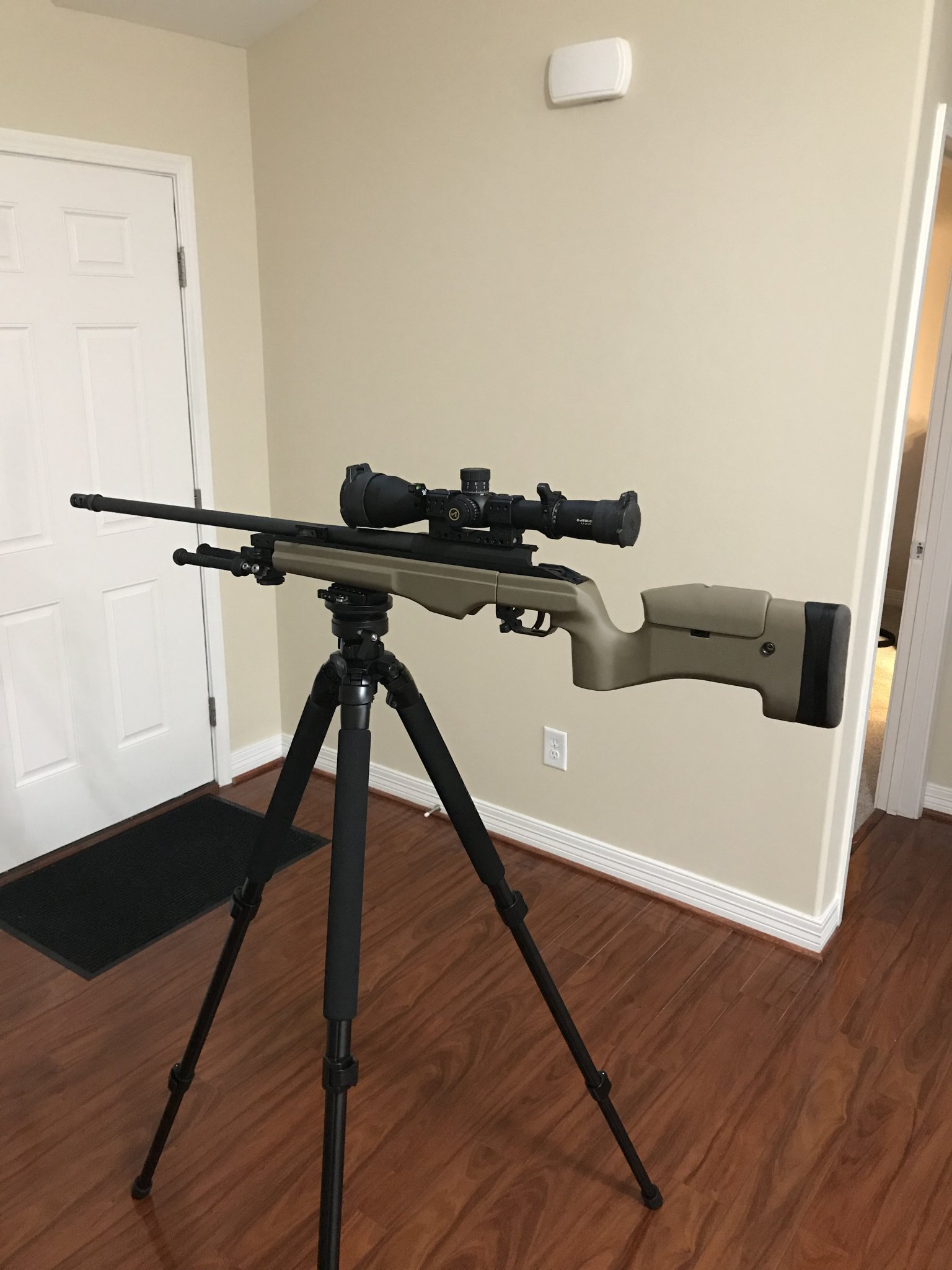

I recently upgraded to a Cronus BTR and a direct SPUHR mount. Since I had to strip down the gun to get the picatiny rail off I had the stock cerakoted magpul FDE.
I also installed a Henderson Precision 3” Universal ARCA rail using the BT Industries BT28-N Rail Nuts.

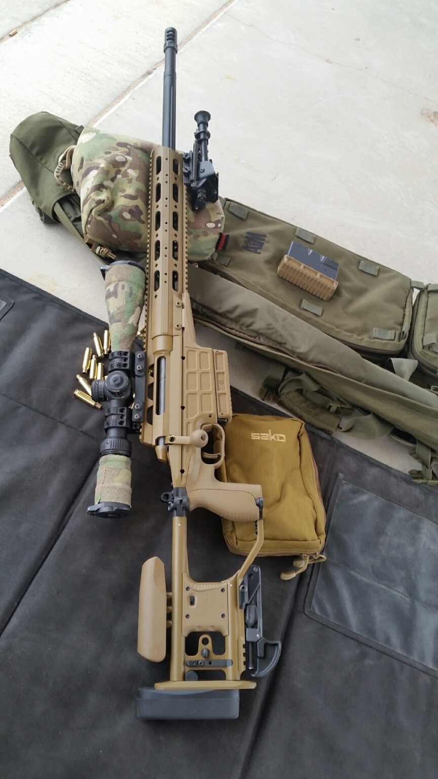

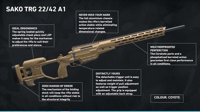

Has anyone got your hands on the TRG 22 or 42 A1, yet?
Apparently the "old" TRG with M10 folding stock and M10 style chassis and fore-end.
Stolen promo image:
Would you guys say these guys are worth the money?
I doubt you will get anyone subscribed to this thread say anything negative about the TRG!
I think it’s worth the money. It’s one of probably two factory rifles that can compete with a custom rifle and be counted on in adverse conditions (the other being AI)
Five or six years ago I think the TRG was even more of a value. That was before the barrel nut and quality custom action and chassis boom. When I bought my TRG I could get it off the shelf and be set. The other option was an AI or wait for a full house custom build.
The TRG was years ahead of the chassis trend while keeping traditional stock ergonomics. KRG took the TRG blueprint and made their Bravo chassis (and SOTIC Rifle)
Now there are lots of great ways to get a great shooting rifle without a full custom build. It’s a great time to be a part of this game.

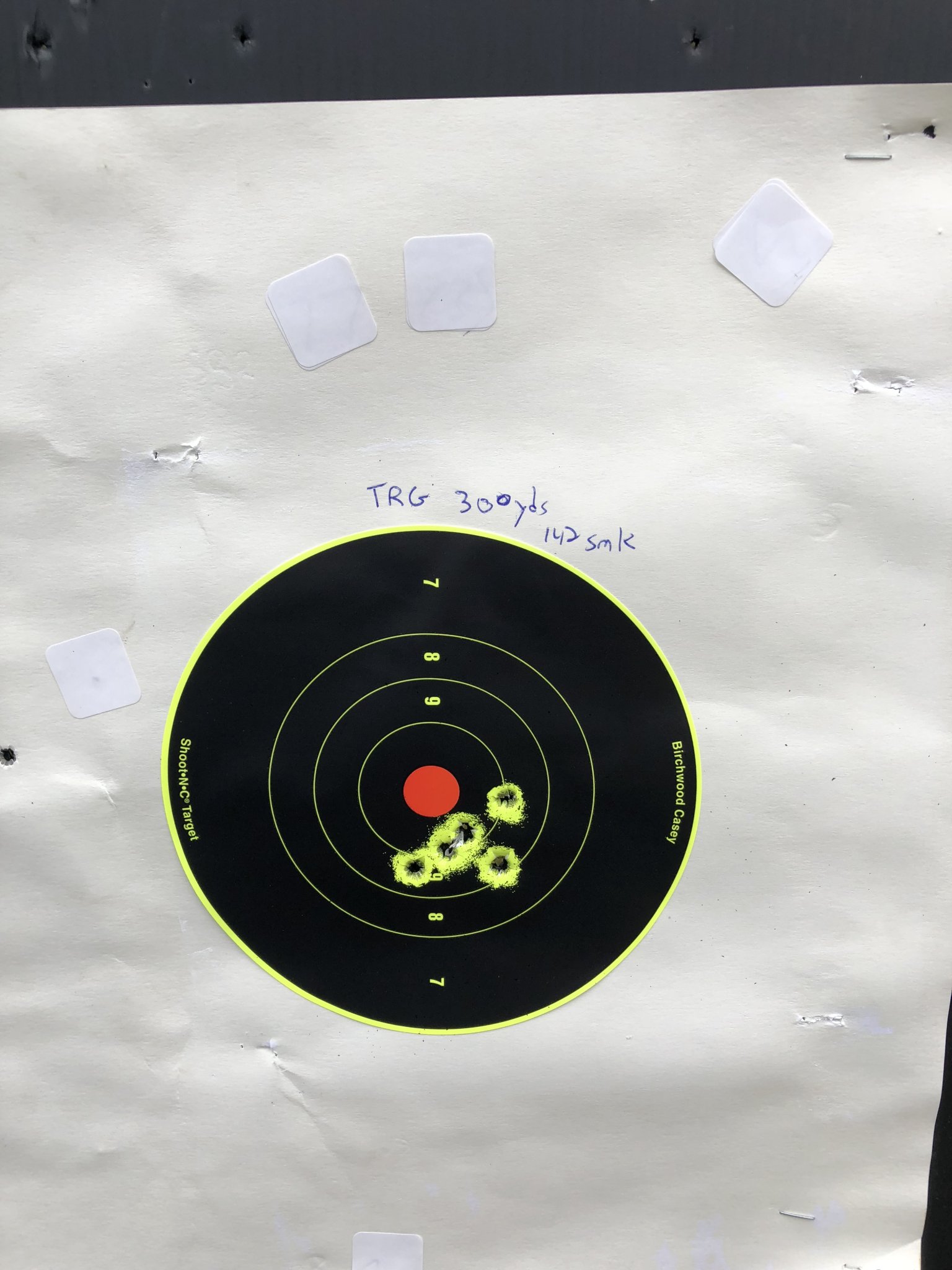

My factory 260 barrel has 2500+ rounds on it and still shoots great! Velocity is down a bit, but it’s shooting well.
With results like this still I’m hesitant to pull the barrel for some extra speed gains.
