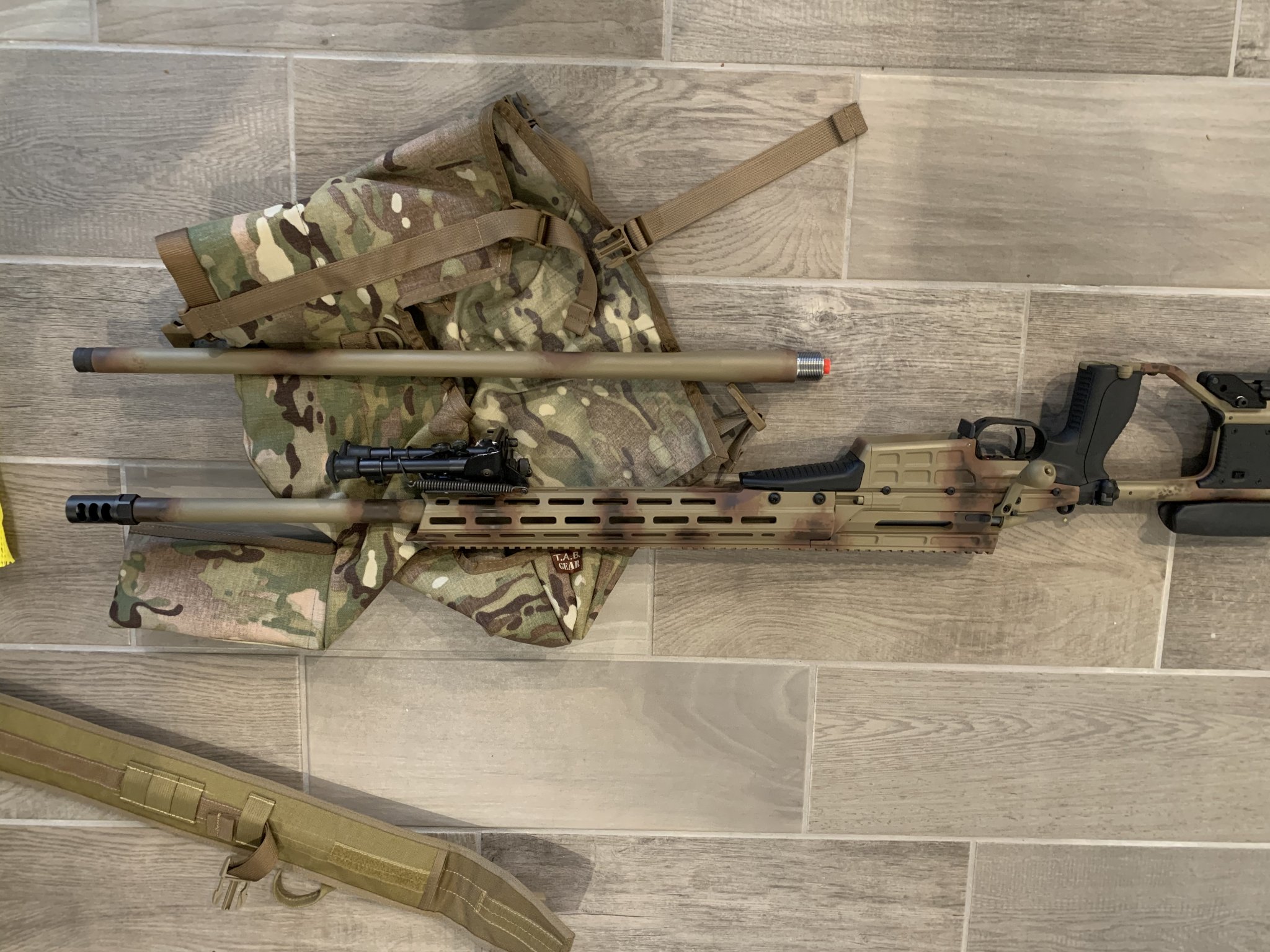

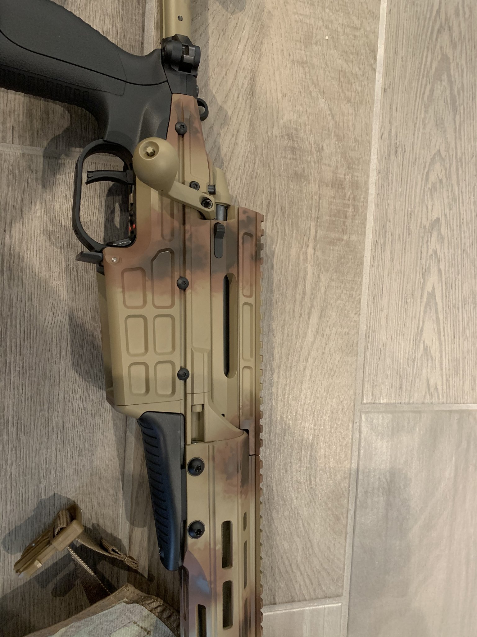

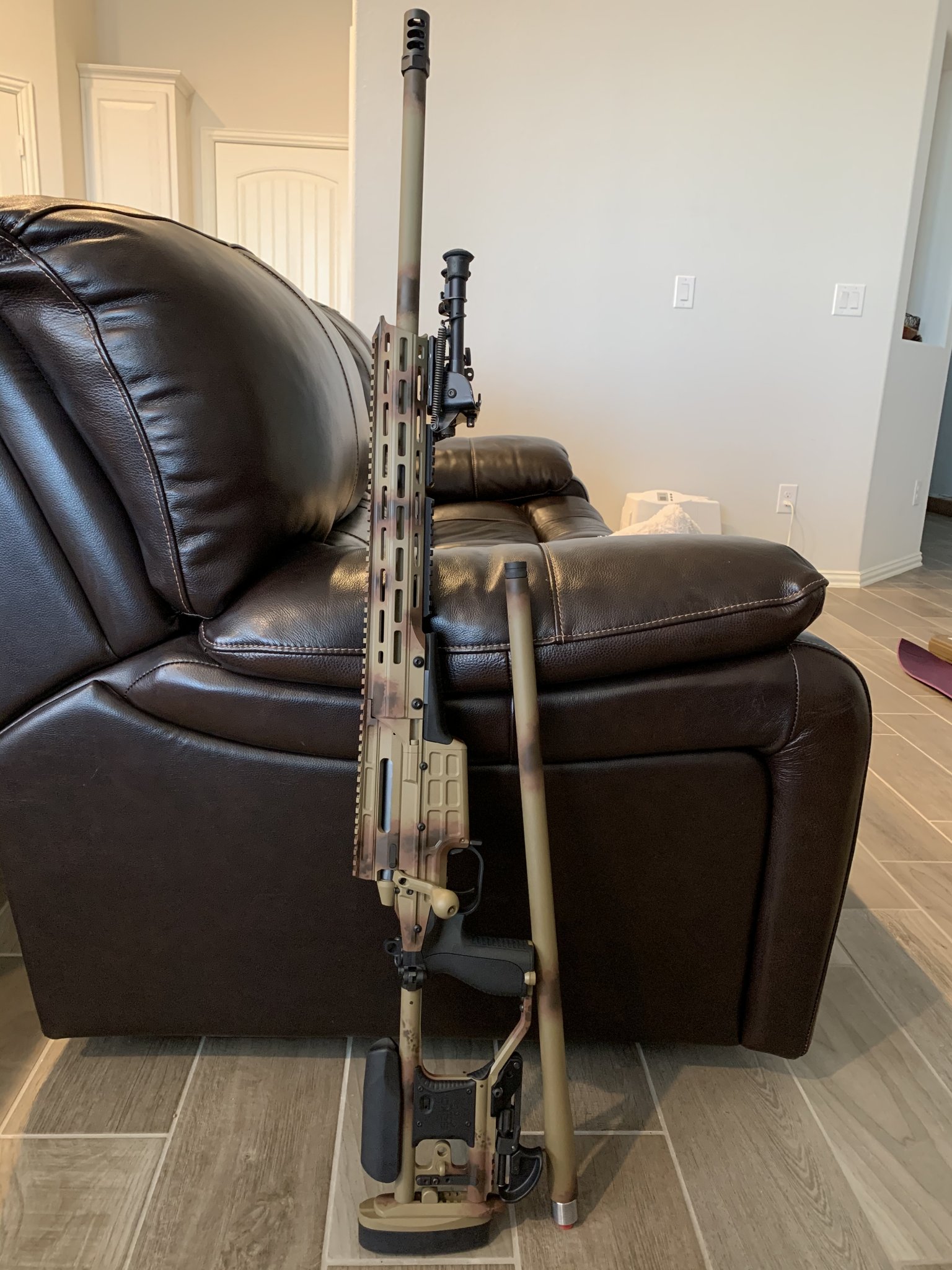

TRG 22A1 in 6.5 Creedmoor, NRL, New Mexico Smith Ranch Shootout

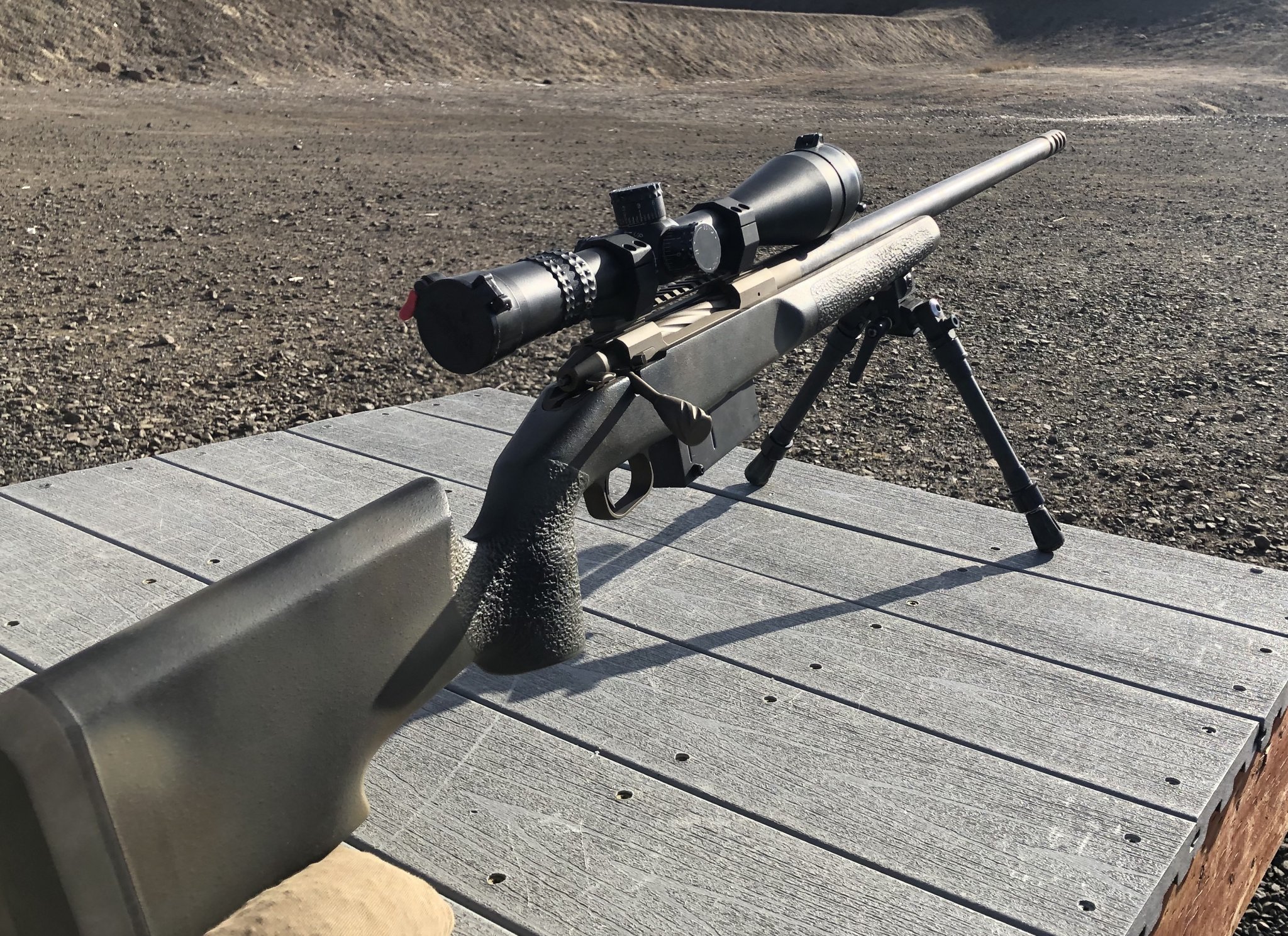

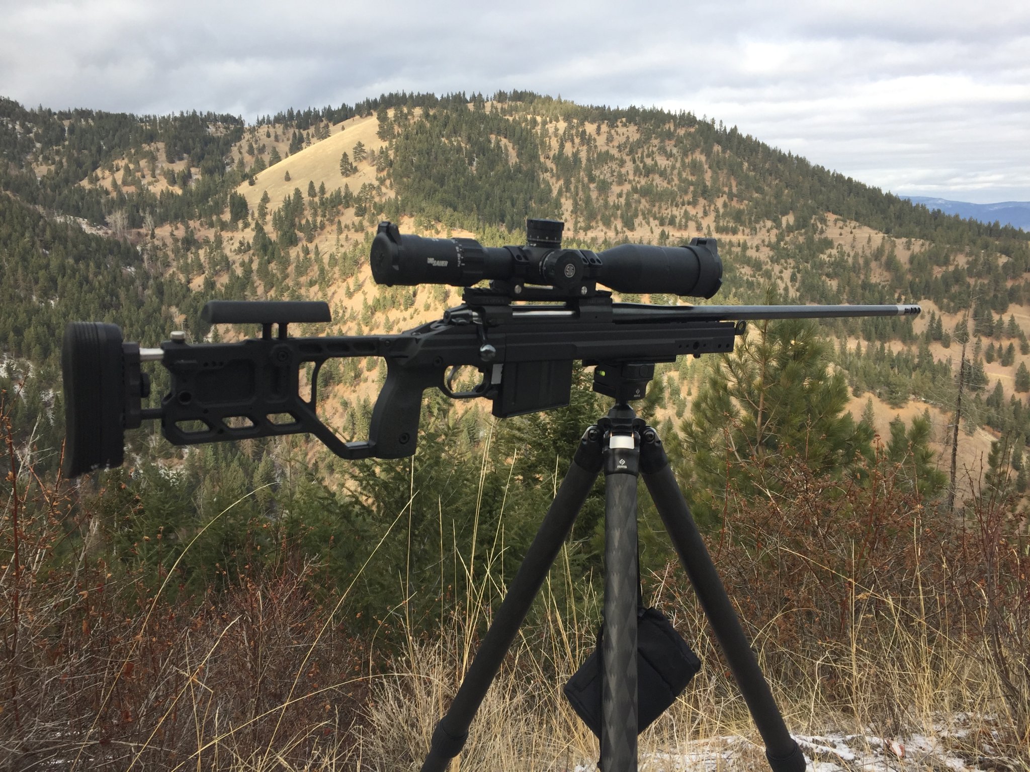

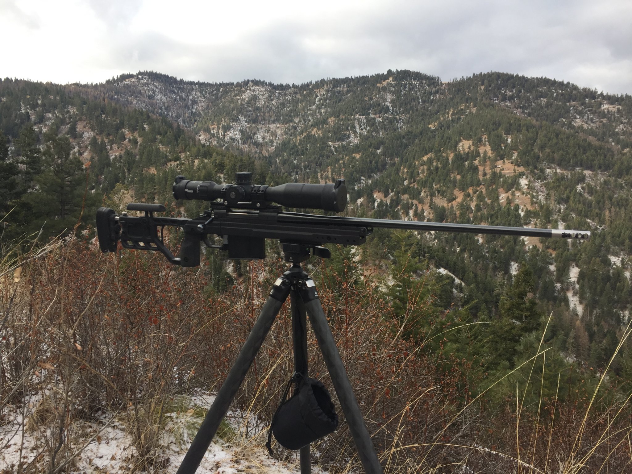

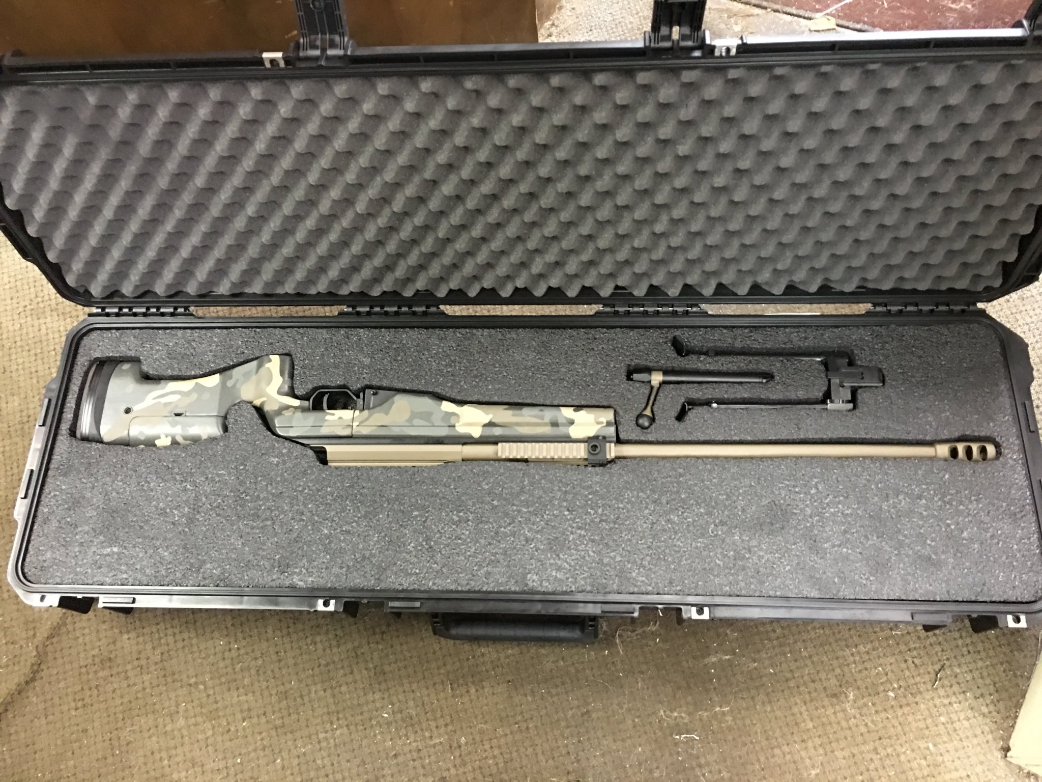

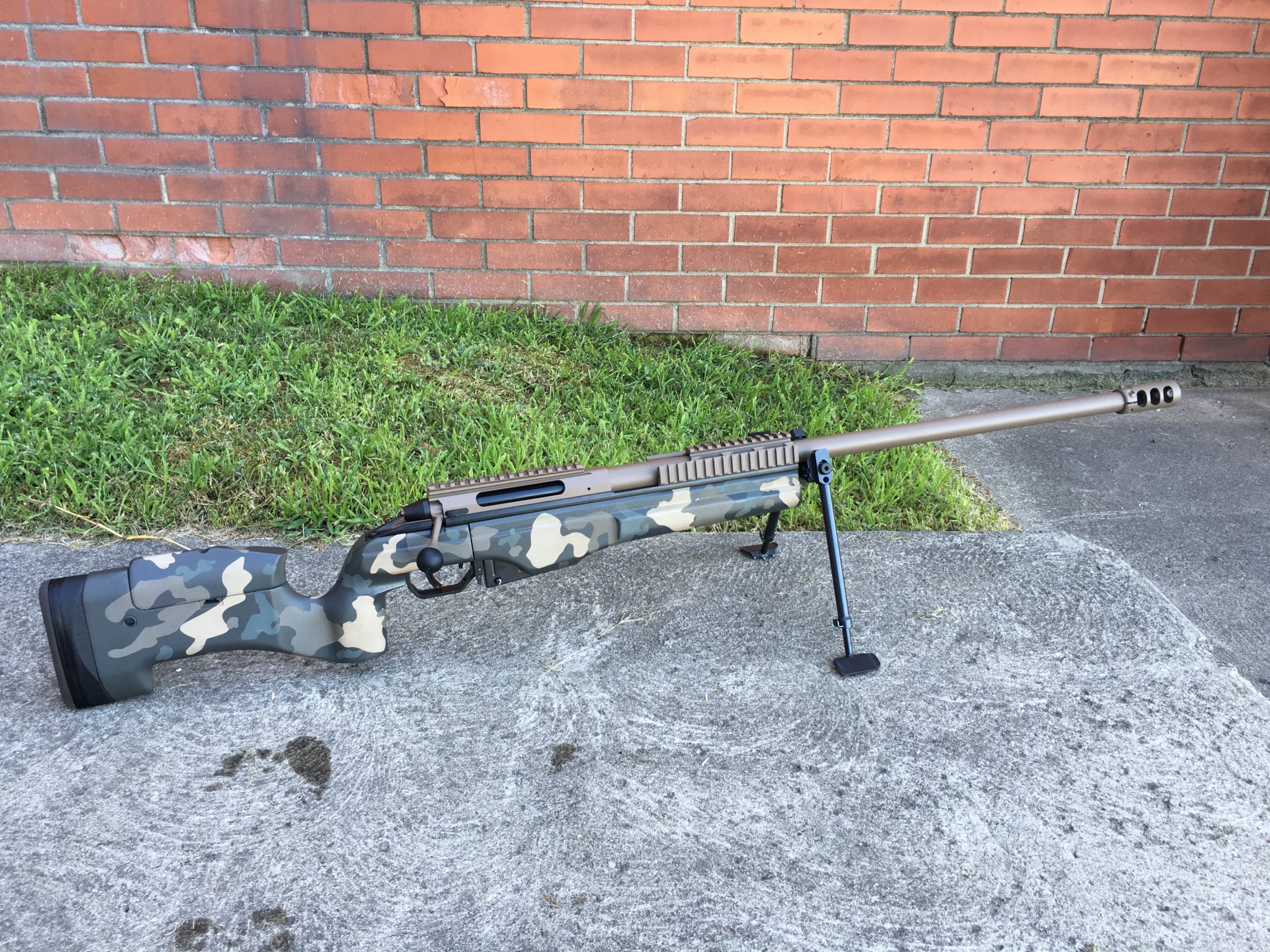

Here is mine. Sako M995 TRG-s action with spiral fluted bolt and bolt knob, Near Mfg 20MOA rail, Proof Research barrel 1-7.5” and 26” long, Benchmark brake, McMillan A5 with PTG bottom metal, and I modified the TRG-42 mags to work. Chambered in 6.5saum and throated extra long for the 147 ELD, but I’m currently shooting the 150 SMK which likes the jump. Burnt Bronze Cerakote on all the metal.

Is the Near Mfg 20MOA rail bolt on or does it have to be drilled/pinned? Don't see it on their site, do you have a part # and price?
Thanks

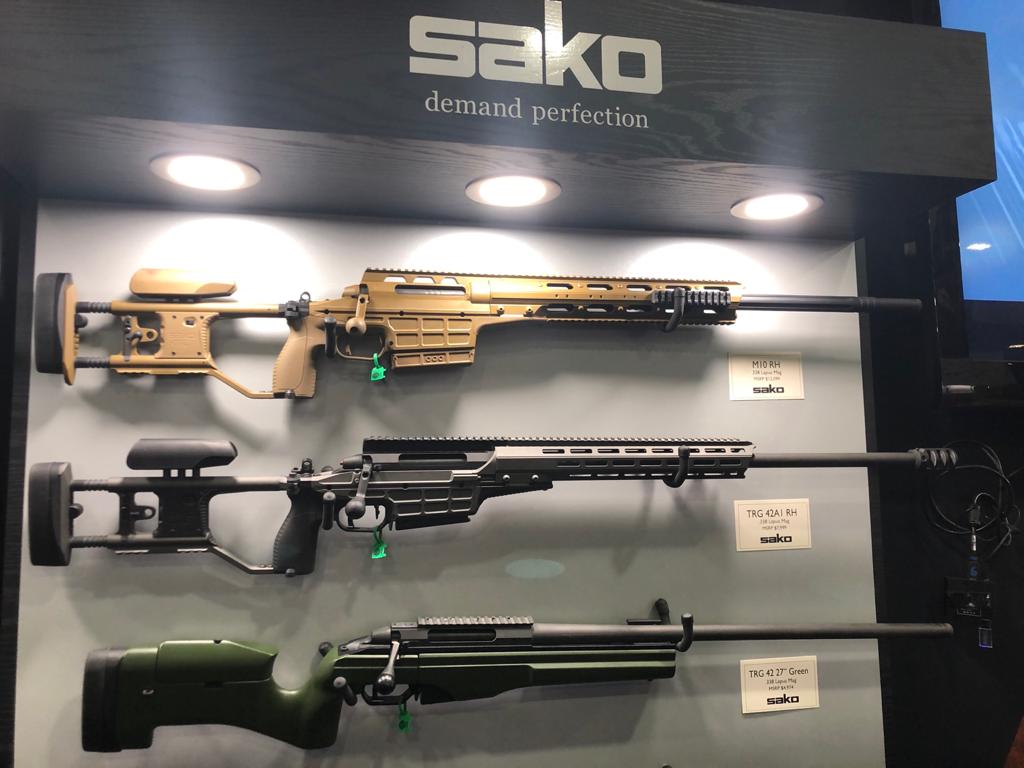

Lovely news! Seems that also Sako is moving from .260rem to 6.5cm so I guess that we have a winner of those 2 ?
6.5cm ammo is also here in Finland cheaper than .260rem.
Hi, I did not ask about the A1. I guess Sako will be replacing old 22/42 line on A1 in the future with the current calibers.
Can you clarify this?
I don't think that Sako will replace TRG-22/42 models at all. It's a different rifle for different purpose. Not all people want to have chassis and rails all around.
Reactions: AustinTom
I’d say that the purposes are similar, just a different chassis.

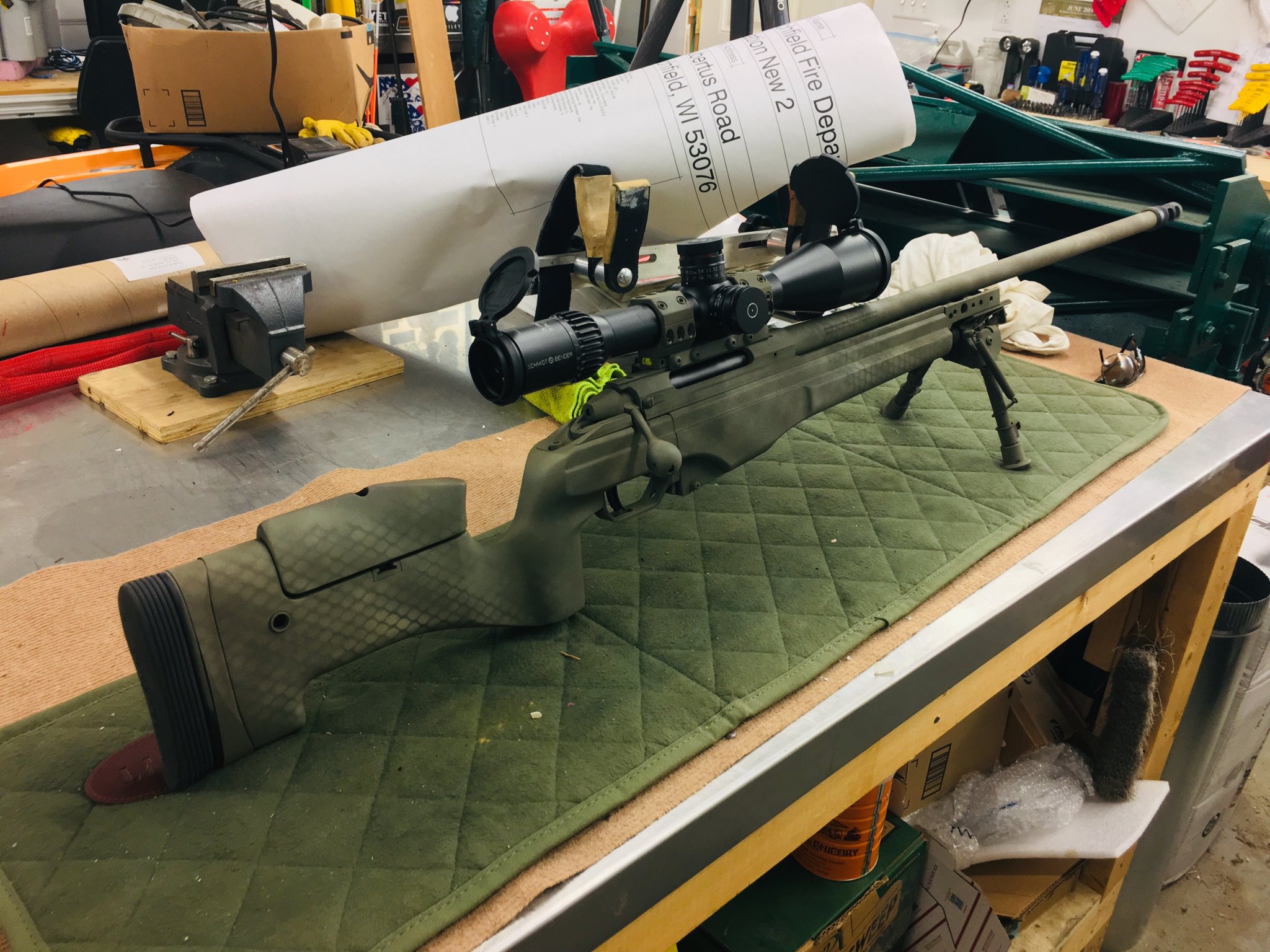

I've just got my Sako TRG-S/M995barreled action back from PVA with new Paradigm carbon 1/9 twist chambered in 300 WM. Last night I've bedded the action and PTG bottom metal into Manners EH1 stock that started off as a leftie Rem 700. Came out pretty good. Still have to touch up some paint and want to cerakote the bottom metal some sort of gray.
Have some H1000 on the way to try out some 212gr and 225gr
