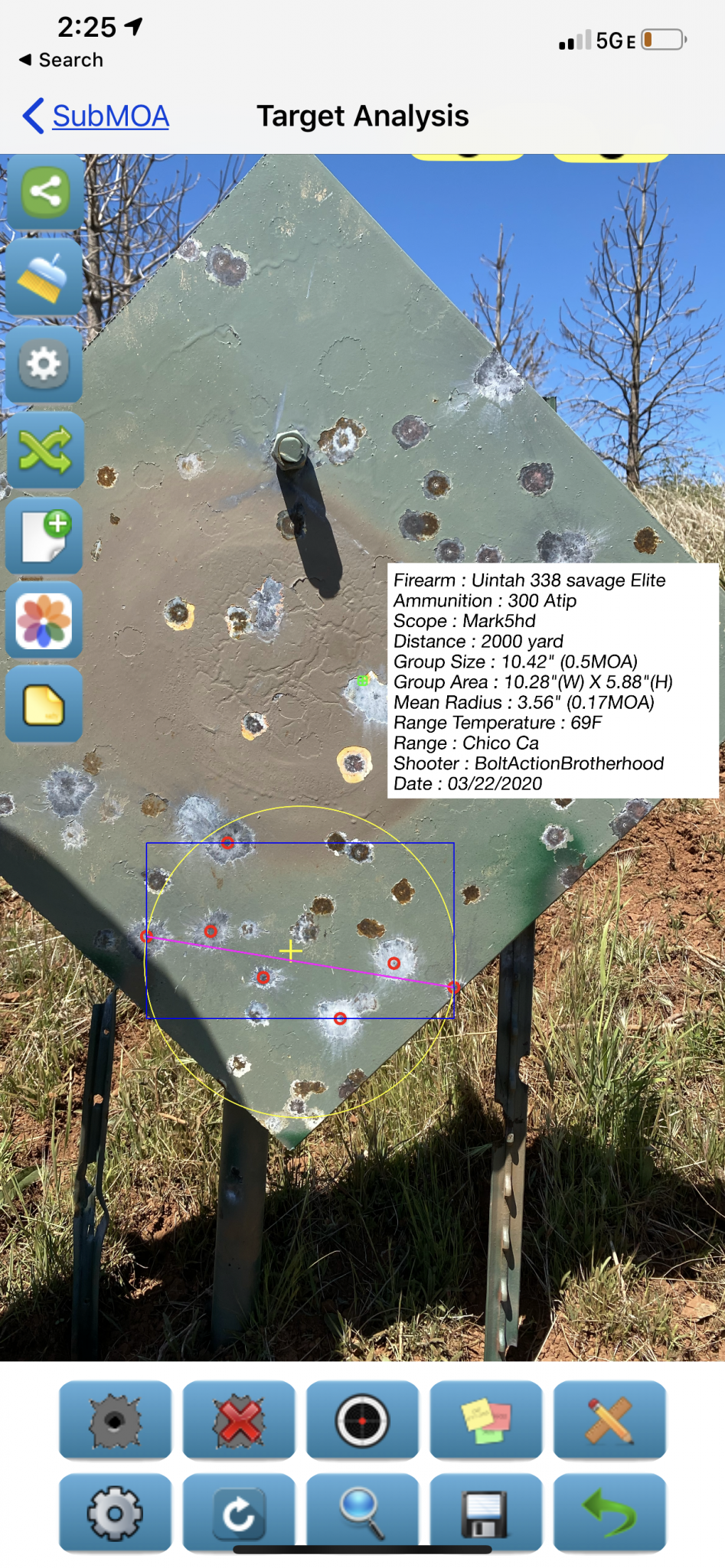

Dude I LOVE MINE In 338 lapua! ran great today shooting 2k . Went 7/10 at 2000 yards with a .5moa group.
View attachment 7309695View attachment 7309696
Nice looking rifle. A 0.5 MOA group is exceptional for 2000 yards, well done!
Is this typical for the rifle, or best group at 2K ever? Wind was cooperating?

Well this was my first time shooting out to 2000 with the rifle. The wind was good that day for sure, I shot it later in the day and didnt have the same luck.
I havent even done load dev with this rifle yet, I was waiting for the barrel to finish speeding up. I shot this group with an sd of 20, but must have been in an accuracy node.
The few groups I have shot on this rifle have given me .53 moa and .33 moa so far are my best two groups. So far I have been very impressed with the rifle.

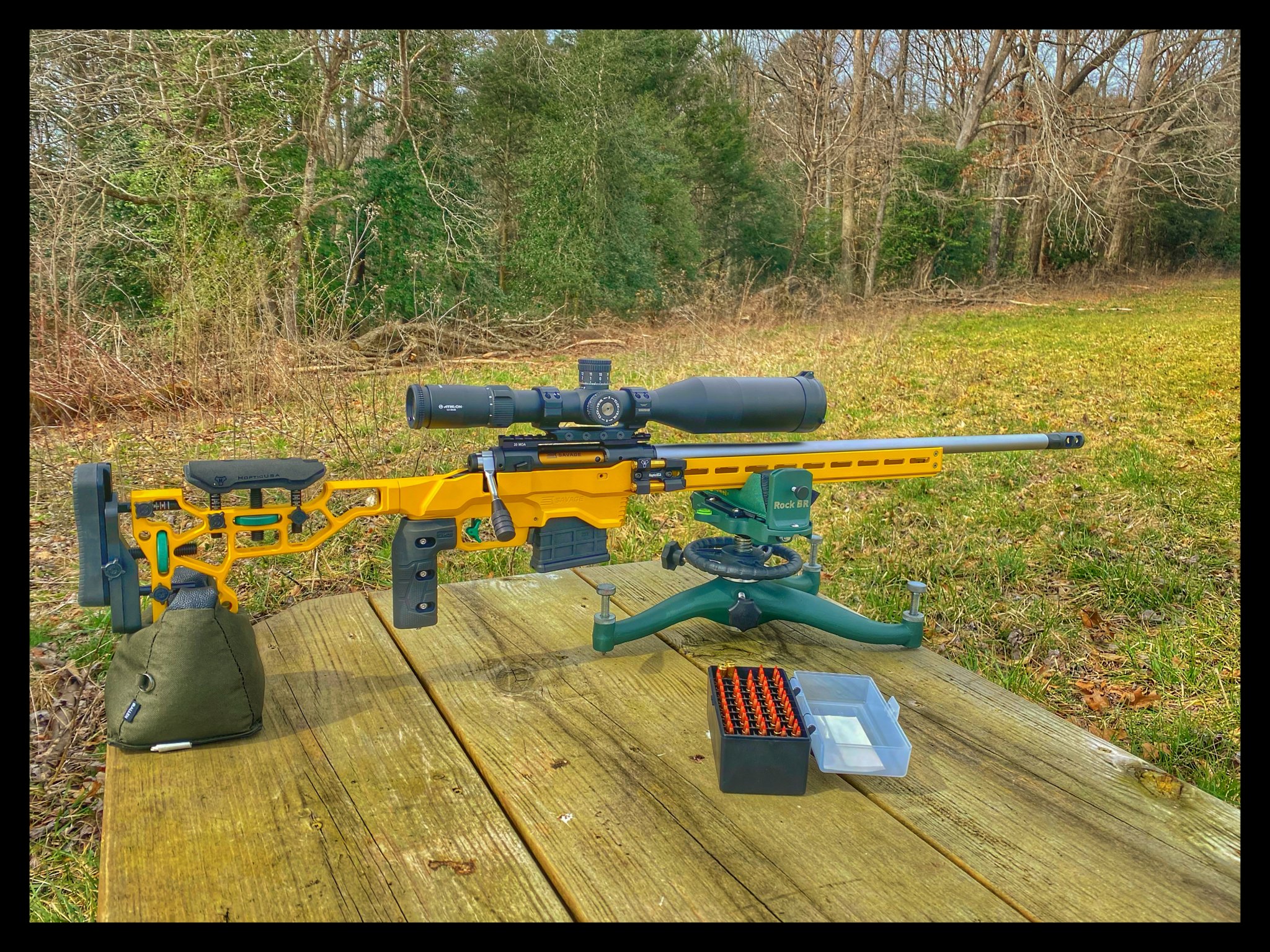

Cool paint job!
Josh
Thanks! When I told some friends I was doing yellow they all said no way. But I think it turned out really good. just ordered 2 of your Mlok bag riders for the two rifles i have. can’t wait to get them installed.
