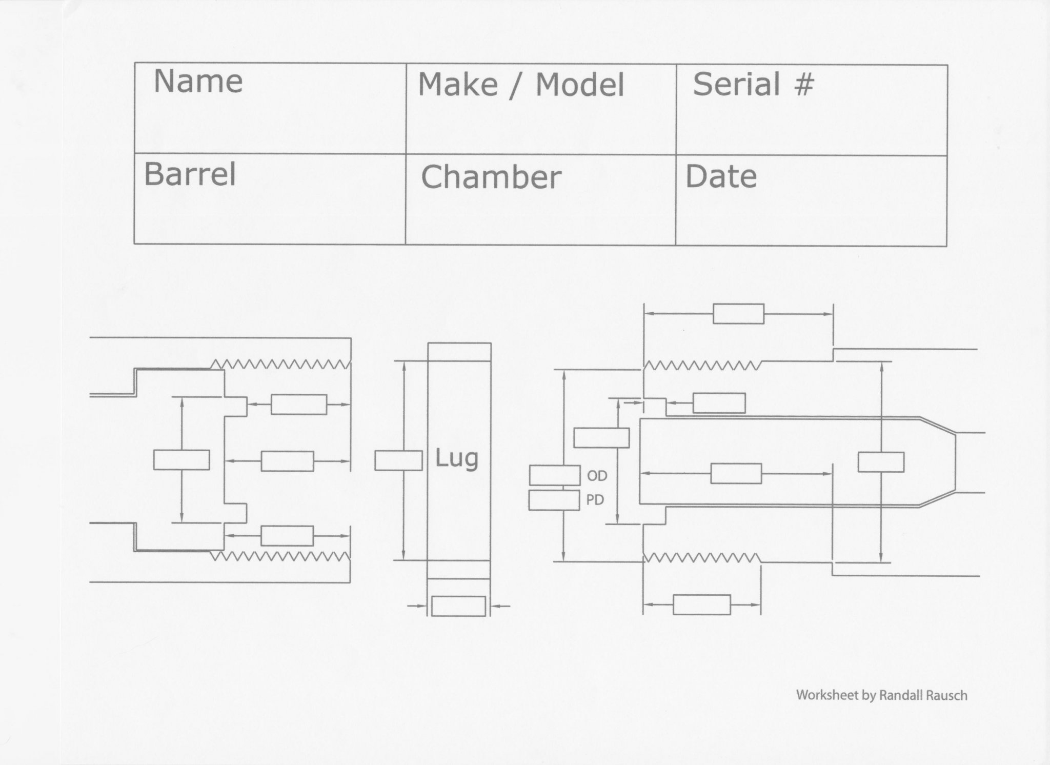

#3 - there is a tenon worksheet on Brownells you can download and use for measurements.

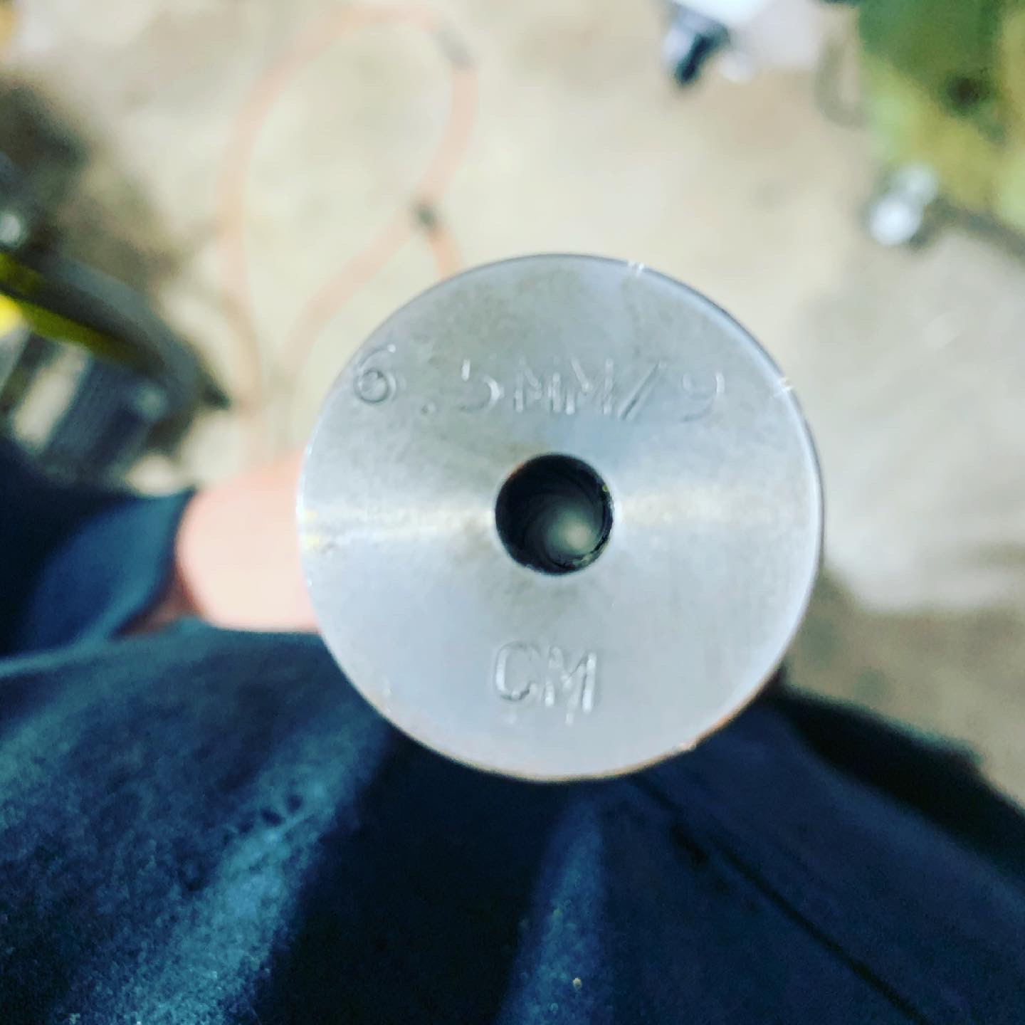

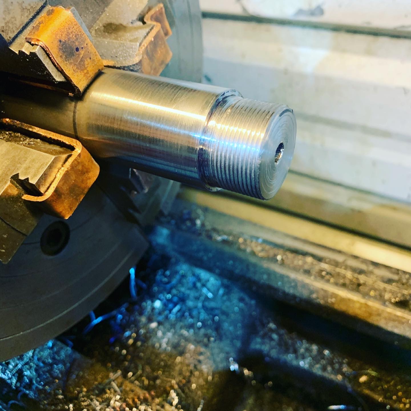

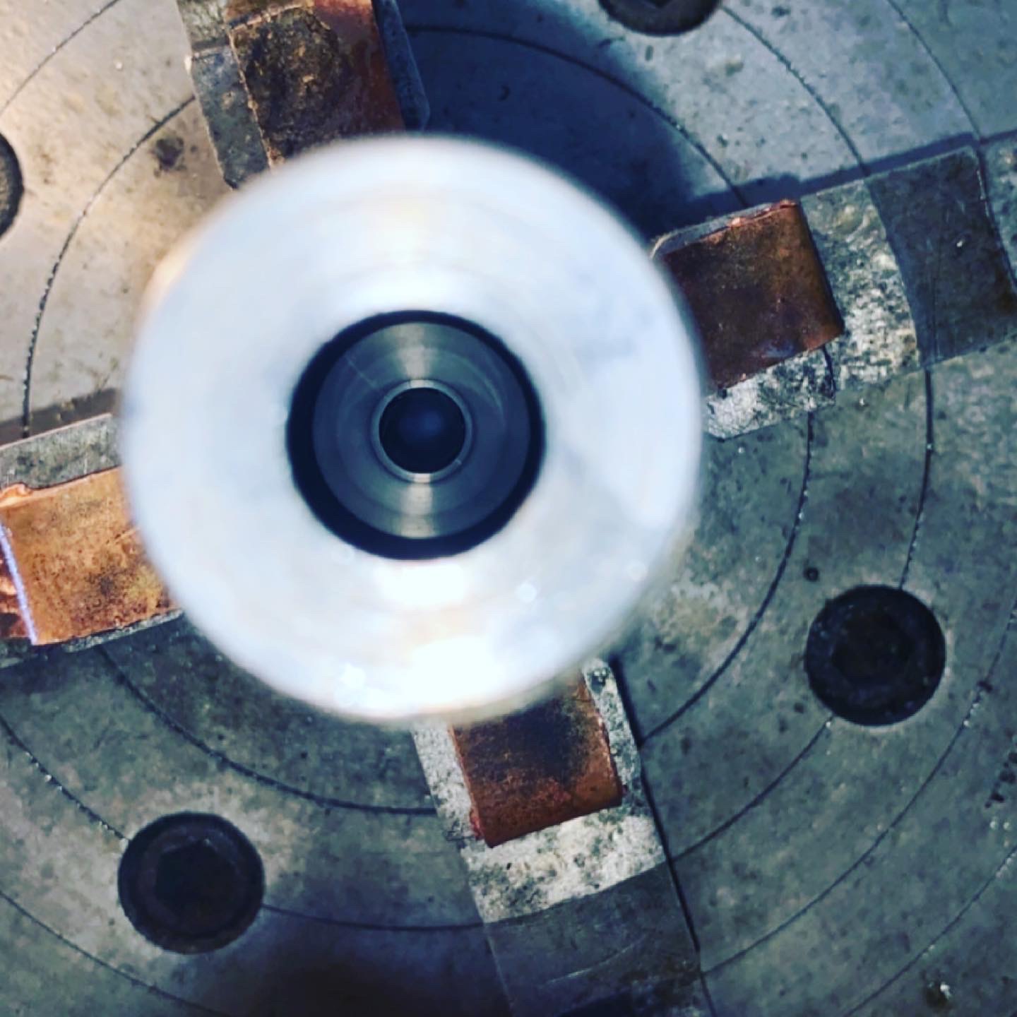

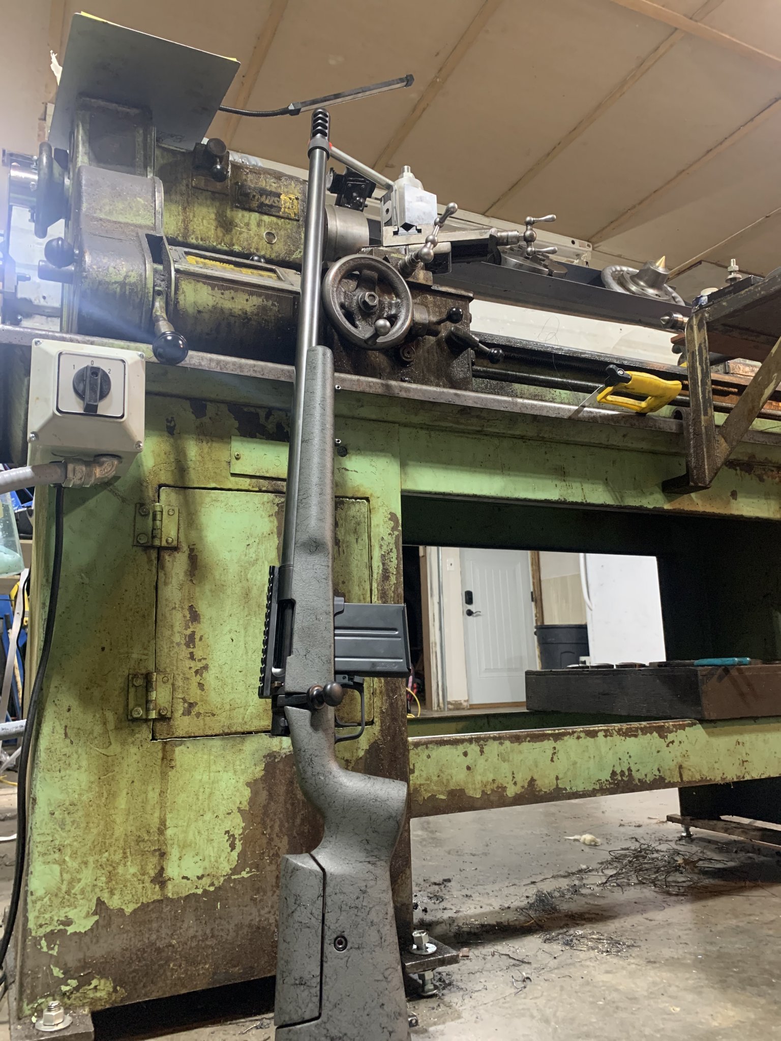

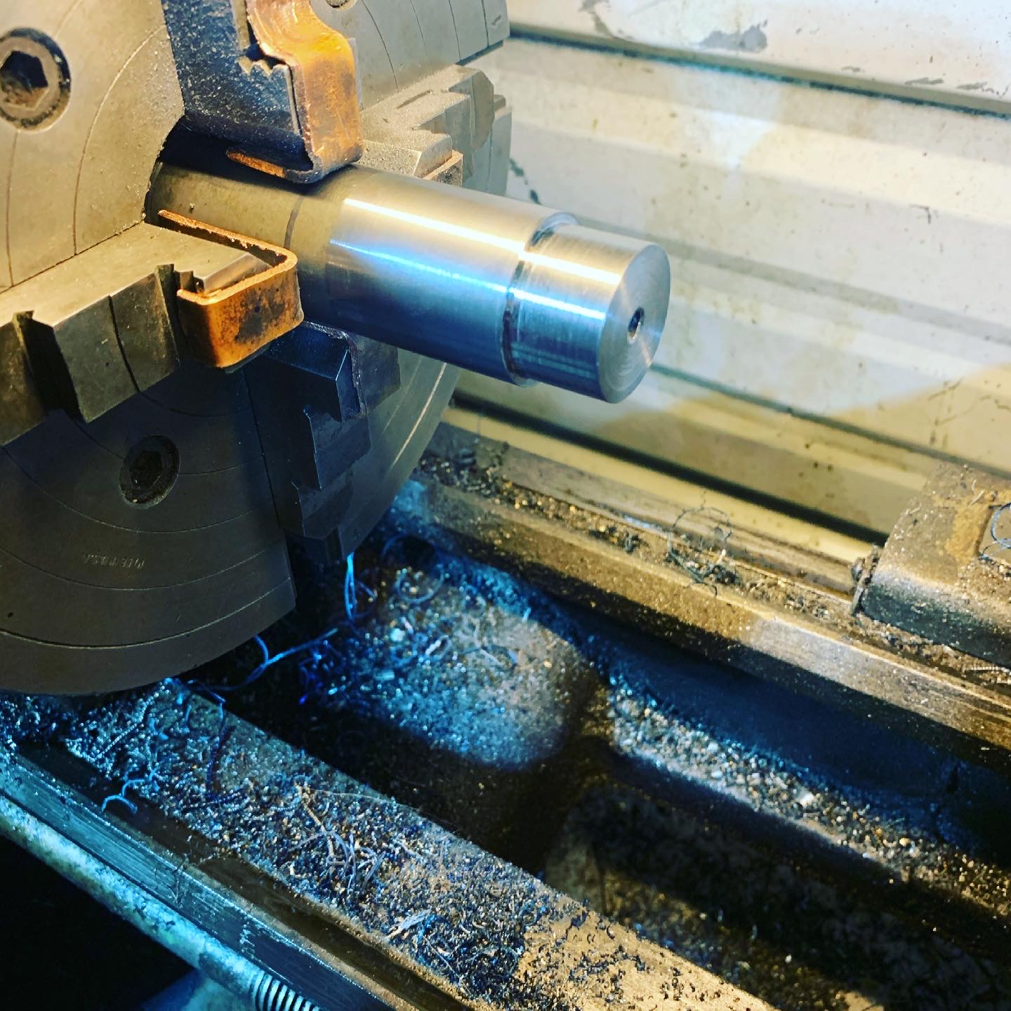

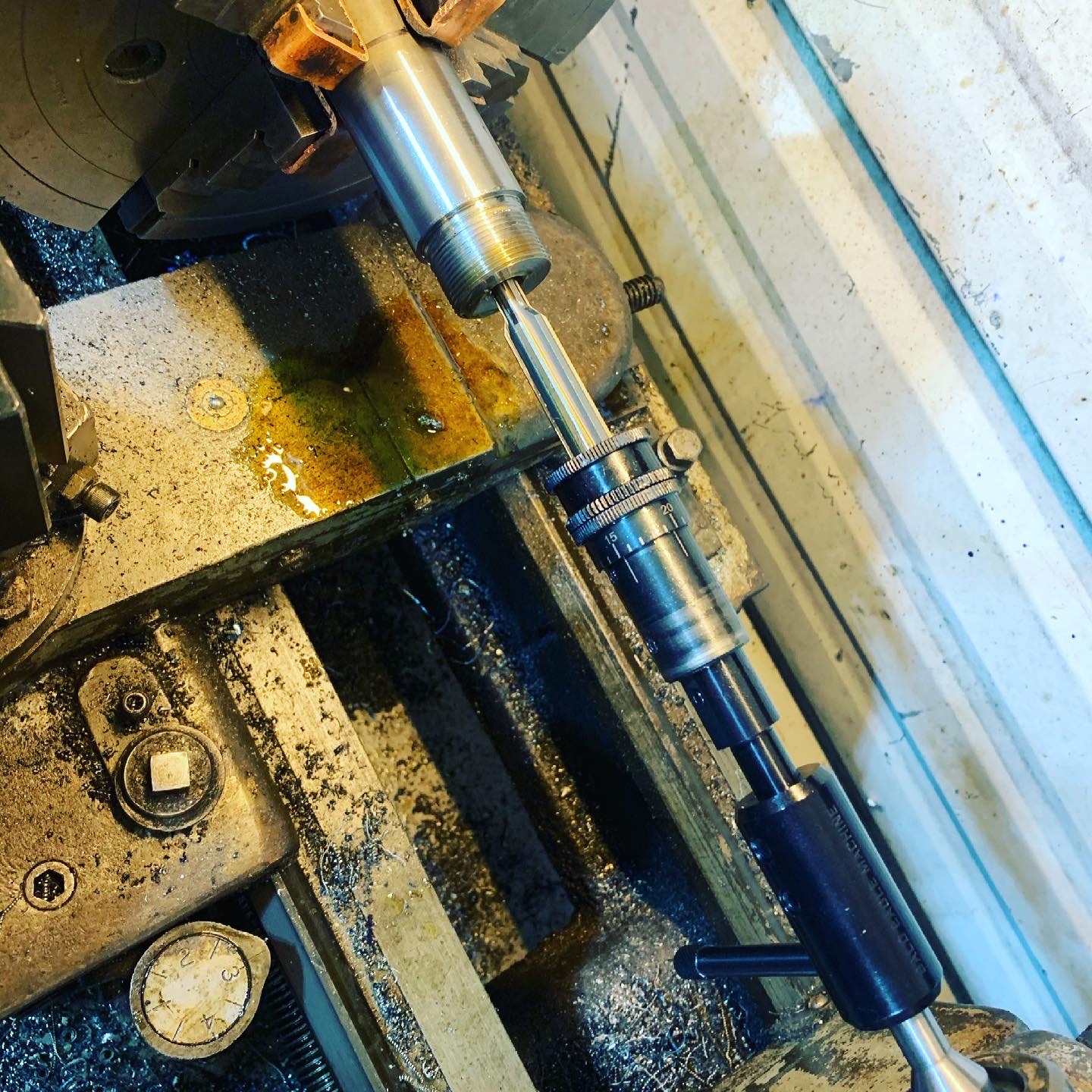

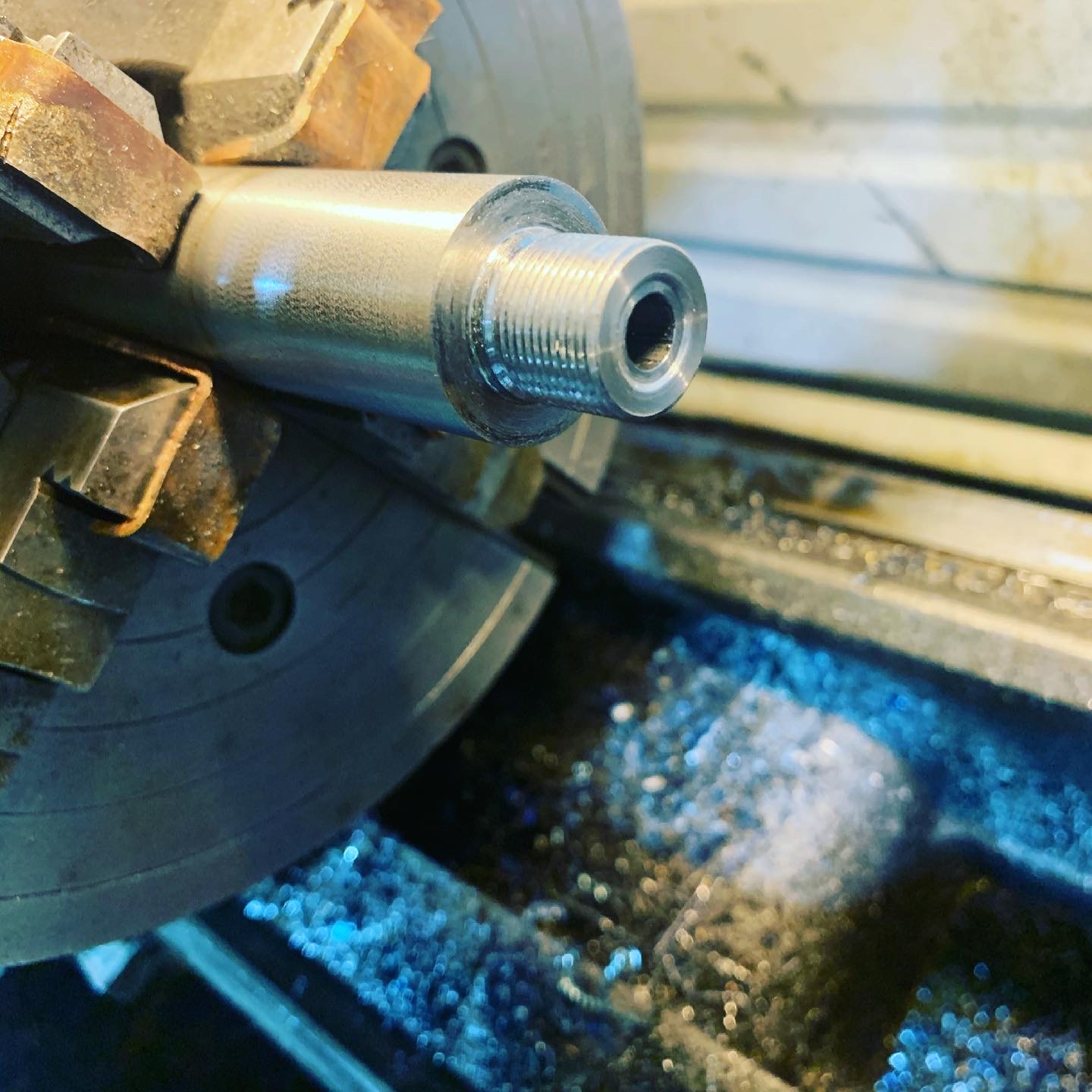

Hey dudes, thought I’d revive this old dead thread. Just wanted to tell you guys thanks, I can’t tell y’all how many times I’ve re-read your responses and focused on every word each one of you said. Almost three years in the making and this week I finished out and put the first rounds through my first tube I chambered myself. Is it the best? No. But it’s my first go and it shoots pretty well for a green mountain and 6.5 130eldm hand loads from a different rifle. 10 groups combined average just under .7 best group being .32 and worst being .8.
Arc nucleus
Timney hit
Green mountain 9 twist 6.5 chromoly
Bell and Carlson comp stick
Grayboe bottom metal
again, I just wanted to say thanks for sharing y’all’s wisdom with a young stranger. I know it takes time.
Arc nucleus
Timney hit

Good job. I'd choke up closer to the chuck, if you're comfortable with that. More rigid allowing for heavier cuts, less tool/material deflection, better surface finish, less likely to chatter, etc.
I don't know anything about the Arc Nucleus, but I'd be careful of any excessive unsupported brass case head/case wall. If it's a flat-faced bolt and you're close to the barrel breech (~.010") end you're probably fine so long as you didn't put a huge chamfer/radius on the corner of the chamber.

It is! Already got a blank for another cal just chomping at the bit to chamber another. This tennon was weird, it just seemed so short in comparison to a 700. After consulting with a couple other smiths over my math and measurements we all agreed it was right. If I remember right is was .637 tenon length, leaving .488 for threads after the lug
Thank you! I’ll be honest, after seeing all the posts from Jim see about excessive chamber chamfer and things of that nature, I just hit the face with some Emory cloth. It feeds great, brass isnt scratched. The case is fully supported and breech face meets the beginning of the case extractor groove perfectly. .151 protrusion per my Reamer/saami print.
edit: I forgot to mention, you’re the 3rd person to tell me to chamber closer to the chuck. I will most certainly be doing that on the next barrel, thank you for the advice!

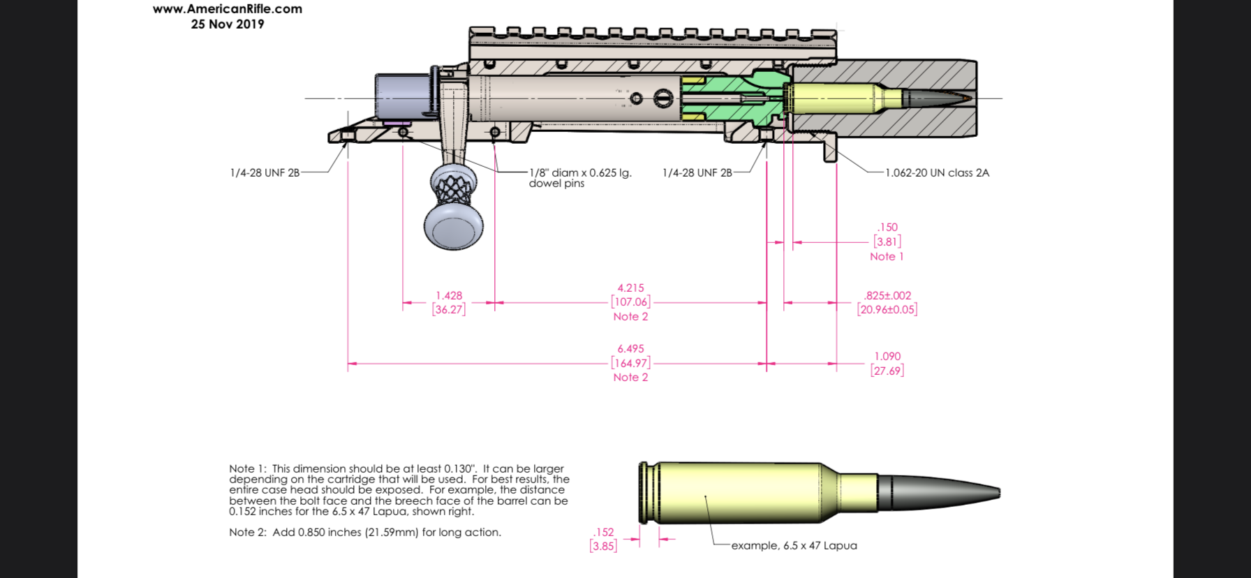

I’ve done two barrels for my Nuke.
.825( mine measured .8254) -.134 of exposed case to reveal extraction grove for a tenon length of .691.
Reactions: ajdemar215
What is the distance from the bolt face to the receiver on your Nucleus? I chambered an Archimedes and it measured .824 from front of the reciever to the bolt face. So I did headspace at .820 in order to compensate for crush and to have a little gap for wiggle room in a field rifle.
Just curious is all.
Mine was .8254 from boltface to outside edge of the lug on my Nuke.
The print I have says .825 +/- .002.
The .825 +/- .002 is the action dimension tolerance. I asked ARC because it looks like a headspace callout on print. They told me it was the action dimension.
