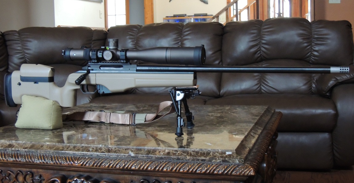

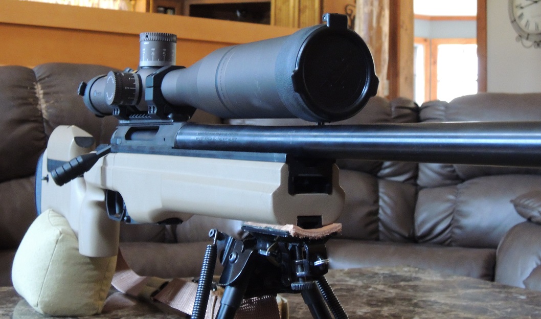

I had a Zeiss Victory on my TRG42 until recently. It sat up high as you describe and I wasnt fond of that. SO........
I ordered a 45MOA base from Near Mfg. (to replace the Badger 20MOA). Bought some Seekins Low 35mm rings and put a Vortex Razor 5-20x50 in there. The end of the bell of the Vortex sunshade (with objective flip open cap) is a couple millimeters from the top of the barrel. I used a scope clearance worksheet somewhere on the web that someone linked me to figure out how low I could go with rings and that 45moa base with the sunshade on. Although, the Vortex is NOT a lightweight scope.

helped quite a bit to get this scope as low as possible which I think is what you are looking to do.
good luck
(edit - If I think about it when I get home I can post a pic.....at work right now)

Yeah that calculator is awesome. Was dead on for my combo. If you put in all the variables accurately...helps to have the scope in hand too for some of the measurements. I'll get a pic this morning and put it up.
