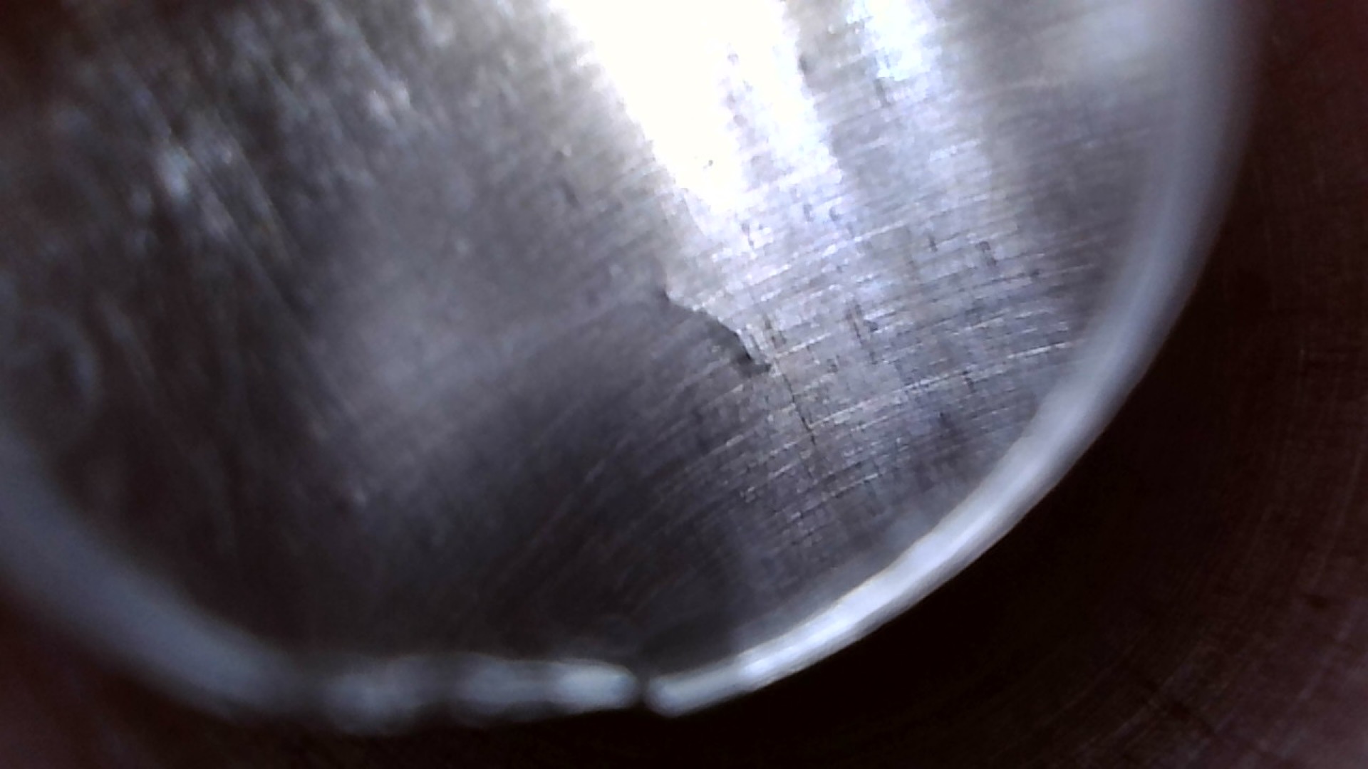

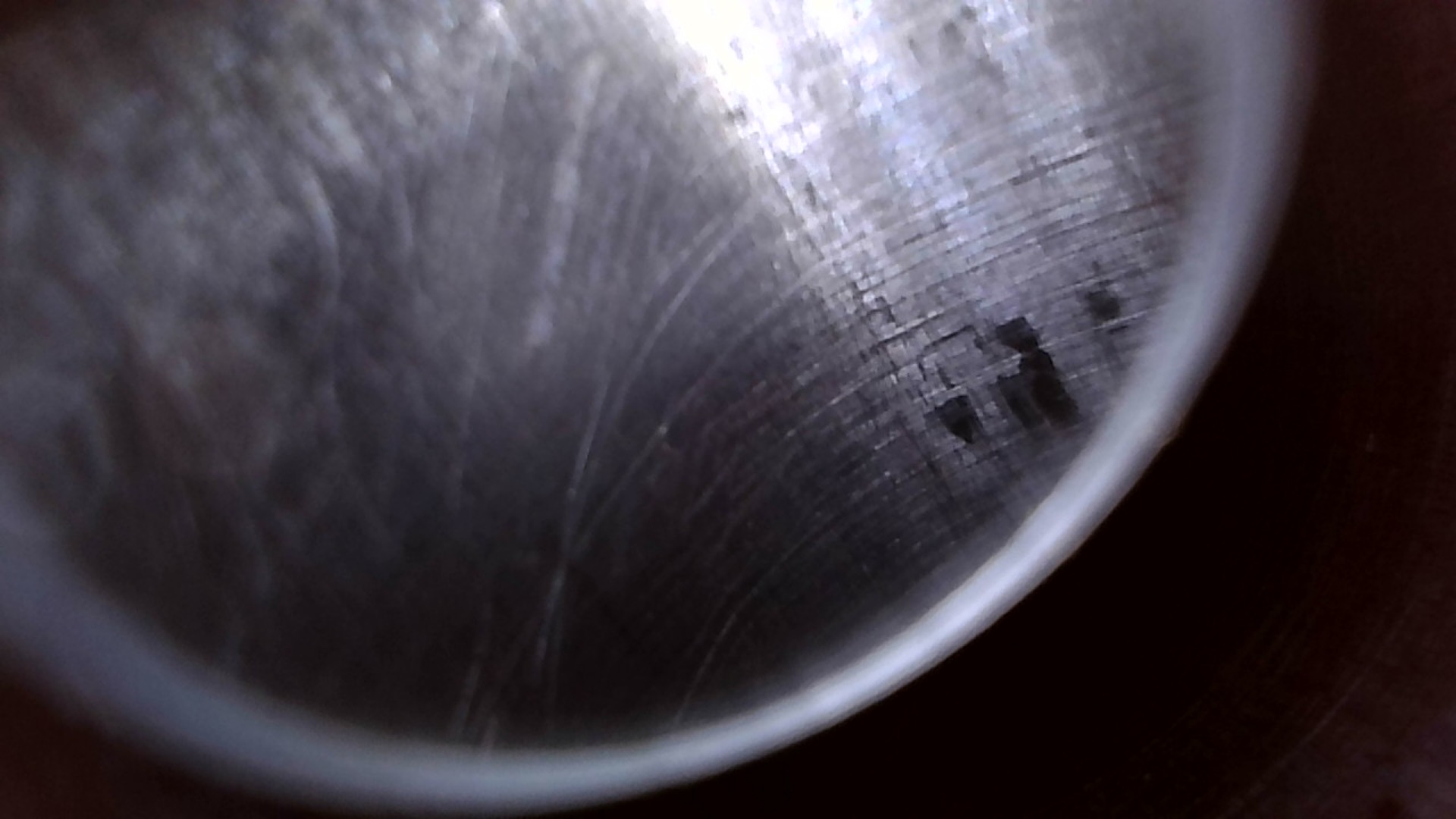

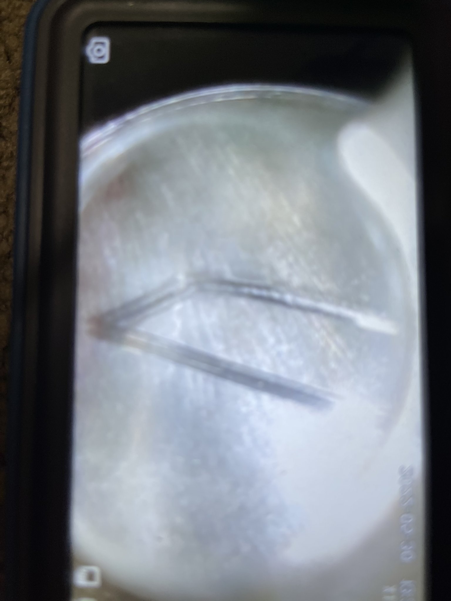

Hi Everyone
I ran the borescope through the barrel and found out the chamber area has some scratches and raised metal marks

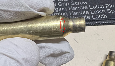

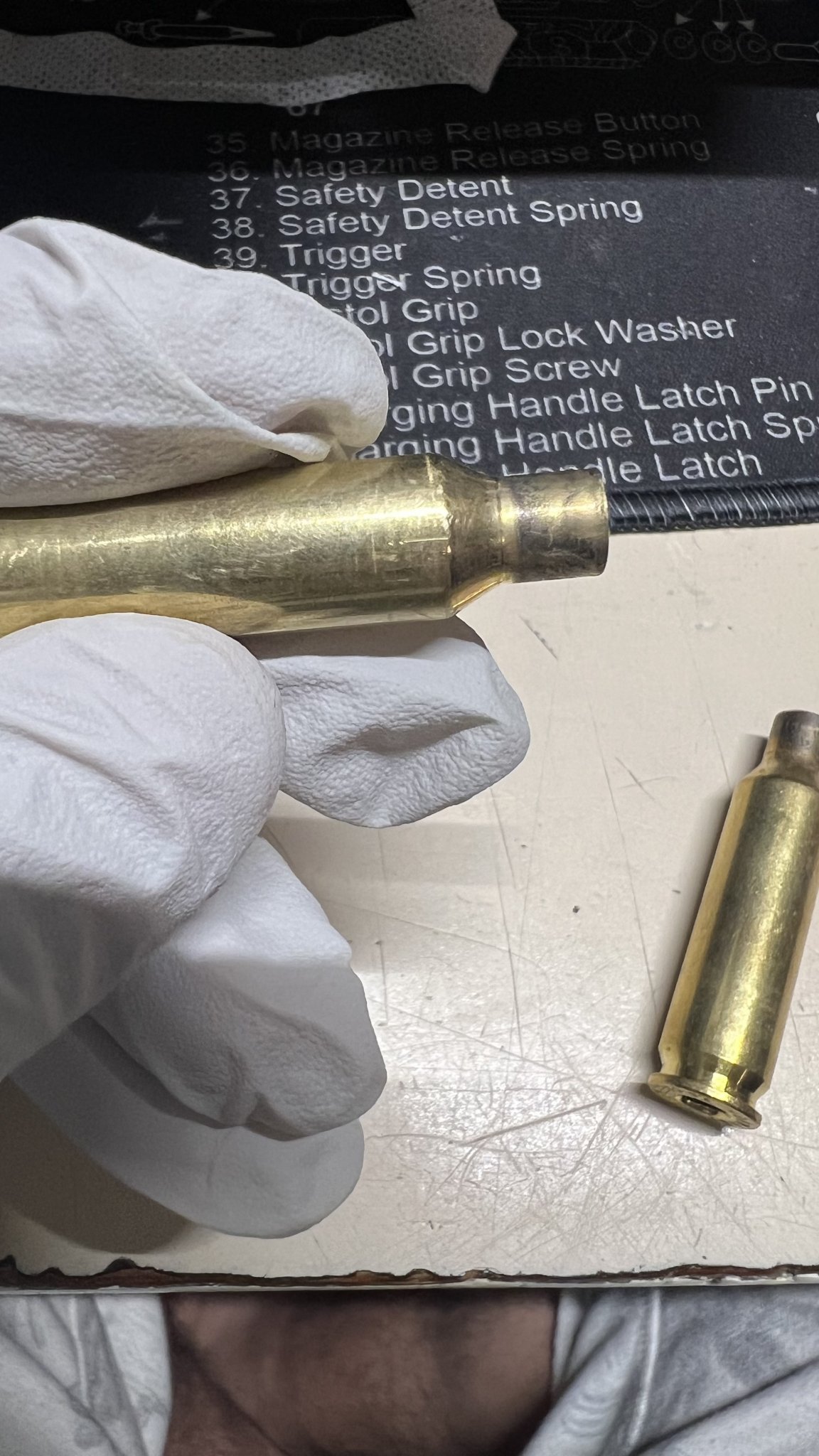

Tried to chamber a virgin brass and closed the bolt, extracted brass has the exact same marks
I look at the bag of first fired rounds that I saw they have the similar marks so it can’t be my mistake during cleaning and etc…
This is a custom rifle with carbon fiber proof barrel and has about 150 rounds down the tube.
I am very disappointed since it’s made by one if the best custom rifle builders in nation!
-should I worry about these scratches and are they going to affect the accuracy and consistency in load development?
How about case lifespan?
- solution to get rid of them?
- do I have to solve this issue before continuing load development?

They are so miniscule that they are irrelevant.
Clean it properly, then with lapping compound, do not lap it, just 4 passes, one to each direction and take new pictures after that.
I do not think a well done chamber is supposed to leave case shoulders dented / harmed.

Did you clean and inspect your barrel and chamber before putting the first round in it?
Looks like a chip embedded in the chamber?
Edit to add: Why did you put 150 rounds through it if you were seeing questionable marks on the brass?
The tiny scratch below the shoulder (if I’m seeing what you’re seeing) isn’t going to affect accuracy or case life at all.

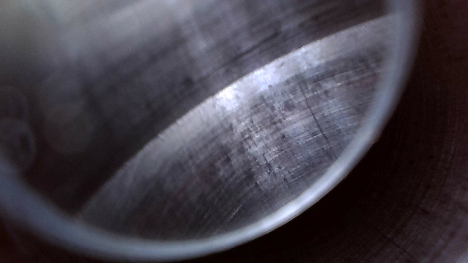

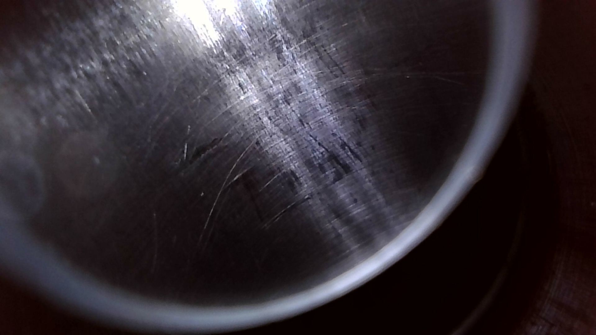

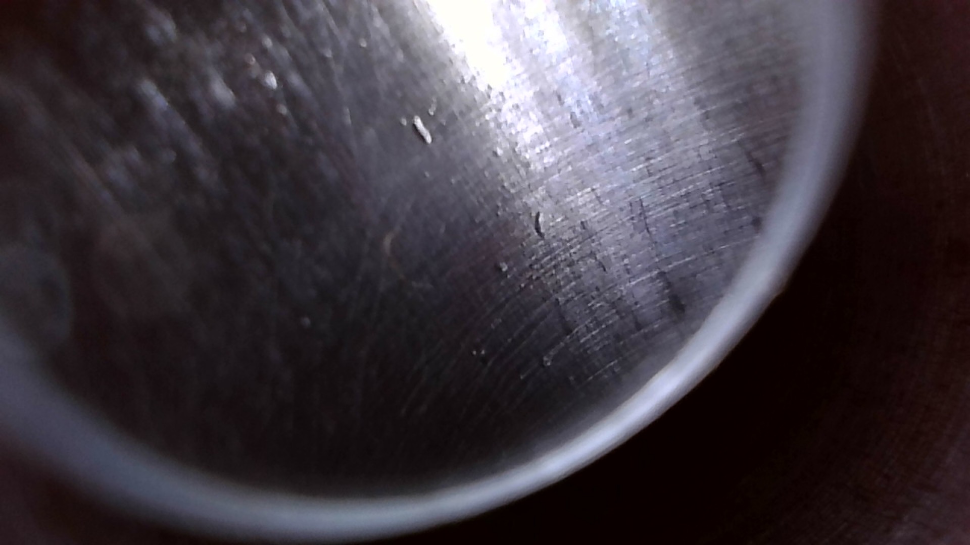

View attachment 8126006View attachment 8126008View attachment 8126009View attachment 8126010View attachment 8126011
Ignore those marks.
Load dev unaffected.
Brass life unaffected.
No solution required.
If you can’t sleep over it, send the pics to the manufacturer and see what they say.

You would categorize those as "deep scratches"? I think they are superficial and irrelevant. I would do nothing in this situation but shoot this rifle for its intended purpose. My 6arc dies scratch my brass worse that that. It was from using them to de-prime dirty brass before I purchased a stand alone de-primer and cleaned fully before I hit them with the dies. I'm probably on my 8th firing on hornady brass, and it is not a problem in any way.

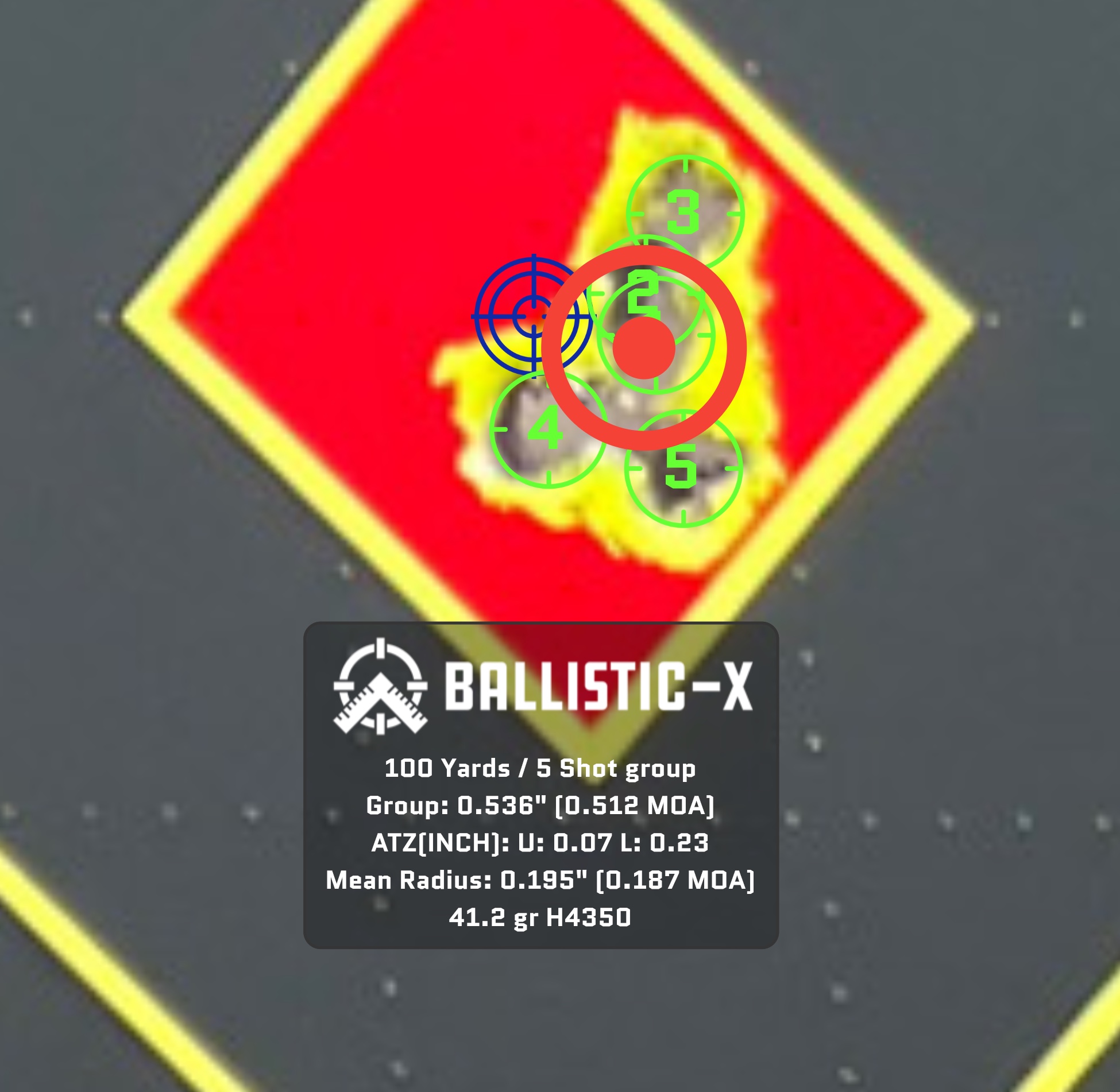

How is the rifle shooting/grouping?
I am not really a good shooter but I was able to mange these groups with my handload
Reactions: Baron23
So why did you feel compelled to look at your chamber/barrel with a borescope?
Trying to understand how you got from shooting .5moa (assuming all your groups are broadly similar in size to the one in the pic) to “I need to borescope this thing”.
Like many new shooters/reloaders, you’re way over analyzing and overthinking from what you have mentioned so far…If it shoots like that, don’t bother. Its not like you’re going to be entering the rifle into some kind of “internal barrel” beauty contest…

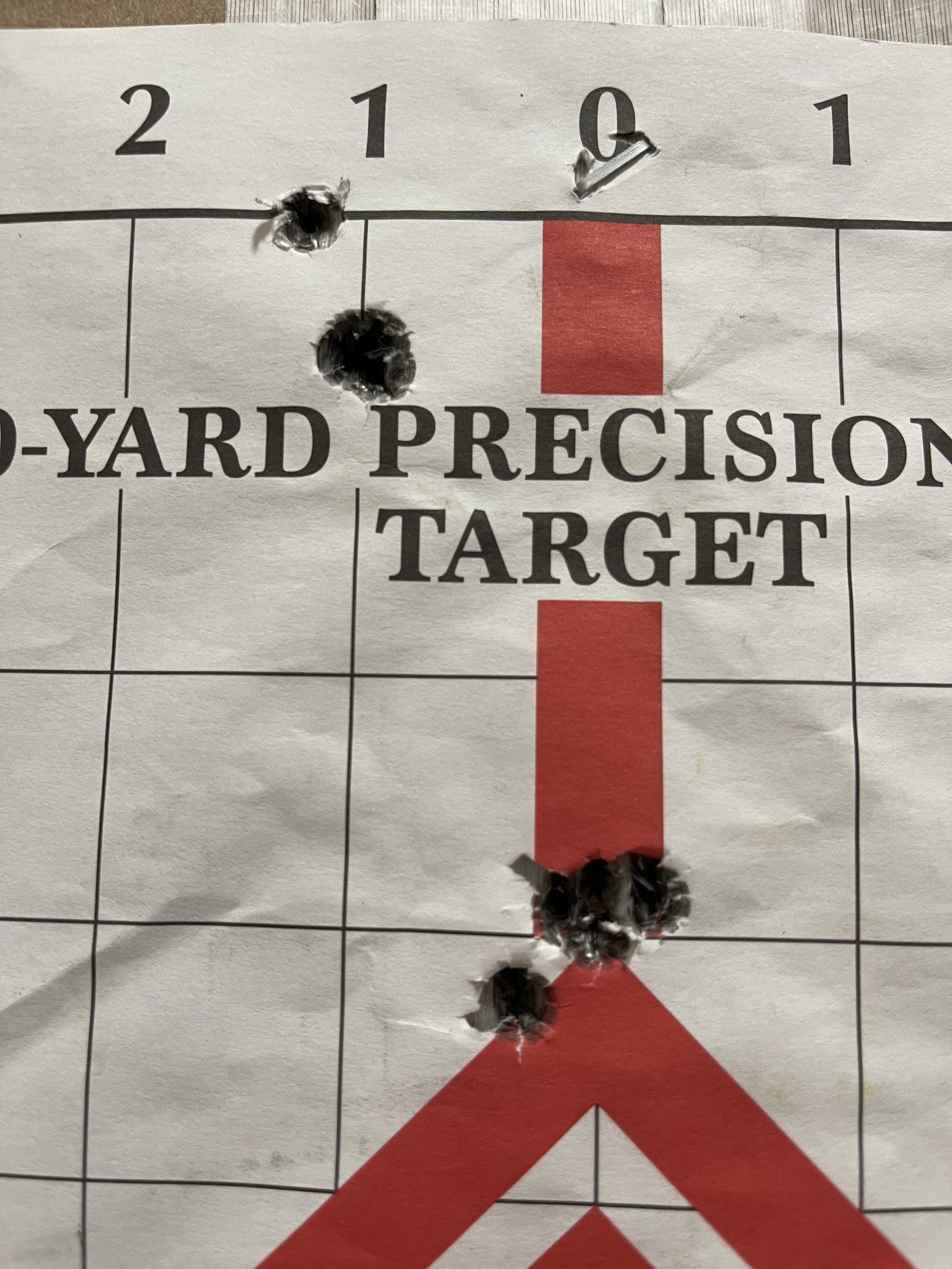

So the other day that I was shooting for groups didn’t have my sand bags, I had some spreads up to 1.1 moa that I know it’s because of the powder charge.
But with HORNADY ELDX ammo I wasn’t able to get lower than 0.9 MOA
The builder was claiming you should get 3/8 moa with factory match ammo which isn’t the case.
I think it’s just a bold claim!

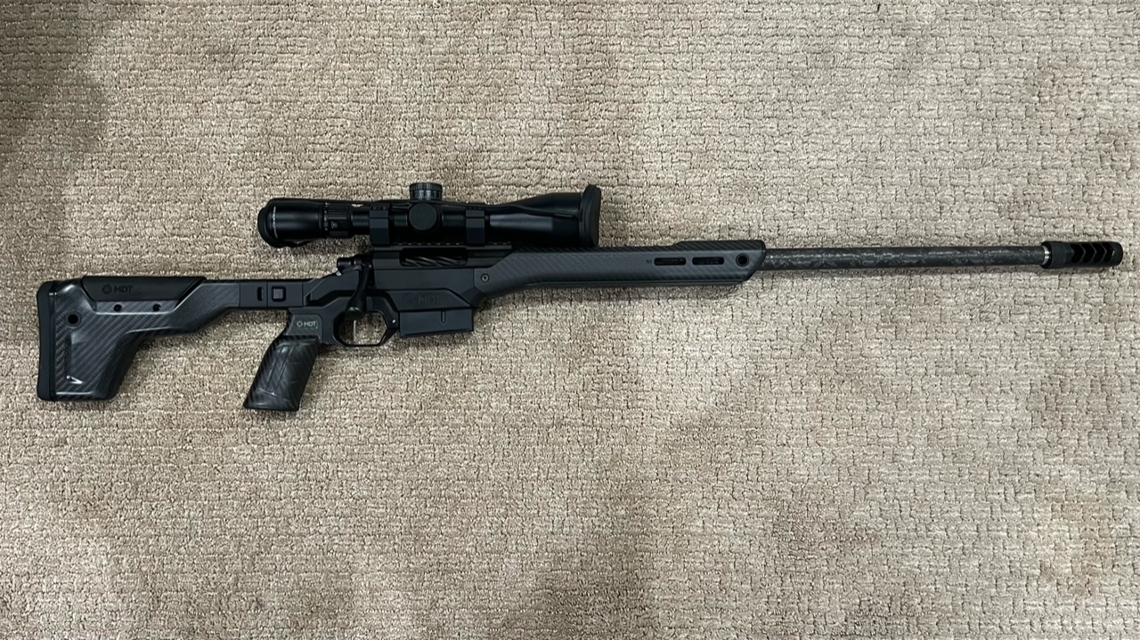

Who was the builder?
Altus Shooting Solutions
Looks like they built you a nice, well-shooting rifle.
“Accuracy guarantees” are retarded and if I was building rifles, i’d never quote one. Too many uncontrollable variables once the rifle leaves the shop that influence performance beyond the platform itself (mostly to do with varying shooter abilities and ammo quality, as you have seen).
I still would love to know how your mind went from “rifle shoots .5 moa; groups nicely or when it doesnt, I know why” to “i have to borescope this rifle”. The thought process makes no sense.
The issue is when you spend close to 5 grand on the rifle and wait 4 months to get your hands on it you expect them to pay extra attention to imperfections

That’s a nice looking rifle, congrats.

I have an Ern (@AccuSol-ERN is the Altus gunsmith) built BA and wow, I stuck a bore scope in it when new and was very impressed with the cleanliness of the chambering job and I'm very happy with Ern, Al, and Altus overall.
Personally, I wouldn't get too worried about superficial scratches in the case body at this point...particularly since you didn't clean the chamber yet (or at least before firing). I would clean it very well and see if you still get these scratches.
I would be thinking more about what looks like dents in the edge of the shoulders where it needs the body. Its very hard to tell from a pic just how egregious these are....did this brass hit the ground at the range or.....??
I did clean the chamber
Yes bras hit the ground.
And I even chambered a virgin brass in there and still got the same scratches, I will check a few more cases and see if they have a dent on the shoulder and will update you
Thanks....not sure what's up with the scratches but you can always contact Altus, tell them what you have going on and send them some pics, and see what they say.
As for hitting the ground....that seems like its a very strong possibility as to where the dents in the shoulder/body junction came from.

Hello everyone.
To start, I would like to thank everyone for helping out Mr. Fereydani as he deep dives into the realm of precision rifle.
Now let's get down to business. I can assure you the chamber did not leave my shop with anything short of a pristine 400grit polish (some even argue TOO polished). So we need to figure out why the scratches are there. I am thinking reloading practices on used brass (dirty brass, dirty sizing die, etc.). I have seen dirty brass mixed with case lube create a substance that rivals the best valve lapping compound. Unfortunately, this compound can very easily etch/dull/scratch the chamber surface finish quite easily and in short order. What goes for the chamber......also goes for the sizing die.
I recommend doing a superb cleaning of your sizing die. Then run a new piece of well lubed brass through. You may not get full contact on new brass......but hopefully it will be enough to catch scratches if it is the culprit.
Same goes for your rifle. Clean the chamber like you have never cleaned before and then dry it completely. If you can, shoot new ammo on a very clean chamber and look for scratches. If you are shooting reloads, make sure ALL case lube is off the round. I like using acetone to get every bit of lube off.
If the scratches still persist, they may very well be in the chamber now and can be polished back out.....depending on the severity. If this is the case please contact Altus Shooting office phone or email for further instructions.

I still have the cases from the first firing session and didn’t reload them and they have the same scratches
Also for my reloads
I never insert a dirty case in my sizing die or chamber, i do decap, tumble and start my measurements stuff…
I will share the info with Altus tomorrow.
And I even chambered a virgin brass in there and still got the same scratches, I will check a few more cases and see if they have a dent on the shoulder and will update youi
Just checked a few more once fired cases
No dents on the neck but same scratches on the sames spots
Reactions: Baron23
Hello everyone.
Regarding accuracy guarantees. I can assure you, nobody would drop an accuracy guarantee quicker than me, if it didn't affect customer sales. Accuracy guarantees sell rifles like horsepower numbers sell sports cars. I absolutely hate giving a guarantee on something I didn't machine 100% from action to muzzlebrake. That is also why I am picky about using top tier parts......not saying they are perfect.....but I am hopefully mimimizing the chance of an errant part and an unhappy customer.
I have built a number of prefits, B/As, and rifles that shoot in the .1s and.2s.
I have also built 338winmag (and like cartridges) hunting rifles the customer had to diligently work up a petload using a specific hunting bullet of his choice.
I wish all barrels were perfect, all bullets were match accurate, all dies were perfect, and all reloaders/shooters were experts in their craft. Unfortunately, this is not reality.
Please keep this thread updated with what you find/decide.
Ern - Altus Rifle Builder

Thanks for the reply
It left the scratches immediately after firing
And also tried a virgin peterson brass in the chamber last night and it has the same scratches after ejection
Reactions: Baron23

The barrel is proof research CF 1:7.5 24”
Sandero light, didn’t put it on the scale but should weighs less than 9 lbs including scope, it feels like a feather.

This is a legit scratch (all me. smith was not the cause of this)
This is how it shoots with garbage Hornady. 2, 5 shot groups.
“Cold bore” on the top one, my fault on the bottom one.
All courtesy bad seating die and me being short on time and rushing things… it’ll be a tomato stake in a year or so… shoot it, toss it, get a new one.
