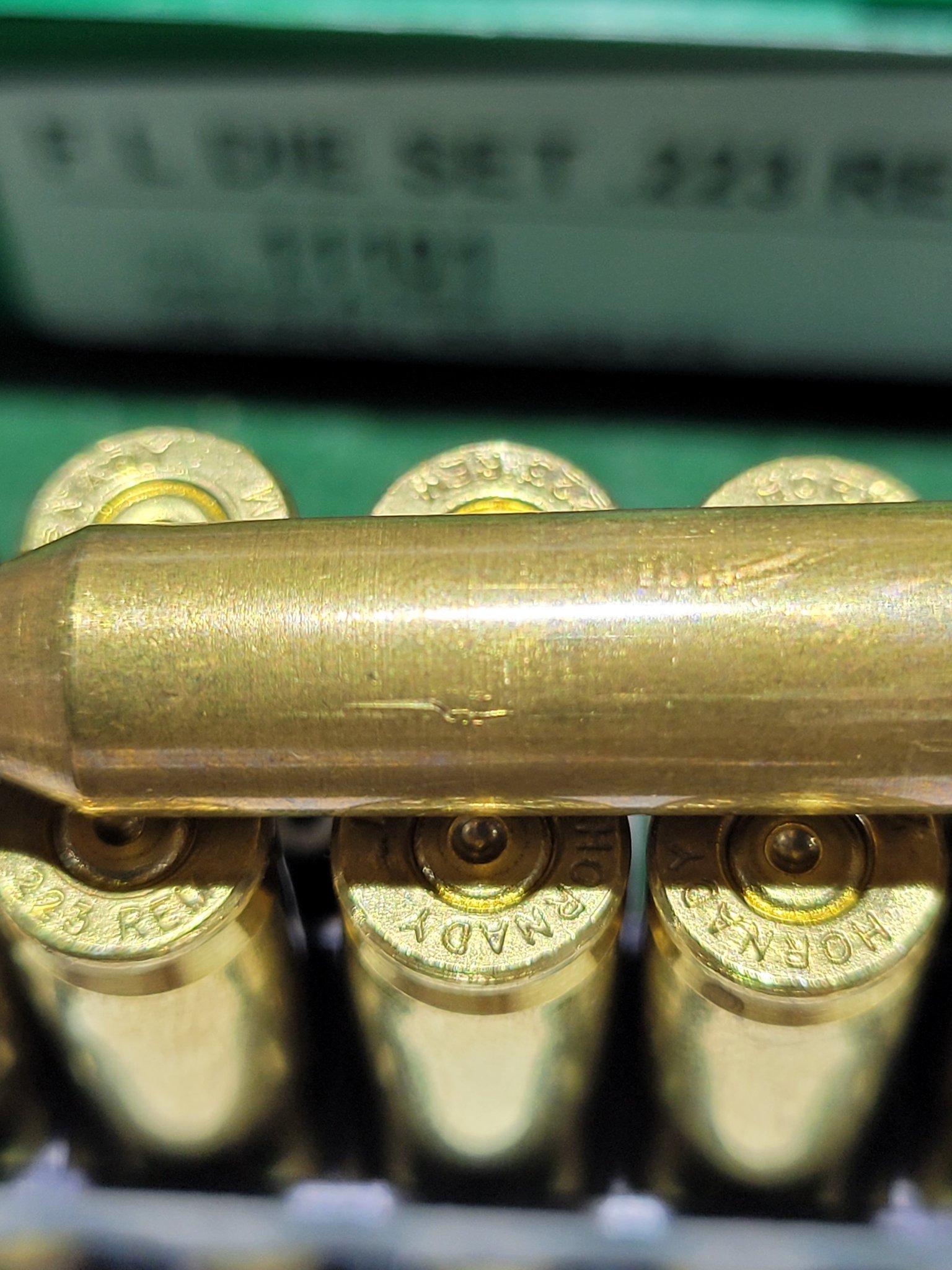

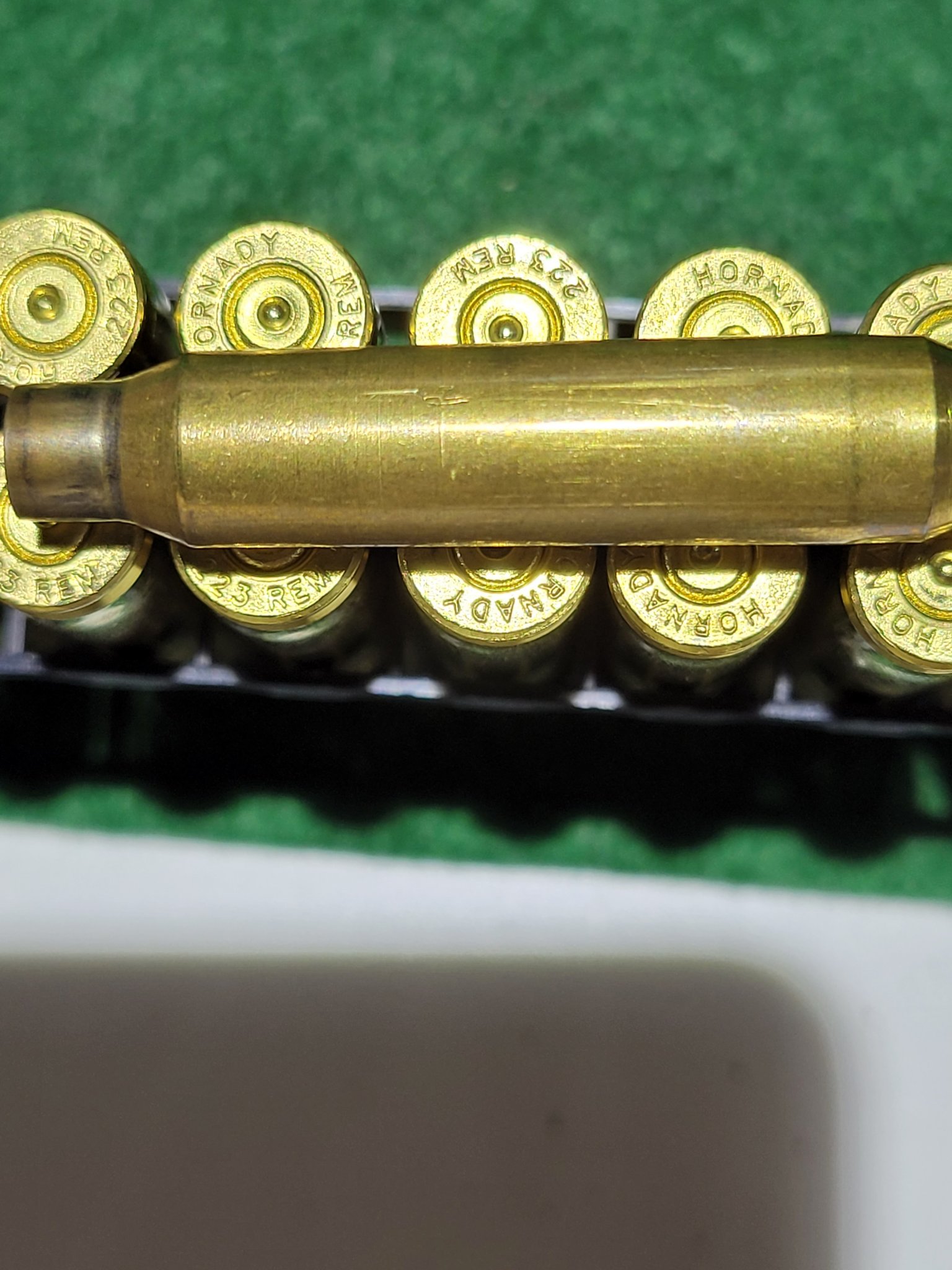

I fugured I would tag into this thread vs starting a new one.
1. Rifle shoots lights out.
2. I screwed up and scratched the chamber during cleaning.
3. Brass comes out after firing with a gouge (see picture)
4. Gouge is not there after extraction if round is not fired.
5. I have identified the spot in the chamber that is gouging the cases
6. I have a flex-hone and hone fluid
A. - should I flex hone the entire chamber?
B. - should I just target the troublesome spot with dowel and sandpaper?
C. - should I re-load this brass?
Thank you

A & B are really bad ideas.
If you step on your own brass at a field match, would you still reload it?
The answer to that question is the answer to C.

You don't have a problem with that brass.
I have about 80 pieces of .300 prc brass with a way deeper cam over pattern that i have loaded twice already with a serious load of 4831sc and 208 hybrids. No issue.
Go to post #48 and see it for yourself.

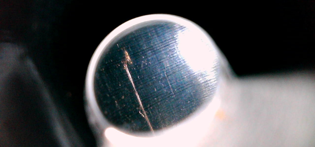

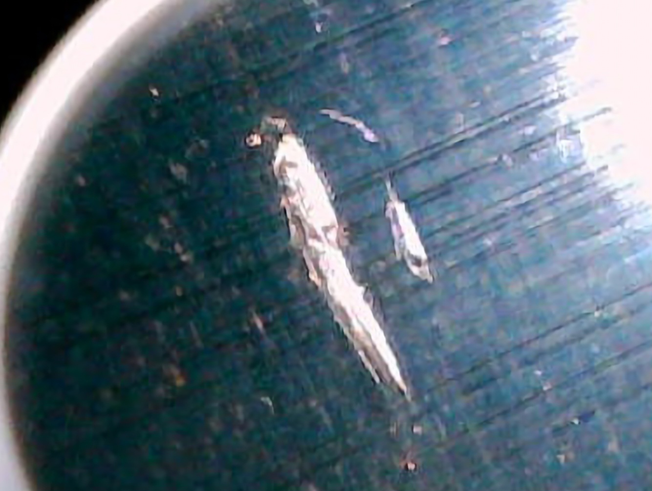

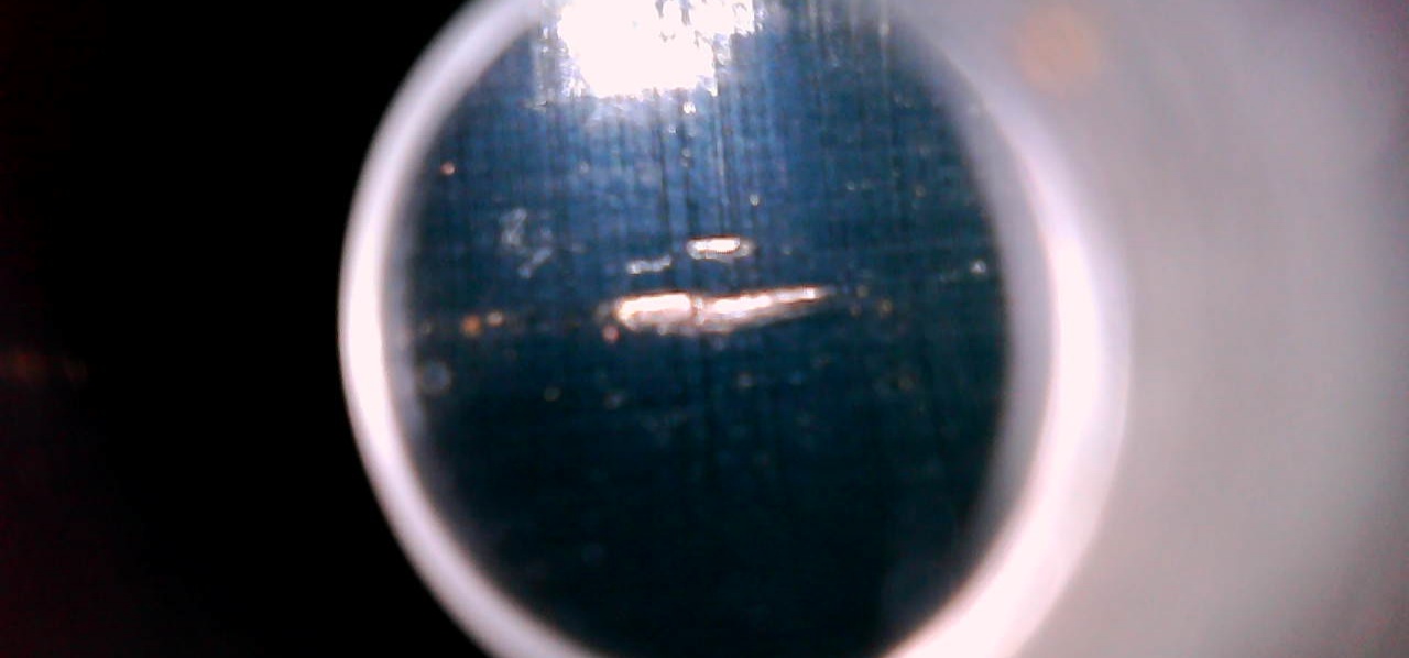

What does the chamber look like? It appears to be raised material in the chamber.
I agree with you about that. I think what is happening is upon firing the case wall is expanding into the raised material. I believe the raised material is from the cleaning rod scratch which pushed material into a "pile" like a snow plow pushed flat snow from the street into a pile...

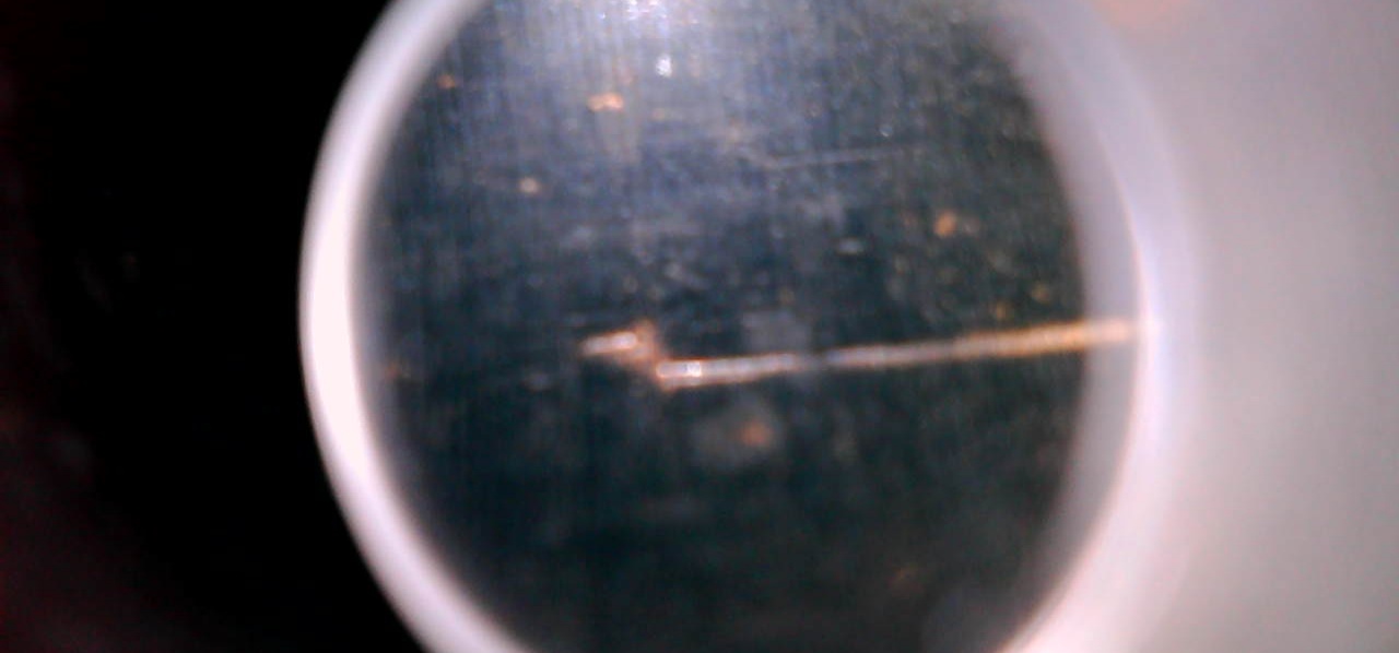

Here are two picture from the chamber..the odd thing is the streak picture doesn't line up with the case scratch. The second picture does like up with the scratch BUT that one seems indented, not raised?
Hit that with a brush and a copper remover first.
No. Brass brush. But I think the culprit was a brass jag and patch which was way to tight and got stuck in the chamber which I had to REALLY push/pull to get out. I think that is what did it.
I am an idiot
I think what you did was deposited a glob of brass in the chamber which is now scratching your cases. Go to town on it with a bronze brush and sweets 762 solvent. It should take it out. I don’t think it’s a scratch. You can’t scratch a chamber with a bronze jag.

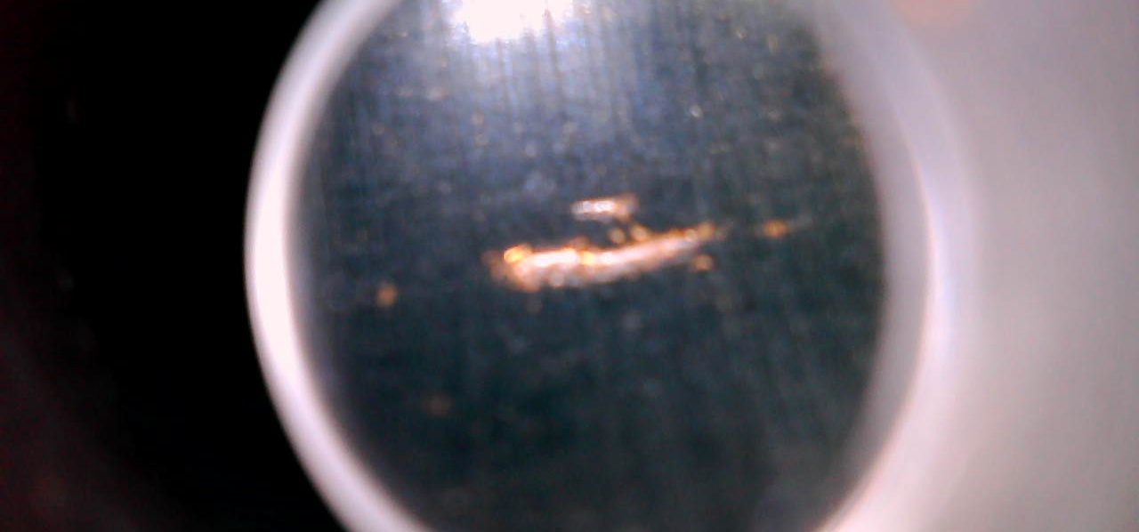

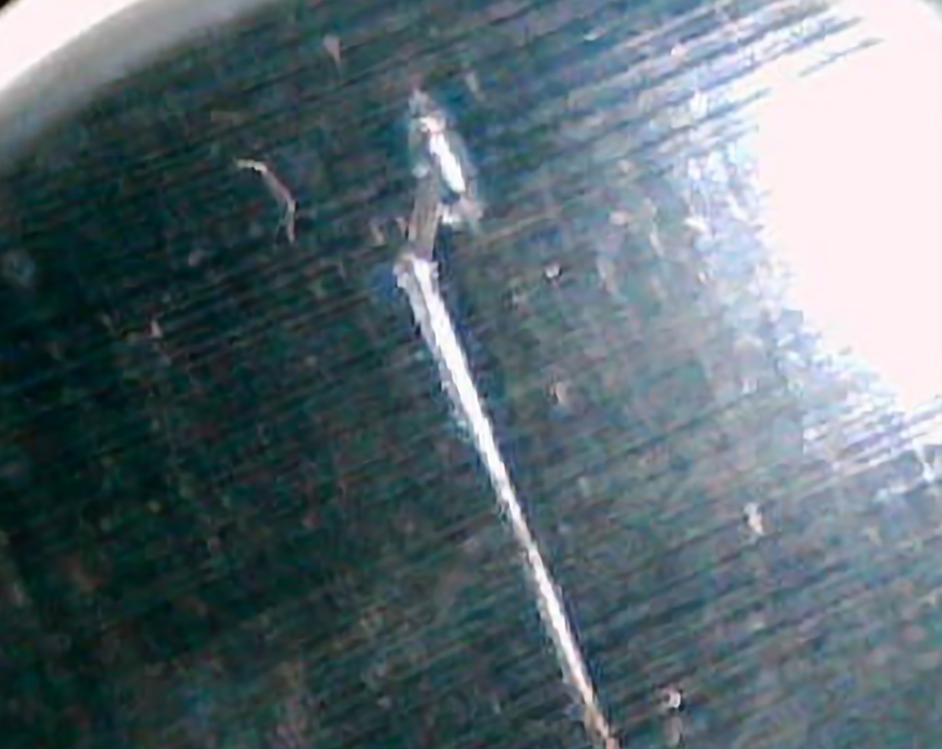

Ok...i went to town with some copper remover and brass brush. I used an oversized bore mop and brush and worked the chamber..the copper/brass is no longer obscuring the photos...tell me...do these look like raised deposits? I think so. The only thing I can think of is the end of the cleaning rod which has the rubber coating wear off and exposed the metal scratching the chamber....but these DON'T look like scratches. So I will head to the range and shoot some round and see if the brass comes out scratched again...if it does I might go with the the special rifle honing brush I have..
Thoughts again would be appreciated

Put a bronze brush on a short cleaning rod and soak it in some real good copper solvent. Spin it using a power drill at low rpm. I dunno what solvent you used but it’s gotta be the strength of sweets or Barnes cr
I thought I would update this post. I ended up using the flex-hone brush on my chamber. 15 or 20 seconds with a cordless battery powered drill at between 20-30% of max RPM.
Cleaned up the oil/fluid/chamber (which was rather dirty after the honing process)
Patched out the barrel and went to the range. And lo-and-behold....problem solved.
No more scratches on spent brass!!
