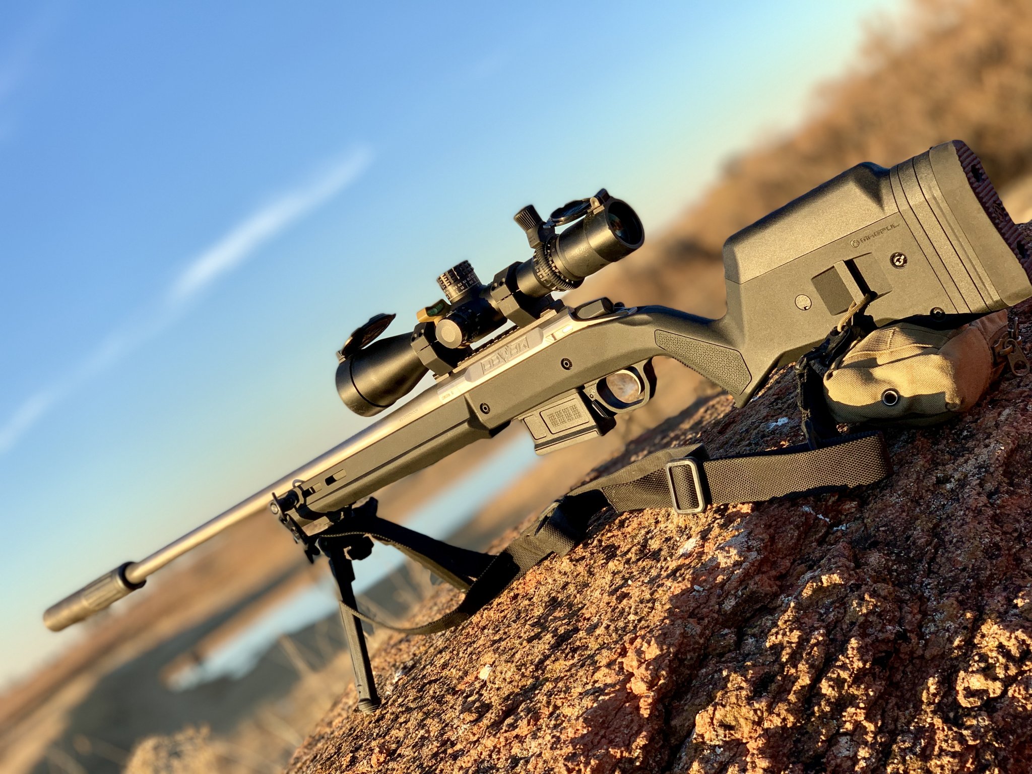

I picked up my Havak Pro HP1 last night. Adjusted the trigger down to 2#, now I’m waiting for my rings and suppressor mount, and bipod. All of that should be here today but I live in BFE so estimated delivery times aren’t reliable.
I bought some 140gr ELD Match and 143gr ELD-X. I’m hoping I have time to get it dialed in today so I can deer hunt with it this week in Oklahoma.
First impressions of the Havak are positive but to be perfectly honest, this is my first bolt gun since a Browning A-Bolt 30.06 about 20 years ago. The A-Bolt feels smoother than the Havak but it’s had just a few more rounds through it. Hoping the Havak will smooth out as time goes on.
Maybe I’ll be able to report back after this afternoon.
I put 26 rounds of the 140gr ELD Match and 20 rounds of 143gr ELD X through my Havak Pro HP1. Every round fired. I zeroed at 100 and then walked it out from 300 to 1000. It worked fine and I was able to hit 20” steel all the way. I’ll be whitetail deer hunting this next week with the 143gr ELD X so maybe I can report back with a kill.
