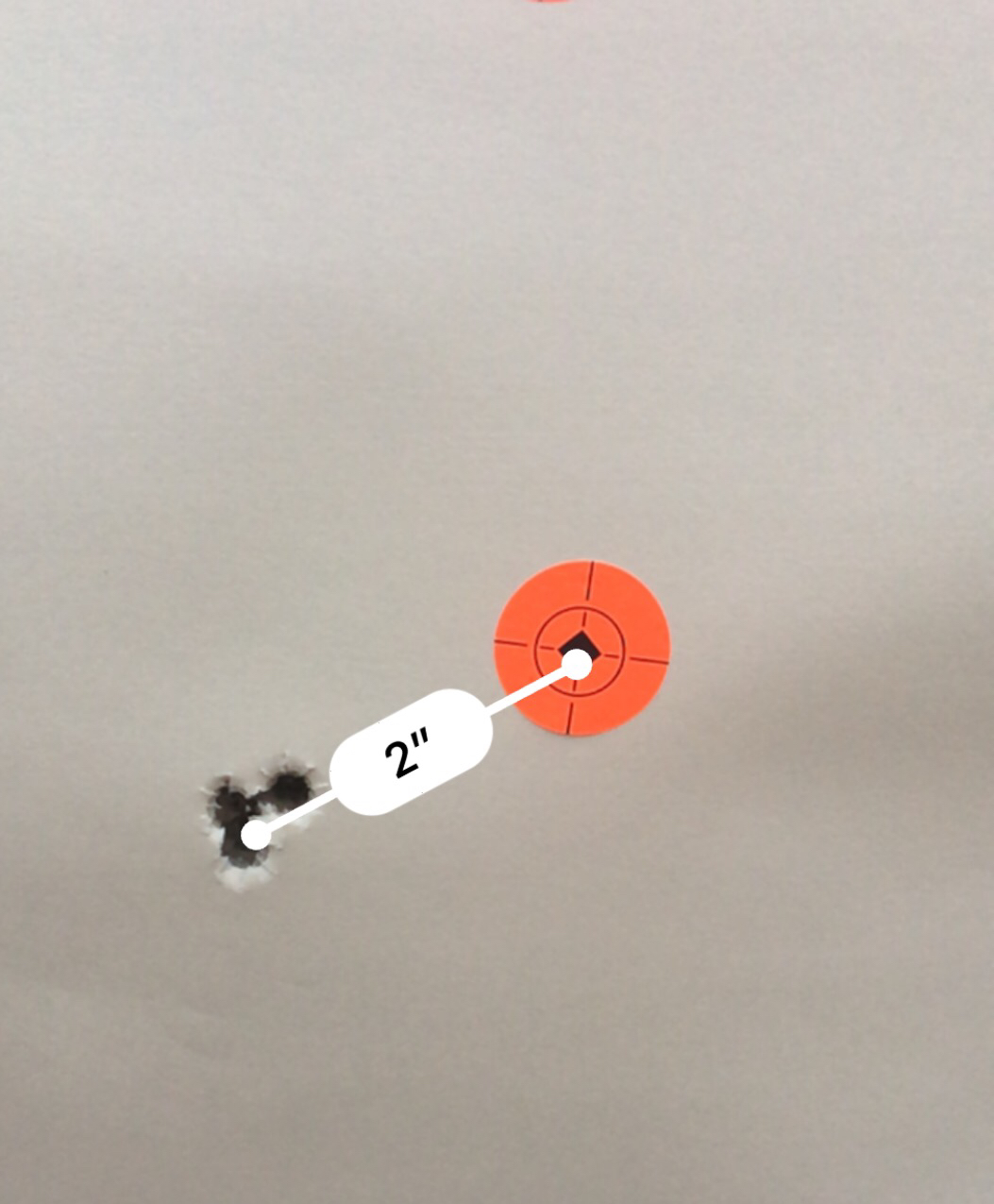

I have similar issues with my Havak Bravo. Factory 147 ELD-M is NOT accurate. Random flyers. With RL26 I seem to have a flyer every 5th shot. But need to shoot it some more.

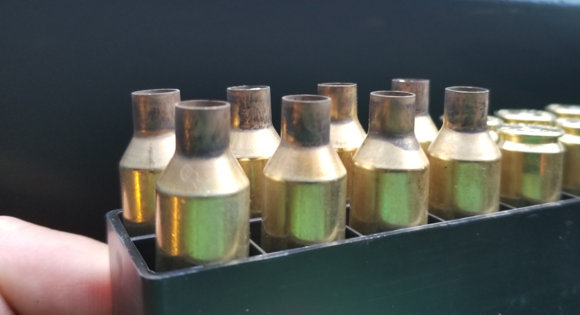

I find RL23 is the most consistent, but velocity is low. Been getting pressure signs (Ejector marks). I may try to trim the neck down more and see if this is the cause of my issue. currently have it @ 2.020-2.023". Spec is 2.015"-2.030".
Kinda disappointed in accuracy but could be just me.
It doesn’t sound like it’s just you. I get 2 good rounds and my third is an inch out. It’s very frustrating. I’m not sure if this is limited to just magnum cartridges. Either way, my bet is that proof will solve the issue
So it's kinda disappointing to hear that 3 of us have all had the same issue with that round. I mean the most likely issue is we suck at shooting but going back to back with my AI I go from one hole 5 rd groups to 3 rd WTF's. If I had to guess it would be chambers.

I do the same thing with my Dasher. 5 round groups under a half an inch and then the Havak at an inch plus. I’m also moving to the 6.5 SAUM when that barrel comes in. I’ve even debated selling the whole rifle and starting from scratch since I’m rebarreling anyway. Decisions, decisions.

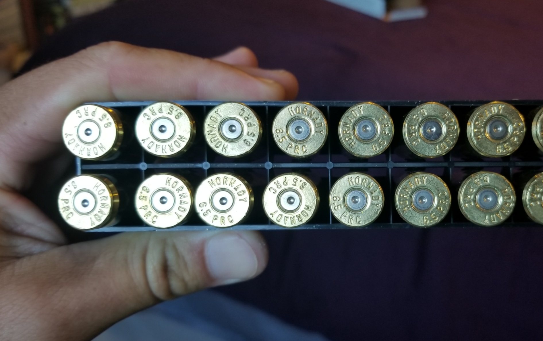

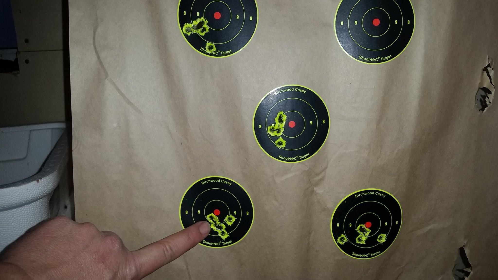

I went out and did a lot of accuracy testing with my PRC the other day to try to figure out what's going on firing 66 rounds of factory 147gr ELD-M. Now have a total of 166 rds through it. Results show that it does not like the KRG Bravo I got for it since I don't like the factory stock. It held .7 - 1.25" groups averaging .9" and was not consistent. It did better with a bare muzzle (.65") then a brake on it and liked the suppressor with groups consistently at .5"
With it's bedded stock that it came in it shot better and I tried 3 different weight Heathen brakes I had, the lightest at 3.6 oz worked better then the 2 heavier ones. I had to adjust the stock to be able to shoot it and who the hell puts a freaking golf ball in the middle of the grip anyway? It did .5" - 1.0" with the brake, worse with the heavier ones and again, not very consistent. With a bare muzzle it was .5 - .7" and with a suppressor was a consistent .5" with two groups at .35". So that barrel is just too thin for the round and barrel harmonics are an issue. Hopefully the heavier contour barreled version of the Bravo does better.
Not bad enough to send back since with a bare muzzle it's decent but not really shotable and very unpleasant. No way to spot your own hits for sure. I'd have to use a suppressor to get the groups I would have expected.

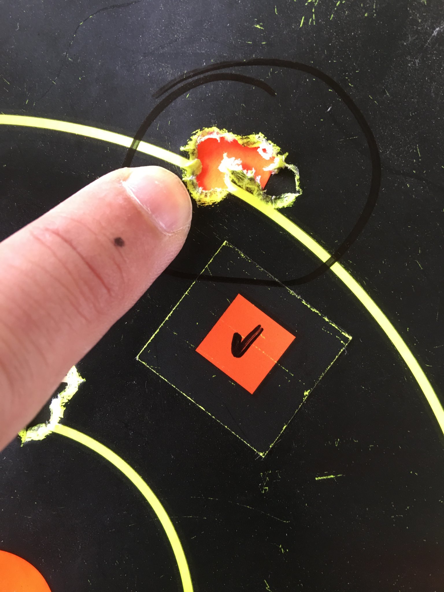

I also noticed that the firing pin isn't hitting the center of the primer and looking at the bolt, the hole isn't perfectly centered. There's also a lot of carbon fouling on the case necks..

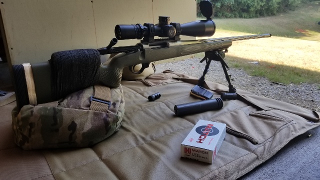

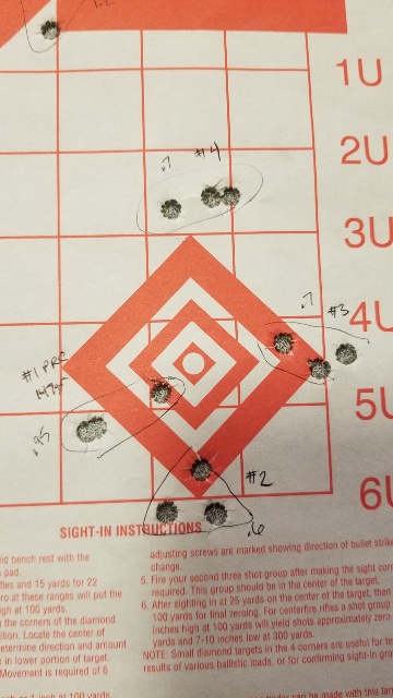

Got to run out to the range again for about 20 minutes and shot 3 groups. Looks like I am 2 for 2 with the PH1s being sub half MOA probably close to 3/8 if shot at 100. Not bad for 7lb factory hunting rifles with box ammo. No ammo that I have shot at 200 has been over 1 3/4.
200 yards with no time to let barrel cool.
Fed Non-Typical 140gr that my Tikka loves so much for some reason (1-1.25 groups at 200) one five shot group just under 1 3/4 inch.
Hornady Black 140gr .6 and .95 3 shot groups.

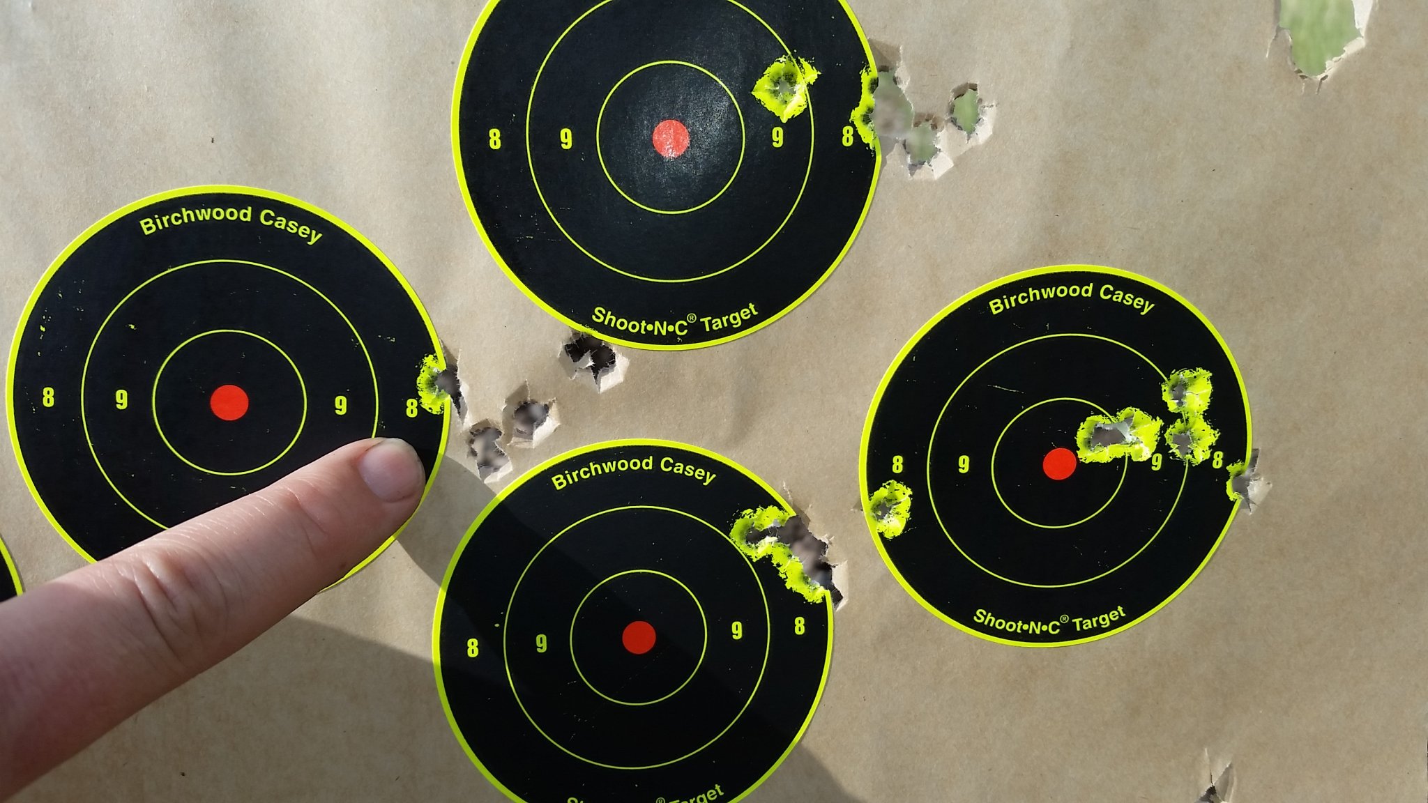

Well, so far my Seekins havak 6.5prc isn't even an MOA gun with factory match ammo. I will admit that I'm a little rusty, but I usually shoot at least MOA on a bad day.
I say, so far, because I did switch the barreled action to a krg bravo chassis. I have since put the factory stock back on and will try again this weekend.
I will also reserve judgement until I try some handloads. But if I can't get it to shoot I'll consider this an $1800 action purchase and will have my Smith put my proof barrel on it and jewell trigger.
Upper two groups are 147eld-m, bottom are eld-x.
