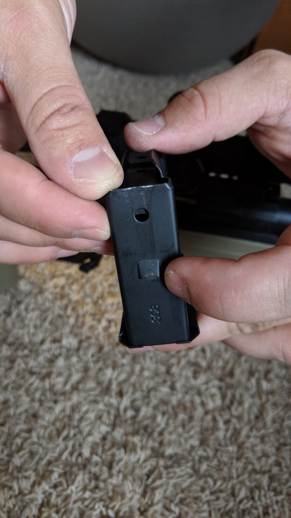

I got my 300WSM magazines the other day and they look the same as the one it came with, but it would not sit in the mag well. So I looked at the .308 mag it came with and noticed areas of significant wear on the magazine. Contacted Seekins CS and within a couple hours they responded to my email with a video request of the issues with my action, magazine, and chambering. I sent the videos and within 24 hours Seekins sent me an RMA and UPS pre-paid return label.
I was given an estimation of 4-6 weeks turn around time assuming all replacement parts are available. I am bummed about the rifle going back, but honestly it's hard to be upset when a company stands behind their products with a top notch Customer Service Team.
Where was the wear located on the .308 magazine? the feed lips?
If you compare the 300WSM and 308 mags, put the feed lips together, you'll notice the 300WSM is wider. that is to compensate for the 6.5 PRC being fatter.
That's a bummer that it will not sit in the magwell.
You can see by my thumb it's worn-- its also bent pretty bad, just cannot tell from this picture. Shipped my rifle back today-- I am confidant Seekins will get things working perfectly!

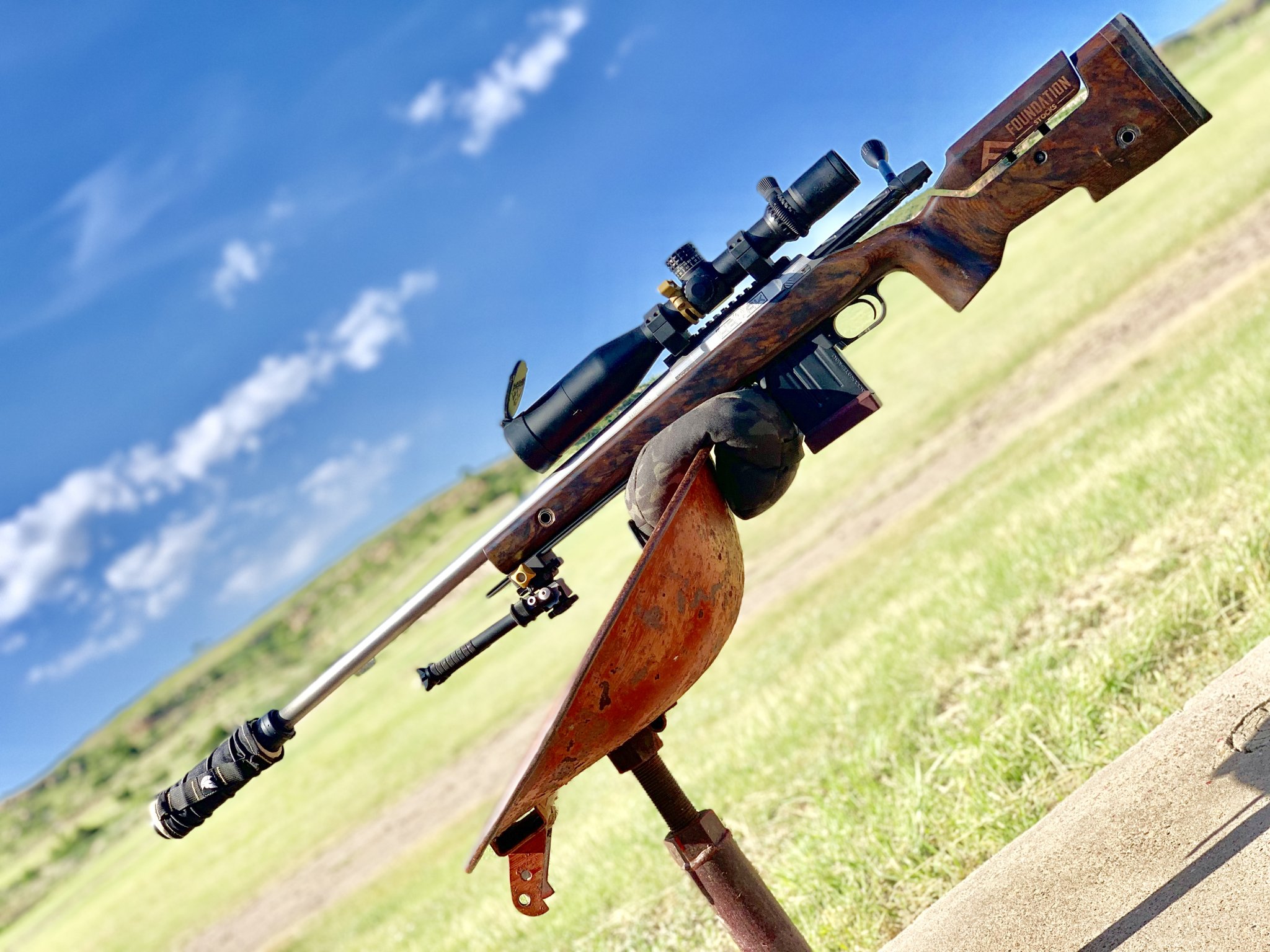

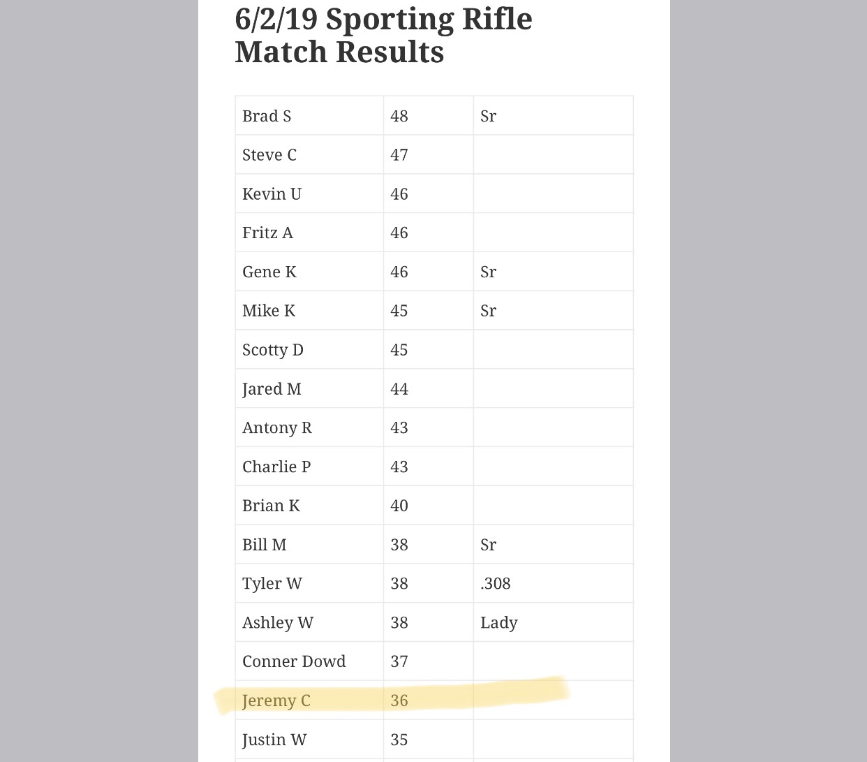

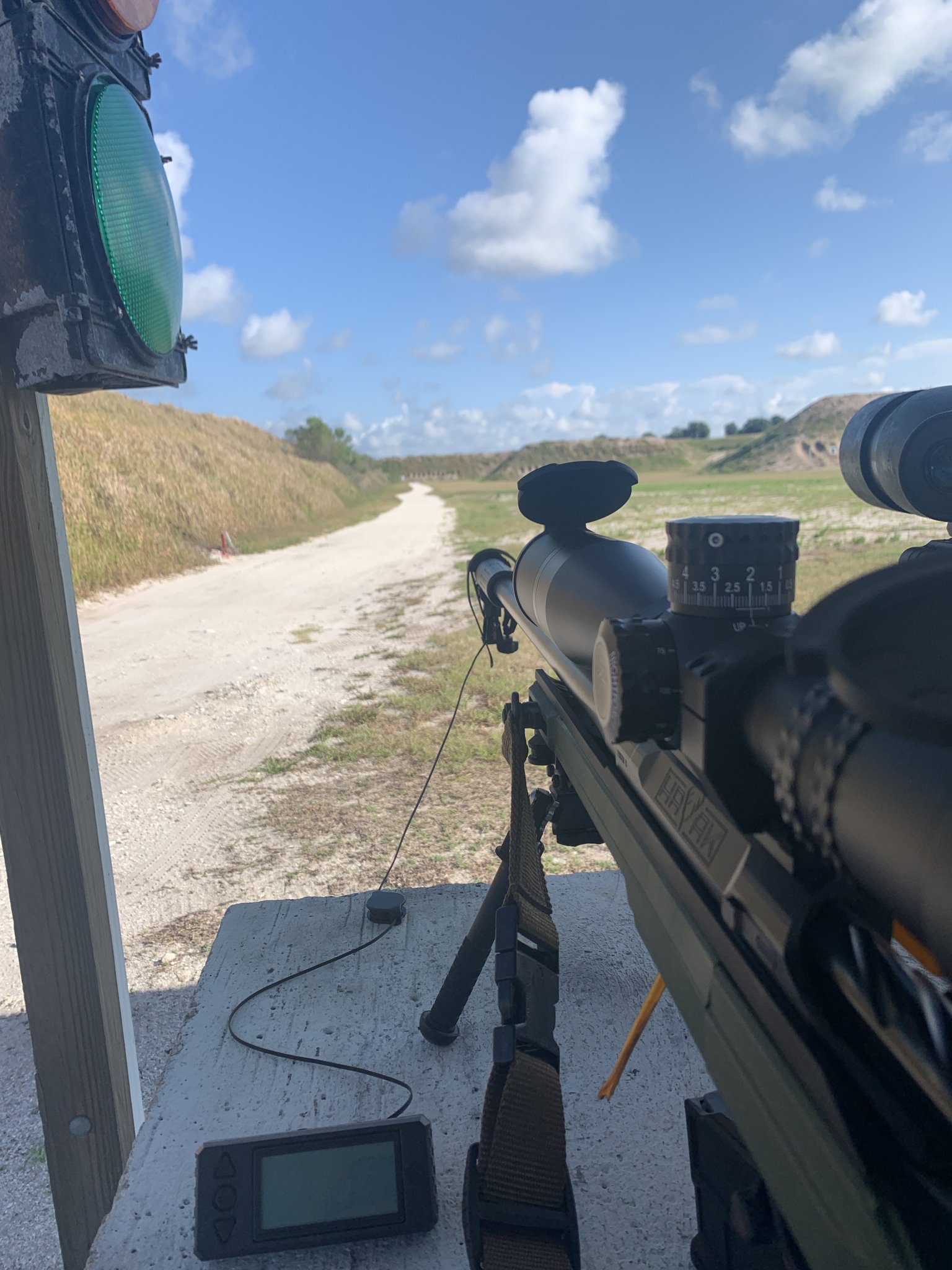

My Seekins Havak shot great yesterday at the Sporting Rifle Match in Raton, NM. The Foundation Stock performed awesome as well. Wasn’t my best showing because of the shifty mountain winds, finished 16th out of 50 shooters. I’ll be back to try again next month!

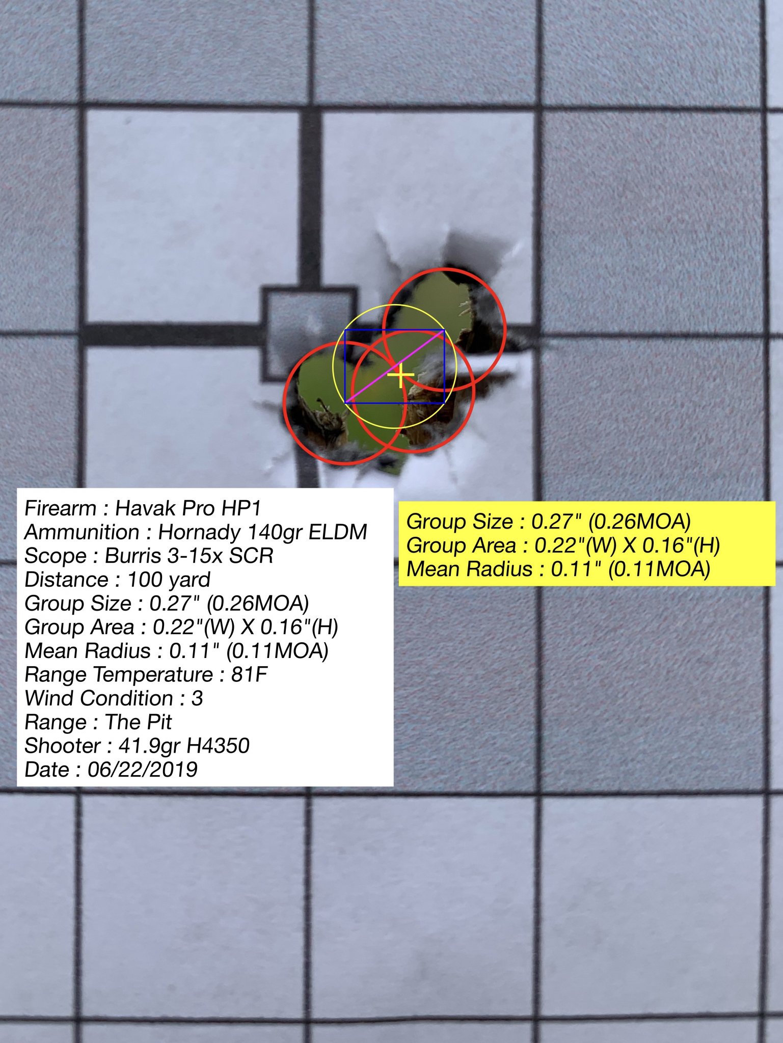

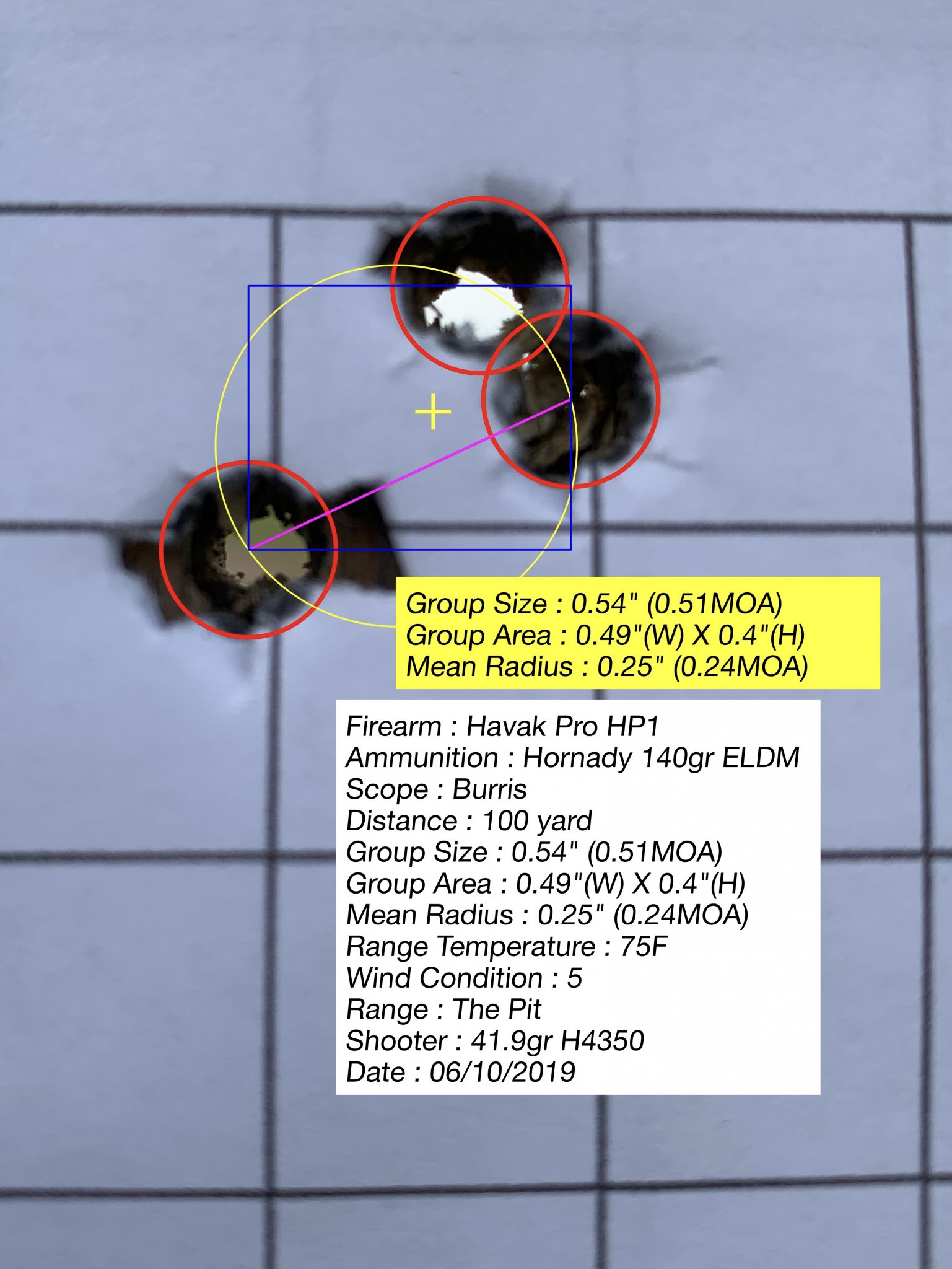

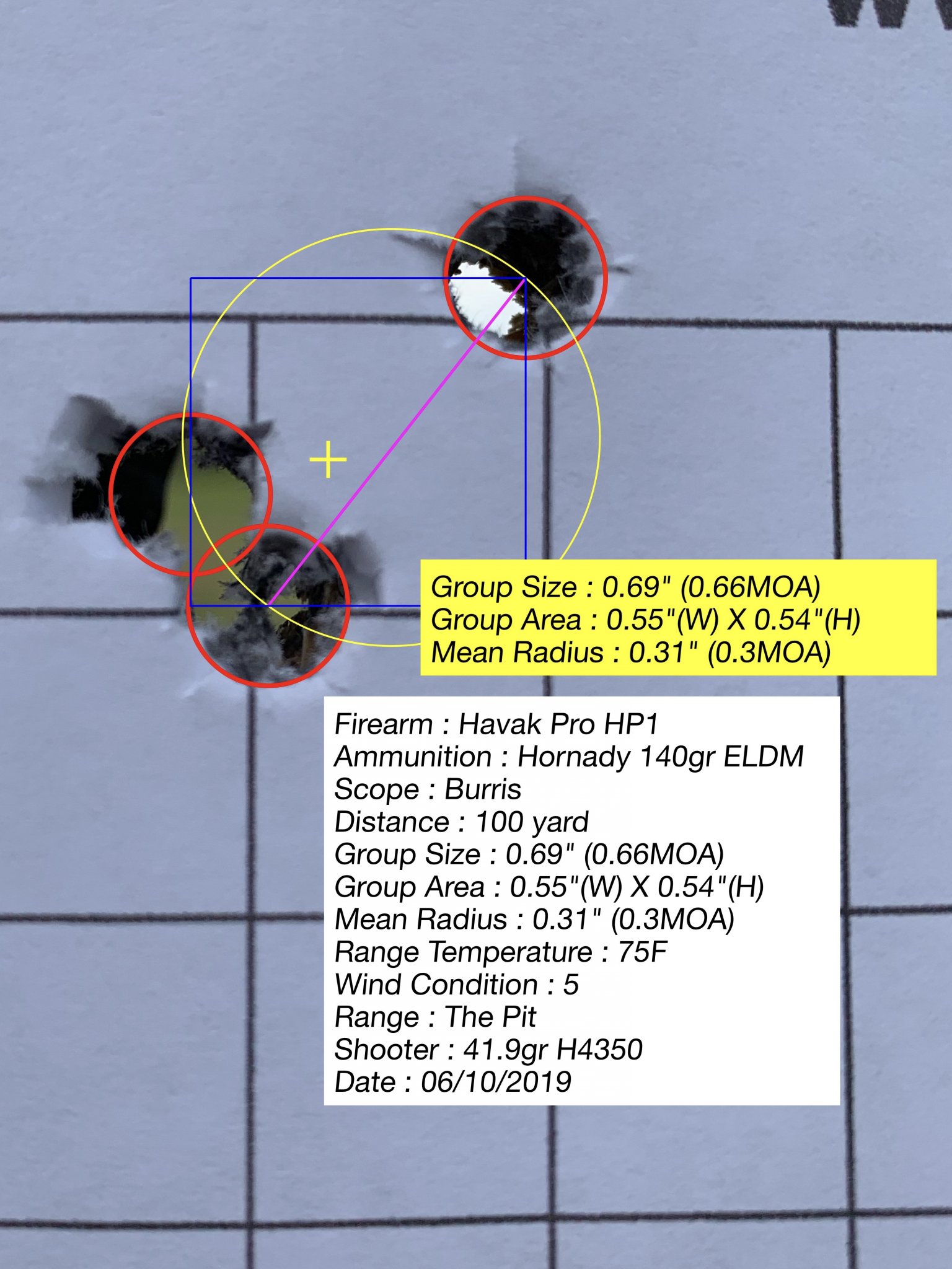

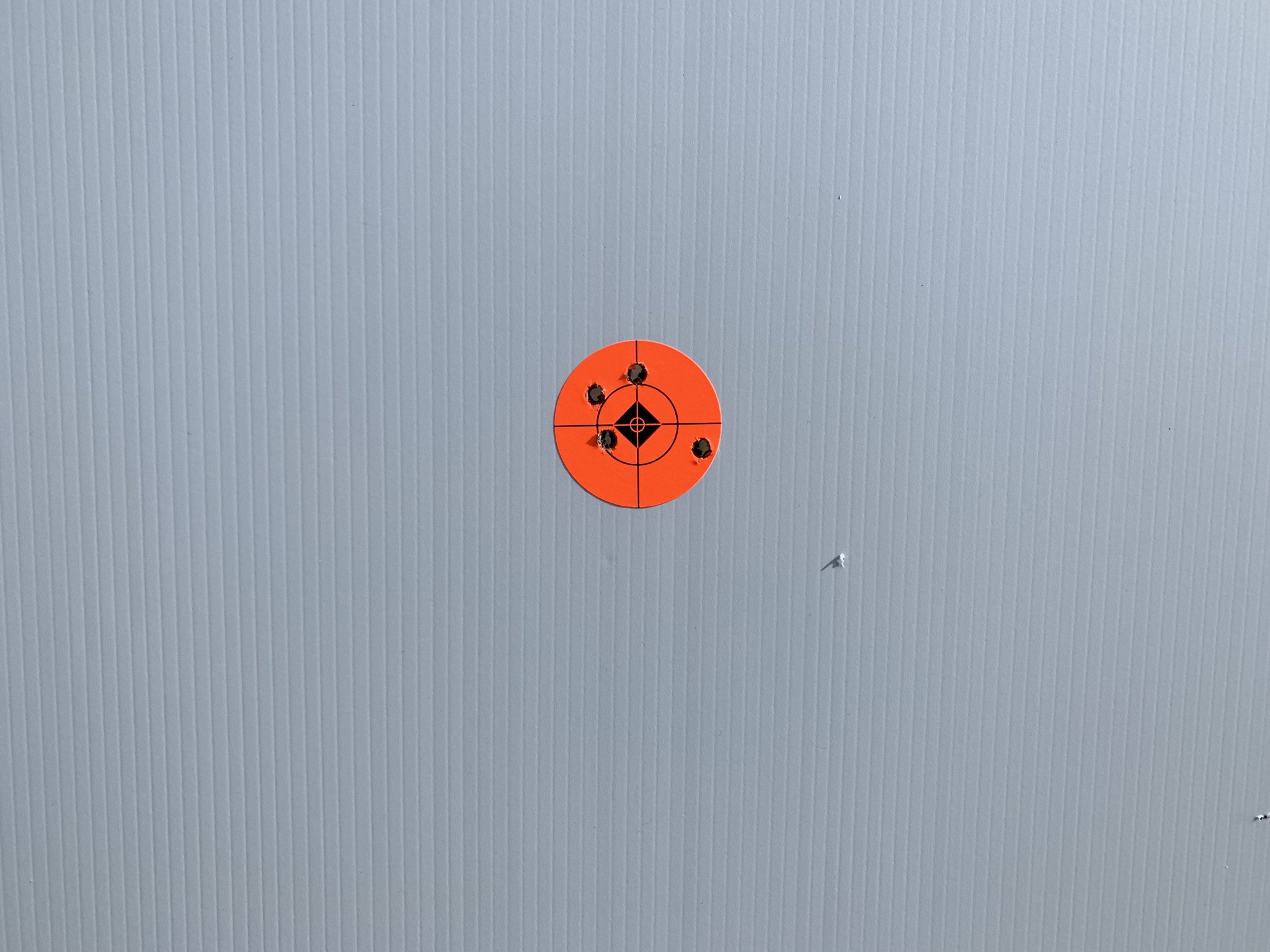

Working up loads for my Havak Bravo. Looks like the sweet spot is right around 41.6gr of 4350 with a 140gr ELDM and Lapua brass.
This is at 300y. The orange dot is 2”. It is only 4 rounds because I used the 5th to include in my ladder.
Very very happy with the accuracy and precision of this rifle.

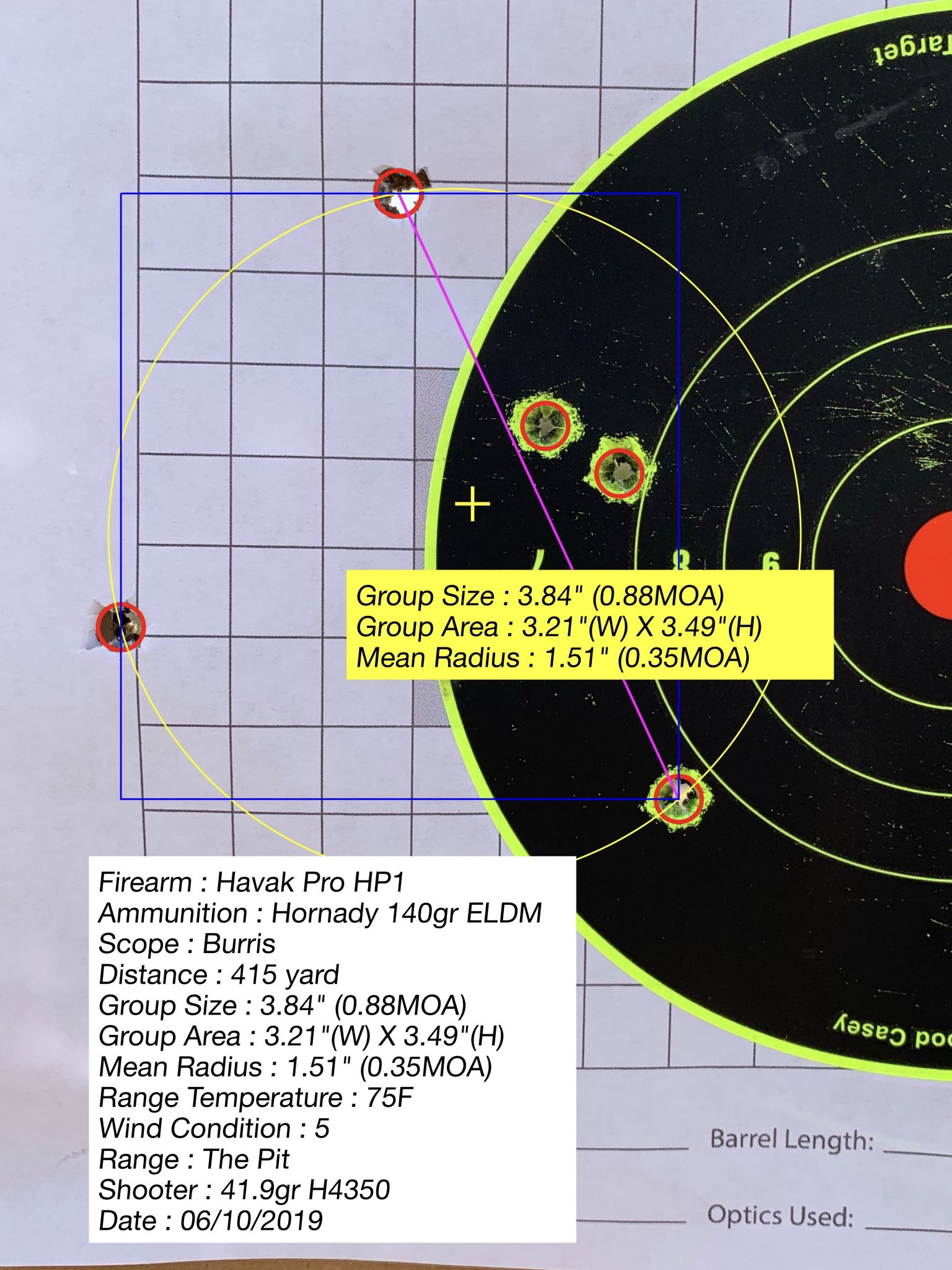

A 5 round 415y group and two 3 round 100y groups.
I’m going to start doing longer range groups. I know I can get it smaller than that.

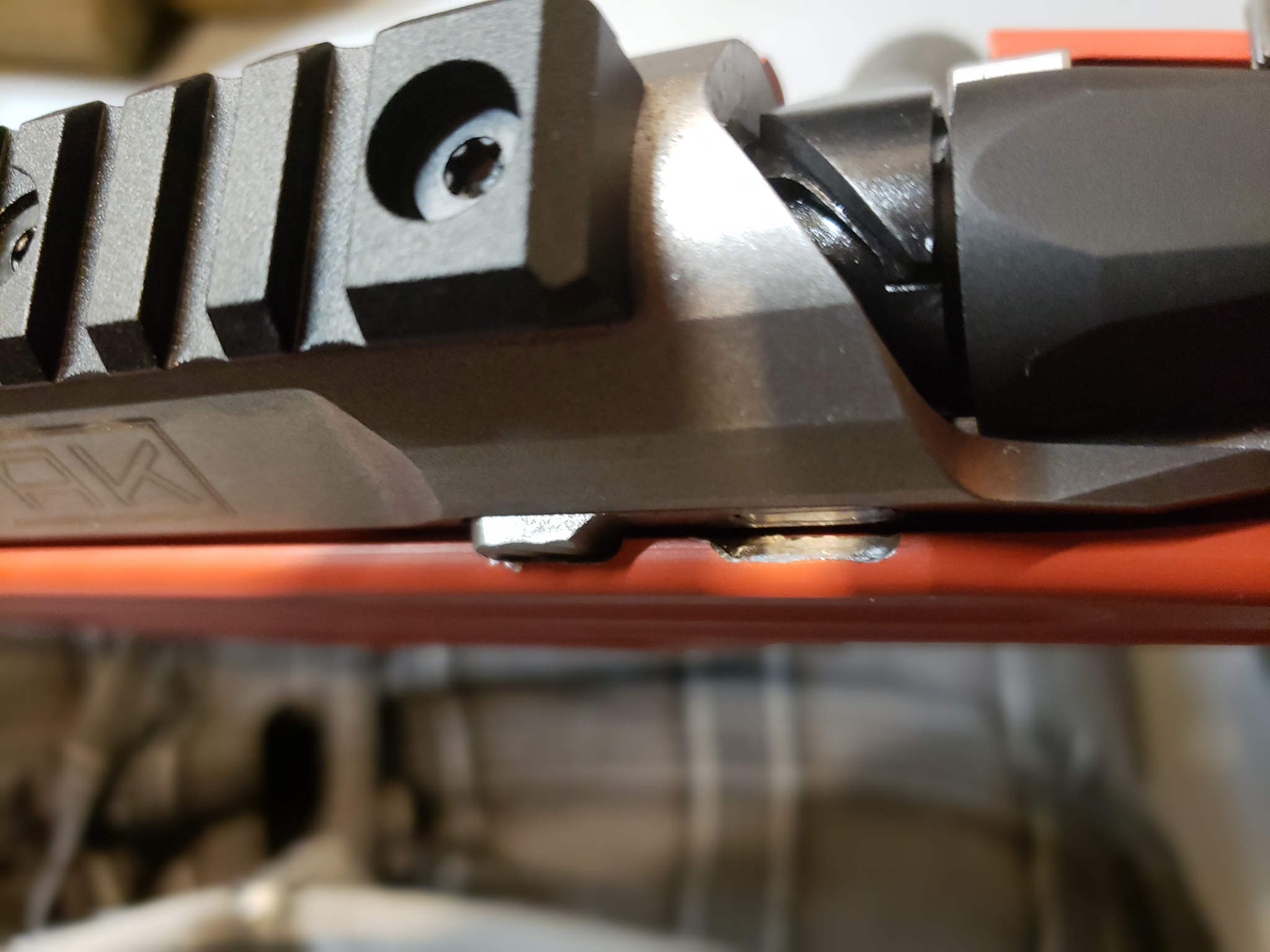

Looking at the action on the havak is the bolt release high enough to clear a standard stock without having to inlet the stock? It looks like it is slightly higher but I havent been able to verify. I am interested in picking up a havak action to run in a McMillan I have already.
I know this is an old question, but it went unanswered, so I'll answer it for the sake of posterity and knowledge sharing.
On an MPA Chassis, I needed to do some dremel work to have the bolt release clear the action channel (see below). However, I can also confirm that the Havak action fits perfectly out of the box on a KRG Whiskey 3 (6th Gen). No fitting was required either to the recoil lug pocket or the action channel. I did need to wiggle it in a bit, but everything worked without needing files or a dremel.
So, to answer your question, long story short, it depends.

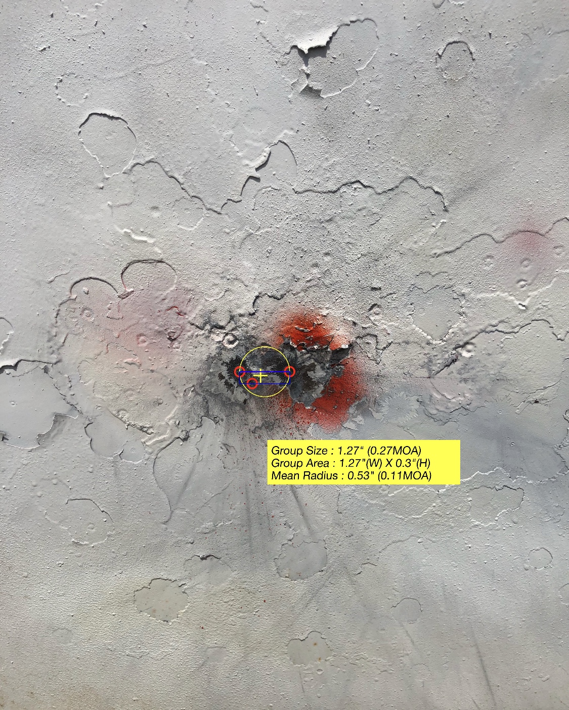

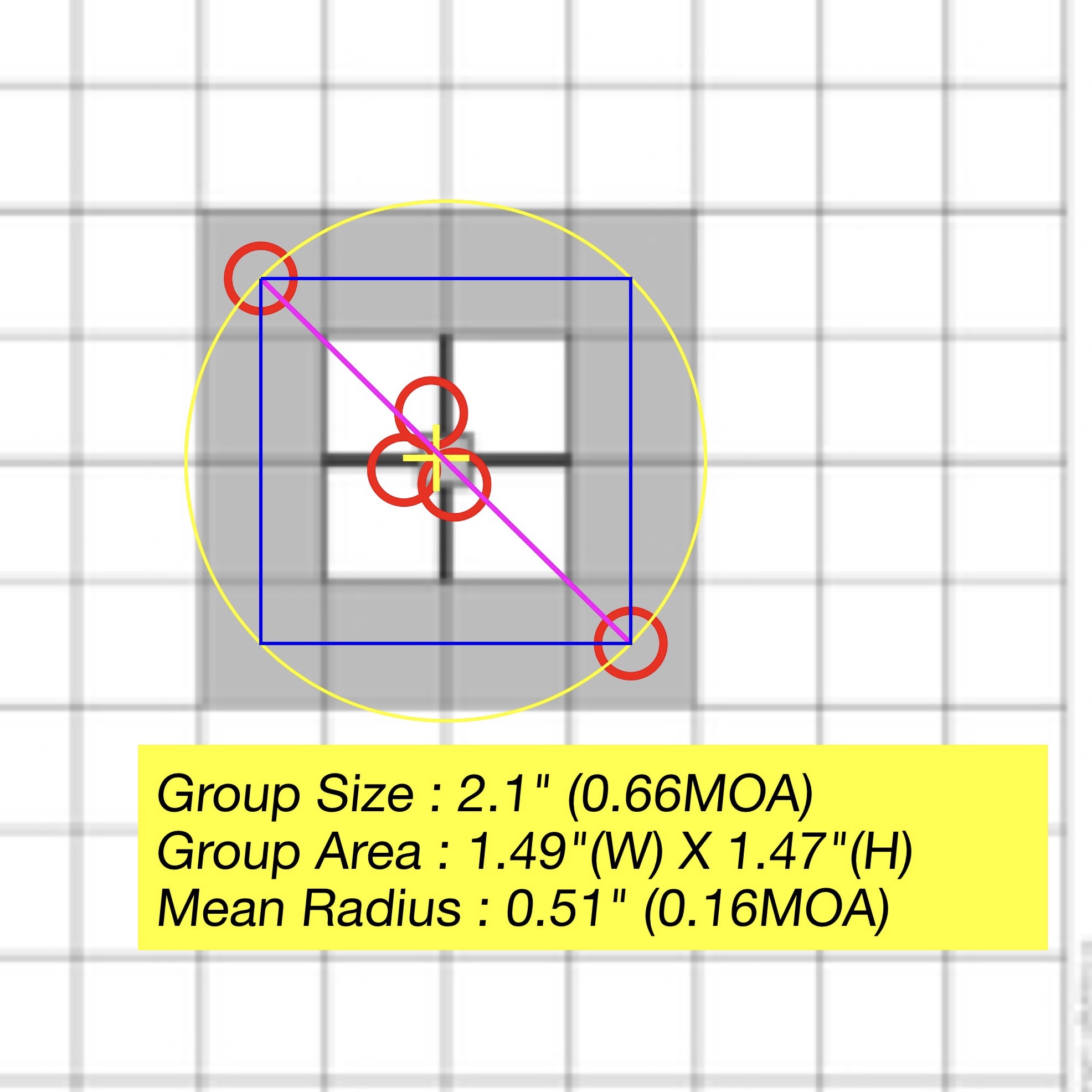

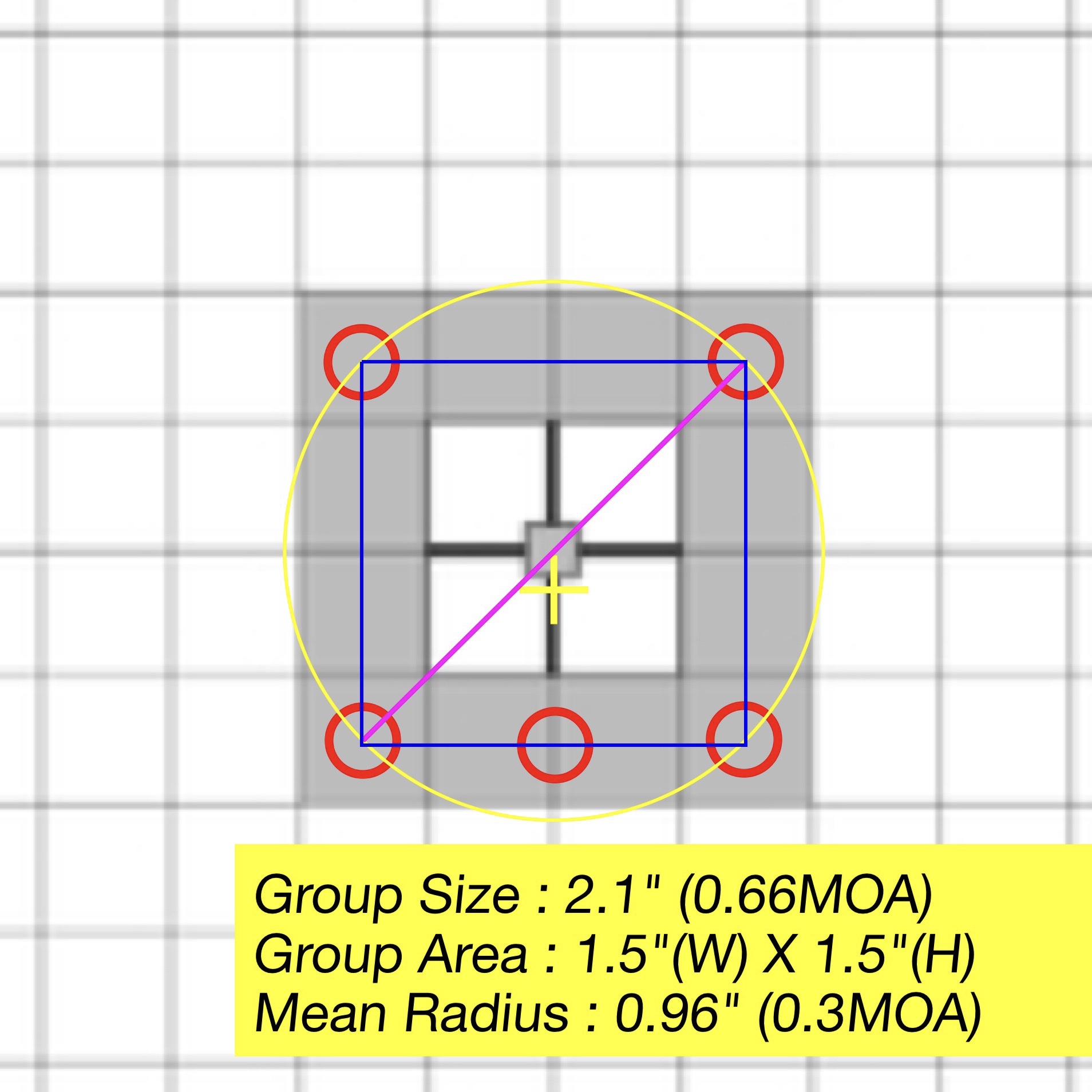

@Wormydog1724 : Looking over most of your shot group pics I have a question. Most of the groups list a "Mean Radius" and "Group Size". Can you explain the difference in the two factors? As above if it's showing a 300+shot group that is still sub-MOA that's some great shooting. Thanks.
If you were to draw radial lines from the center of the group, add them together, and then divide by the number of rounds that gives you the mean radius. It could also be called the average distance from center.
Generally group size is the farthest center to center spread for the group, this seems to be the industry standard for measuring “MOA” or “group size” for a given rifle and shooter.
Hope that helps - ATTACK
So as pictured above the yellow circle is the "group size" correct?
Correct. Big yellow circle is the group size, blue rectangle is group area, mean radius is how far the average shot is from the center of the group.
Getting them all small is the goal but the mean radius is also useful to see if the group averages smaller than the group size actually is. For example, You can have a 2” group size with a 1” mean radius meaning all shots are within 2” of each other and all shots are 1” from the center. You can also have a 2” group size with a .5” mean radius, which could be caused by a “flyer”, or two, but most shots fall within .5” of center, which is better. Example pictures attached to this post. Both are 2” groups but one has a smaller mean radius.
