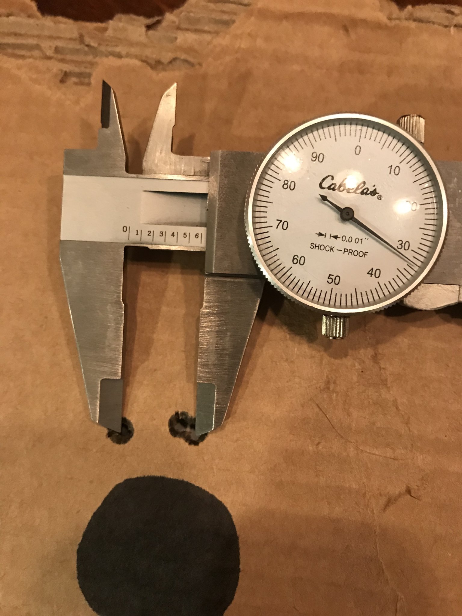

If you were to draw radial lines from the center of the group, add them together, and then divide by the number of rounds that gives you the mean radius. It could also be called the average distance from center.
Generally group size is the farthest center to center spread for the group, this seems to be the industry standard for measuring “MOA” or “group size” for a given rifle and shooter.
Hope that helps - ATTACK
So as pictured above the yellow circle is the "group size" correct?
Correct. Big yellow circle is the group size, blue rectangle is group area, mean radius is how far the average shot is from the center of the group.
Getting them all small is the goal but the mean radius is also useful to see if the group averages smaller than the group size actually is. For example, You can have a 2” group size with a 1” mean radius meaning all shots are within 2” of each other and all shots are 1” from the center. You can also have a 2” group size with a .5” mean radius, which could be caused by a “flyer”, or two, but most shots fall within .5” of center, which is better. Example pictures attached to this post. Both are 2” groups but one has a smaller mean radius.

Yes. At 303y my 5-shot group was 2.34”, which is .74moa, that’s sub-1moa.
A true sub-moa rifle should be sub-moa, regardless of the distance to the target.

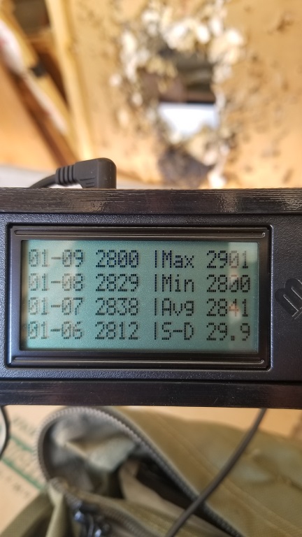

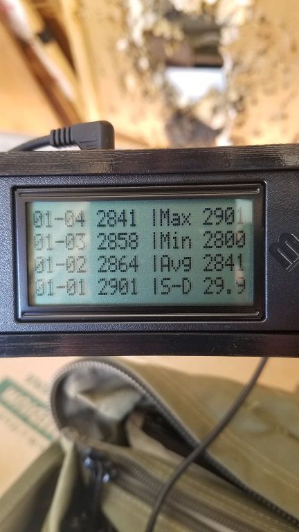

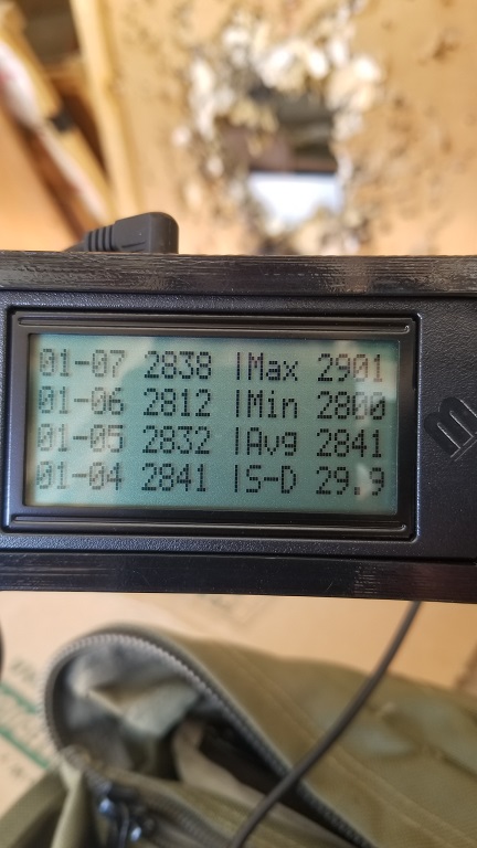

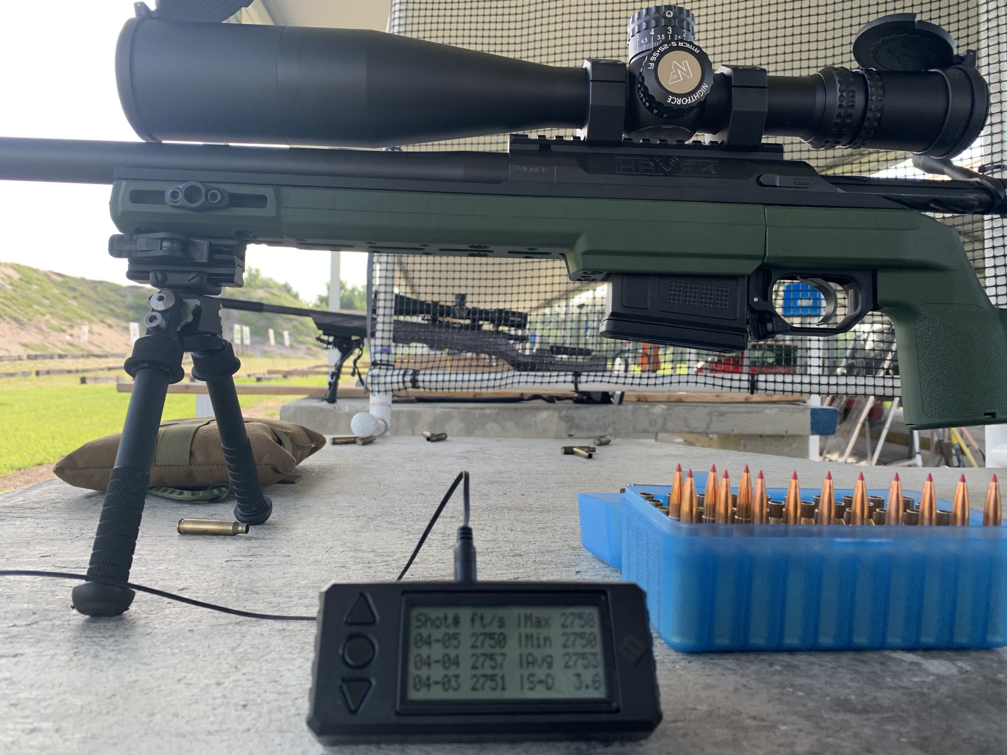

I took my Havak out yesterday for the second time and I don't know what's going on with it. First time I took it out I put 40rds through it but didn't bring the chrono. This time I brought the chrono and WTF. 49 rounds total through it now.
6.5PRC in a Bravo shooting Hornady 147gr ELD-M using Magnetospeed V3 in a Wiser Precision setup. 75 degrees, 3 rounds per group, 3 groups, 10 min or so between strings to let the barrel cool. Every successive round fired was slower than the last. Started at 2900 fps for shot 1 and ended at 2800 fps for shot 9. I checked the Magnetospeed after every string to make sure it was still ok and not lose or something. Groups had vertical stringing inline with the chrono results and over an inch. I shot the Havak right after my AI where I got all rounds inside each other.
I don't know what the hell is going on.
7102223
7102224
7102225
That is odd. Someone im this thread had a loose barrel...i doubt thats the issue but would check just in case. Do you have a brake or suppressor on your Havak Bravo?
It's got a Heathen brake and It is tight on there. I was checking everything wondering what was going on.
@EmanP Did you do a quick clean prior to shooting? I would check the chamber, bore and brake. see if there's any obstructions. Possibly try a diff lot of ammo.
I have 2 separate lots of factory 147gr, and after my barrel sped up, the slow lot avged ~2900fps, and the faster lot avg ~2947fps. Slow lot started out @ ~2828fps. I've got about 300rnds through mine, mostly reloads.
Reactions: TheMammoth
I don’t really care about SDs for round counts under 30, but I was impressed. This gun is a laser beam.

I find RL23 is the most consistent, but velocity is low. Been getting pressure signs (Ejector marks). I may try to trim the neck down more and see if this is the cause of my issue. currently have it @ 2.020-2.023". Spec is 2.015"-2.030".
Kinda disappointed in accuracy but could be just me.
