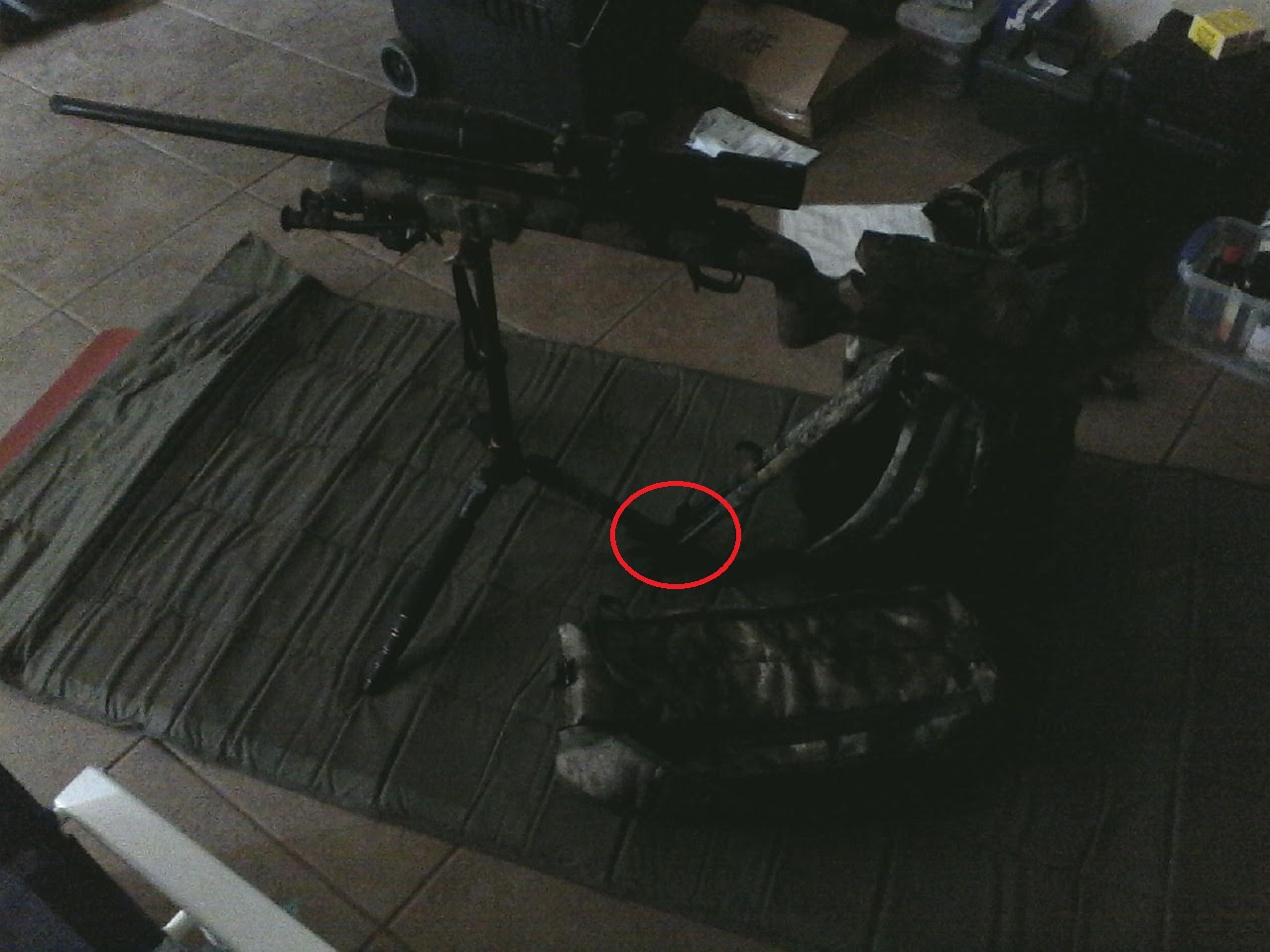

Any ideas for improvements? I am ringing steel with this at 1000 yards. Note the mini clamp in red circle. I clamp the 2 bipod legs around the back leg of the tripod. I use the ruck sack to further support my right arm. There is some horizontal wobble in the wind.
Note the load is 185OTM, COAL 2.815, Peterson Cartridge small primer brass, CCI BR4, 43.8gn Verget, muzzle velocity 2710fps. The scope is the Gen II PST 3-15 ffp with EBR2c reticle. I can shoot from 8yards at 3x to 1100 yards at 15x without prescription glasses with this scope. The set up is less than 1 minute from the 'tank' ruck in foreground.
