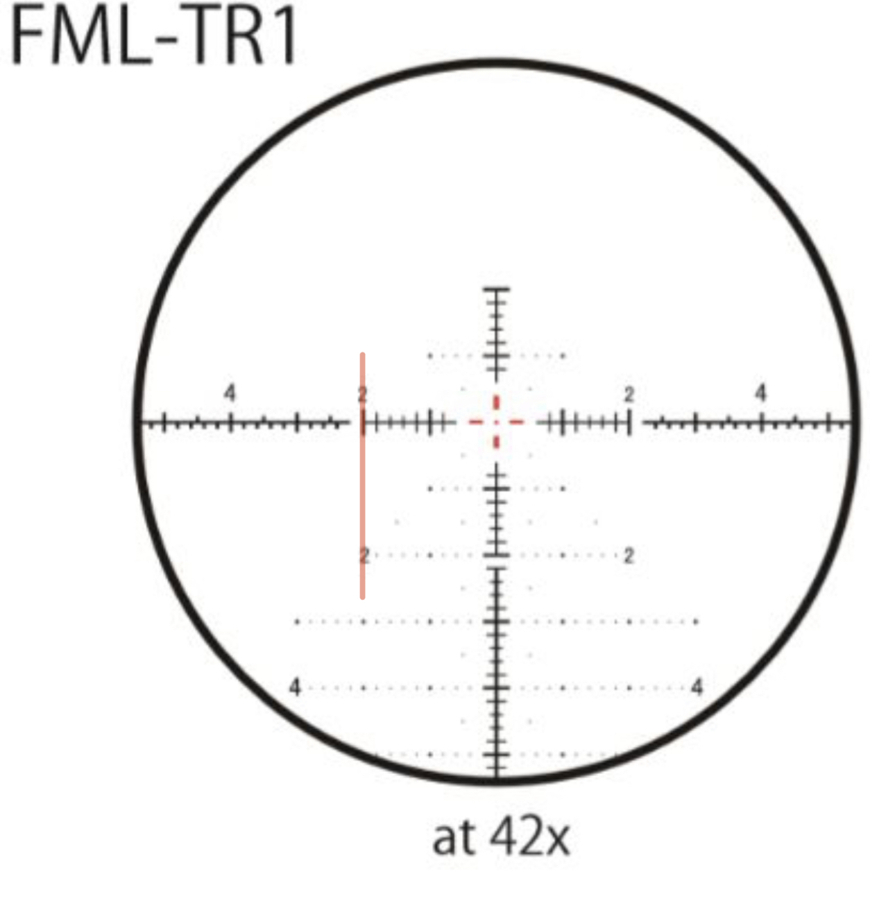

I hadn't seen this table before, so thanks for posting it! There is very little difference though, as you were pointing out. Also, the reticle selection makes me sad.
I'm OK with the reticle choices. I was not liking the chevron's because I'm effin retarded, and am happy the nova is coming, but I may still go back to a chev reticle to get FFP if I feel I may need that.
Reactions: Jazz30-06
I just want something with a little more info in it than drops. Simple trees seem ideal to me on glass that isn't ideal for adjusting turrets. I know a lot of other people like their bog standard mil dots though, so I'm sure it works great for them.

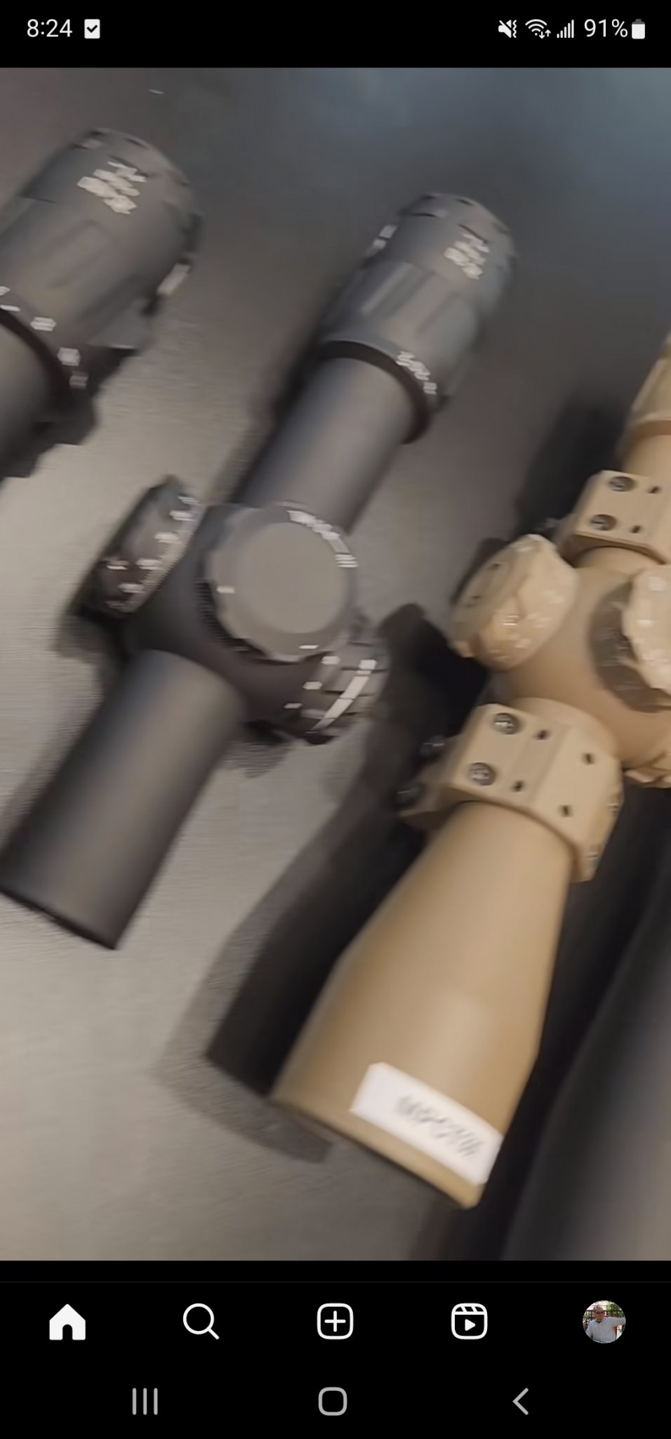

I really like this concept that March revealed this week as well. To me after seeing a scope design like this makes me wonder why has anyone done this before. I really like it, seems like one of those inventions that are an absolute no brainer.
I totally like the concept but my concern is the weight of the mounting system. I mention this because my Genesis 4-40 has a similar mounting system and its very heavy.
So compact lighter weight scope plus heavy mounting system = nope not what I envision.
This is going to sell a lot of scopes for March.
You don't have to shop for 2 separate things, a scope and a set of rings when you buy a scope. It's lined up right by U taking it out of the box and putting it on your rifle (unless there's something wrong w/your rifle).
No scuffs/scratches from the rings to knock the price of your scope down if you ever decide to sell it.
If you're a "fumble fingers"/accident prone "Klutz" who doesn't pay attention to detail, you can still get your scope on right.
Whatever the minuses are this is too convenient to go away.
I've seen the Zeiss and Leica rails but think this design is better, really curious to learn more.
I have a Swarovski z6 with the SR rail. It works well and is rock solid. The biggest plus is that you have far more flexibility in placement for eyerelief since you can slide back and forth quite a bit without the need for cantilever.
I would prefer this or a zeiss rail for all my hunting scopes. For my PRS rifles I can see the March solution being quite nice as long as I can still place a sendit behind it on the picatinny rail and as long as I have sufficient flexibility in height options

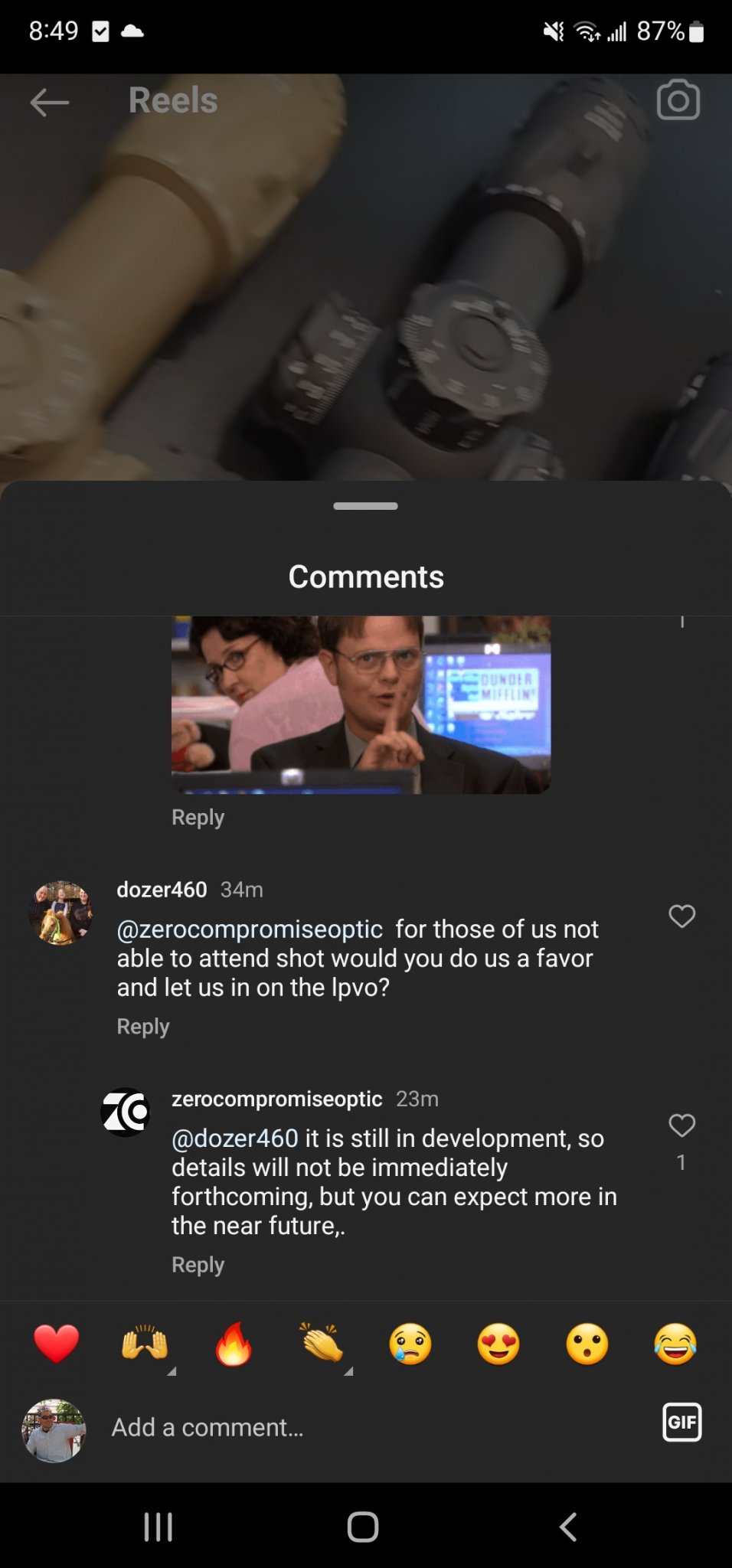

The one I'm thinking of is Antimatter Industries sliding power adjuster.
Found it and Flux Industries has their sister company Antimatter industries is making them with a motor now and a small cable that goes to the control switch so you can mount the switch where your support hand goes.
If the slide was ~$500, I wonder what one with a motor will be and how reliable.
From a hunting perspective, especially long range, it might be handy to zoom in without disturbing the sight picture.
Probably the juice isn’t worth the squeeze and more complication than worth but good to see innovation this year.

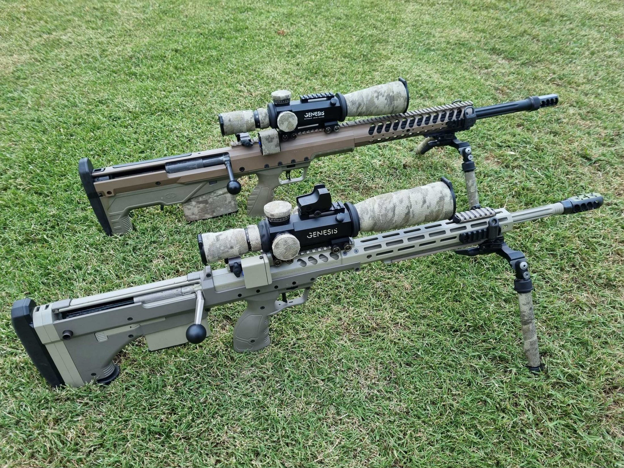

Wait are you saying the Genesis scope is light? I dunno to me if I were going to buy a Genesis with 400 moa of elevation travel I wouldn’t give a single shit nugget about the weight. lol but that’s just me
You serious ???? i had 4 Genesis scopes.. 4-40 and 6-60... the integral mounting systems is no heavier than any decent conventional one piece ring/mount setup.

I had 4 Genesis scopes..2 x 4-40 and 2 x 6-60. These had superb glass!! absolutely stunning...BUT !!!! I also hade huge issues with them when mounted on a Desert Tech 50BMG.
After each firing the scopes would go completely out of focus. Also they would NOT hold Zero...
It was such a pity as i really liked them, ................clarity, reticule....
