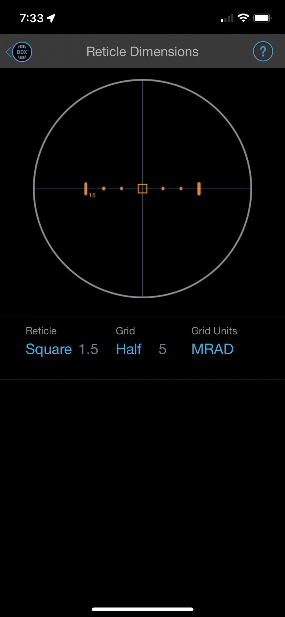

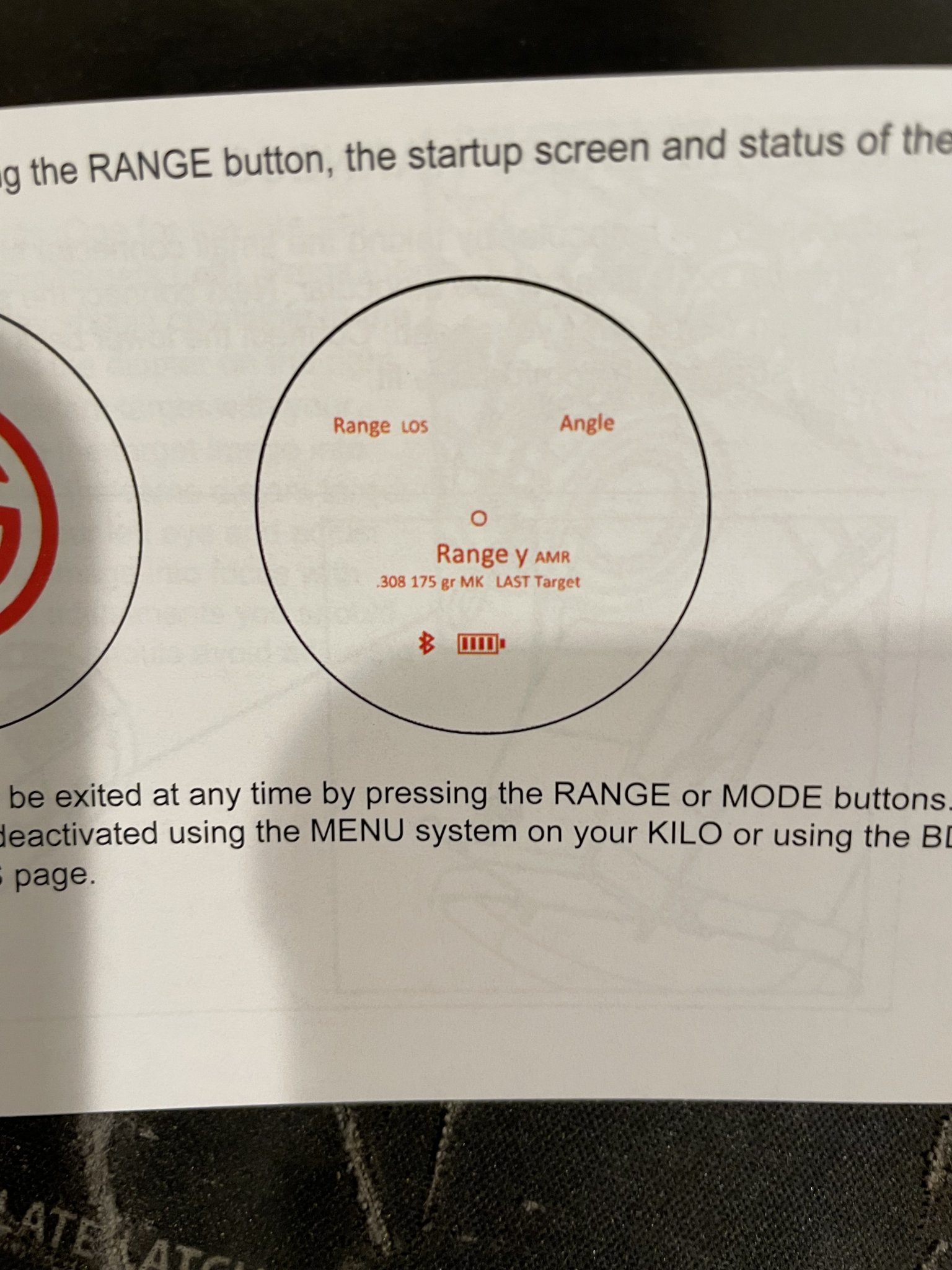

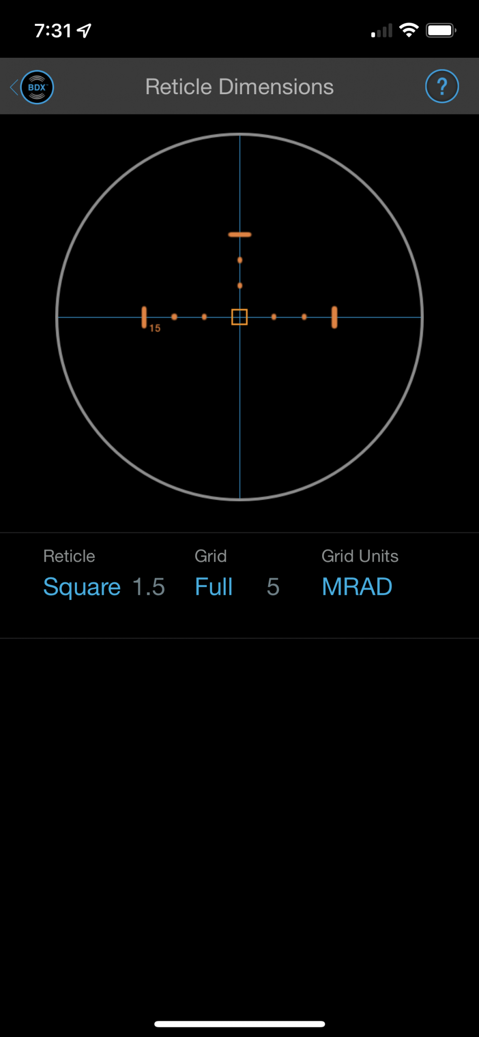

The 8 would be great if it matched the sub-tensions of the reticle or the known 1.5 mil reticle square which it doesn’t. Pics attached show it should be 15 mils which match 5 mil hash marks.
AB external was used and made no difference with kestrel or any other connection. Tried all settings lol
Yup I know what AMR means. It’s just in the wrong portion of the display. View attachment 7850149View attachment 7850150View attachment 7850151

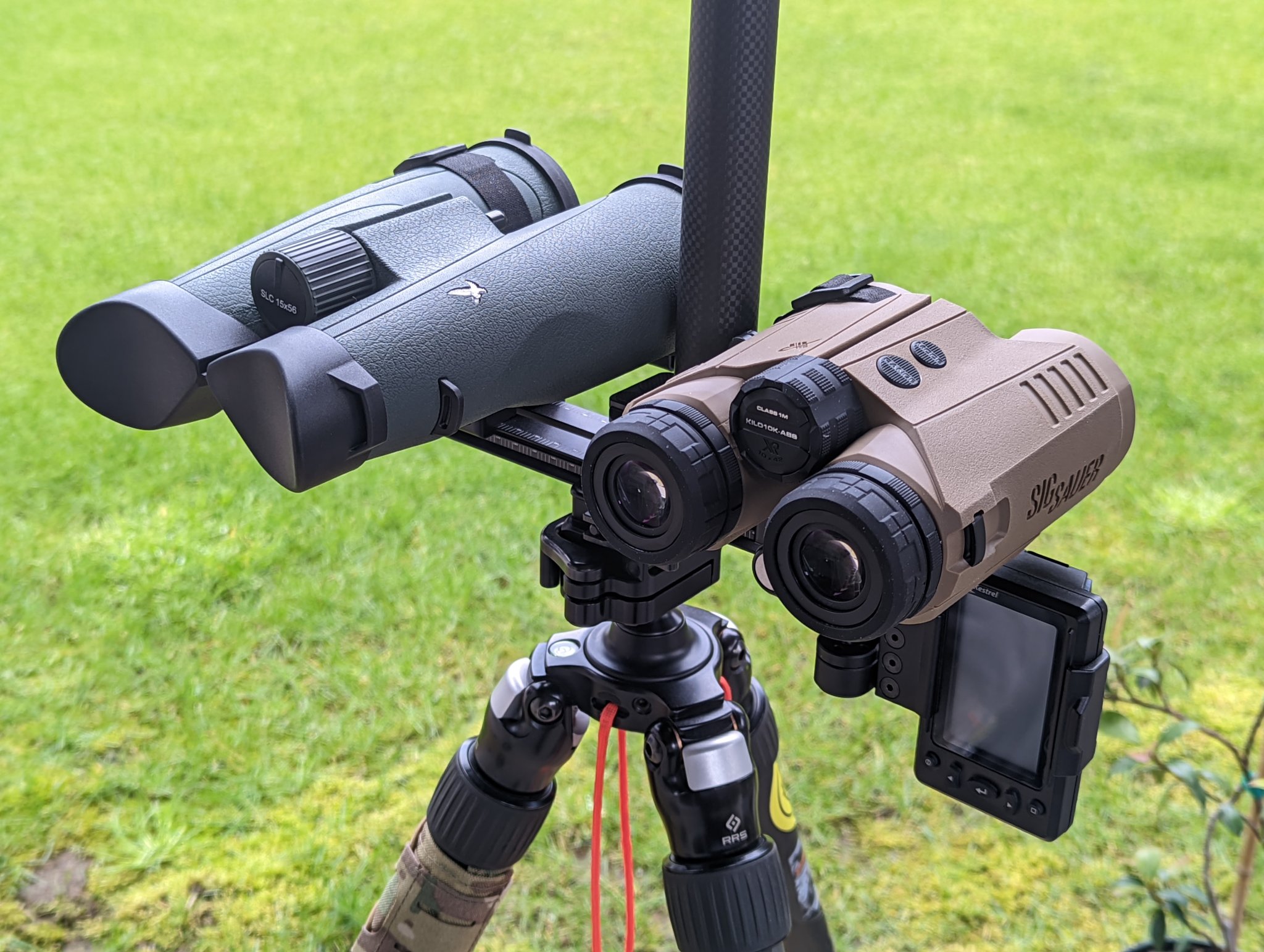

Diopter focus is strange. I have more-than perfect corrected vision (my eye doc is a specialist in shooting sports and used to help team USA air rifle team)... The right and left diopter, if not corrected exactly perfect, will leave a little blurriness in the AMOLED display or the target and vice versa. While my diopter is not maxed out like those described above, it can become close. I have reached a middle ground, however.
Using these side by side with Swaros is entirely unfair. The image quality is trash compared to it BUT it's certainly not TERRIBLE. 😂

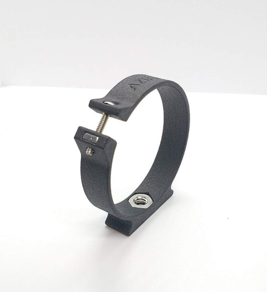

Was mildly disappointed they didn't tweak the design to be able to incorporate any kind of flip up lens caps on the front or the eyes. Soft rubber is all well and good, but I just prefer something that clicks closed.
I think with some experimentation, and perhaps modification....something can be made to fit well. Might try tweaking a pair of buttler creeks for the front and see how it goes.
Anyone got a solution for lens protection on these? Something more than just rubber
Has anyone checked with MKM to see if any of their flip caps would fit? Don't they make some that flip/click open and closed. I think they have some that secure with a little screw too, so a perfect size wouldn't exactly be required.
Maybe they're too long for the barrels though.
@Tyler Kemp
Get me dimensions and I can let you know what caps are needed. [email protected] can assist! We can also make custom if needbe.

Can you make some that are soft open/close? In other words - no noise. I had to stop using flip caps on my rifles because they would scare game.
All I will say at this point is...........I've got something in progress that I'm confident will be considered the nicest caps available ;)
