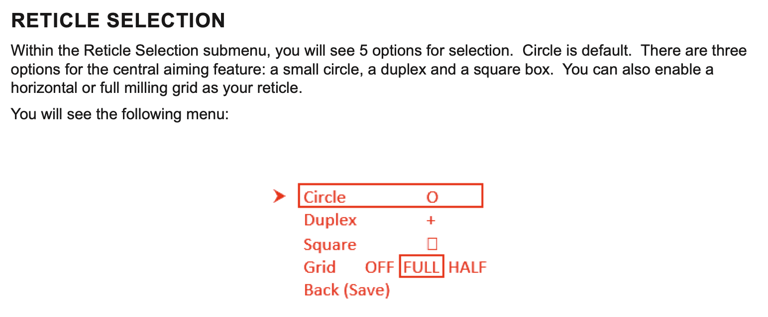

Sig and euro both have a image showing the display on the product page. It’s nothing fancy
I don't have an 8k to check (those that do can confirm) but there's various reticle options; is that actually the FULL Grid option on the Sig site?
