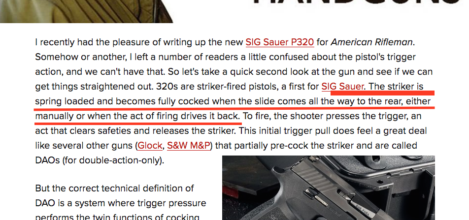

Picture 3 says the sig 320 IS FULLY COCKED when the slide comes to the rear.
I am completely correct. All the strikers are fully cocked when the slide comes to the rear, it is when it cycles forward into battery the sear engages the arm on the striker assembly that removes it being fully cocked, It is then the trigger pull that restores it to 100% cocked and lets the sear slip off the striker arm.
You didn't read the part after the "OR".
No, you really are not correct at all. For one thing, your statement above is backwards. The strikers are not fully cocked when the slide is rearward and open, they are fully forward in the slide and the opposite of cocked. The striker catching the sear or trigger bar during forward slide movement is what cocks the strikers, either fully or partially.

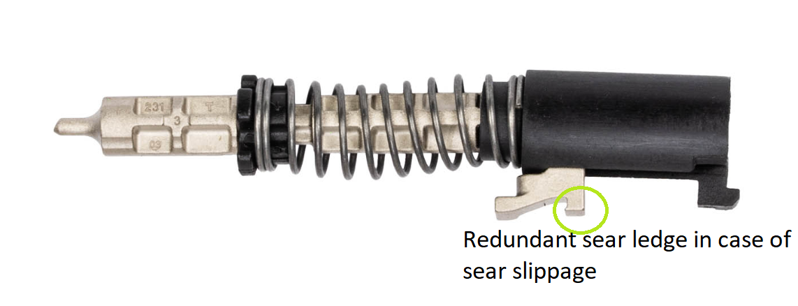

It's more like M&P. The P365 design has a striker safety that is the functional equivalent to an M&P striker safety plunger (dome style) that is not a part of the striker assembly. If you lock your slide to the rear, you can see the safety (black in color) blocking the striker (silver in color) underneath the slide towards the rear.
Pulling the trigger moves the trigger bar which toggles the safety lever which pushes the striker safety out of the way as well as allowing the trigger bar to drop the sear, allowing the striker to release.
There is no redundant ledge on the P365 sear in case of sear slippage or safety failure. The redundant ledge is on the striker.
There is no lever or cocking mechanism designed on the trigger bar or other related parts that drives the striker farther backwards to to position the striker's primary sear ledge behind the sear.

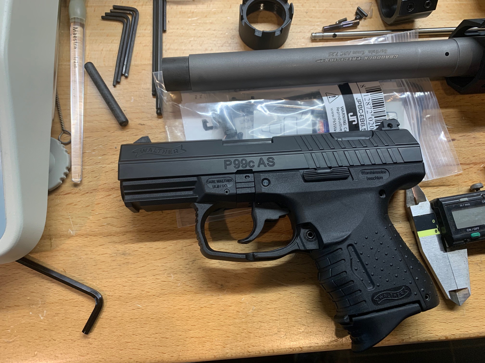

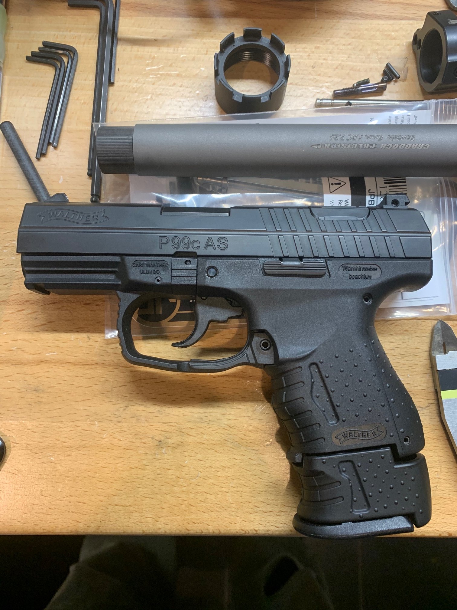

For carry I currently have a Walther P99c AS. No safety, however it has a true de-cocker. First shot is true DA with a long albeit smooth pull & from then it's a true SA with short reset. Trigger is very good IMO & so are ergo's. Of coarse they quit making the P99 likely do to cost & profit margins.

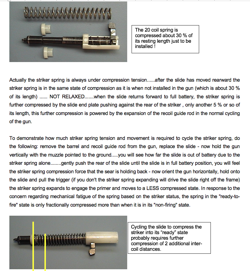

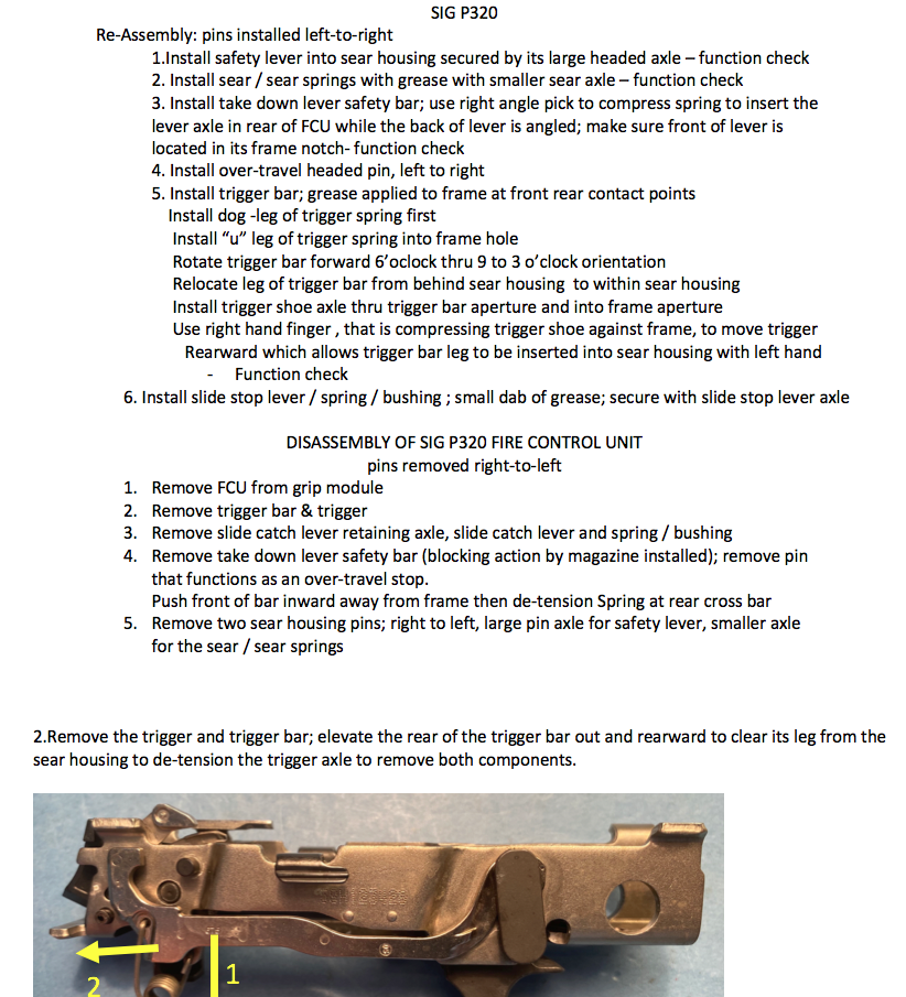

I have virtually every modern striker fired pistol, 8 M&P 9's (1.0 and 2.0's), 10 Glocks (G17,23,19's ,43's), Sig P320 / 365, HKP7M13 and on and on. Hundreds of thousands of rounds down range collectively. I have completely disassembled / re-assembled all of them a gazillion times. My M&P technical manual has been an expert reference for 10 years. Your experience may be different.
I read a lot of mud slinging regarding how striker fired pistols are not DAO. When comparing them to amount of hammer travel occurs with DAO revolvers or even DAO pistol e.g. Sig P250 / P290 RS the amount of striker spring movement is miniscule, however the striker pistols still are technically DAO's. Some still want to squabble with the DAO designation despite the factory designating them so.
You can demonstrate the required amount of striker spring compression in all these platforms by the simple test described below.

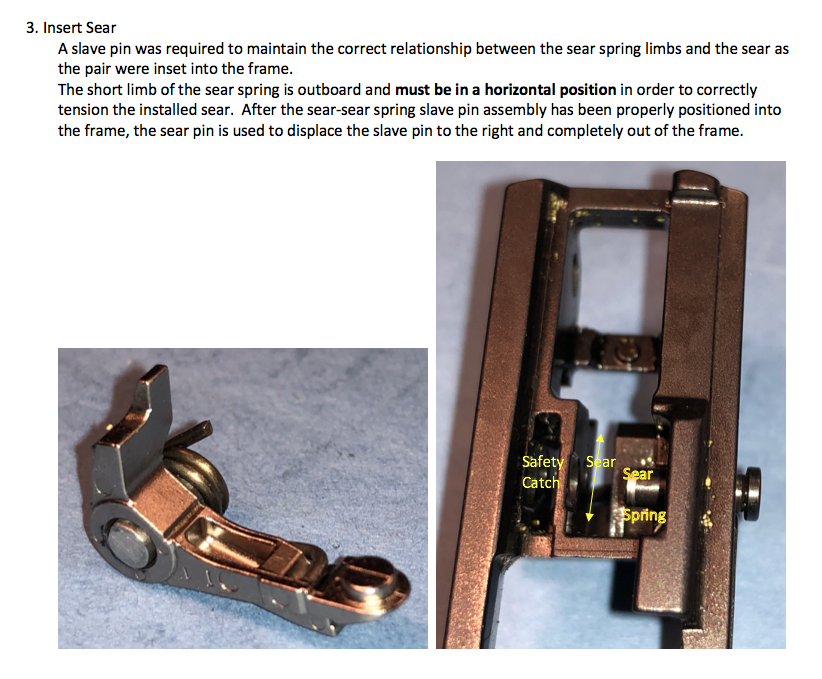

A few out takes from authored Manuals on the P320 and P365. I am pretty sure I have disassembled them and have a comprehensive understanding as to their mechanical function.

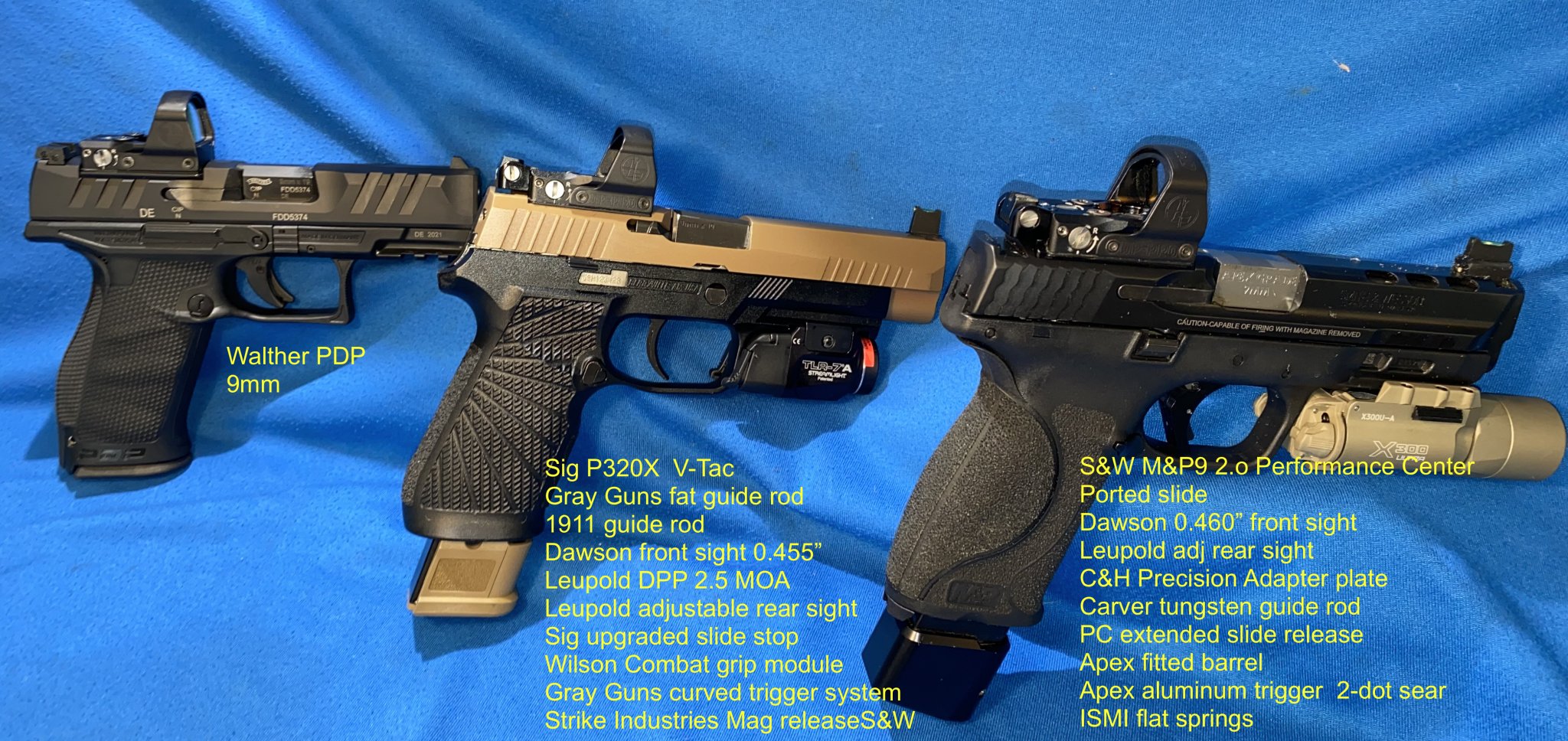

IMG_8638Walther PDP Sig P320 M&P9 2.0 PC with Leupold Delta Point Pro 2.5 MOA and Holsters 03....jpg

Walther in Baltimore config. She's tall with the extended mag though 5.25"
I actually wouldn't want a safety on the P99. It's a striker fired DA/SA carried de-cocked. Button on the top of slide is the de-cocker. I don't know of any other DA/SA striker pistols.

The point I was trying to make is: while pretty much all of the polymer/striker guns are "technically" considered DAO guns (or passed some sort of required test to earn that delineation), there is a difference between what most would consider a "true DAO", where, at rest, the striker isn't supposed to have enough energy stored in it to light off a round (usually accomplished by only partially compressing the striker-spring), and a whole vast subset of "DAO in name only" guns (most of them newer to the party), that when at rest, have enough stored energy in their strikers for something no bueno to happen if the striker were to somehow get loose... ...which is something that seems to keep happening now and again with Sig P320's.
Obviously, it's a rare occurrence, the Sigs are popular in the gun games and there are lots of them out there with Mil/LE peeps, but alas... seems like something's fucked up, and you can bet your ass Sig isn't going to admit it if they can help it.
And yet you obviously haven't taken the time to understand how they actually work. If you think the P320 cocks the striker to the rear in any significant amount as the trigger is pulled, you're wrong, full stop. If it doesn't cock the striker to the rear with trigger pull, then it's a single action. Hell just look in the back of the slide with a bright light while you dry fire the gun - you can see what it does and doesn't do.
Even the article you quoted about it says the trigger "feels like other DAO pistols" and then explains in the next sentence that it is not a DAO system. It's poorly worded, but you didn't even seem to read what you quoted. Worse, you haven't taken the time to consider what a double action vs single action even means; your very first quote was that all of these pistols hold the striker nearly fully cocked (wrong, not all of them) and that they're all DAO as a result. That's not what DAO means.

Once you disregard the BS the companies and magazines sell, the P320’s, Walther’s, VP9’s, and M&P’s (I know I’m forgetting some others) are all single-action guns. It actually was an argument years ago whether any of those platforms should be legal for IDPA SSP or USPSA Production since they’re basically “factory cheaters” out of the box, competing against DAO’s like Glock’s and such instead of 2011’s like they should be.
This is a pretty important point to understand, and worth re-reading.

I can't speak to the SIG and S&W, but Glocks are not "95-98%" cocked when in battery with the trigger released. Judging by trigger pull, I'd also say the same about the FN 509. That's part of the overall Glock safety concept and has been since the very beginning - even if the striker somehow slips off off the cruciform and the firing pin safety is defective, the gun still can't go off without a full press of the trigger because there isn't enough energy stored in the firing pin spring at rest.

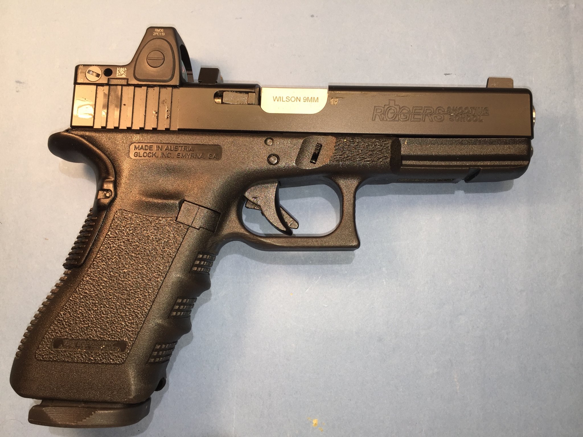

I just played around with making some crude measurements of rearward striker travel on a Gen5 Glock 19 using a digital caliper as a depth gauge, and it appears to have about 0.150" of rearward striker movement between full reset and trigger break. A stock FN 509T has about 0.120" of rearward striker movement. A 509C with the Apex Action Enhancement kit (trigger + sear) has only 0.090" of movement, which provides a strong hint as to how the trigger feel has been "enhanced".

If this were a stock p320. This would happen hundreds of times a day if not more. There’s more to the story,
Yeah you’re wrong. Happens over 100 times and Sig admitted the defect with the secondary seat disengaging without trigger pull and here’s one on video showing officer walking along and shot:
