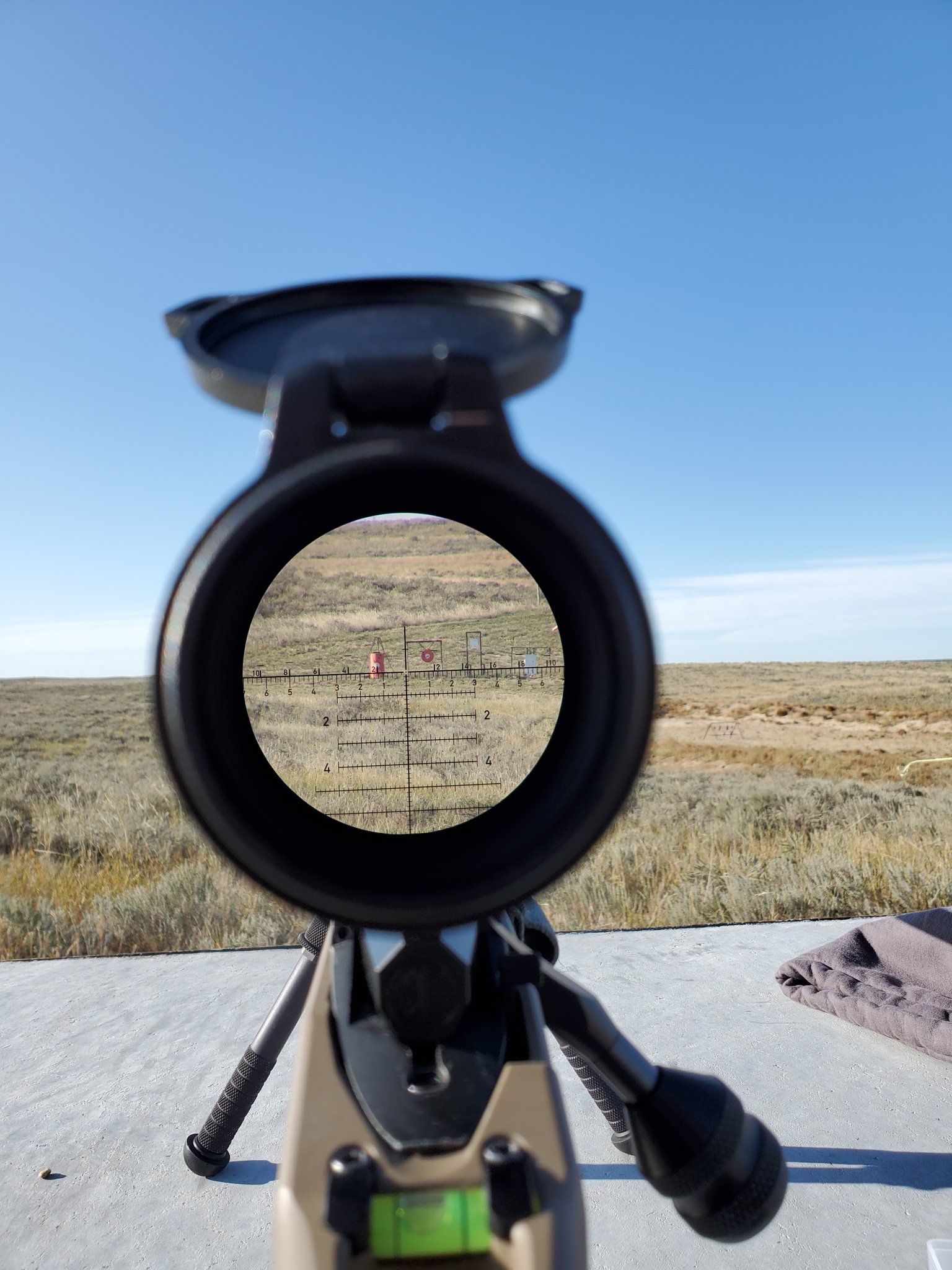

I've had my 5-25 for 9 months now. I can't live without the capped windage and locking turret. I see a bunch of vx-5's in line for my hunting rifles.
I love my 5-25! Amazing clarity and tracking has been spot on.
MPA chassis, Curtis action, Atlas bipod... that's exactly what I'm running! You have good taste! ?
Do you shoot PRS with that rig? I've done a few competitions with mine and I'm about to swap out my Sig TANGO6 for another optic. Seriously considering the Mark 5HD 5-25x56. It's made in the USA (I'm in Portland and Leupold is based out here, so I like the fact that I can support local business), they have a good reputation and have been in the scope business for decades.
The one thing holding me back is that no one else at the competitions I've been to are running Leupold. My shooting partner runs Vortex Razor HD GenII (I see a lot of those), another guy has Schmidt & Bender, and Nightforce, US Optics, and Kahles are also really popular. I want to support Leupold in PRS so they keep making scopes for us, but I also don't want to run the "wrong" scope if there's a reason why the PRS community isn't choosing it for their rigs.
If you have competed with that setup, is there anything about the Mark 5 that you felt was holding you back? Like the time to get on target, changing magnification, adjusting dopes between shots, etc.? Thanks!
I do actually shoot prs with this rig. So far the scope is amazing. Not a ton of people running them yet but i am seeing more and more people starting to use them. The clarity is phenomenal and so far the tracking is spot on. Ive taken it to 1100yds and back multiple times. I came from using a burris xtr ii and its a night and day difference. The amount of travel i still have is crazy. Like 28 mils of travel left after zeroing. I havent found anything i don't like about it just yet. But to be fair I havent taken it out a ron with it being the end of the season and me moving houses lol. I dont think you will be dissapointed at all if you got the mark 5
I agree with you on this. I dont think its any better or worse than any of the other scopes in its class. I think the cost is great for what you get along with the elevation. Some of the features like the locking zero are great if you like em or not so great if you dont like em. Its all preference and what you can afford these days
Thank you both for your input!
