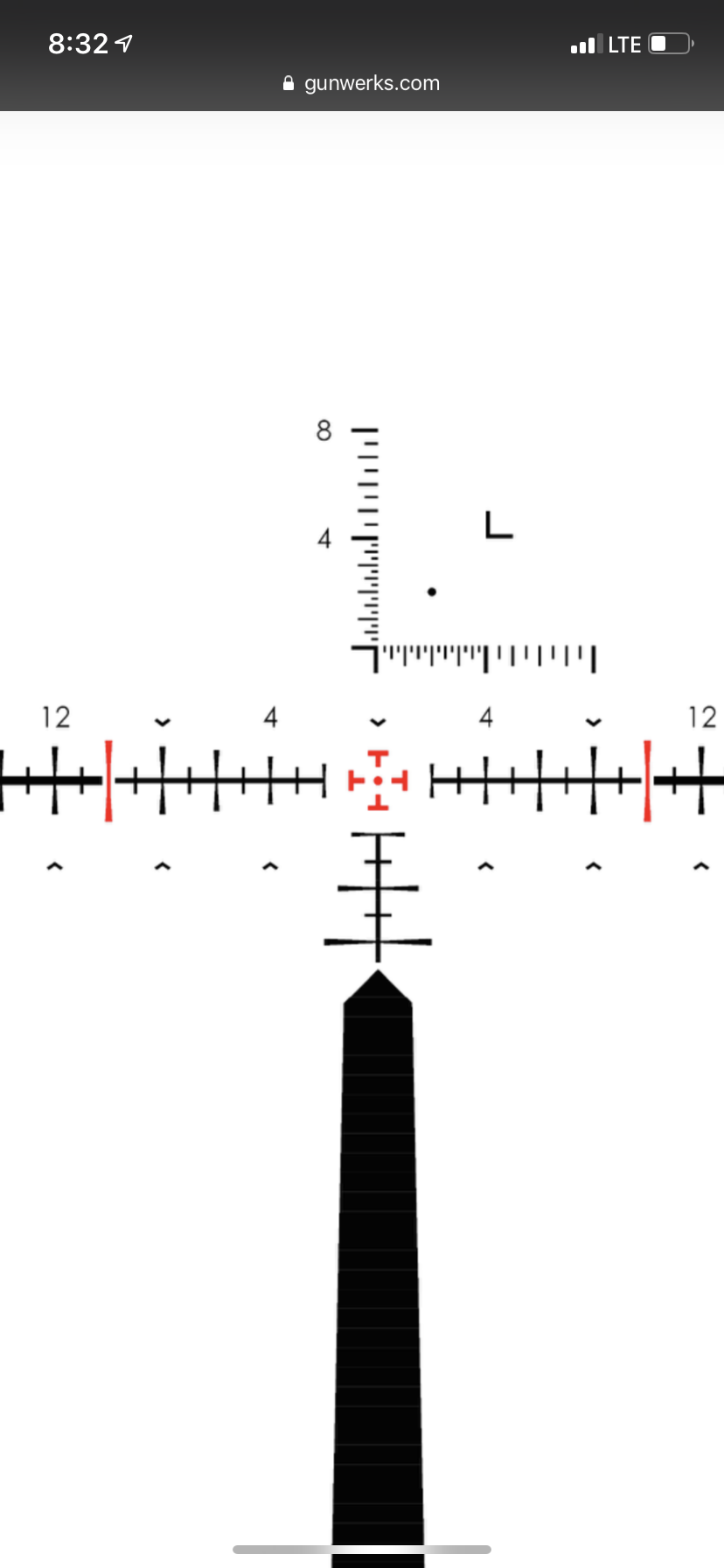

I’ve kinda been looking at the gun werks moa version for hunting. I like the looks of that reticle.
I have the illuminated PR1-MOA recticle in my Mark 5 HD 3.6-18 and I cannot recommend it enough. I do not like a busy reticle or Christmas tee types, so the PR1-MOA was an easy choice for me. It is thin enough for great accuracy at the range but also thick enough to be useful hunting on low power. Side note, the illumination on my Mark 5 is daylight bright, which I don't know if that was mentioned earlier by other users.

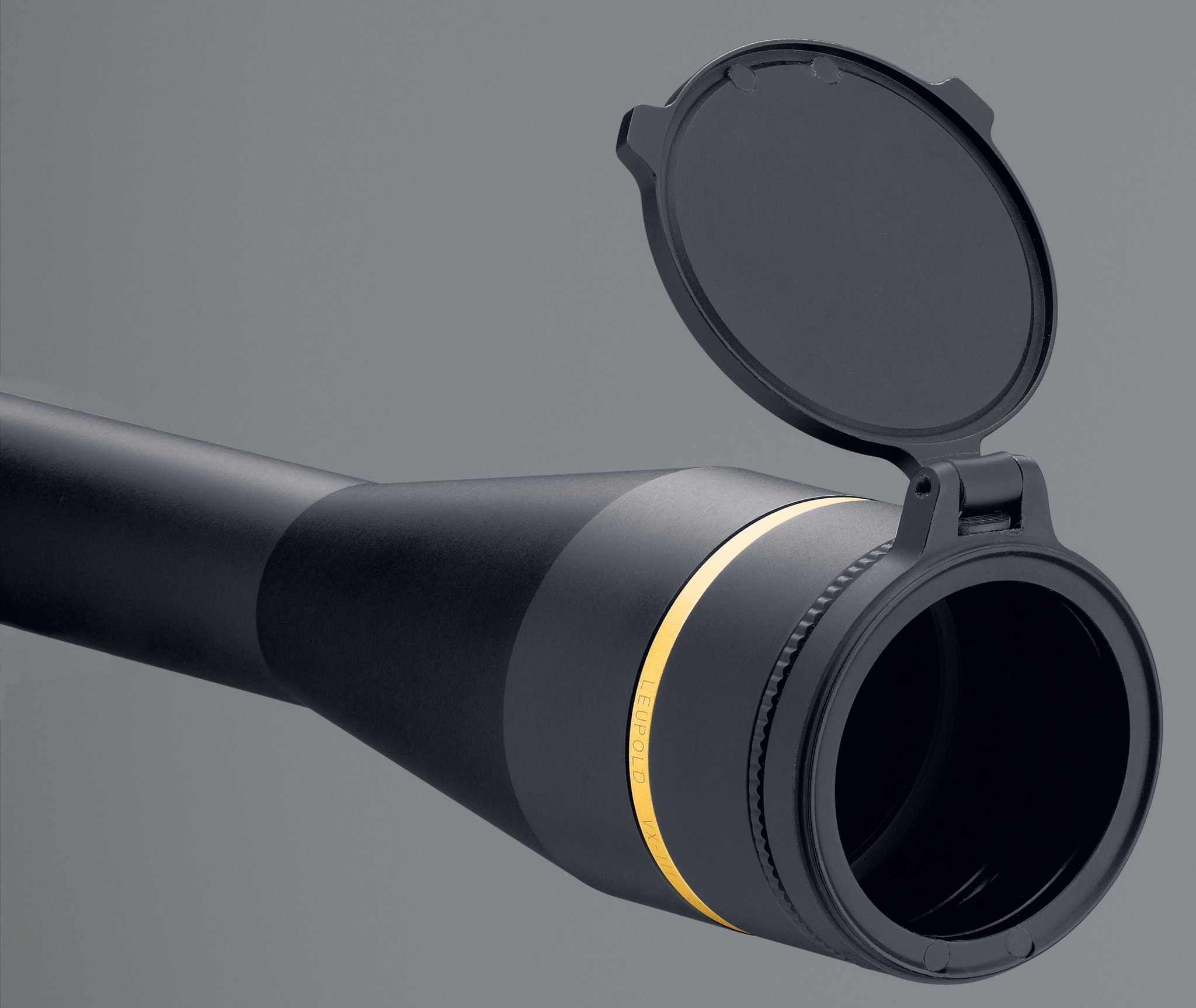

Anyone know what tenebraex caps fit the 5-25x56 scope?
I don’t think they make them for the mk5hd but Aadmount does & they are top quality. Everyone I know that has Aadmount really likes them. I’ve owned tenebraex caps & I think the Aadmount caps are just as good. One thing I really like about the Aadmount caps is the tension screw makes it easy to adjust or take off & rock solid when finally set
An Aadmount objective cover goes around the outside of the scope housing. A tenebraex obj cover has an insert that screws into the threads that a sunshade would. The actual cover itself mounts to the insert and fits into that. It doesn't protrude much, it at all, from the od of the obj housing of the scope.

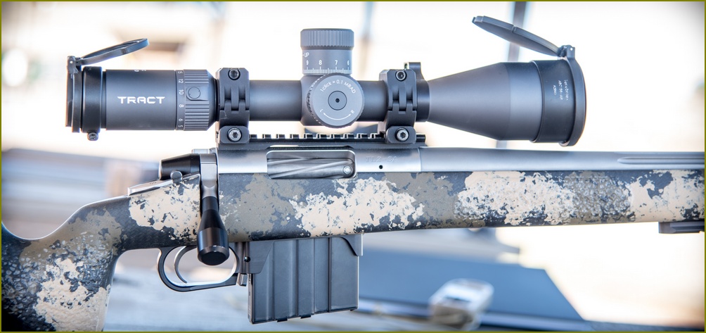

Here’s a pic of a tenebraex on the tract Toric. It protrudes just as much as Aadmount.
If your scope is that close then you might think about the leupold alumina caps. They are as flush fitting as it gets but expensive. If your scope is that close do you have trouble getting behind it? You might need higher rings
