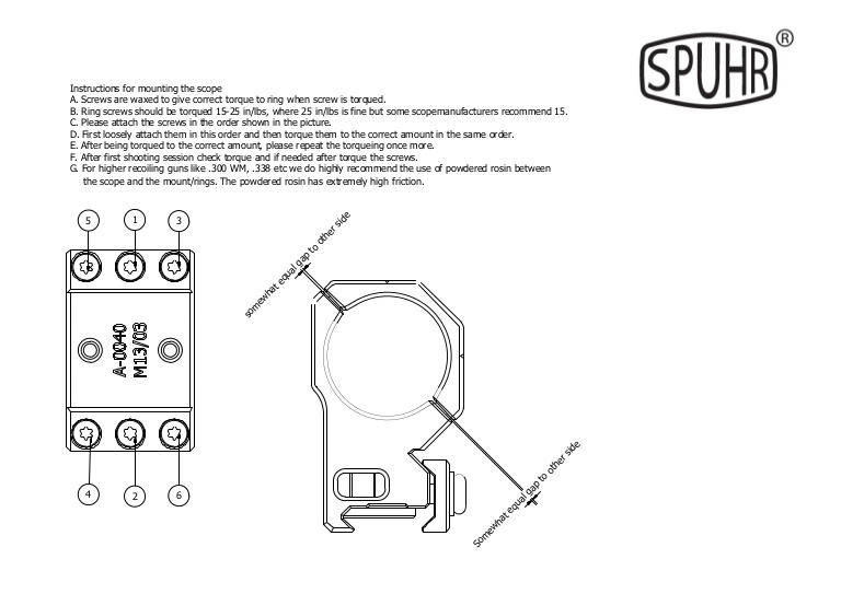

The instructions that come with the Spuhr mounts don't seem to be the best. I had to learn a few things by emailing and asking them.
One thing they recommend is using wet torque on the ring halves - either with loctite or the factory wax that is put on the screws.

I agree that the wide, 6 screw rings on the Spuhr can be an issue and are more technique sensitive during installation.
If you just crank all 6 ring screws down to say 20 in/lb in one step and you don’t tighten them in a specific order you will be left with a tweaked ring with uneven pressure on the scope tube. I have a hunch this method of installation is responsible for some of the complaints of “my scope slipped.”
With the Spuhr rings, you have to start snugging the center screws first, then criss-cross snug the outside 4 screws, and then repeat the process starting back with the center screws-- stepping up the torque each repetition. I like to torque them progressively in 4 steps, then go over all of them in order (2x center, then criss-cross the outside 4) one more time at the final torque value to make sure they don’t tighten any more. The criss-cross tightening pattern and stepping up the torque in multiple steps is common sense to me having assembled a lot of engines over the years, but may not be familiar to others; I’ve done it when installing all scope rings regardless of brand.

I used this diagram and followed the instructions.... except for step G after the fact.

I used this diagram and followed the instructions.... except for step G after the fact.View attachment 7457660
