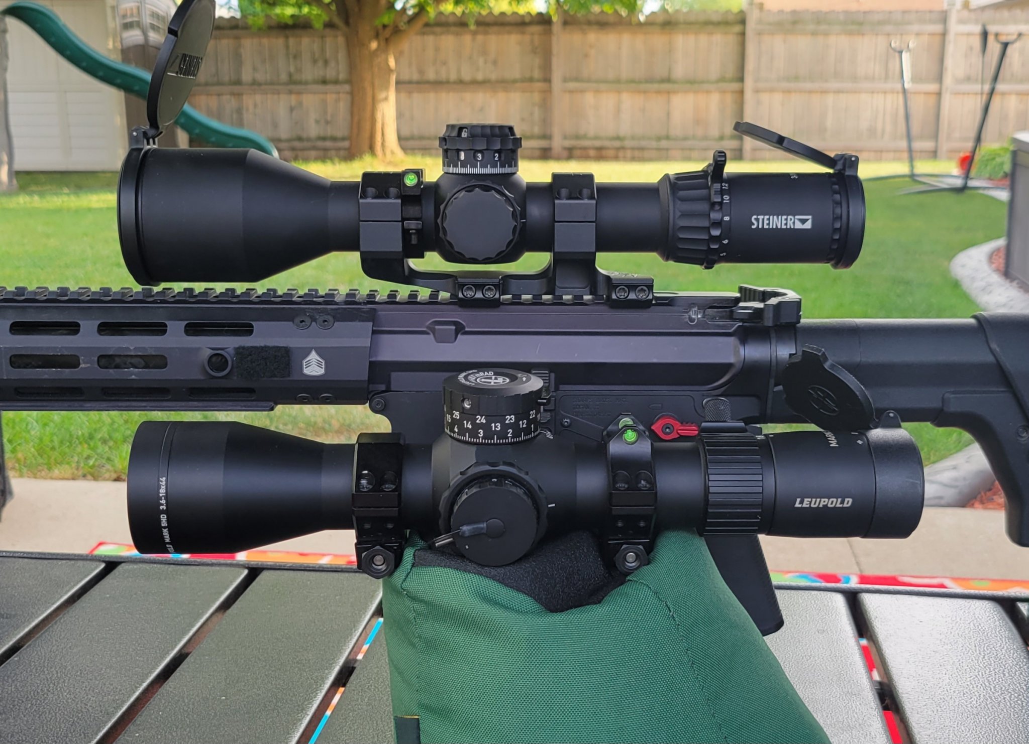

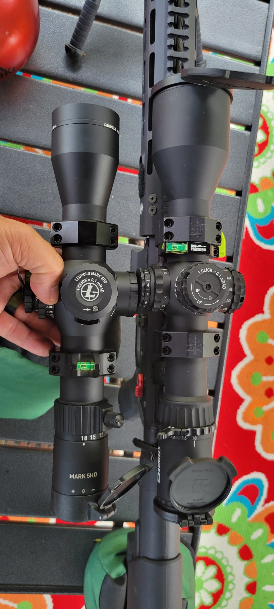

Borrowed my buddy's Leupy MK5 3.6-18 for a test against my TX6i. Short story is the TX6i is optically better, better at low light and much better FOV. Target used for reference was 200yds away.
His Leupy has MUCH better turret clicks (I hate the offset windage zero engraving) and about 8 oz lighter (very noticeable).
If weight and compactness is big factor I'd pick the MK5 otherwise TX6i for the win at the moment. Going to test them to 600yds this weekend.
