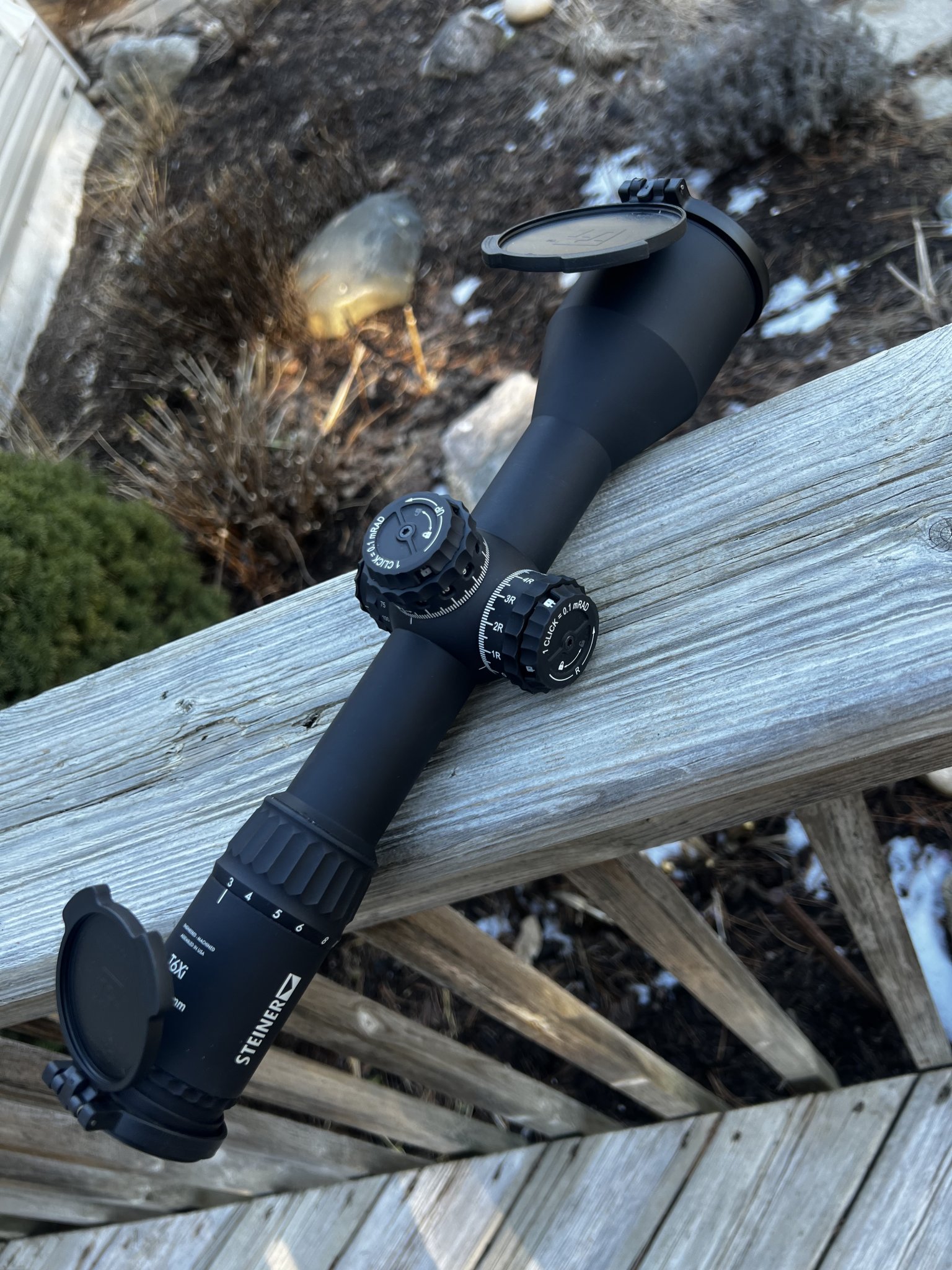

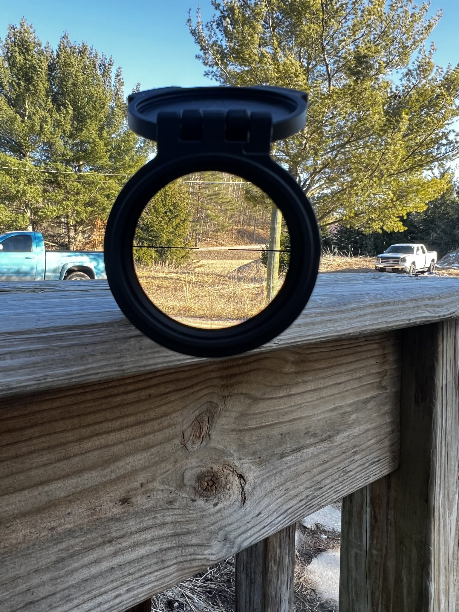

Just showed up in the mail today. Quick run down so far. Optic feels super solid and looks badass. The turrets are decent, about on par with my nx8, but not as good as my Athlon ares etr. Holding the scope and looking through it I’m not as impressed with the iq as I thought I would be. An optic of this caliber and price point shouldn’t have any CA. The CA was very noticeable to me. And that’s disappointing. My nx8 didn’t have any CA at all. It’s bad enough I’m not sure if I even want to mount the optic and go shoot because I’m already thinking about selling it.

Yeah that’s what I thought when I had it out of the box too, but I put it on my rifle and once it was setup with proper diopter and eye relief the ca really died down. Enough to where I barely notice it and I’m pretty sensitive to ca most of the time. Only on 18 x do you really see any to speak of. Eye box is very nice. Had to next to my s&b 3-20. Yeah it has some to be desired in ca correction but it keeps a flat image and the fov is awesome. The s&b is better corrected and has a piss better res resolution but barely. The image size and fov and lower cost is a passable trade for me. Everyone is different.

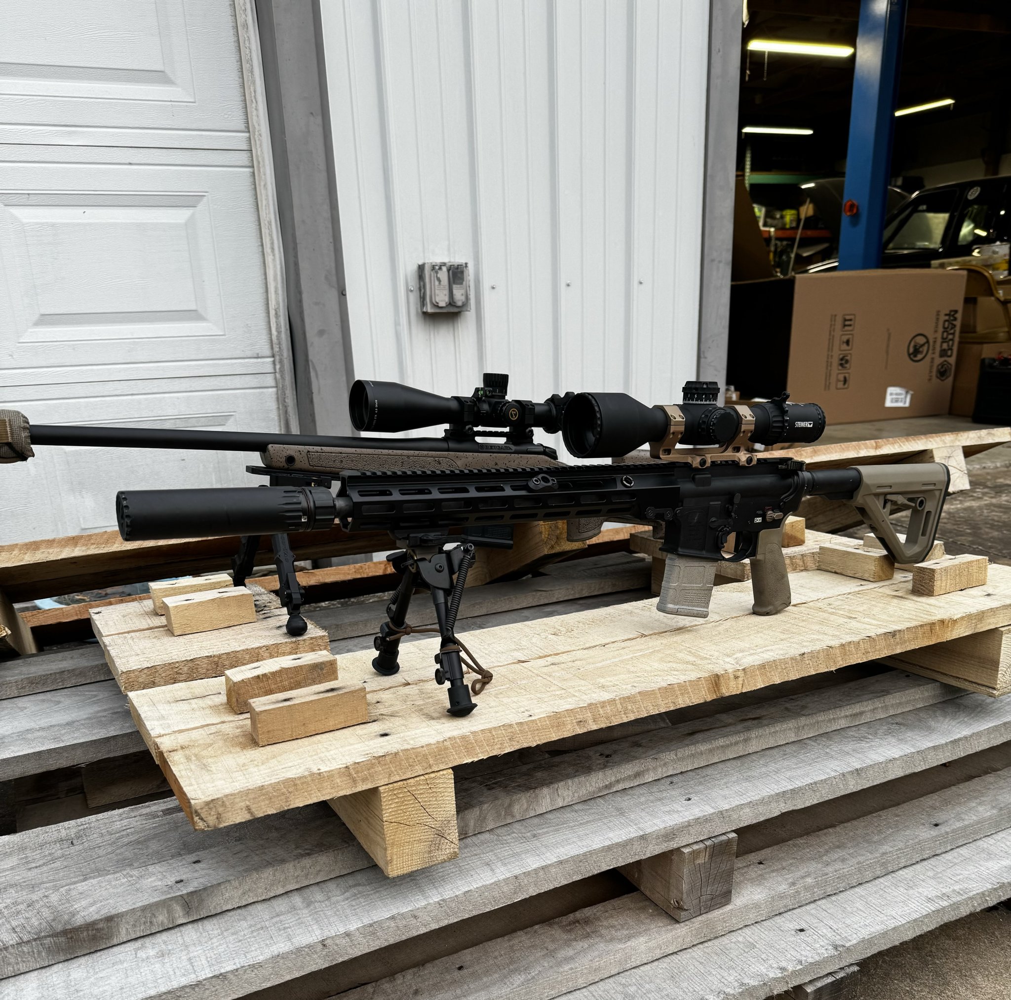

Got my t6 mounted today. I can honestly say I’m not that impressed. The glass has the worst CA my eyes have ever seen. It starts pretty early around the 12x range. This is such a big let down because people say the glass is good, and I just don’t see how. The ares etr behind is just as clear and doesn’t suffer from ca at all. I was expecting better for this price point. One to the next, guess I’ll have to bite the bullet and buy an atacr. I wanted something better than my nx8 and I was hoping this was it. Lots of people say it was, but it’s not for me.

Send it to Steiner. Mine ain’t nothing like that.
Seriously? That’s super disappointed. I feel like an optic of this caliber shouldn’t have to be sent in because of poor quality control.
Yeah mine is free of ca until about max power. Sounds like you have a bad apple most likely

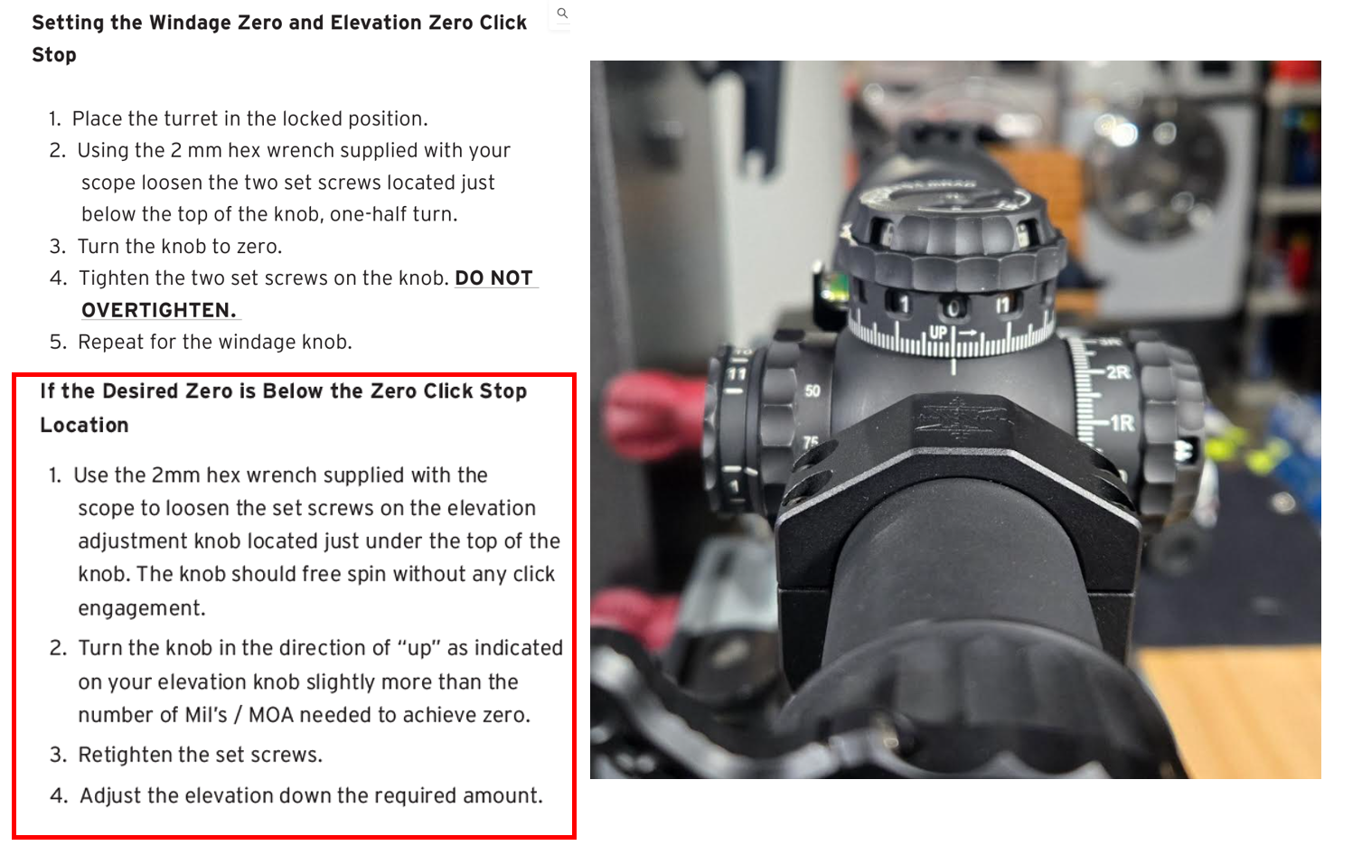

Got my Steiner back from repair late last year and finally getting to zero it on a different rifle. (Elevation turret was repaired).
I am shooting 1.2 mils high and cannot bring the POI any lower than an additional 0.5 mils. Currently I can only dial 22.4 mils (35 mils is advertised). This thing is driving me nuts and I'm even reading their directions. For step #2 I am rotating it up 1.7 mils so I can come back down 1.2 mils per step #4 but I'm still shooting 1.2 mils high. I've tried this with turrets locked and unlocked. (HATE this locking feature!)

So you are 1.2 mils high, and you follow the steps 1-4, and after adjusting you are still 1.2 mils high? No change?
That is correct so I repeated it again, then again but with turret unlocked. Same result. 1.2 mils short and only 22.4 mil available up. I'm thinking when they repaired my turret they reassembled something wrong (I emailed them last night). I sent it in due to a screw missing then become a problem when it broke (comments #813 and 883 in this thread).
When you loosened the screws and added 1.7 mils does the turret click? Because it shouldn’t
Reactions: Malum Prohibitum
No clicks are heard or felt when both set screws are loosened as I am twisting the main turret up per instruction #2.
Something seems weird then. I’d put it in a jig or clamp down ur rifle so you can see if the reticle is moving during your reset to see exactly what the scope is doing. Mine has been flawless. The zero reset procedure they are using is very popular with the higher end scopes. It’s pretty simple
I'm sending this unit back in. I put on my 2nd TX6i and did a poor man's bore sight and used a cheap laser bore sight at home. With my upper clamped down and using the same reference point about 75yds away the 2nd TX6i had no issues getting a visual zero AND still having 29.7 mils left of elevation to dial.

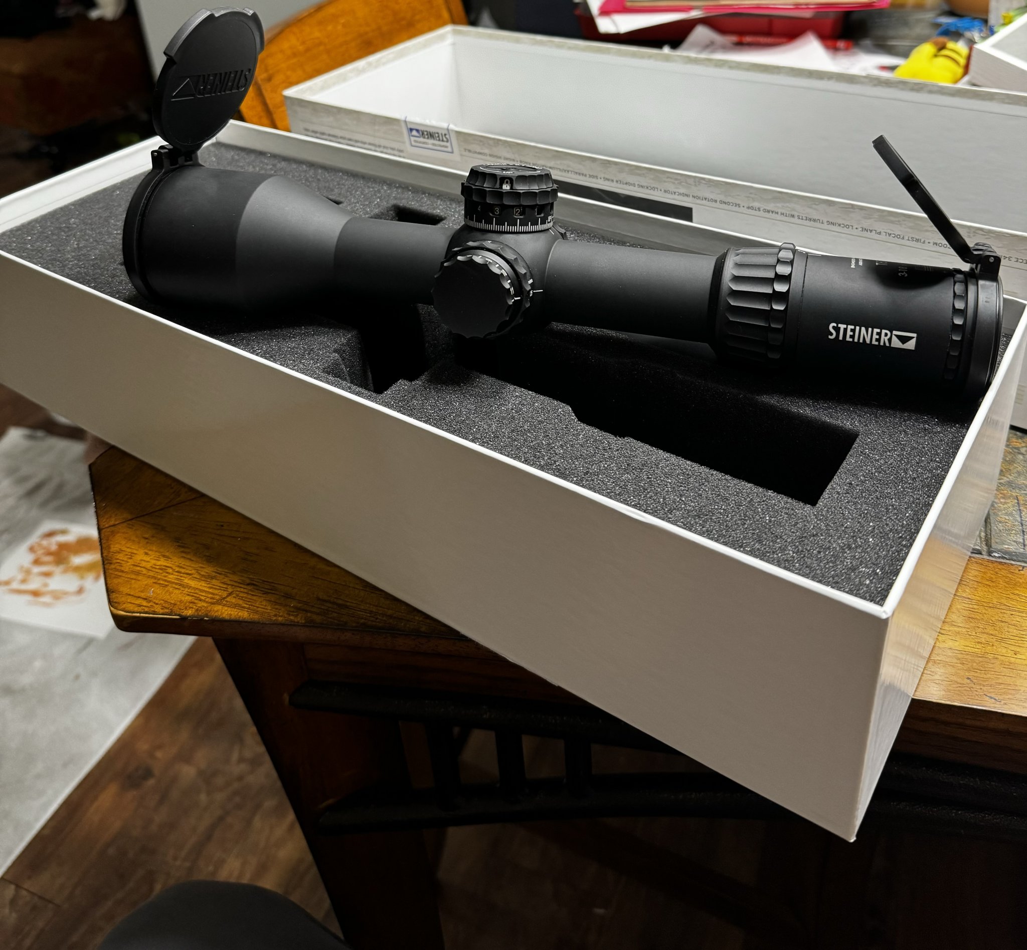

Got my second one in today, this sample is better than my first in about every way. The turrets are about 200% better. I’d even put them up with my old m7xi and pmii. Night and day sadly compared to my first one. Optically Probly about the same. Maybe a less ca too. I had a way harder time picking it up at max power. But the. Again our snow is gone. Maybe their qc is getting better with this one ? Not sure. I love them for the price.
