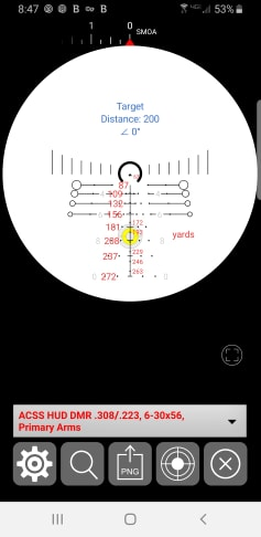

Something doesn't sound right. I put your reticle on my 22LR rifle to play with it. I'm using an 18-inch round target. Here's the reticle view at 200 yards with no elevation dialed:

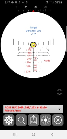

Now, with the turret dialed 23-1/4 MOA:
The target and hold-over yardage for each subtension move / change (as they should) when the elevation turret is dialed.
If yours isn't doing it, I'd recommend contacting the developer, Igor Borisov. He's very responsive to users. You can find him on the Facebook "Strelok Ballistics User Group." Or you can email him right through your phone app... click the "About" button at the bottom of the home page. Then you'll see a button to "Send email to Igor Borisov" right at the top.
