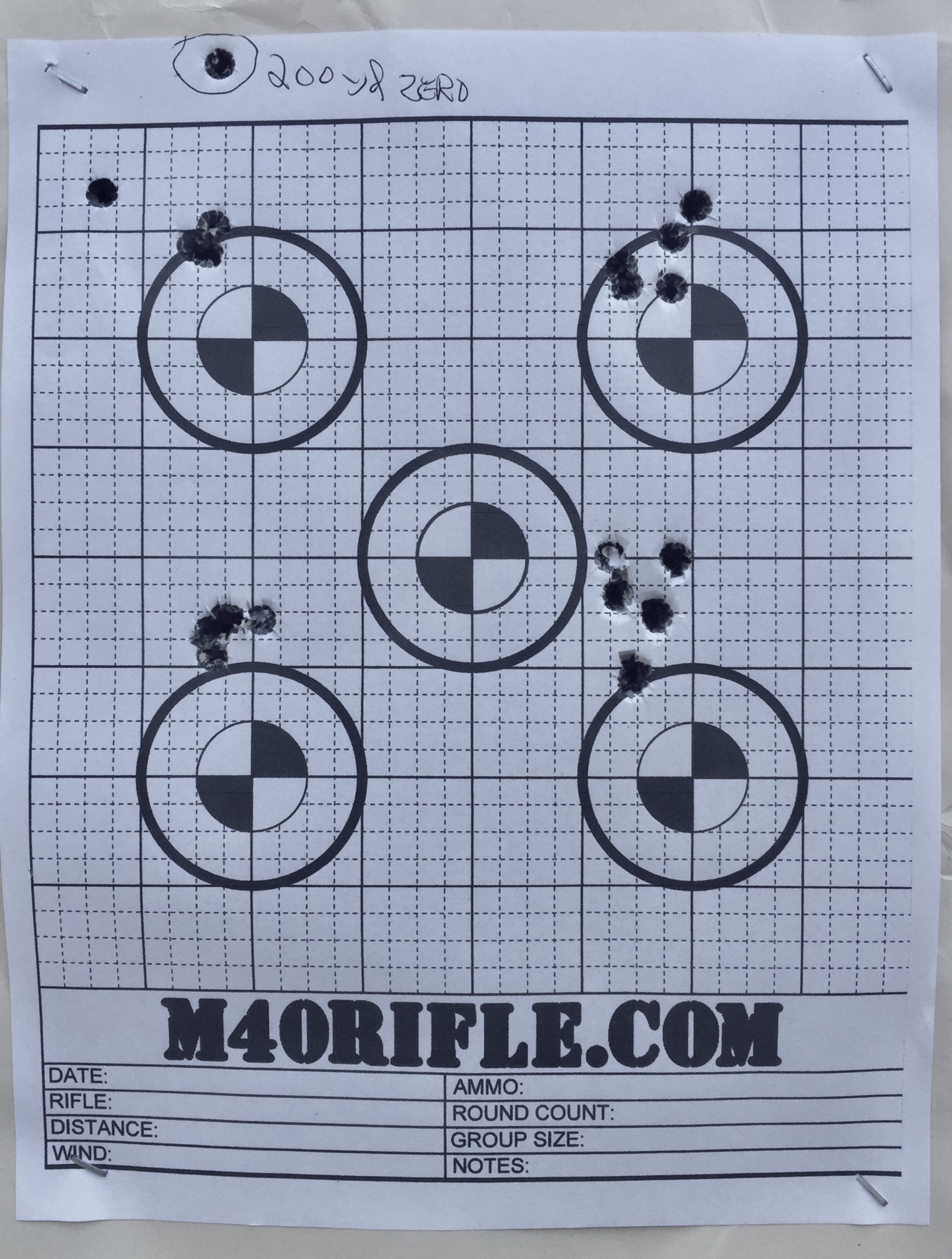

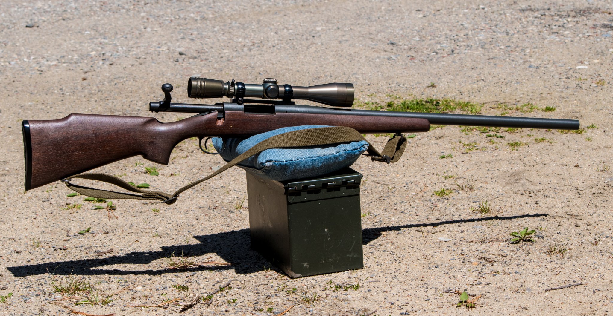

(y) Good looking rifle! Bottom left looks like the winner. Which bullets? Have you tried adjusting the seating depth yet? I sent my R700 action into Patriot Valley Arms for a new barrel install with an M24 contour. I'm looking forward to having it back for new load development.

Your build looks nice. Bottom left target looks good, was that 41.2 of I-4895 with 168 SMK and Federal Match primer? Just curious.

I havent played with the seating depth at all in truth I wanted to stay with the standard 2.280 308 OAL.

Well, now that you've found an optimal powder charge weight, it may be beneficial to adjust the seating depth a bit. I did that with my .308 R700 shooting 175 SMK's and it shrunk the group even more. What you've got there certainly works, just tossing out ideas! :) I find my optimal charge weight, then adjust the seating depth, after that....It's off to longer distances.

I guess that means I have to go back to the range and shoot it some more.
The struggle is real!

Hey brother....Someone has to do it, ya know? I did seating depth adjustments with both 175 SMKs and 175 Berger VLD's. The VLD won for smallest group. Which I'm only partially upset with, because they cost a fair bit more than Sierra's to shoot. The price we pay for better bullets with superior external ballistics is the real struggle ;)
