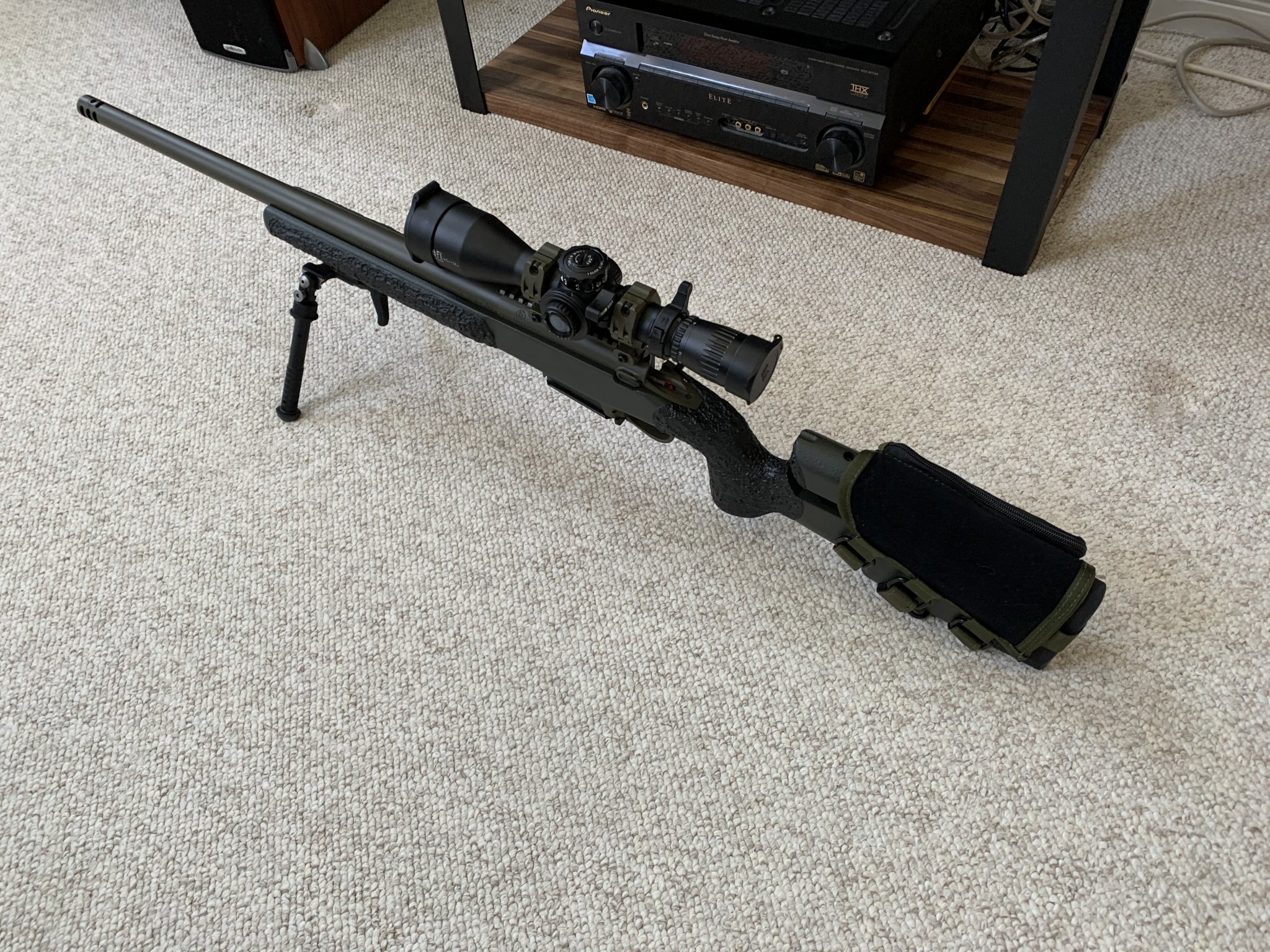

Just got my Surgeon X-ray 51. This is a masterpiece. Really, it is.
There is just one really major problem. And I spent much of the day yesterday speaking with Mike about this one:
I need another. So I placed an order for the Delta 51 with a carbon fiber stock and a forward night vision mount.
If there is anyone on the fence reading these posts- rest assured that you will not be disappointed.

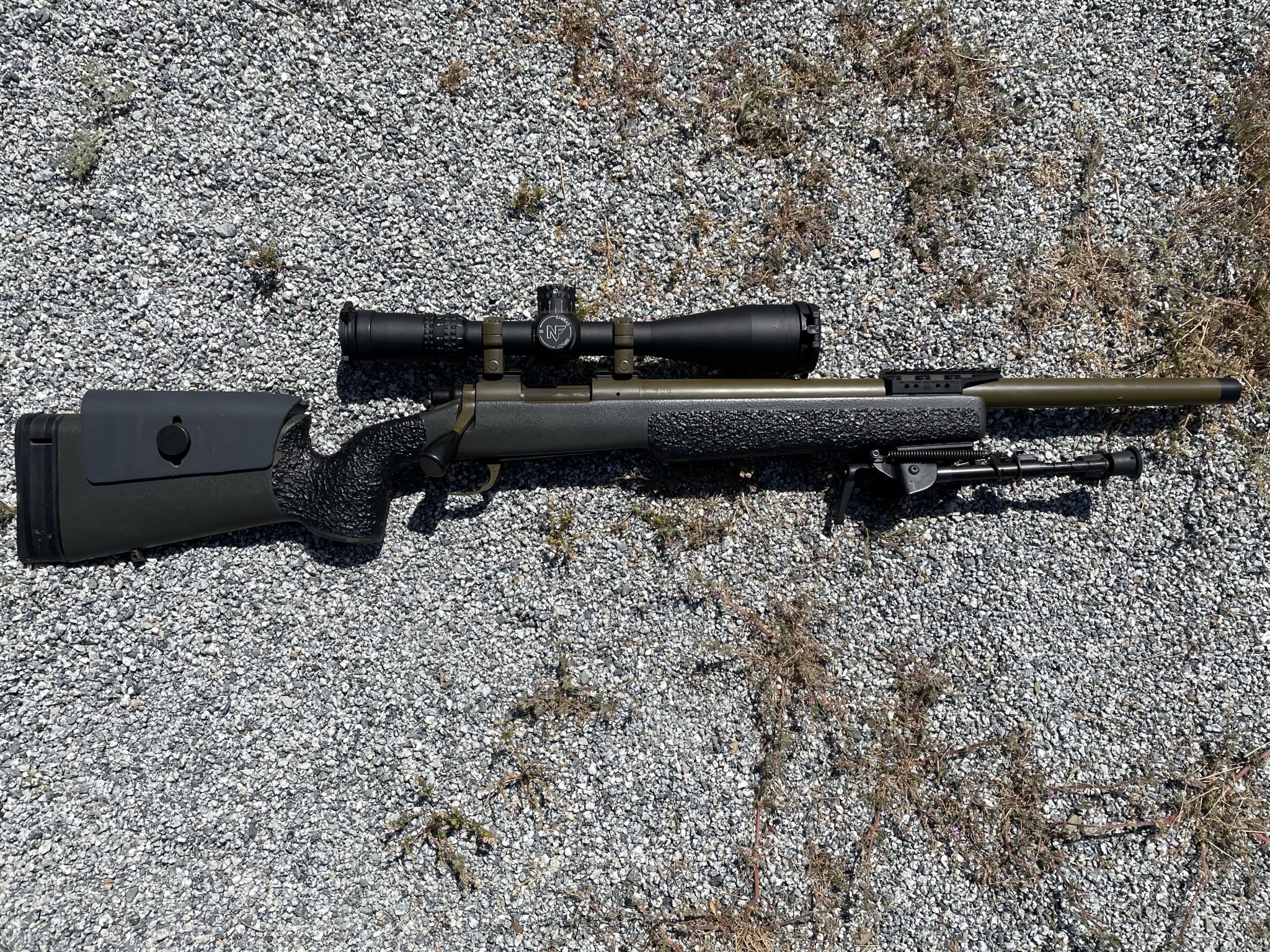

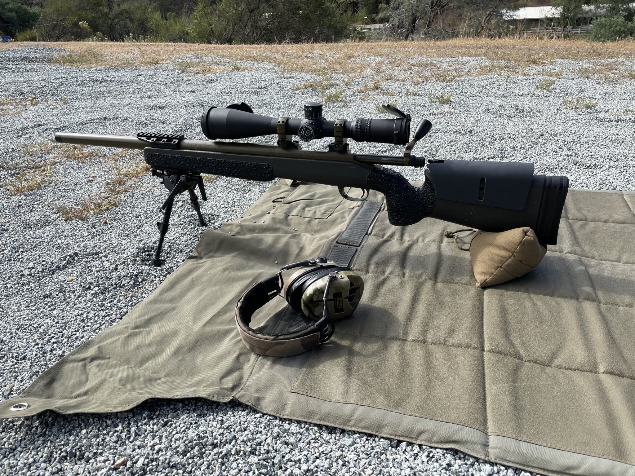

So I took the Surgeon Xray51 to the range for the first time today. She is topped with the March 4.5-28.
All I can say is holy smokes. This setup is completely out of bounds. The rifle has essentially no recoil. It makes bug holes at 100m with absolutely no effort whatsoever. The glass is amazing even if the eyebox is a little tight. This gun makes me look like I know what I am doing (which I don't),
Prior to this, my go to bolt gun has been a Steyr SSG69 with a Swaro optic. Now this has been a great setup for the past 15 years. But the Xray is light years beyond this. I have decided that I will be parting with the Steyr for another Tacops. I will not look back.
I had not had any experience with a Tacops rifle before this. But all I can say is that the accolades are completely justified and you really have to experience this to understand just how special this firearm truly is.
I have said this before in this thread- if you have any hesitation about purchasing a Tacops rifle, don't. You will not be disappointed.
Steve
Reactions: J Scott
Steve
Steve
Steve

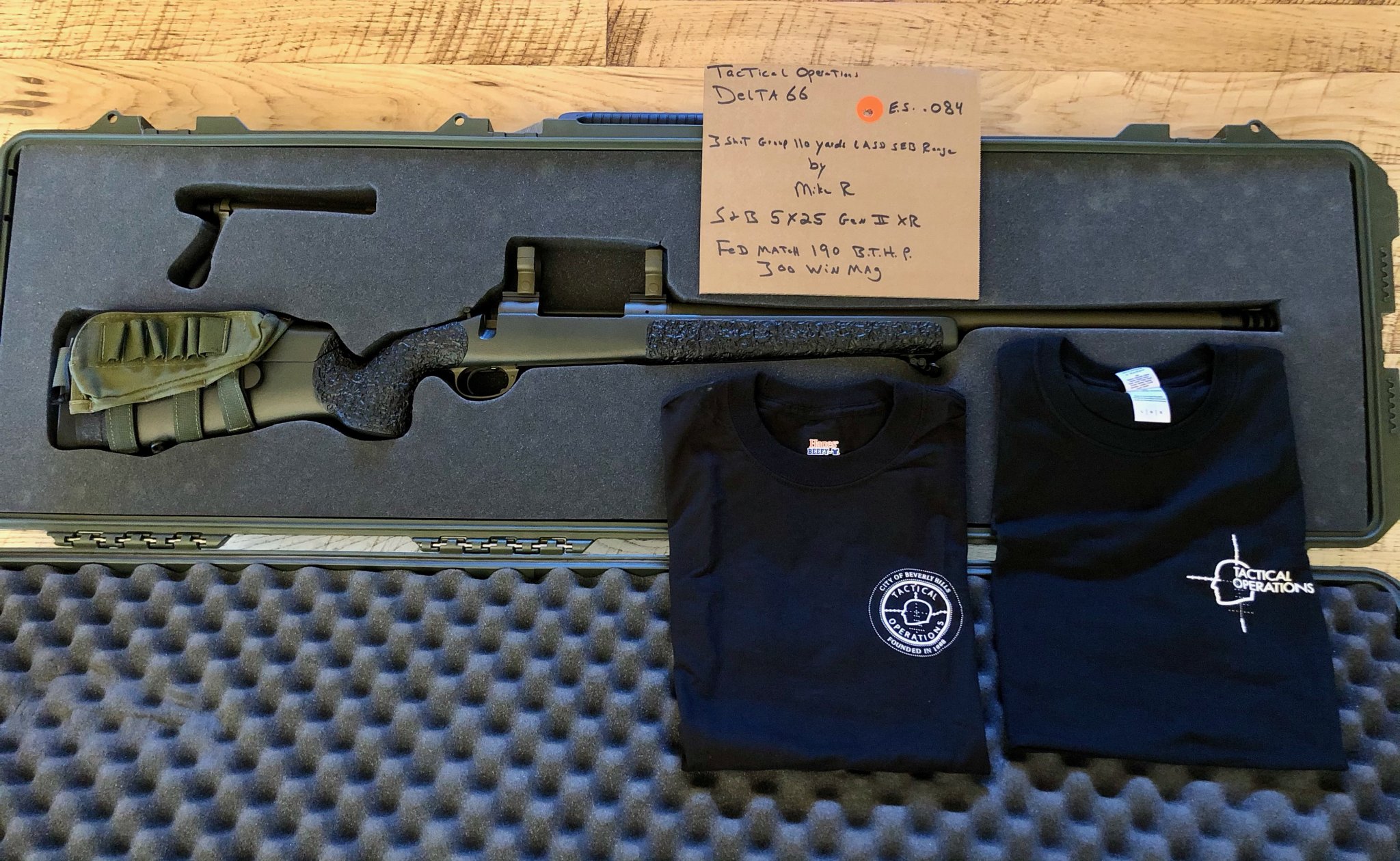

Not that it bears repeating here, but I'll echo everyone else's sentiments anyways: Mike is a class act, easy to get on the phone, very responsive, and every recommendation he made was an improvement over what I thought I wanted initially.
I can't wait to mount my scope and hit the range!

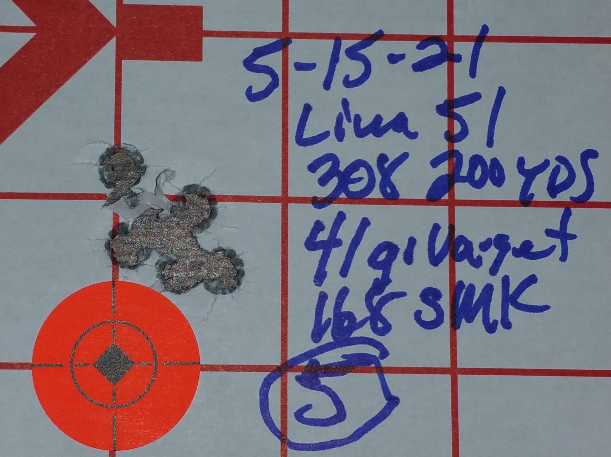

I miss my Lima 51, so took it out of the safe and shot it today!
Basic load of 168 SMK, 41 grains of Varget and WLR primers. Some old R&P brass, 90's era. :)
Another 200 Yard Target, off a crappy bench and using a Harris. :)

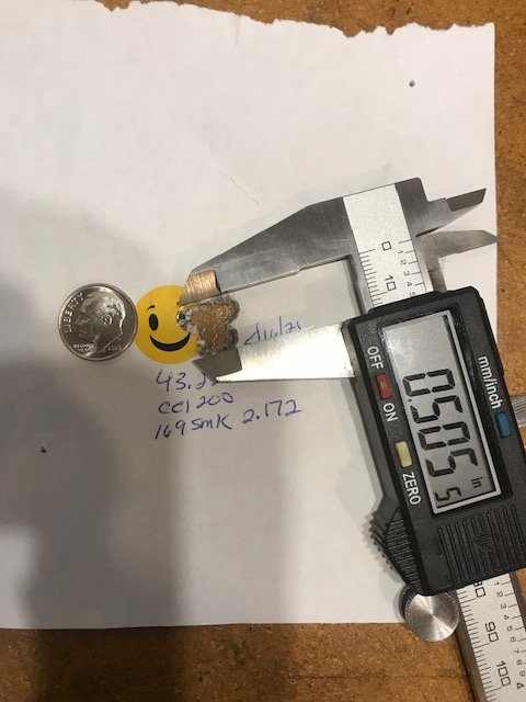

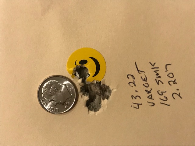

I'm testing out Sierra's new 169 grain SMK projectile in the Delta:
43.22 grains of Varget
CCI #200 primer
FGMM once fired brass
169gr SMK seated 2.207 at the ogive
Problem is the COAL is 2.865 which is too long for the internal box magazine, causing feeding issues. They shoot pretty well even though I flubbed a shot out of the 5 round string.
I'm going to test seating them at 2.167 for a COAL of ~2.820 and 2.172, COAL ~2.825.

I "Mexican Matched" some FGMM168 with the 169s by kinetic pulling the 168s, dumping the powder, bushing sized the necks to 0.002" tension, poured same powder charge back in and seated to (IIRC) 2.850" OAL (I have a DBM in my Lima51). Groups opened up from the FGMM I was shooting (<1/2moa group with FGMM168 to >1/2moa with 169s). Disappointed, but not surprised. I would suspect Mike's throat reamer is made for the much more secant ogive and the more tangential ogive of the 169 isn't happy about it. I'll try some regular handloads with the 169s sometime and suspect jump length will be more critical with the 169s.
On a side note, when I dumped the charges from the 10rds I Mexican Matched, I weighed them. Not impressed at all! I found the normal powder charge to be +/- 0.2gr and the worst was a full grain from the norm. Case weights were all the same, +/- about 0.5gr and BTO were all within 0.005" before pulling bullets.
Feeling pretty good about these 169 SMKs out of the Delta after seating them deeper to see if feeding improved from the internal magazine.
Powder charge and primer same as above - projectile is seated 2.172 at the ogive with a COAL of ~2.825 with no feeding issues, but I'm probably right at the edge.
Next steps are to see how they do out to 500 yards, and if this is transferrable to my Lima 51 with a 22 inch barrel vs Delta's 18.
