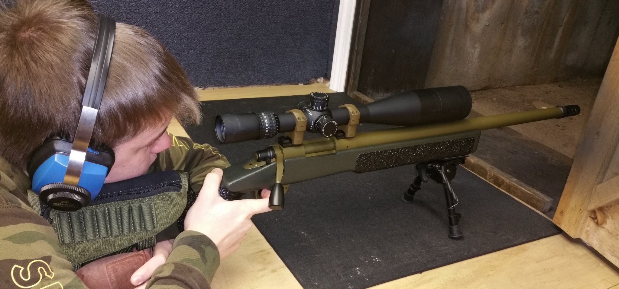

Pic of mine that Mike sent me.

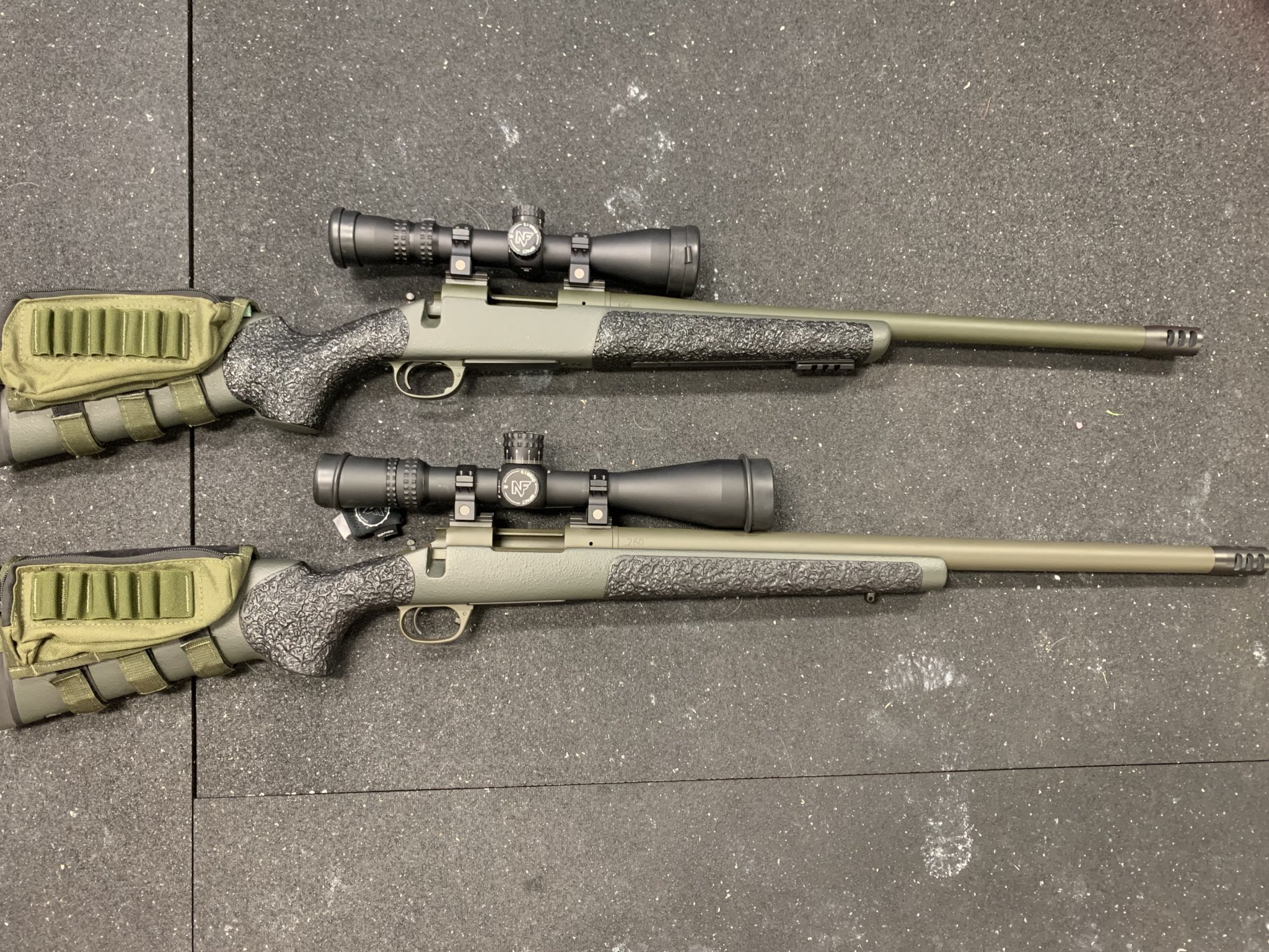

For reference, here is my Tango 51 (top) with NF NXS 2.5-10x42 in NF 0.885 30mm rings. Also, have my Sierra 260 (bottom) with NF 3.5-15x50 F1 in NF 0.885 30mm rings. On the Sierra, due to the thicker barrel profile, it is a tight fit but works. I don’t think you would have a issue running a TT in a 0.885 ring height on a tango with the thinner barrel. Not sure of options with ARC rings but I would definitely try to stay below a 1” height. Go as low as you can.
I assume the TT 3-15M runs the tenebraex covers like the P models I have. Those are thick. Personally, for me, getting the scope as low as I can for a good cheek weld is more important than worrying about caps. If the caps don’t fit, run a scope coat. I would go 0.94” at max if stuck with ARC brand. Personally, I would use the NF 0.885” rings to be a little lower. I don’t think the 0.79” ARC rings will fit.

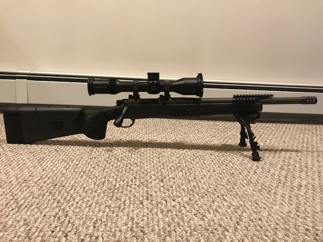

I still need to scope mine.... Tacops X-ray 51 on a Surgeon
Tangent Theta 5-25x56 or ZCO 5-27 would be a great choice on that one

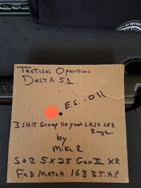

Take a close look inside the "O" in "Operations". What reticle do you see inside the "O"?:

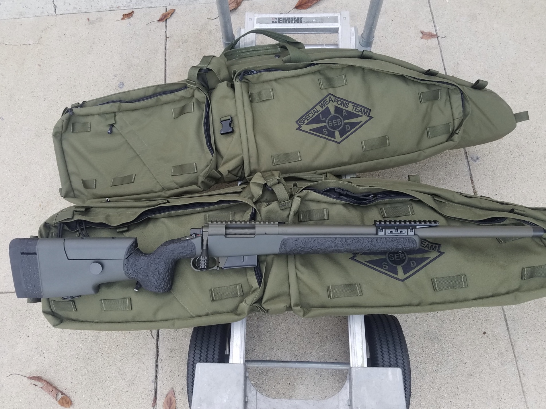

Here is the new Delta 51 Lightweight that arrived last Friday. This is the same rifle now in use by LA Sheriffs Dept. Special Enforcement Bureau.
Specs:
Remington 700 action
Internal box magazine
Krieger barrel finished at 18" with Mike's brake
McMillan A3 carbon fiber stock
Mike's fit and finish throughout
S&B PMII 3-20x50 ultra short with the DTII P4F
A couple of TacOps t-shirts

Beautiful rifle Mike does it again

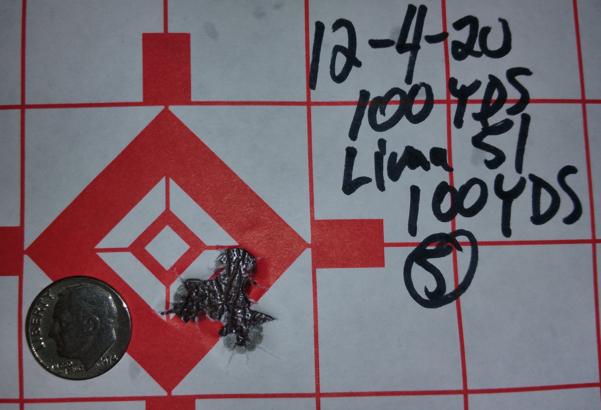

Anyone know how mike shoots groups like these? I get that the rifles shoot really well, but there is no way I could shoot a group a like that even if the rifle is capable of it. Does he put them in a mount or are these bagged in on a bench? Just curious.
nothing special
the bastard is just that good lol
NO MOUNT, just a front rest with sandbag, rear sandbag, FGMM ammo, and a lot of skill.
