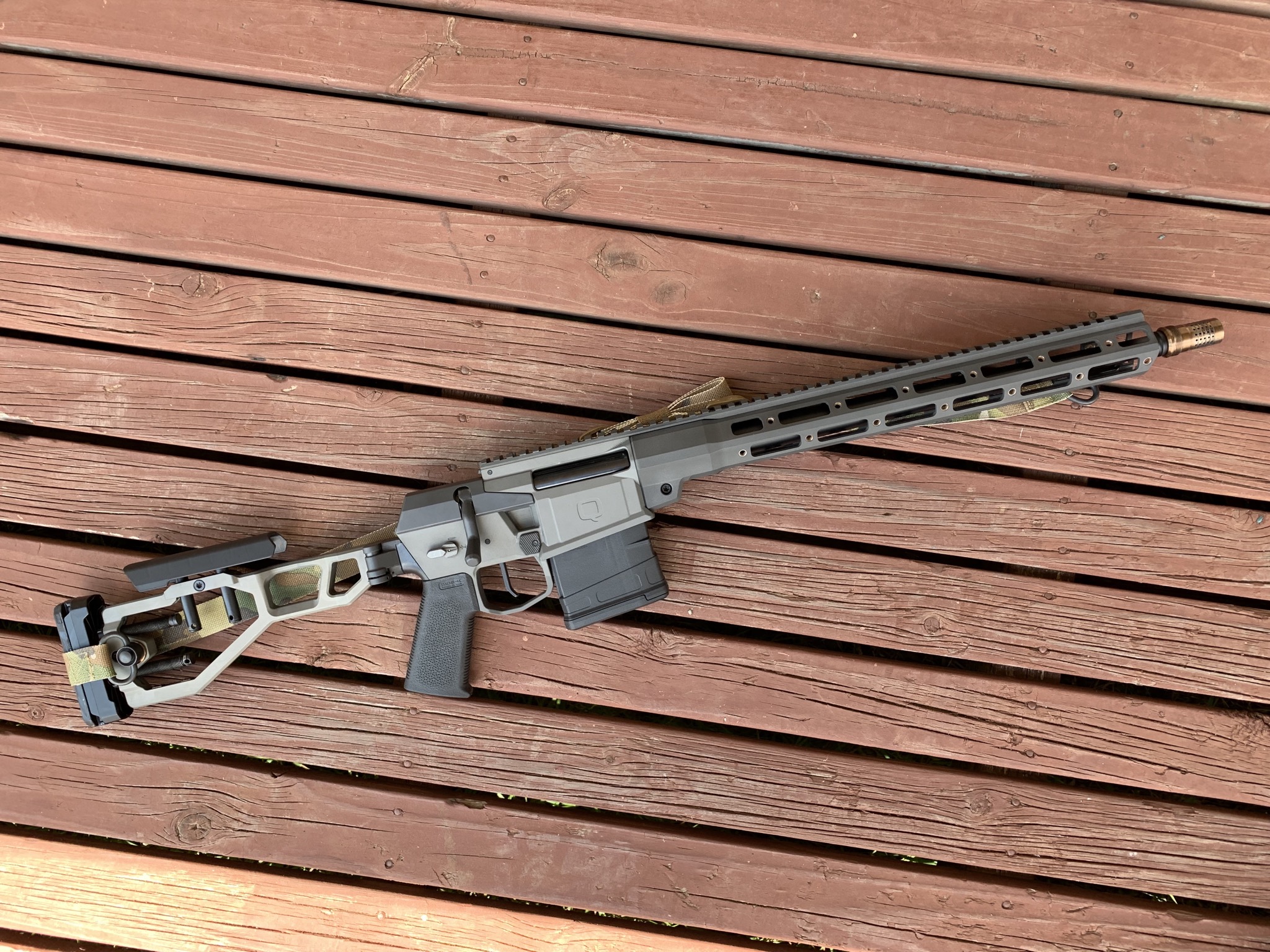

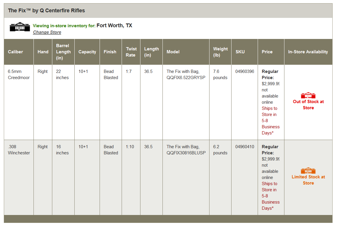

I was doing some online shopping at Cabela's today. There might be some 16" .308 rifles in stock at their Ft. Worth, TX location for those looking for one.
Stupid blue accents. I’ll never get over the fact they won’t even let us order black ones to get rid of them.
They’re not gonna make a variation of colors on accecories and parts available to the public when they have a 7 months wait list on the rifle. Maybe some day they will when sales slow but not anytime soon. I personally love the blue accents and will probably be taking mine apart to cerakote a few other small parts blue
Looks like a nerf gun
Considering that your posts about the rifle seem to be only negative, not surprising. Don’t like it, don’t buy it. I highly doubt anyone who actually shucked out the $3K to buy one feels like they have a nerf gun because it has a couple of blue accents.
Mine isn’t blue but has quickly became my favorite rifle, more so than my AI AX. I’m already planning to buy a second as well as a mini. The rifles are all they’re cracked up to be and a little more. My only complaint is that I didn’t buy one sooner.
I haven't made any negative comments. Why so sensitive?
Oh and thanks for your permission not to buy it douche.

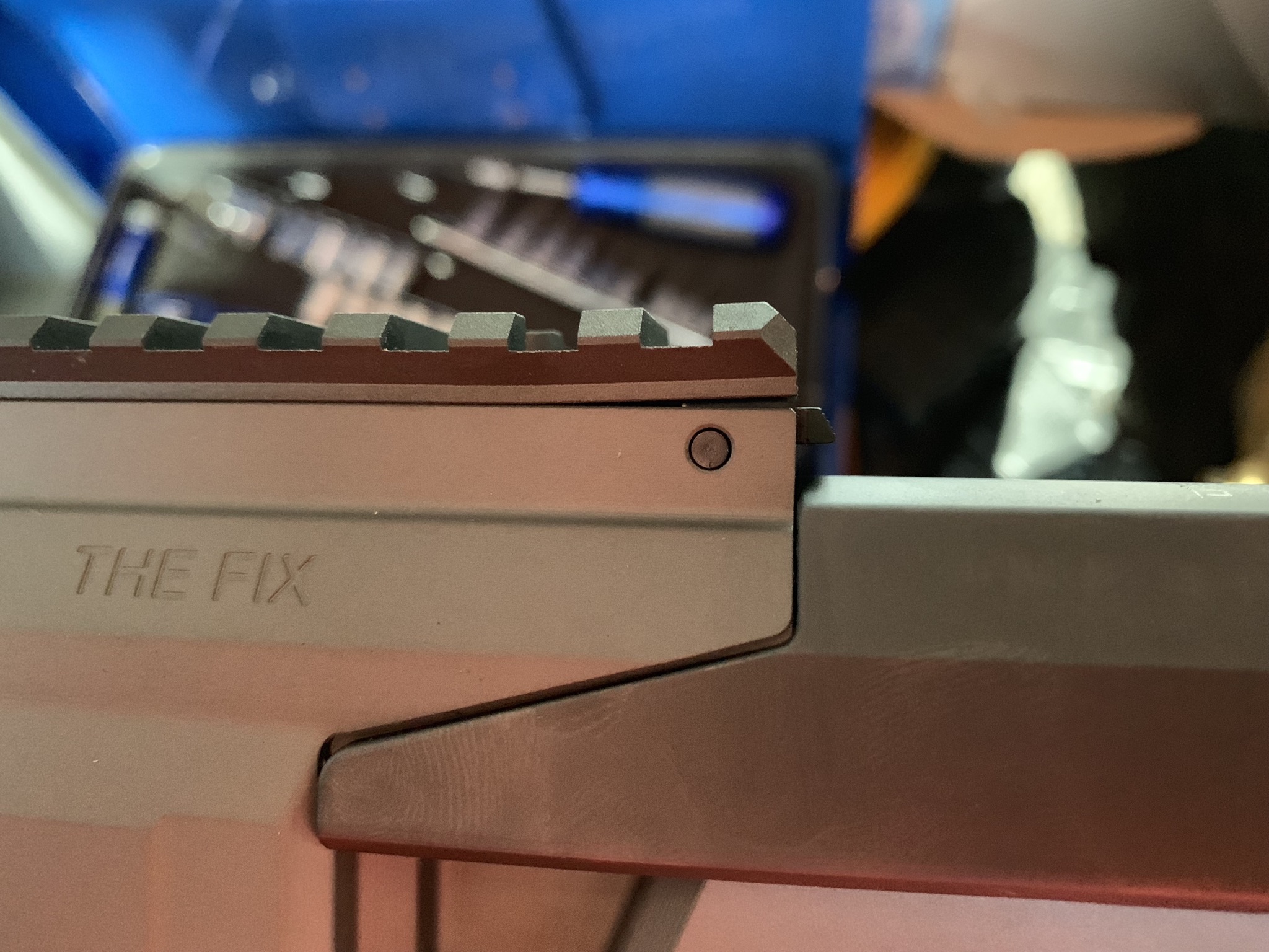

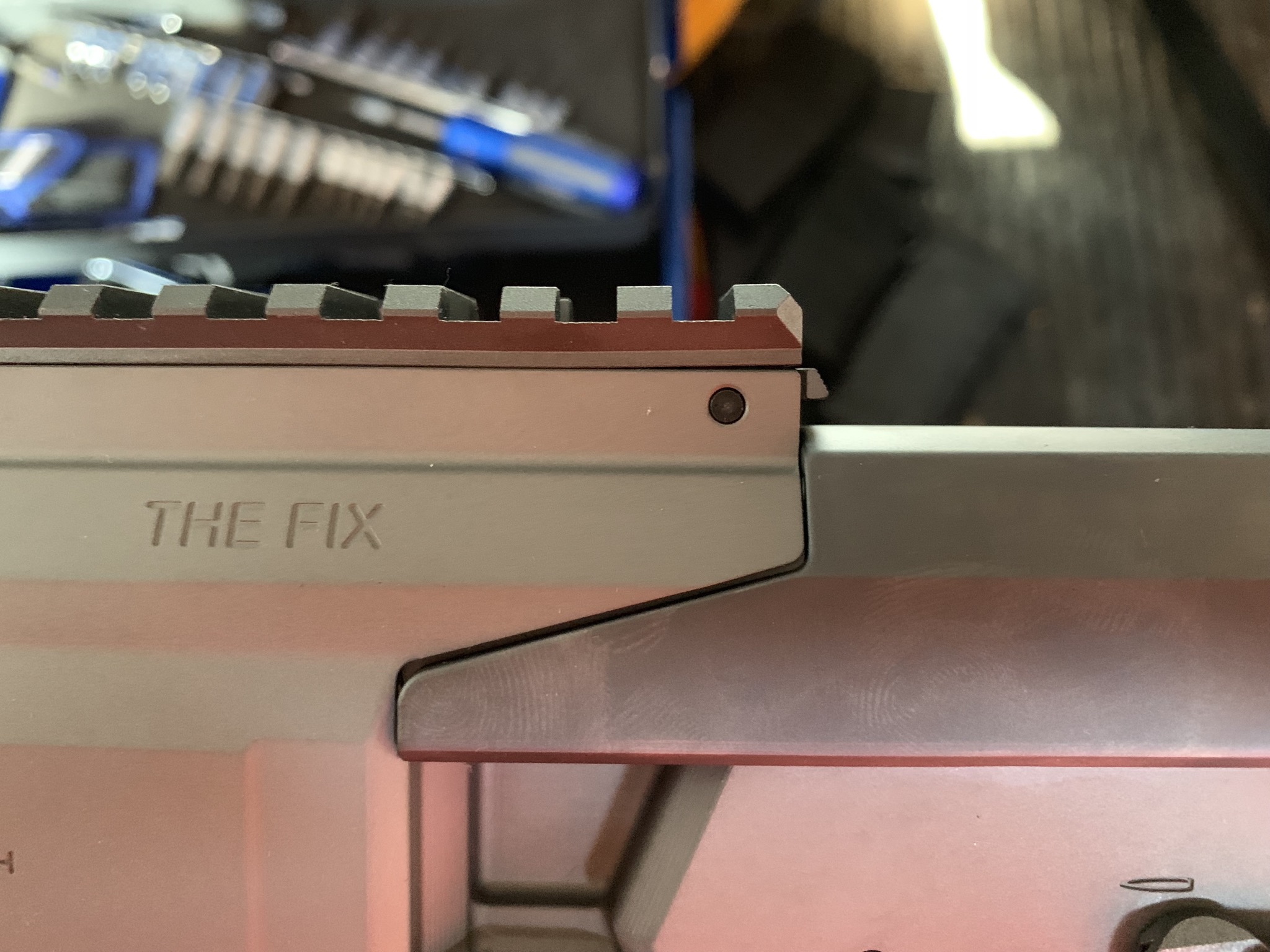

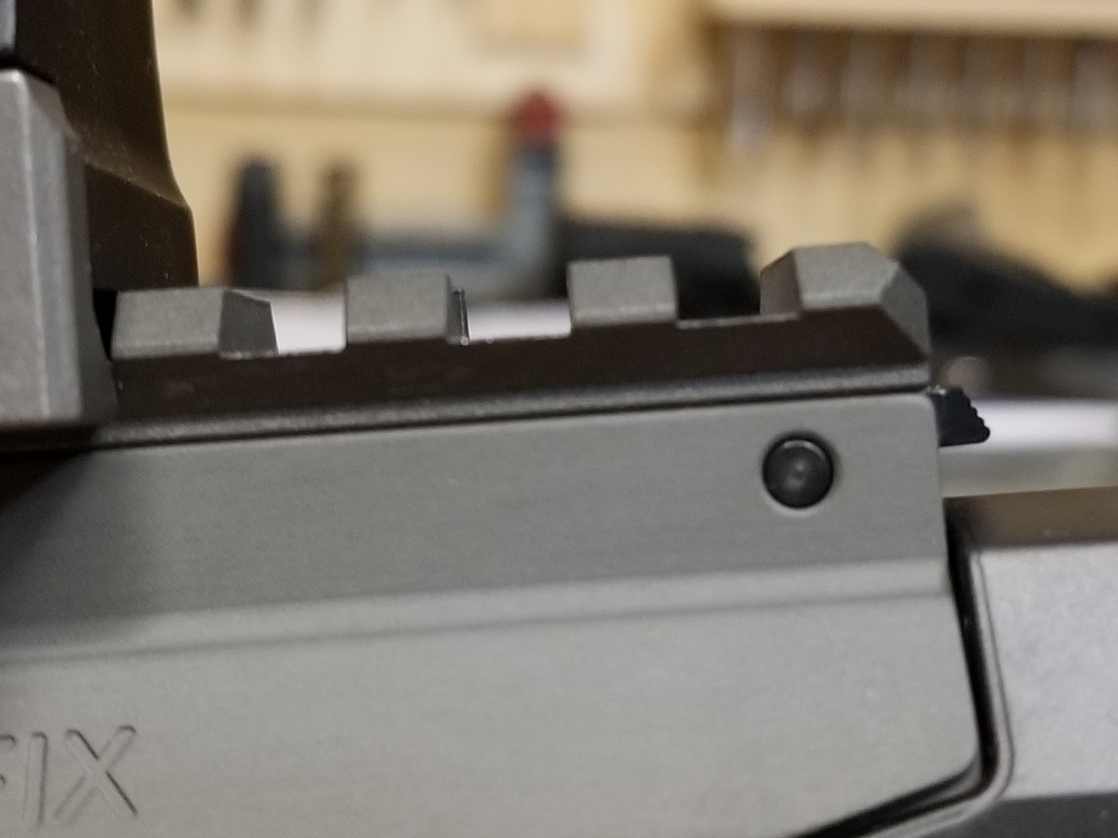

Just got mine and from what I can tell the top rail is busted? It wasn’t installed correctly and is bent. I took it off and torqued it down correctly and it’s sitting better but I think the damage is already done. Anyone else’s look like this?

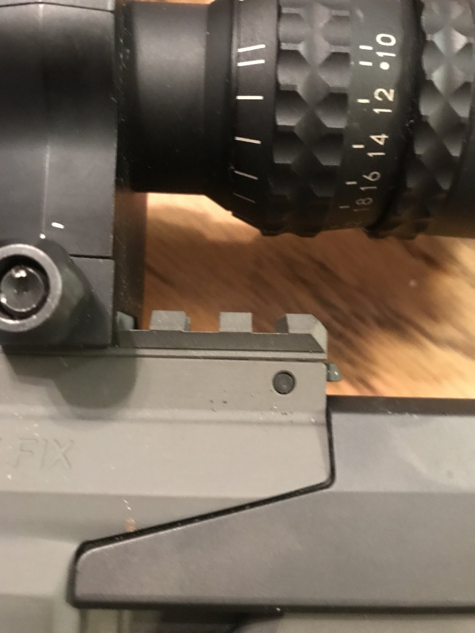

Mine has looked like that after I took it apart a couple times. I didn’t notice it until after the 4th or 5th time I did a barrel change. I also switched to the short top rail and it does it as well. My assumption is if the spring for the bolt catch doesn’t sit in there just right, it messes with the rail. It could also be the spring is slightly too long. I have not noticed any sort of hindrance to shooting or returning to zero after barrel changes because of this.
Thanks for the reply and info.
So when yours is installed correctly it sits flush or it looks like the second picture?

Okay so a bit better. I’ll try reseating and torquing it down again and hopefully I can get it as good as yours and call it a day.
No problem. Some tips on installing the top rail that I do,
1) make sure the rifle sits level and that the spring is sitting in the pocket square before setting the rail on top.
2) I then start tightening the screws starting at the bolt and working towards the muzzle hand tight at first.
3) I then go through a torque them down in the same direction.
Hope this helps

That's kind of shitty, it looks like something was caught between the receiver and the rail when it was torqued down. Assuming the spring and everything else is fine (uncrushed) id email them the original picture and ask if you could swap rails. Its good for Q to know so they can avoid it in the future. Going forward, when I assembled mine at Q the engineer instructed me to apply forward pressure to the rail (towards muzzle) when installing it like you would when mounting a scope.
Thanks I’ll do that to the new one when I get it.
I emailed Q first and they finally got back to me saying that’s not okay and they are sending me a new rail.

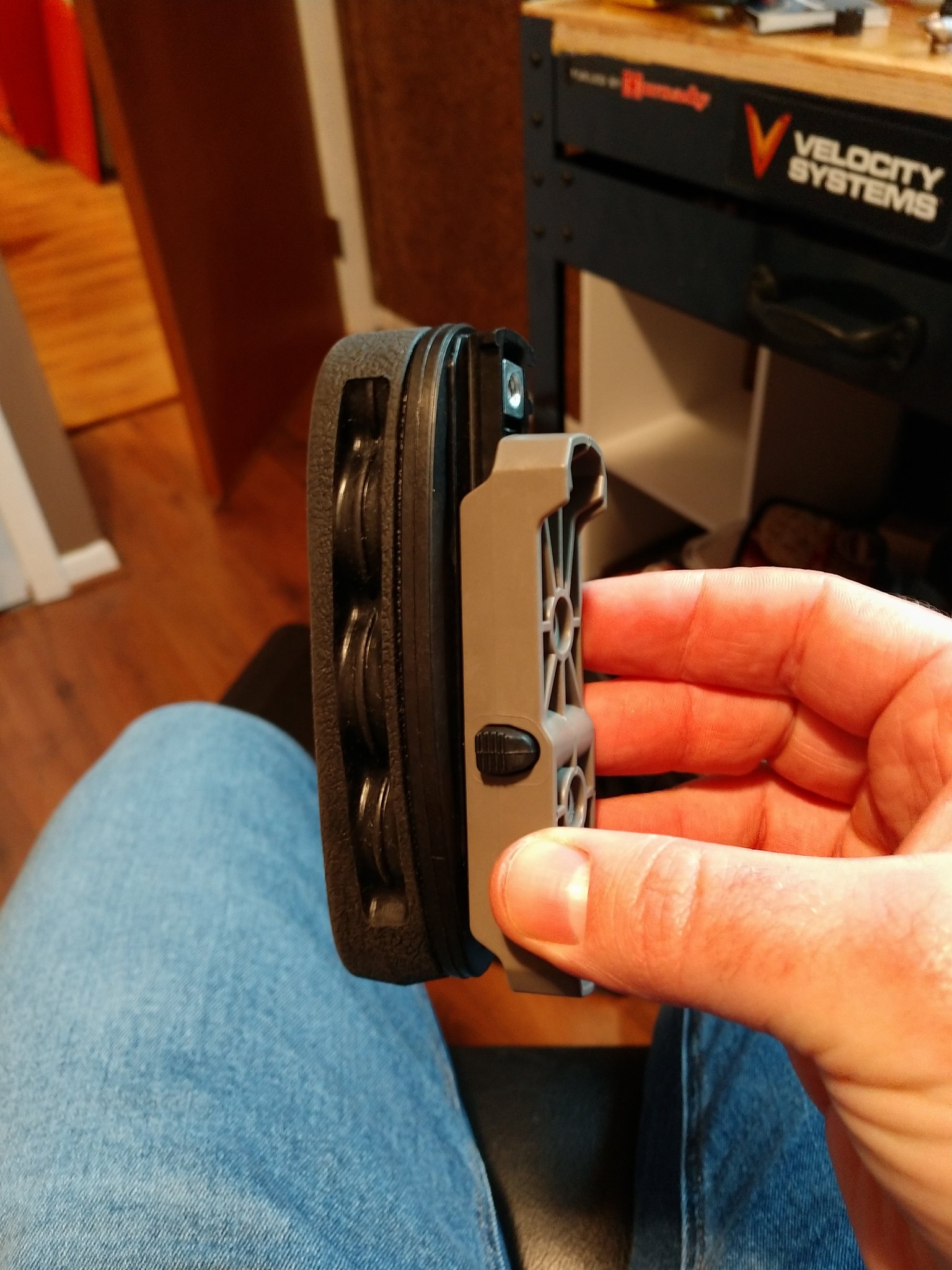

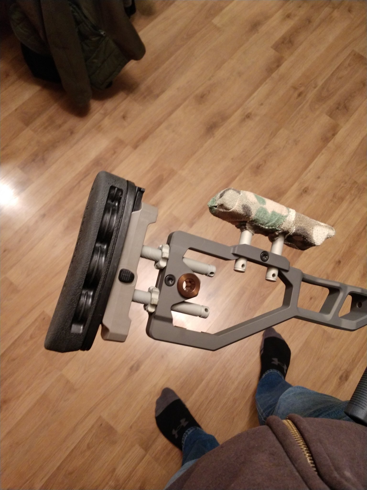

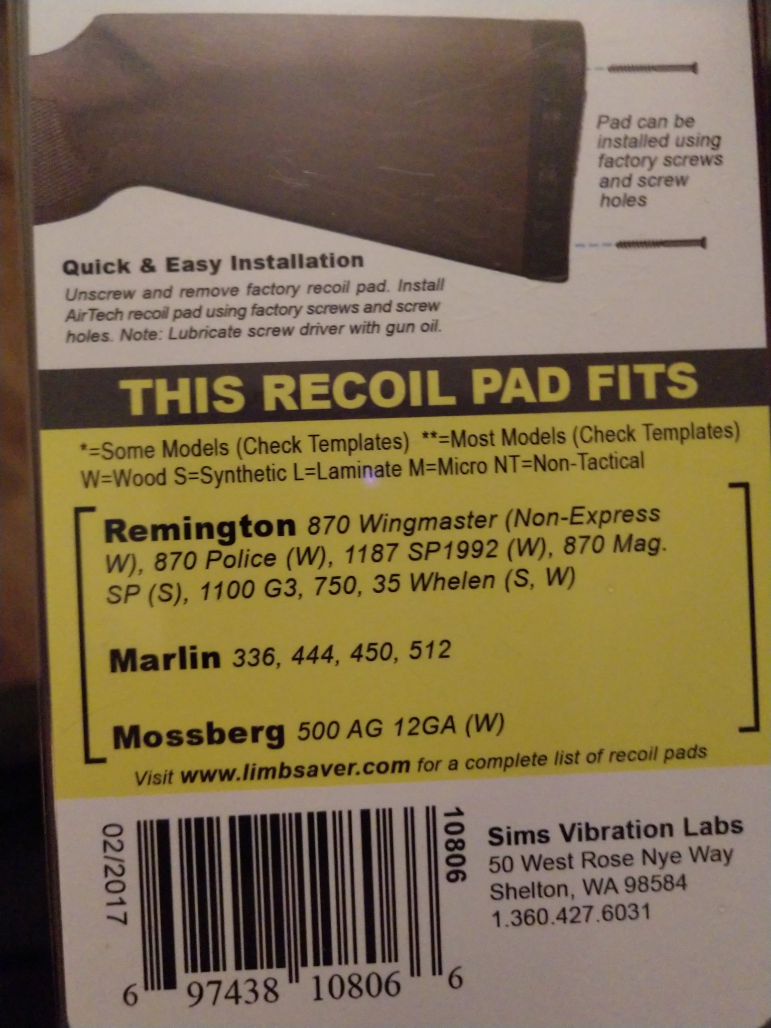

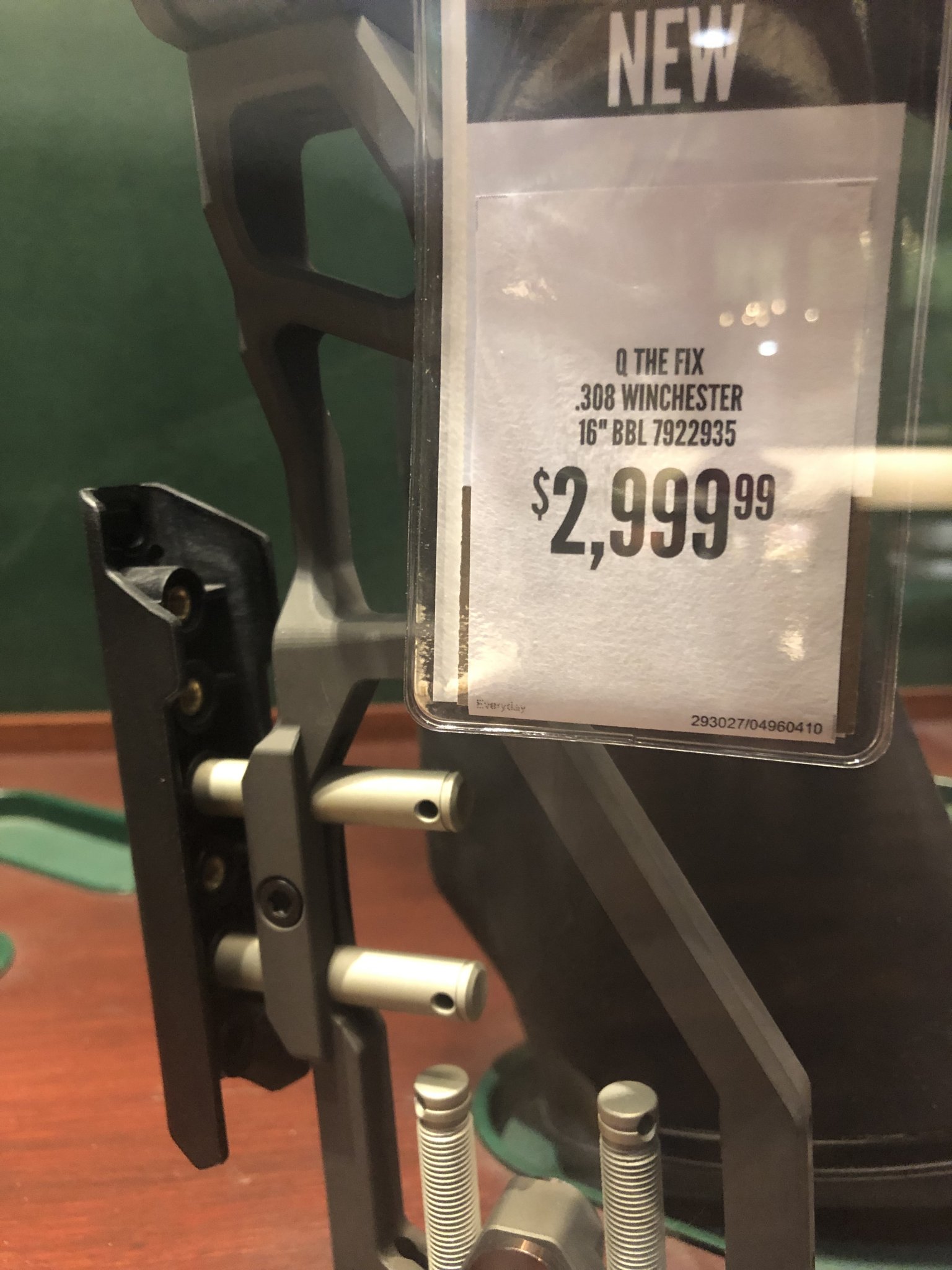

Well I had vacation this week and the deer hunting has been slow so I decided to get after the butt pad issue. I took the butt pad assembly off and after removing the thin rubber torture device, noticed that the holes in the pad holder matched up almost perfectly with a limbsaver I had lying around.
The channels in the holder lend themselves perfectly to a square nut, and a quick trip to Home Depot later, I have a very soft butt pad that still functions 100% for up down adjustability, as well as folding all the way as long as the pad is adjusted down to flush on top.
I know some have said the stock pad is totally adequate for hunting/light firing schedules, and I agree, but after 80 rounds from the prone in an F Class match I had had enough.
View attachment 6977538View attachment 6977539
Great find. Do you know the model number of the Libsaver pad or for what firearm it was made?
