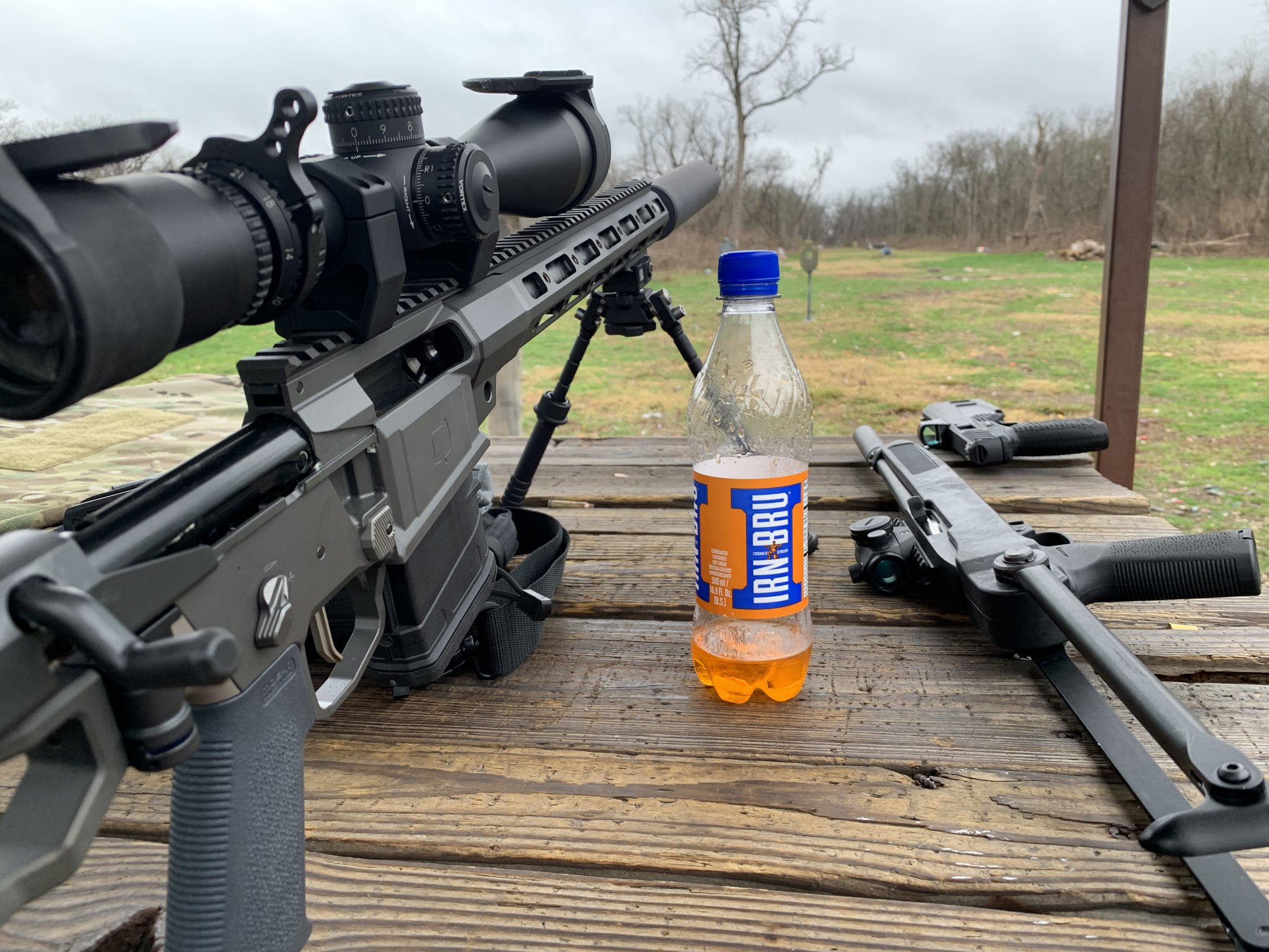

Finally got my Proof cf 16.5“ 6.5 creedmore out a couple weeks ago. Fantastic, and makes the creedmore like the 16.5 308. Great handling. Just got to dump the 22” steel it came with. next outing shooting for groups.

how is it grouping?
Better than I can shoot that’s for sure. I really like the lightweight and shorter length, but no doubt the 22” steel would add some stability, but I have bigger heavier guns if I want that kind of length. Super handy and the carbon fiber is just bad ass. Just waiting on replacing my full Nelson with a trash panda when the paperwork clears. Of course I may get a jumbo shrimp as well.

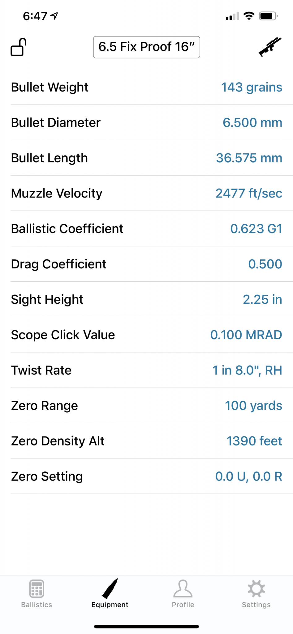

Just outta curiosity, what kinda velocity are you guys getting with the 6.5 with a 16" barrel?
I haven’t chrono’d mine yet but I’m hoping to get a load @2550 ish with 143 eldx, might try to work up a load with the 127 lrx as well. Check out the shorty rifles thread, there’s a ton of load data on shorter guns 16-20”
from my experience I would skip the 143. It doesn’t open up well. I would focus on the lighter bullets with a shorter barrel
