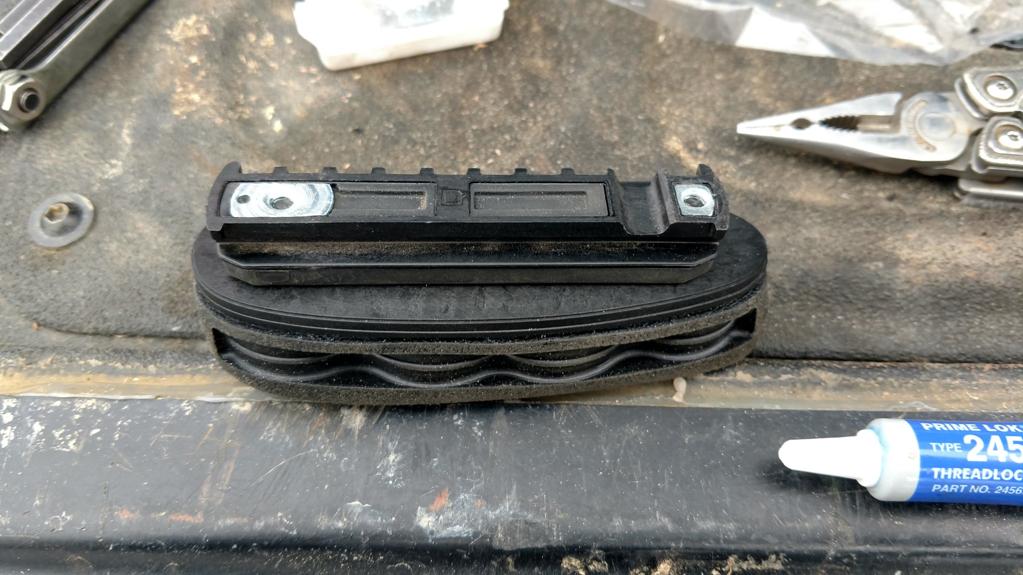

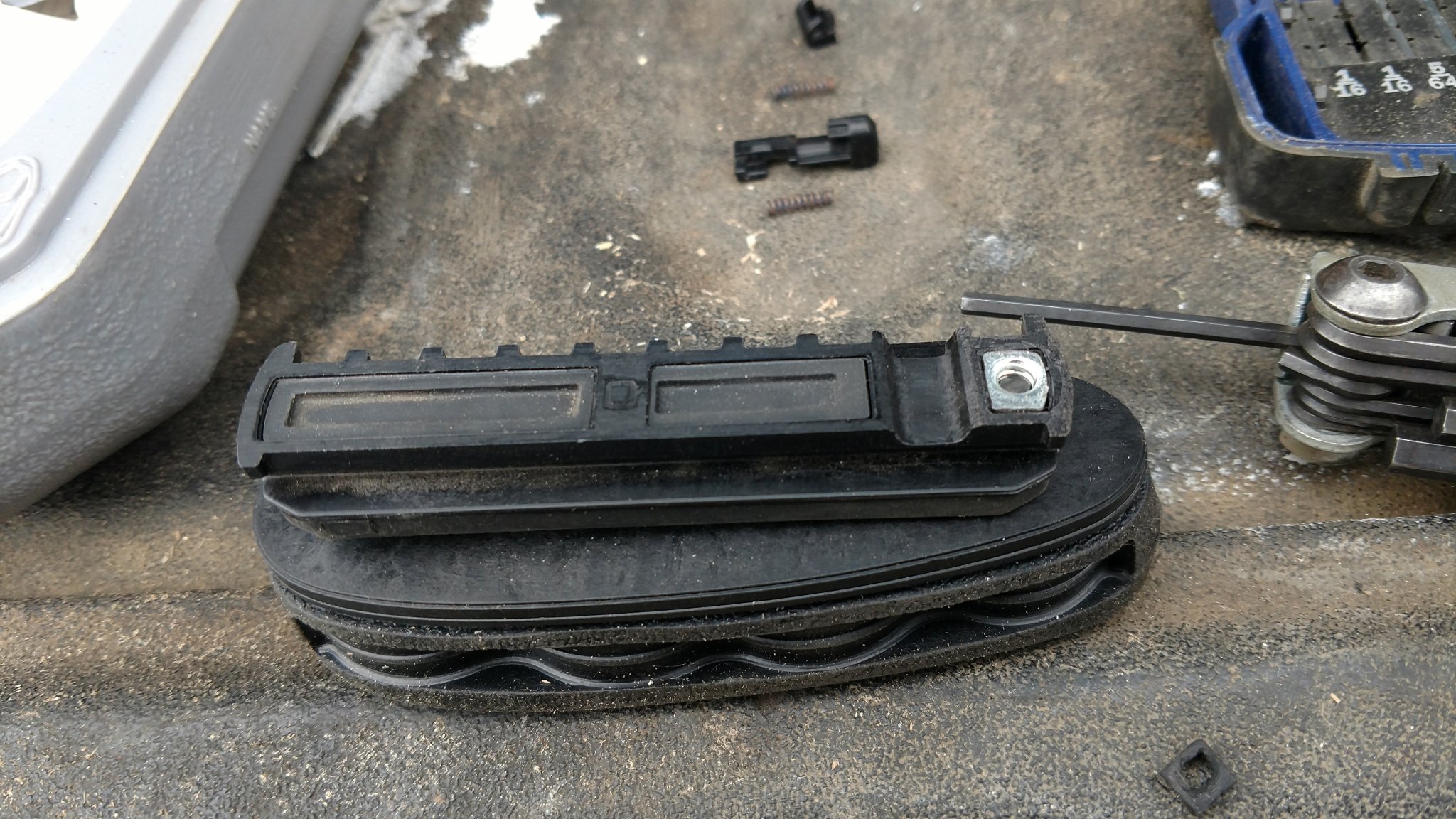

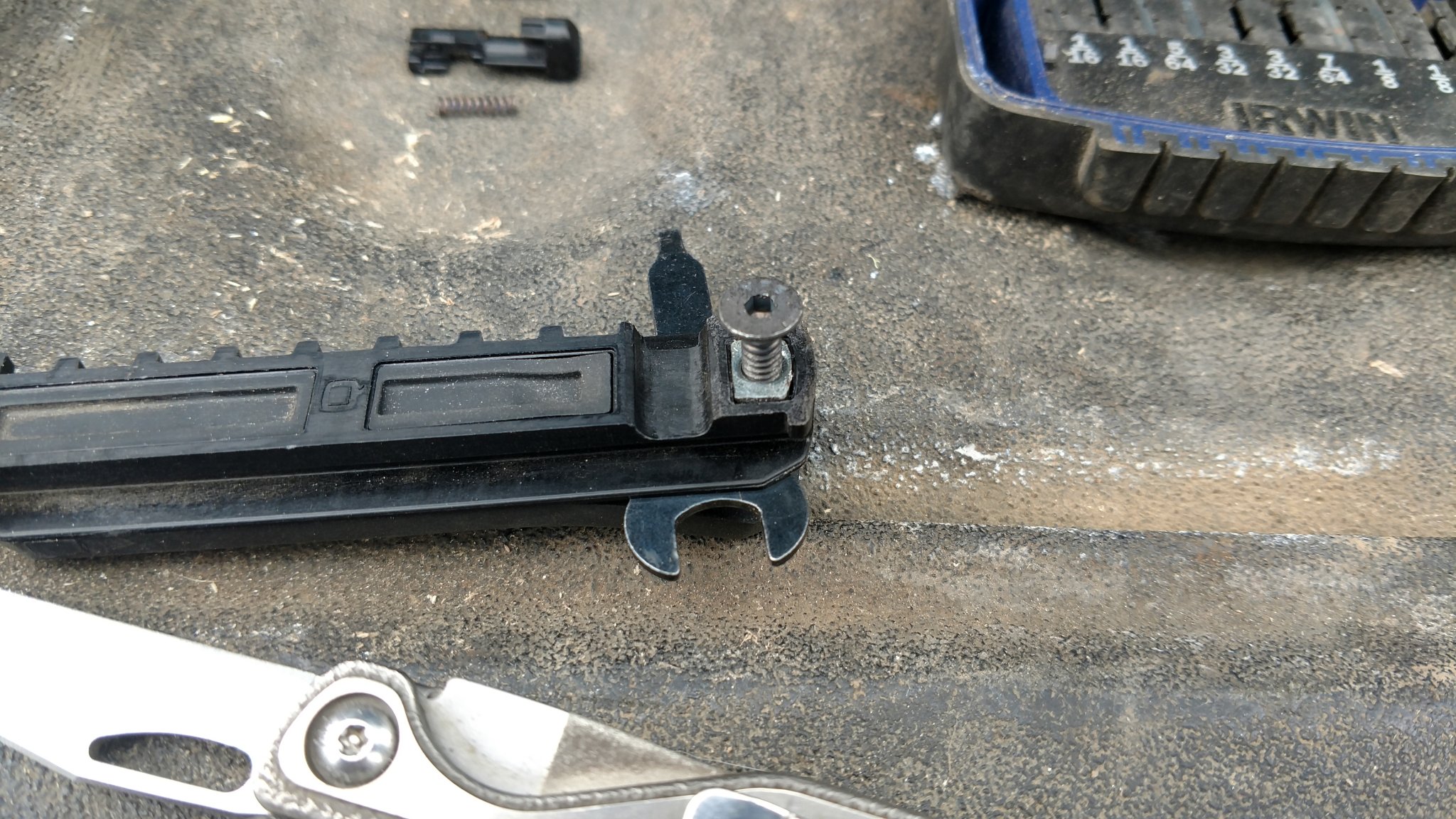

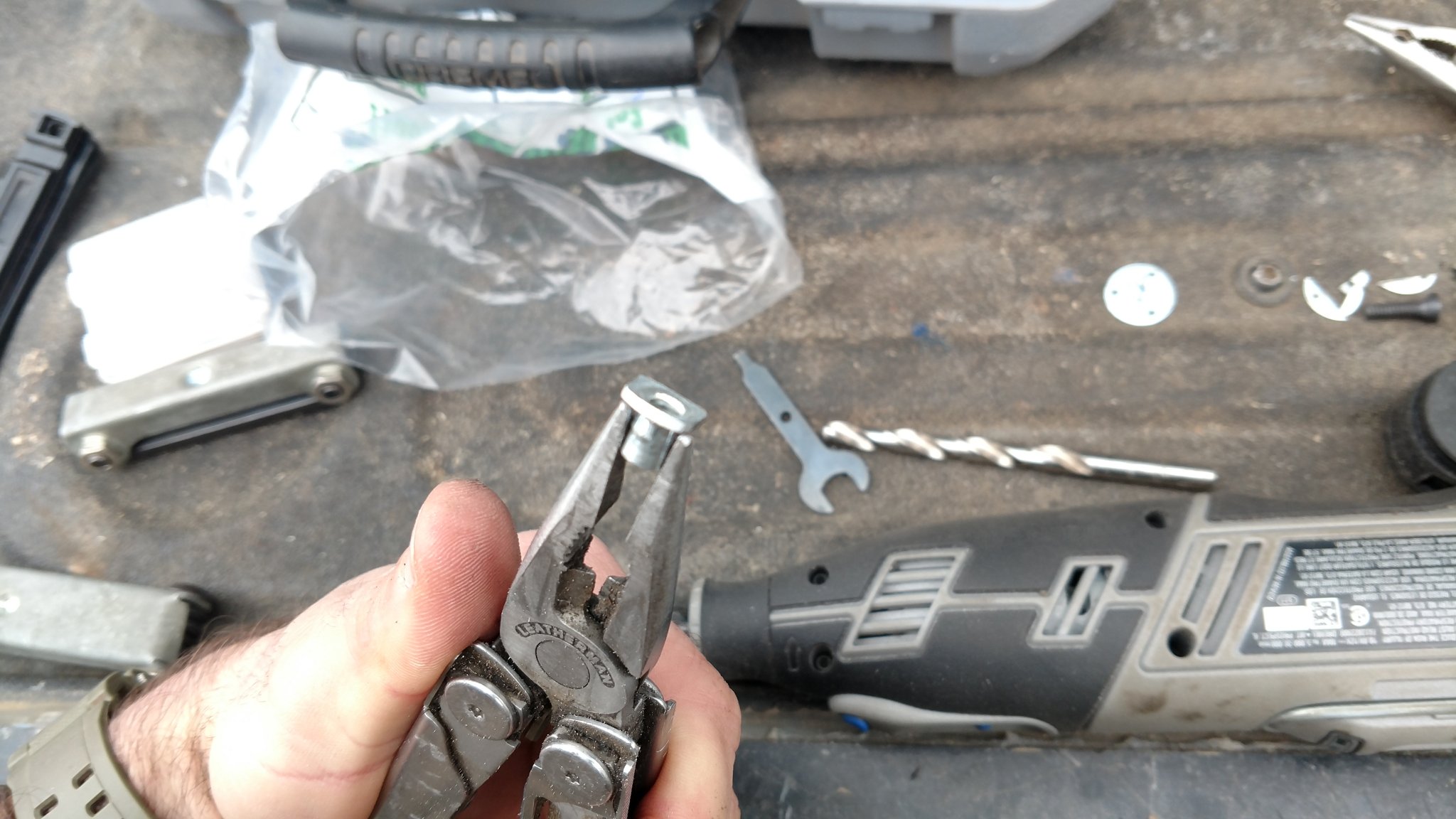

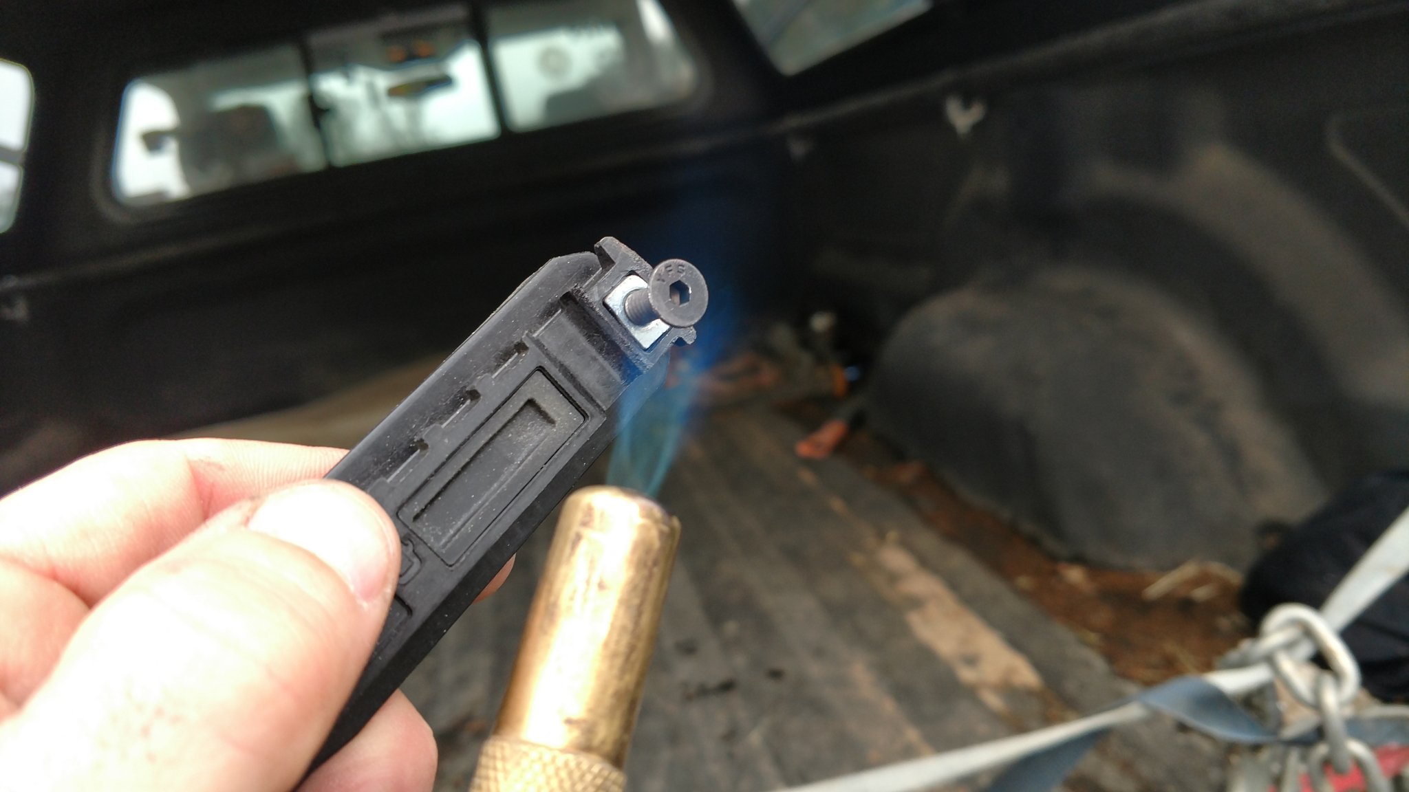

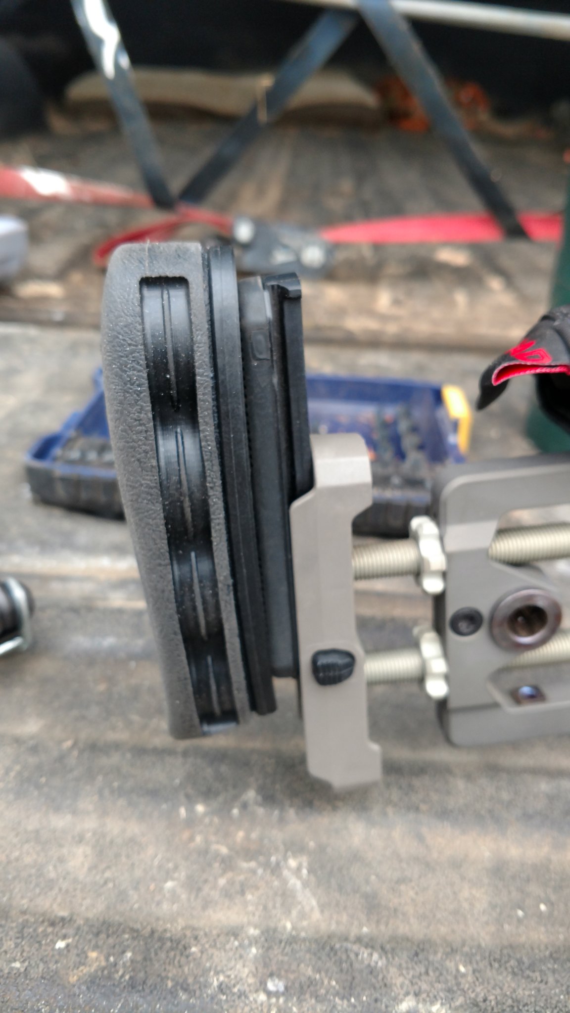

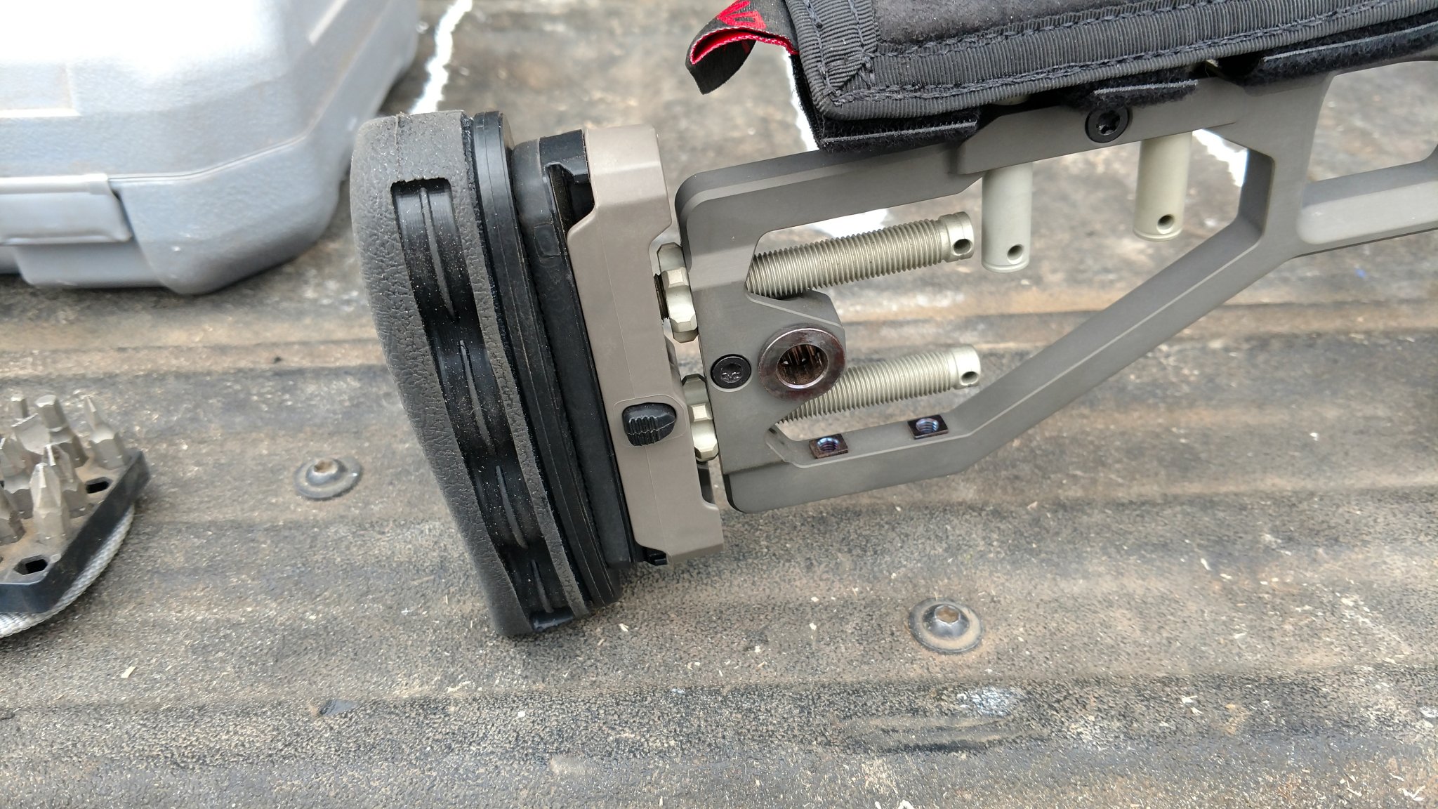

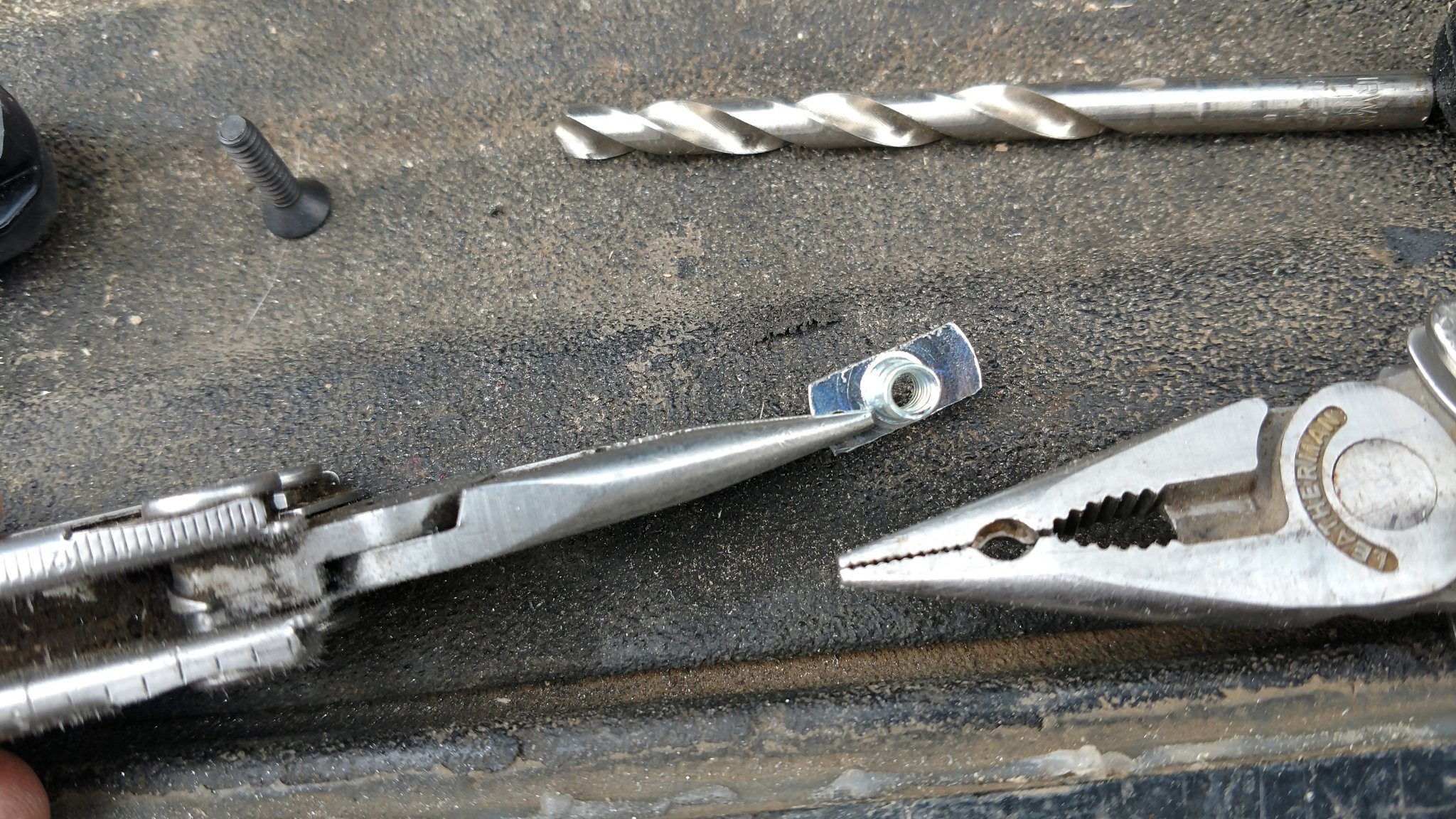

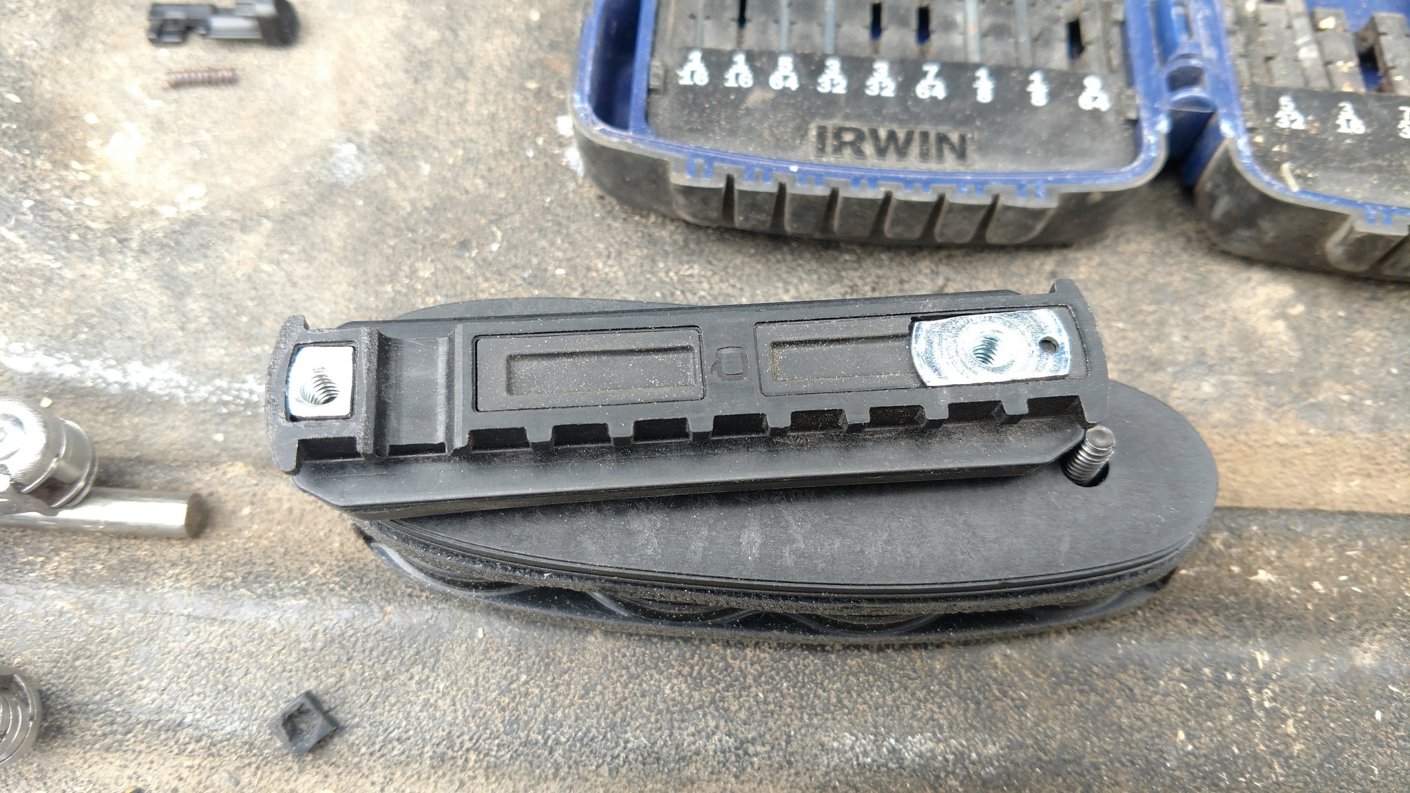

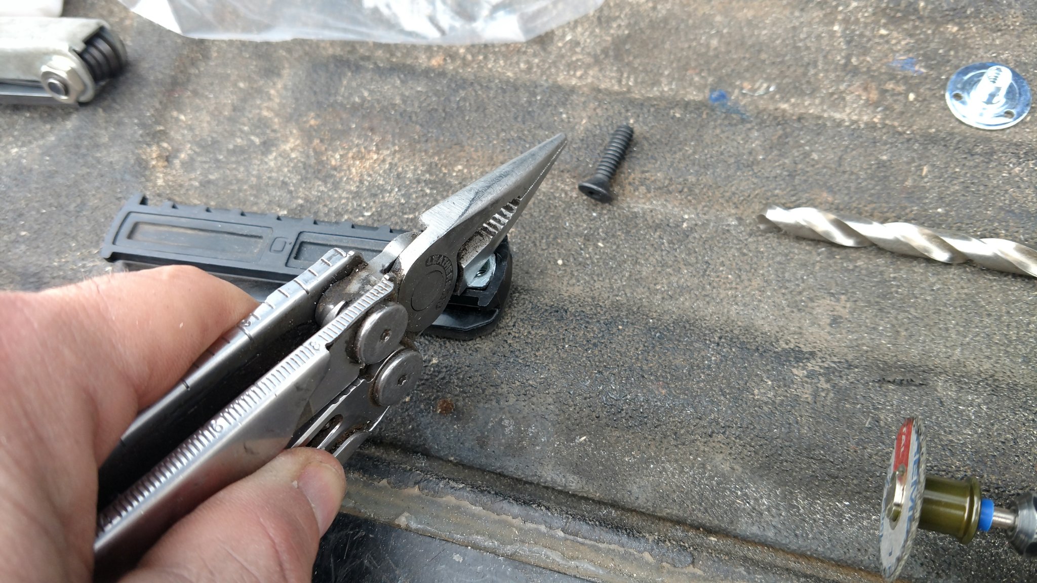

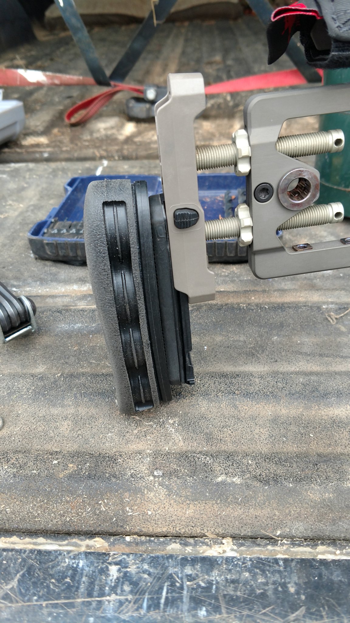

Sticker shock on the Big Butt!
Made a BadonkaButt™
Decided to do a Limbsaver with an AirTech 10802
Grabbed a couple screws and brad hole nuts
After removing the factory butt piece(pictures omitted for your own safety) I locked the nut in my vice and machined the bottom screw brad nut to fit the pocket on the butt piece
After getting it within half a thou, I heated the component for an incredibly precise press fit finish, which I seated in with a specialized dead blow tool made in Portland
With a quick test fit, in ISO9001 compliance
On the upper mounting mechanism it was a little more straight forward, but required use of my cnc laser to precisely trim away some excess vibration damping material on the factory butt piece, which was fit in the manner the first was, heated (I was actually doing this because the brad nut has a step and I didn't want to blow the hole out to the larger diameter) and seated with my special Portland Press
Once finished on the Q butt piece, I used my mill and chamfered the fastener seat inside the Limbsaver and got set to assembling
Every BadonkaButt™ is assembled with Brand X blue thread locker, on an ISO9001 tailgate
Reactions: Mr. Tots and mpncc

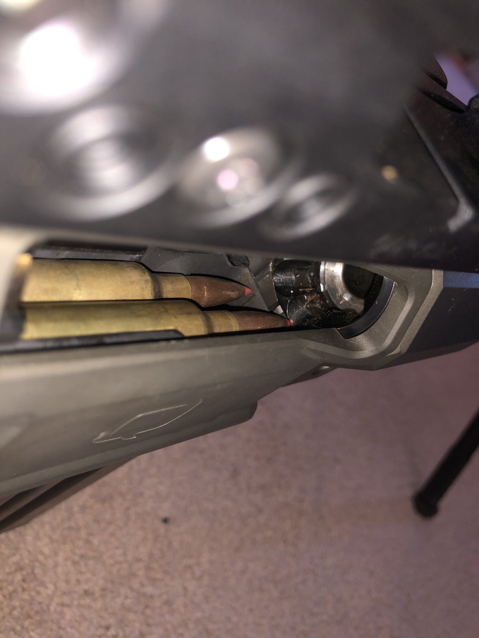

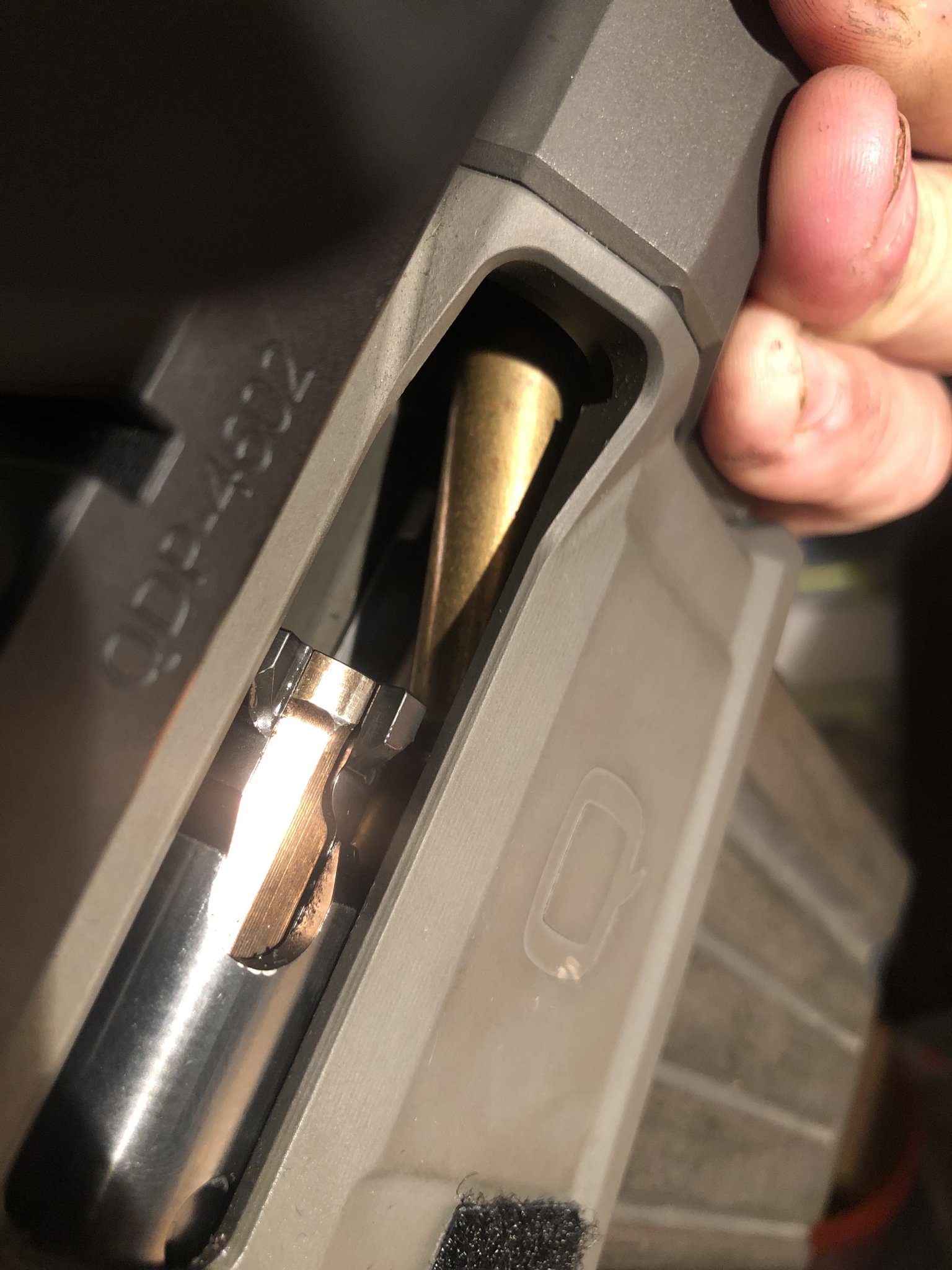

I haven't followed the thread for a while. Has Q acknowledged and fixed the feeding problems for 6.5 Creedmoor? I just shot with a friend and was able to contrast his buttery smooth Tikka T3 action with my own shitty feeding for the Fix.
I messaged them on this very issue with my 6.5CM recently and the response I received was “You need to run the Fix faster than older bolt guns.” Not saying I agree or disagree with this being an acceptable response. Just stating what I was told directly from Q.
I love the rifle and it is my favorite gun to shoot out of all that I own so I’m not going to let that ruin it for me. However, I would have almost rather The Fix utilize a proprietary mag that eliminated this situation than use a common SR25 mag.
I tried the velcro strip in the mag well, but it bothered me knowing it was there. Would love to know if anyone has the rifle can run the bolt fairly slow like a more traditional rifle and have the fix feed reliably or if this is just inherent to a somewhat universal fit mag in a bolt gun issue.
I run the bolt every which way in mine and have zero issues. Runs like a sewing machine. I use KAC 10rd mags
Mine is there now to see if they can straighten it out. It's been a week and a half but I haven't got an update. With some mags bullet tips hit below the feed ramps. 20 round mags greatly exxagerate it. Unusable for the most part. Running the bolt hard only tries to set the bullet back and maybe, sometimes, it will jump up on the ramp and load. Velcro in the magwell for me corrects the tip/ramp alignment but then I get bolt over base issues as the rear of the round kicks down while entering the chamber.
The magwell could be a little tighter but then pmags might not drop free.
The mag could sit higher but there doesn't seem like much room for that.
I think deeper feed ramps like an m4 could take care of my issues at least.
