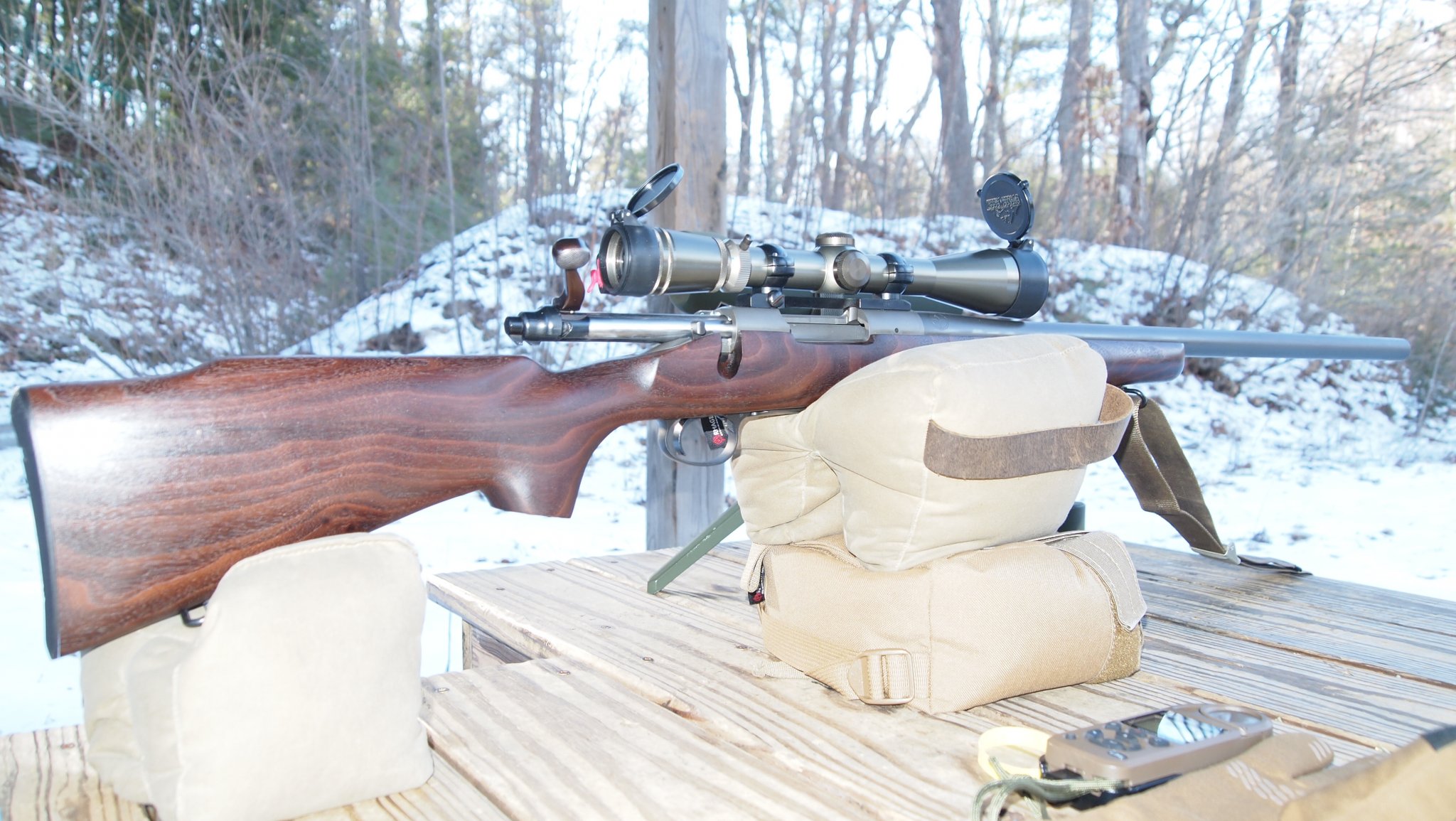

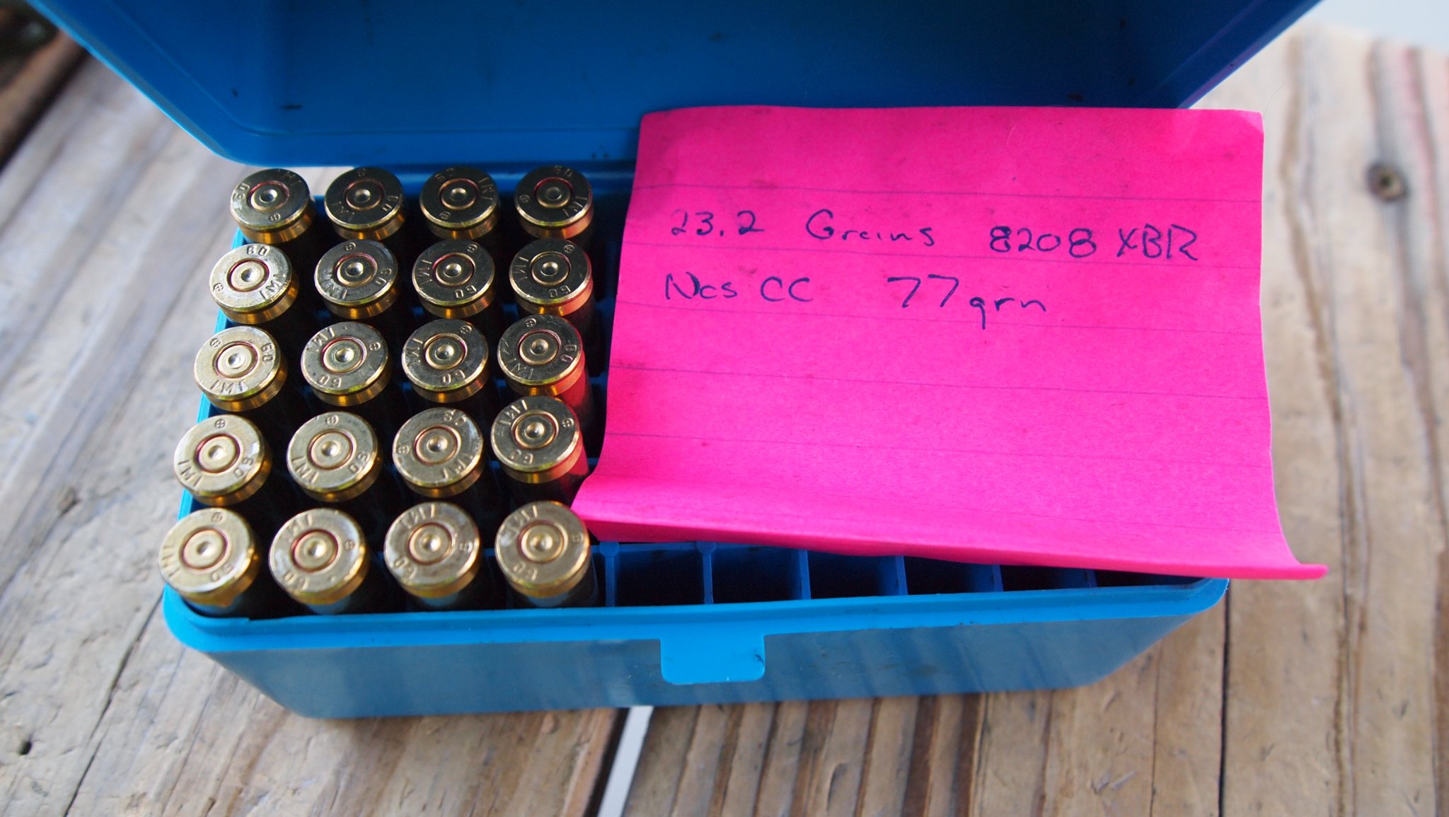

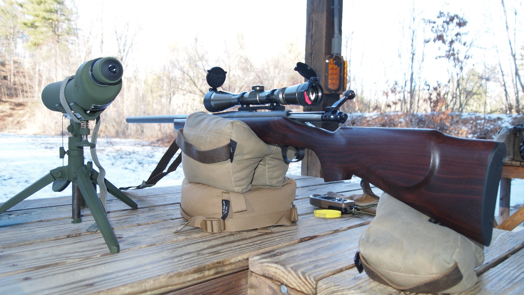

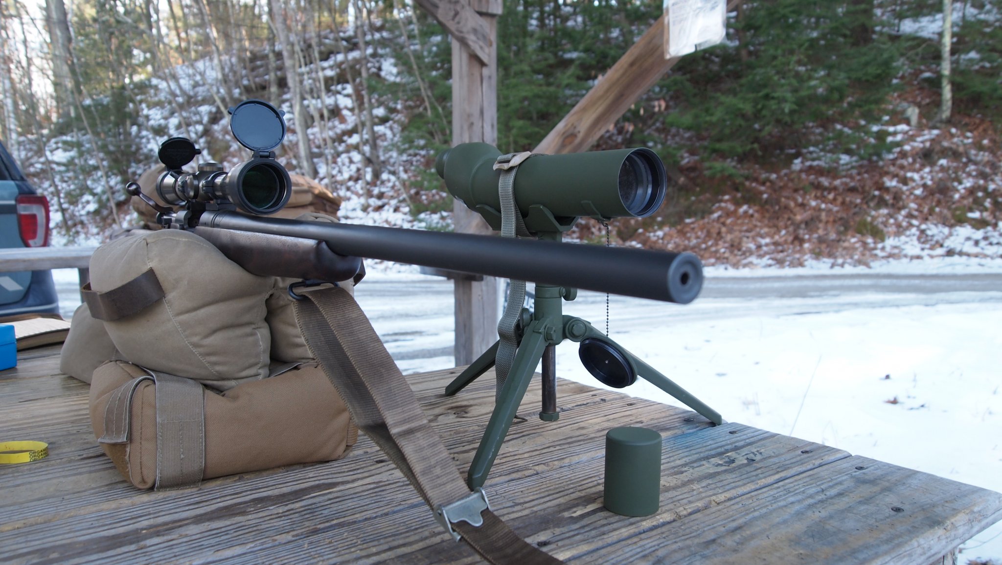

Damn! Looks like.....Maybe UNQ....
Probably not the best equipment for this exercise but you run what you brung.
Ive been wanting to take this guy out and I wasnt changing for you pussies....
Top row was the only target reticle allowed good crosshair reference. I wanted to make a scope change but didnt dare.
Second row didnt provide me much reference but I could just use crosshairs.
Third row I held under 1 mil using first row as aim point. There is 1 mil exact between every other row. First row dots are mil dot sized at 100 yards.
Fourth row held 1 mil under using second row.
Fifth row held two mils under using mil dot in the first row target dot. Tried holding my scope correction by keeping a "bump" high and right - kind of like a snowman toppling over to the right.
When I left added 1/2 MOA up and 1/4 MOA right to scope.
Fun. Going to have to try with Billy Beroo.
