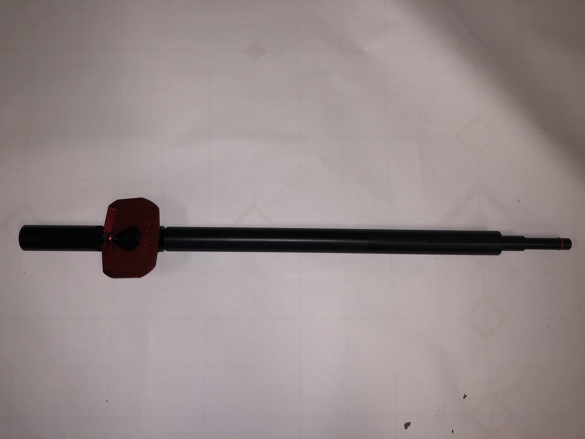

Another new owner question. When cleaning the bore, what do you recommend for a bore guide?
Thanks,
Phil
I know you asked this a while back, I've been gone for a bit and just saw it. Bore Tech made these a while back specifically to fit the MRAD. I don't know if they still do/have them or not but this one works great and fits perfect. Sorry about the shitty photography.

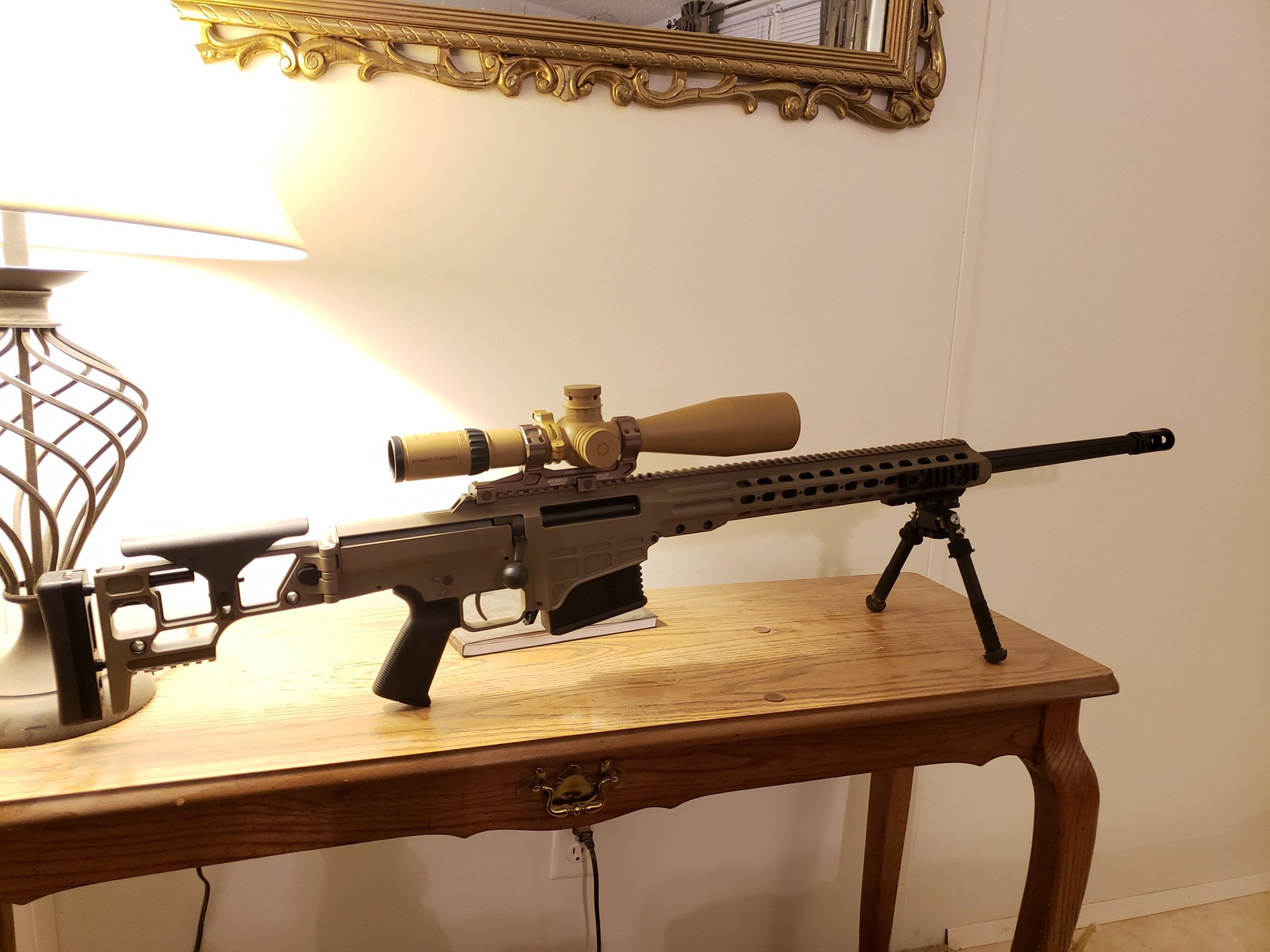

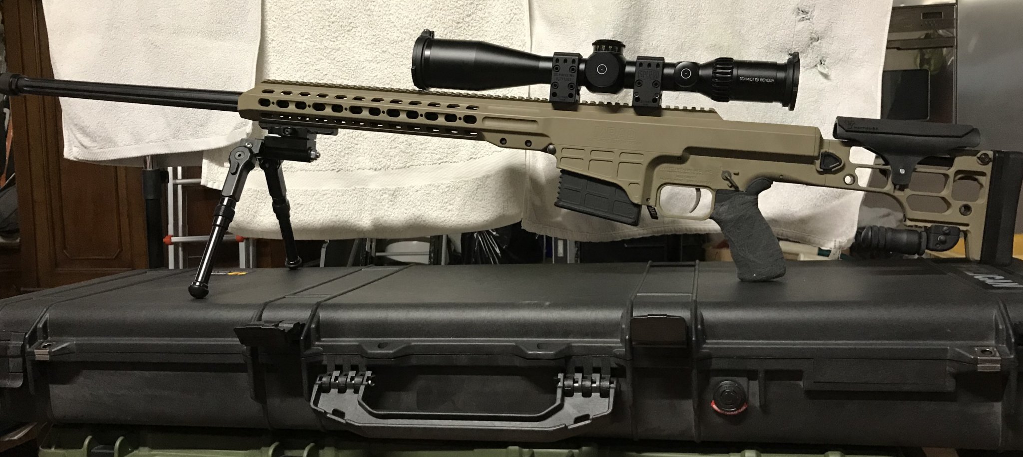

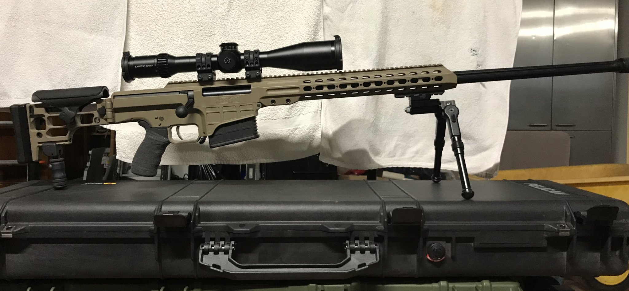

I purchased an MRAD a few months ago after parting with a 98b. Since there isn't much info regarding loads in this unit, (I have the fluted 24" 338LM barrel) I will share my experiences.
The 98B shot factory ammo ok, but responded beyond expectations with handloads. It settled on 300g Lap over Lap brass, 90g of H1000, set to the lands, OAL of 3.755. .3 moa was the norm, mostly holding all the way to 1000yrds, if wind was cooperating. Excellent.
I decided on the MRAD due to the folding stock and switch barrel design. It's not quite as comfortable to shoot as the 98b, but has a few attributes I prefer.
I have found the gun also likes the same load, except I had to change the OAL to 3.700, and it shoots .3 moa as well (to 300 yards anyway, I have yet to make it to 1000, corn not out yet).
I have the unit topped with a NightForce NSX. AAC Titan QD suppressor.
These guns shoot!

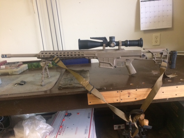

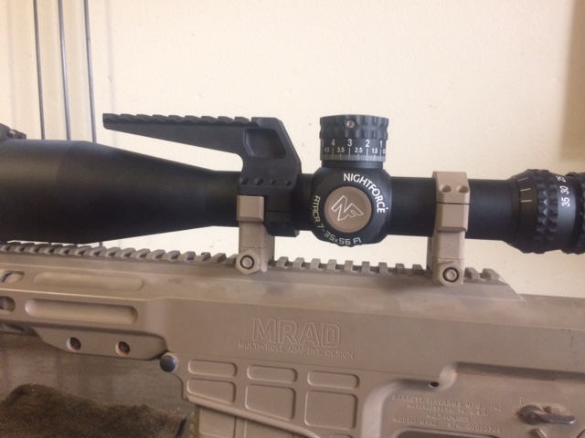

What ring height on Barrett MRAD for NightForce ATACR 4-16x50?
I do not have that optic, but am using 1.5" to clear a 56mm PMII with rubber scope caps. You could probably do 1.2-1.3 for the NF.
I do not think taller rings/mounts look out of place on this due to the low bore axis.

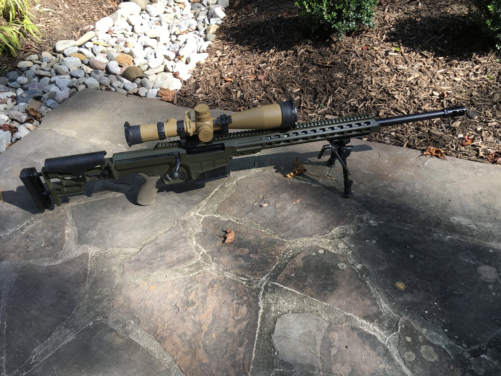

After putting 65 rounds (.260) through this, from 100-1000 yards, it is an easy system to be confident with. The trigger has a little creep before hitting a wall and then breaking, almost like a two stage, even a 1lb 8oz. I am not sure if I would adjust it much lower.
In case someone else is using the factory .260 barrel- Labradar put the Prime 130gr .260 at 2836 fps (70F, sun) and 2831 fps (35-40F, overcast) in the 24" factory .260 barrel. AB data was as almost dead-on using kestrel atmospheric data, the Norma golden target 130gr bullet Litz BC (.295 G7), and those average velocities.

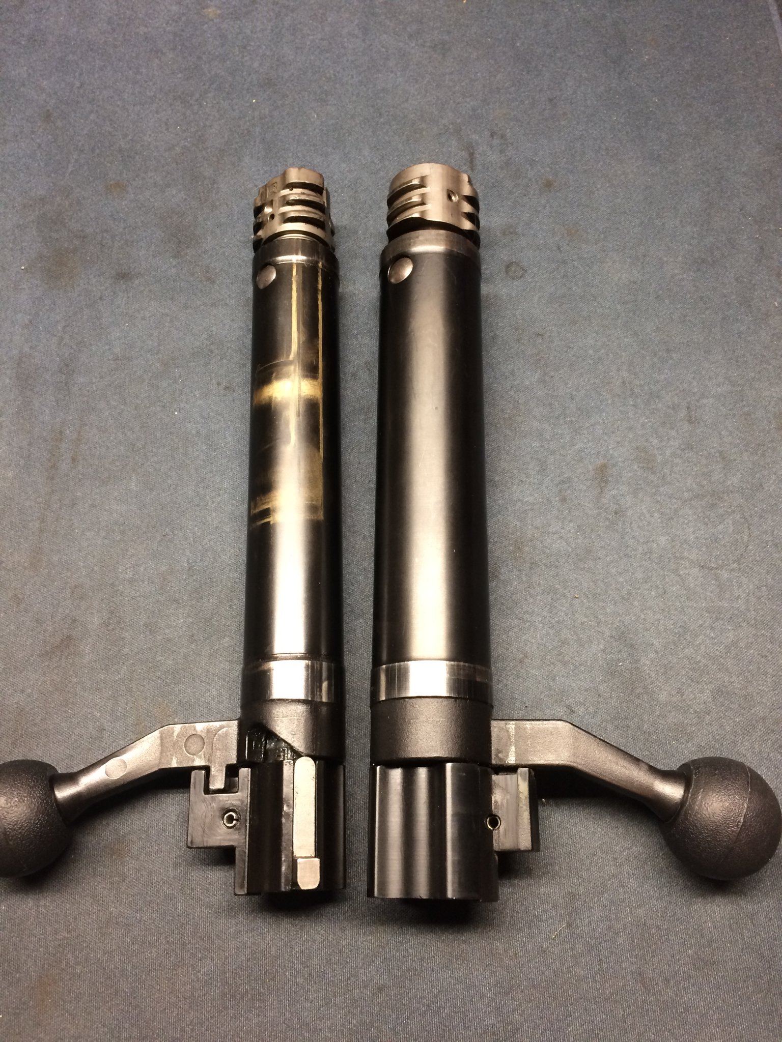

For those who have recently purchased a new MRAD, what size breech are they? I was never really clear on this and a call to Barrett CS was not much help.
For discussion's sake, I have both here:
Large bolt face (.338lm) and body: ~1.1" diameter bolt body
Small bolt face ("C" marked, .308 family case head) and body: ~.95" bolt body

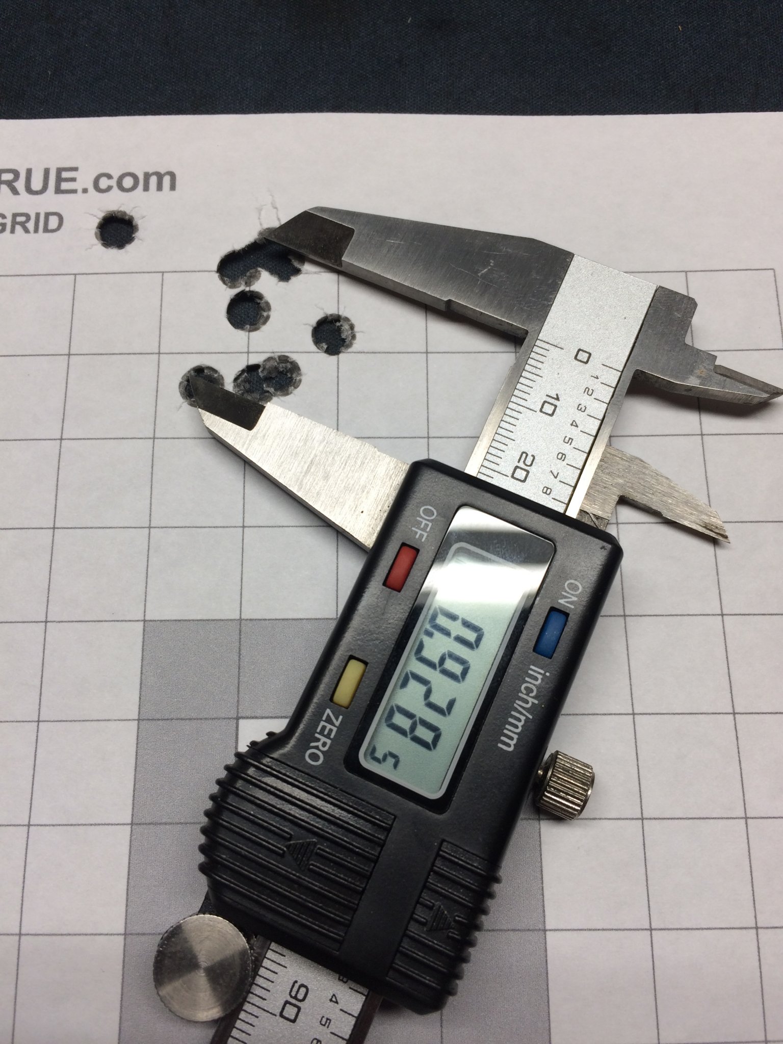

Not the most scientific test today, but I did try the sequence I posted above a couple times today and here are the results from one iteration:
100yards, factory prime ammunition, which is normally around 1moa for 5-round groups at this distance
shoot 3 rounds .260
replace .260 barrel with .338
shoot three rounds .338
replace .338 with .260
shoot three rounds .260
remove and replace .260 barrel
I did call the outlier (was the third round of the second .260 group) and do not think I can attribute it to the rifle system.
You don't see the .338 impacts as they are 1 mil left of the .260 group.
That is similar to the results I saw with my friends mrad.. how did the .338 group look ? Or where you even shooting groups with .338?
Sure. I have never printed anything decent with the Hornady 285gr BTHP, but the group was fairly representative. It was $2.30 a round, so still worth it for this kind of thing and the brass. I shot two other groups with it that were about the same.
Of course I could also be anticipating it with the recoil shooting from the bench.
My .338 barrel is older (2013) and shows some heat cracking under a bore scope.
